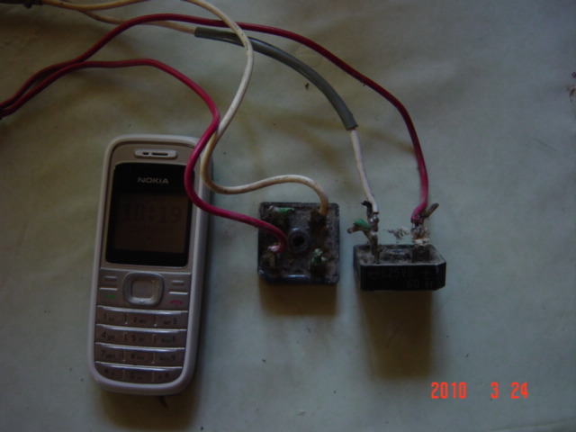

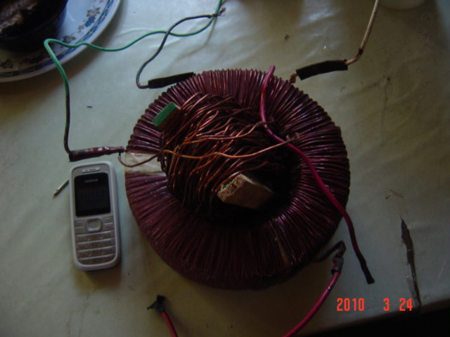

can this torroid meet the 2500kva requirement?
see cell phone for torroid size
