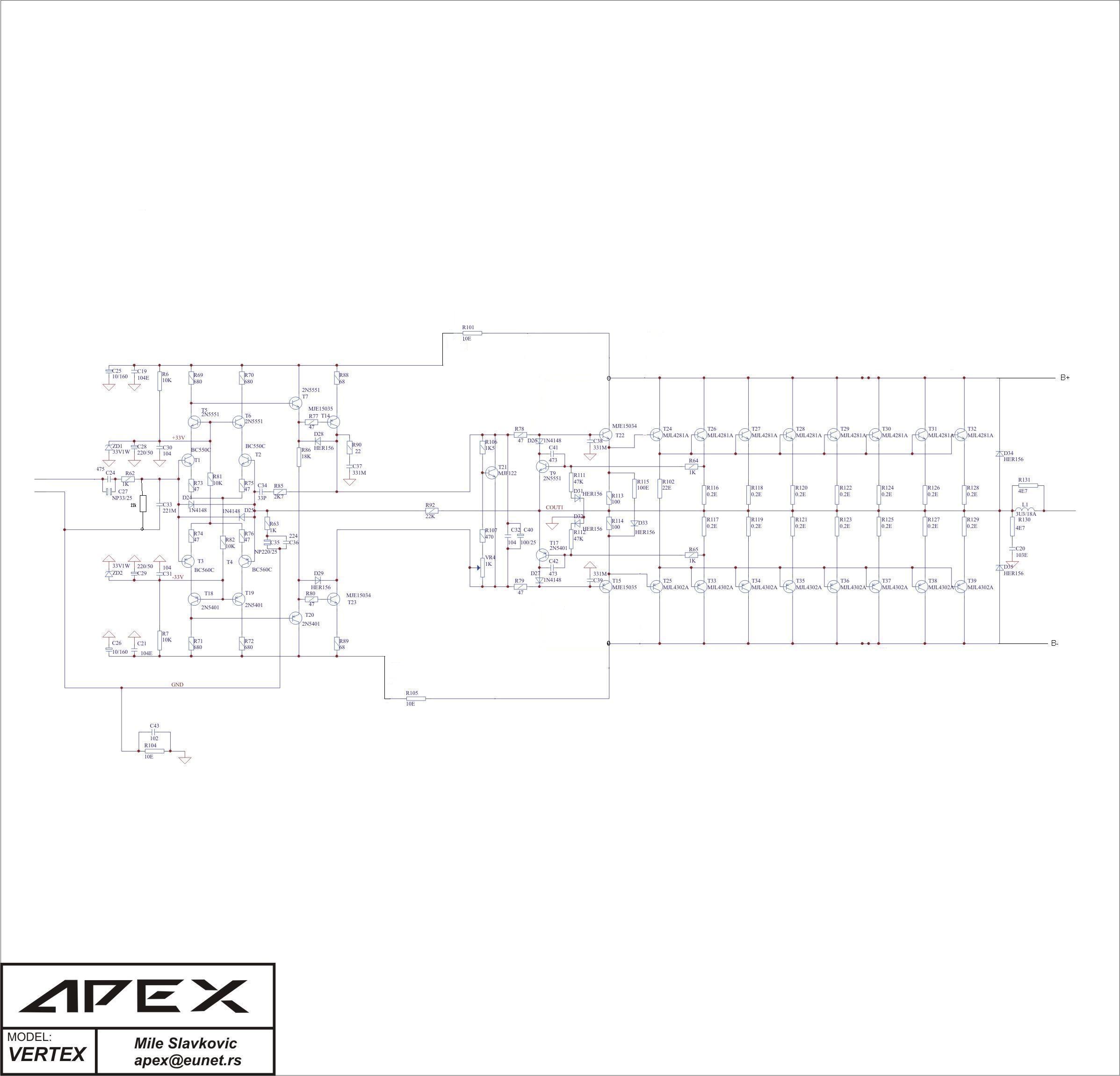

have a nice day sir apex...i just want to ask you about the vertex amp...can i remove step driver?and what would be the proper connection?....i have to cut some connection from step driver...it seems like my attachment?
regards
jhun

You can remove step driver, I suggest to add some DC offset adjust circuit if you don't want use DC servo.
Regards

if add some DC offset, what would be the proper connection sir, can you help me plz, i realy want your vertex amp,...if i make the vertx amp, which is your attachment, it will work Good and what would be the dis advantage and advantage if no step driver?...and how much the wattage w/o step driver? thank more power!!!...

I prefer DC servo with LF411 or TL071. For simple DC offset adjust use 100R variable resistor instead R73, R75 (47R). Sound is similar to CA and PRO amps of 'crest audio', good for me.
Regards
