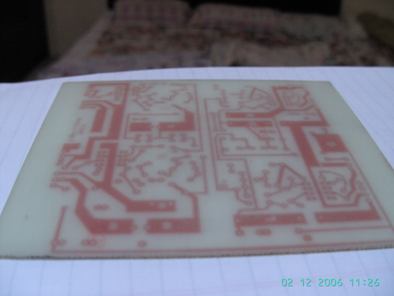

greetings now pcb is ready can i use 16 amps ultrafast diodes
only for testing purpose since diodes 30 amps will take tim4e to get can they
work in vertex schematic there are zeners 15 volts 1 watt and in4744 zeners
are they not the same transformers 24 0 24 3 in series is it ok

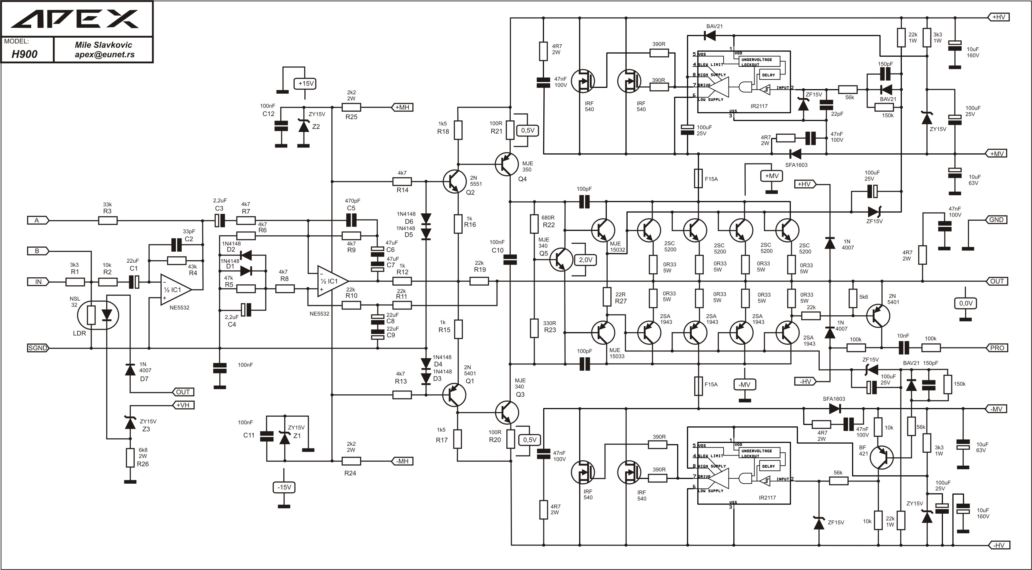

apex,Yes Vertex 2500 is 3 step class H amplifier use IR2117 like H900, but VAS current in H900 is to low for drive more outputs. H900 can be upgrade with 15mA VAS current for 3 step class H and add more outputs for more power. I will share upgrades when amp was tested.

You can use 16A diodes for test, with 3 2x24V transformers in series you will have 72-48-24-0-24-48-72, it's ok for H900, same power lower disipation.

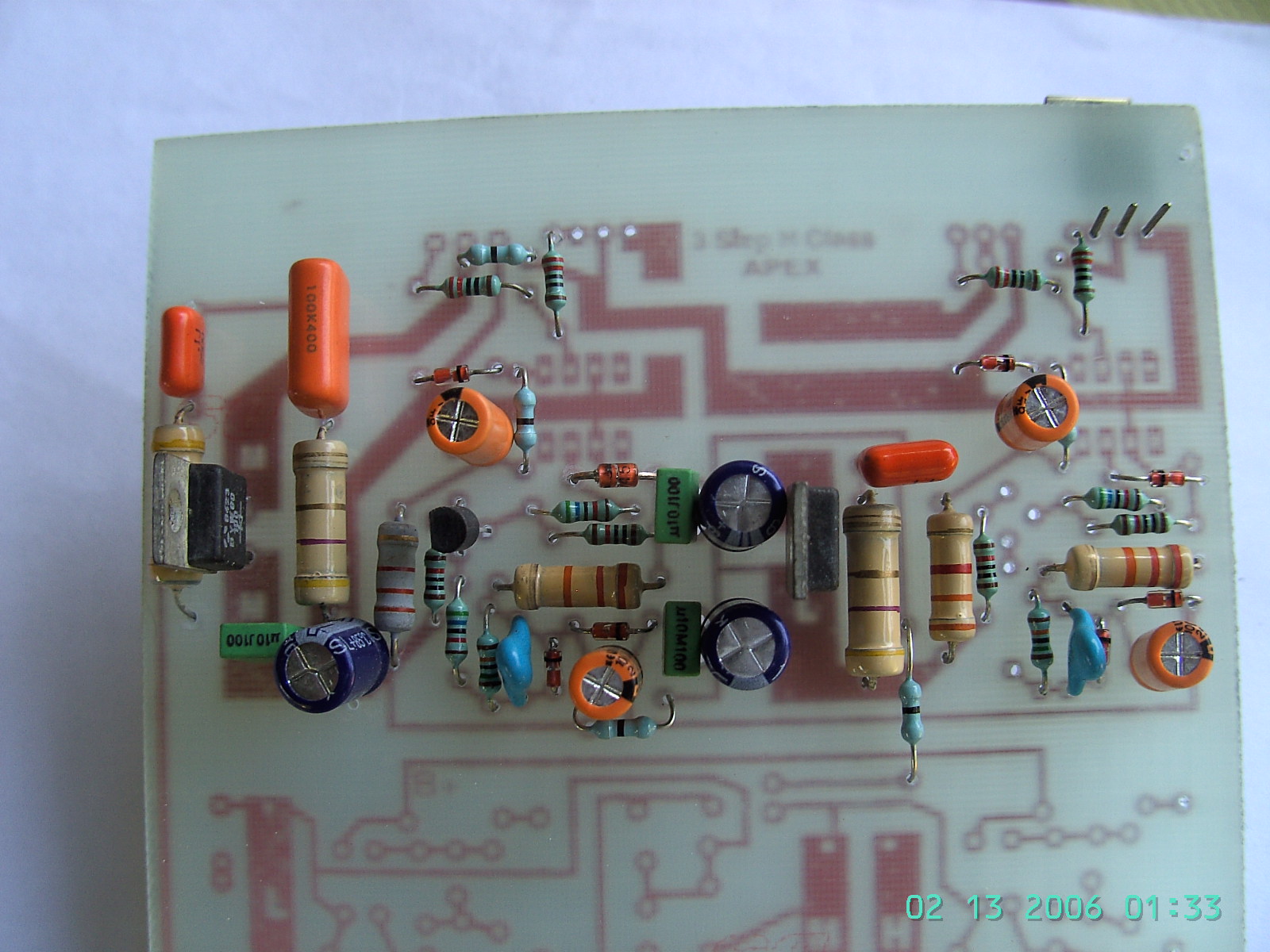

hi apexaudio
greetings vertex schematic zeeeners IN4744 AND ZENERS 15 volts
are they same trying a dummy run on pcb to see if components in correct place
matching with schematic please can you tell if drain source tracks are connected properly pcb tracks have to be made thicker will do another pcb
today are zener polarity ok counting on your help to make this project a sucess

1N4744 is the same as ZY15 1,3W zener diode. Do you have component layout for your pcb for matching with schematic.

On this PCB I use IRF540 in paralel for step higher voltage, and LDR for limiter. Output stage with 2SA1943/2SC5200. Step driver with IR2117 and NE5532 on balanced input stage.

can i have your schematic diagram of this amplifier?
Post #805
hi engel dela pena
greetings working on 900h my dream project finished
winding my transformer have eto put insulation tape and take leads out
heatsink have to be cut and anodised posting pictures
thanking you
andrew lebon
pcb to be fitted like this

LM082 is TL082 or use TL072.
