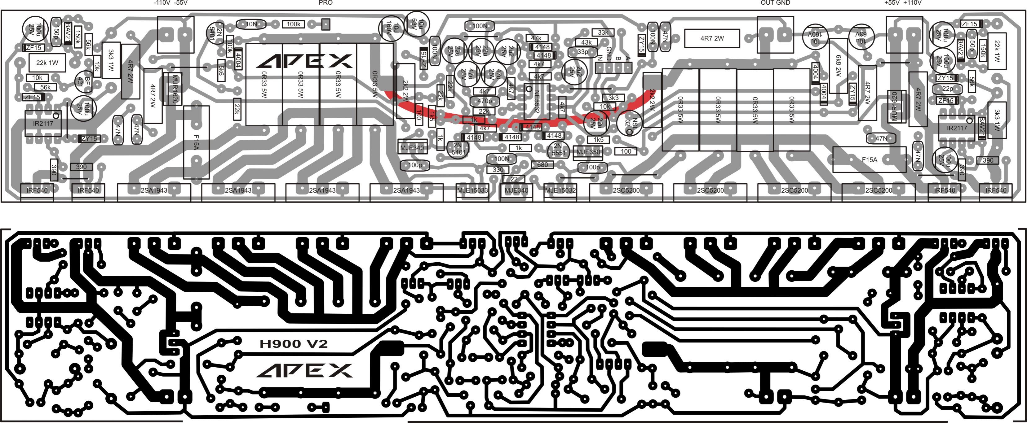

hi apex can i ask you a favor? please give the complete layout for the balance line input regards....
You can find pcb layout in threads for B500 and H900.
Regards

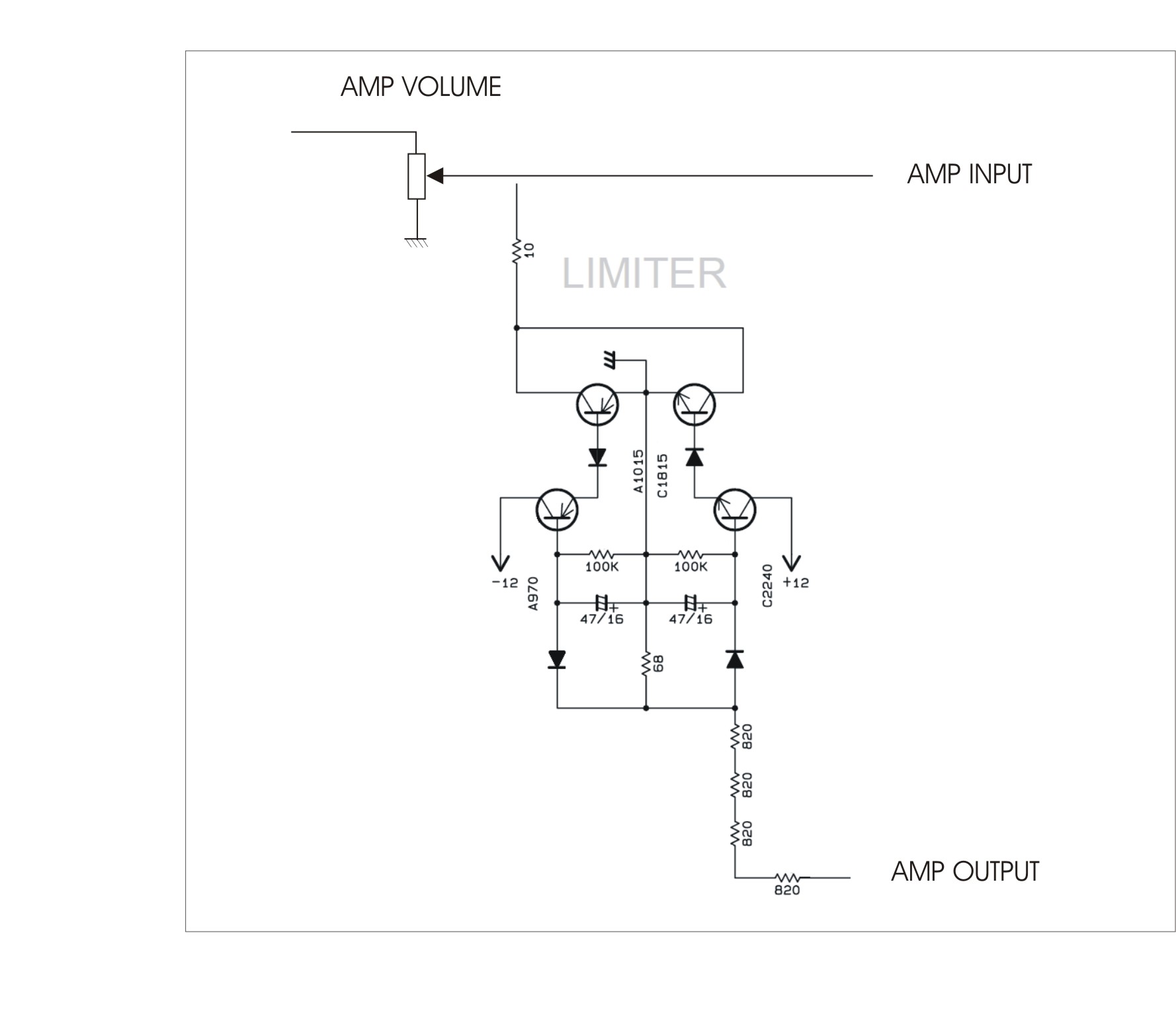

greetings do you have any input limiter circuit to share simple
one
thanking you
andrew lebon
Simple limiter without LDR or OTA
Regards
Post #73
http://www.diyaudio.com/forums/solid-state/167363-mic-line-eq-preamps-8.html
Regards

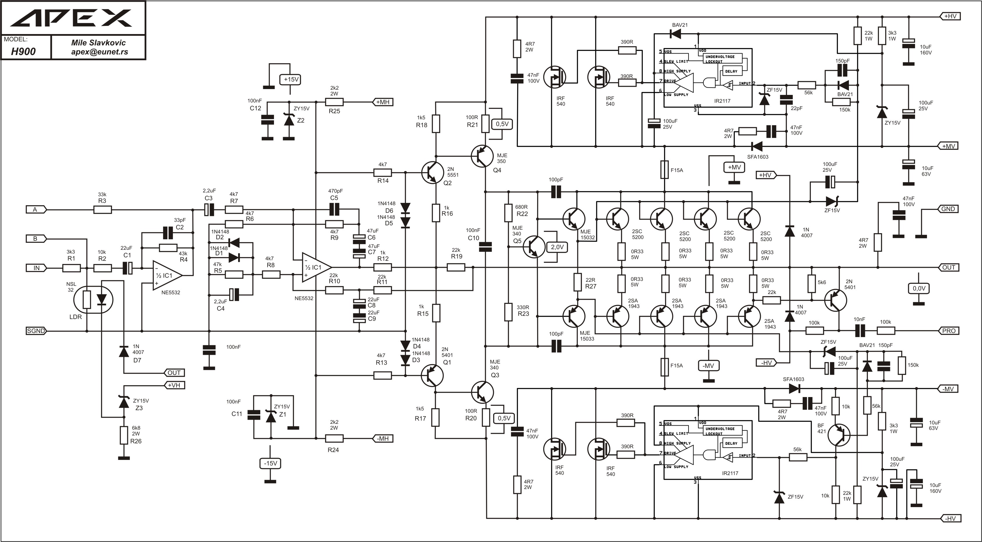

A & B pins on the input side are for bridge mode (wireing schematic is in the thread), not use for stereo.
V2 use dual comutation diode in TO220 case with 3 pins.
U need 2 protection circuits for 2 channels
VAS and step driver with IR2117 is on PCB (step driver with TL072 is for convert classAB amps like B500... to classH, not used for H900)
If U are beginner, I suggest U to build some simple amp like this:
http://www.diyaudio.com/forums/solid-state/167394-quasi-amplifier-begginers.html
Regards
apex,
how to implement 3 step (3rd step driver using h900 schematic)?
Use schematic from Vertex Amplifier.

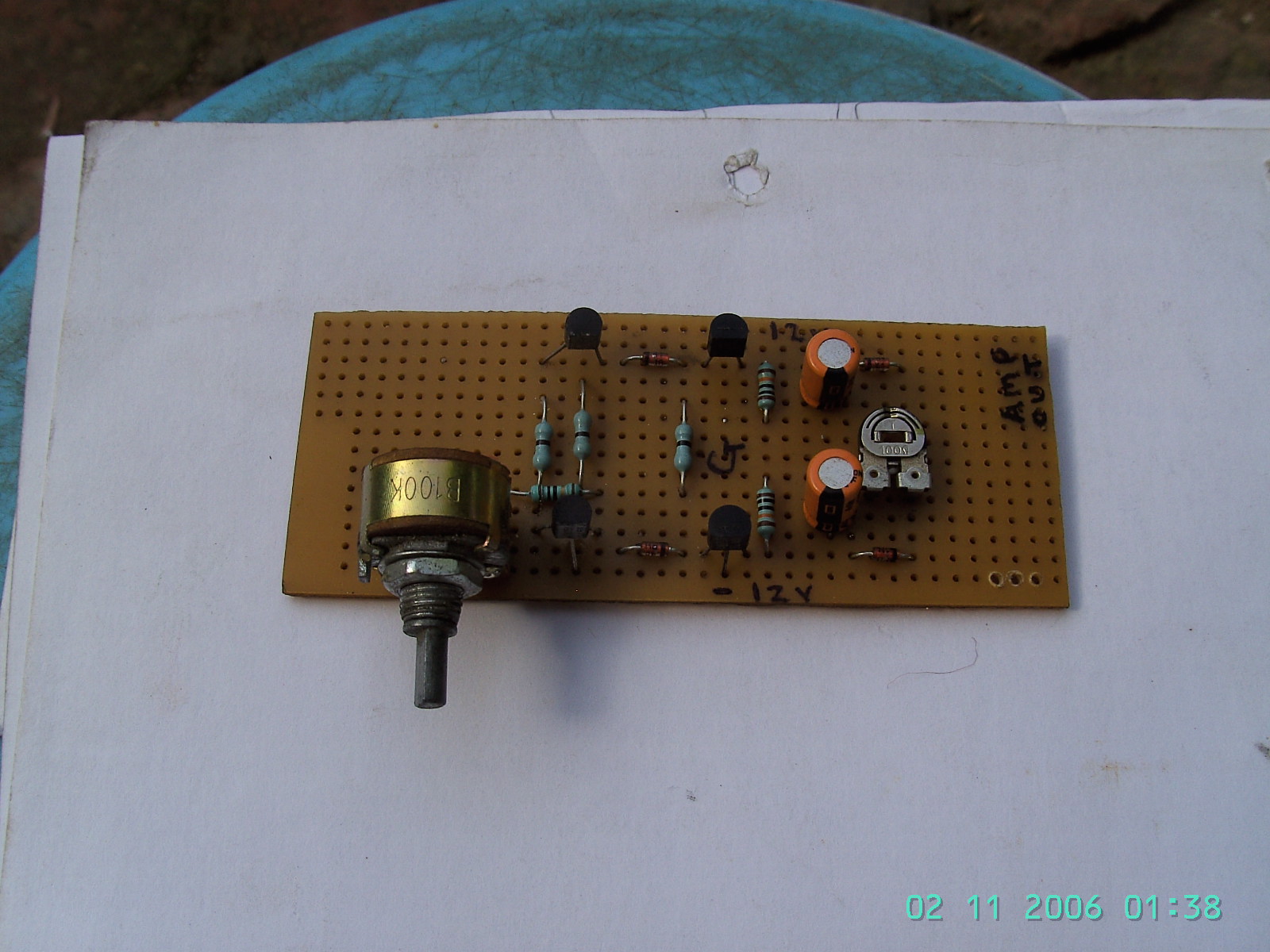

HI APEXAUDIO
greetings limiter ready should dc supply be taken from amp
or external supply any more limiter circuits which you feel best for amp and effective
thanking you
andrew lebon
Use +/-15V from protect circuit. I will share limiter with LM13600.
Regards
apex,Use schematic from Vertex Amplifier.
thanks for sharing vertex schematic
i understand pcb is not for share
and you don't want diy'r to go for higher psu like that
if you permit please share idea of adding another step for h900
just modified h900 schematic
thanks,if possible
apex,
thanks,if possible
You must add predrivers and more outputs, and than you can use 3 step classH driver from Vertex, but that will be new amp.
Regards
