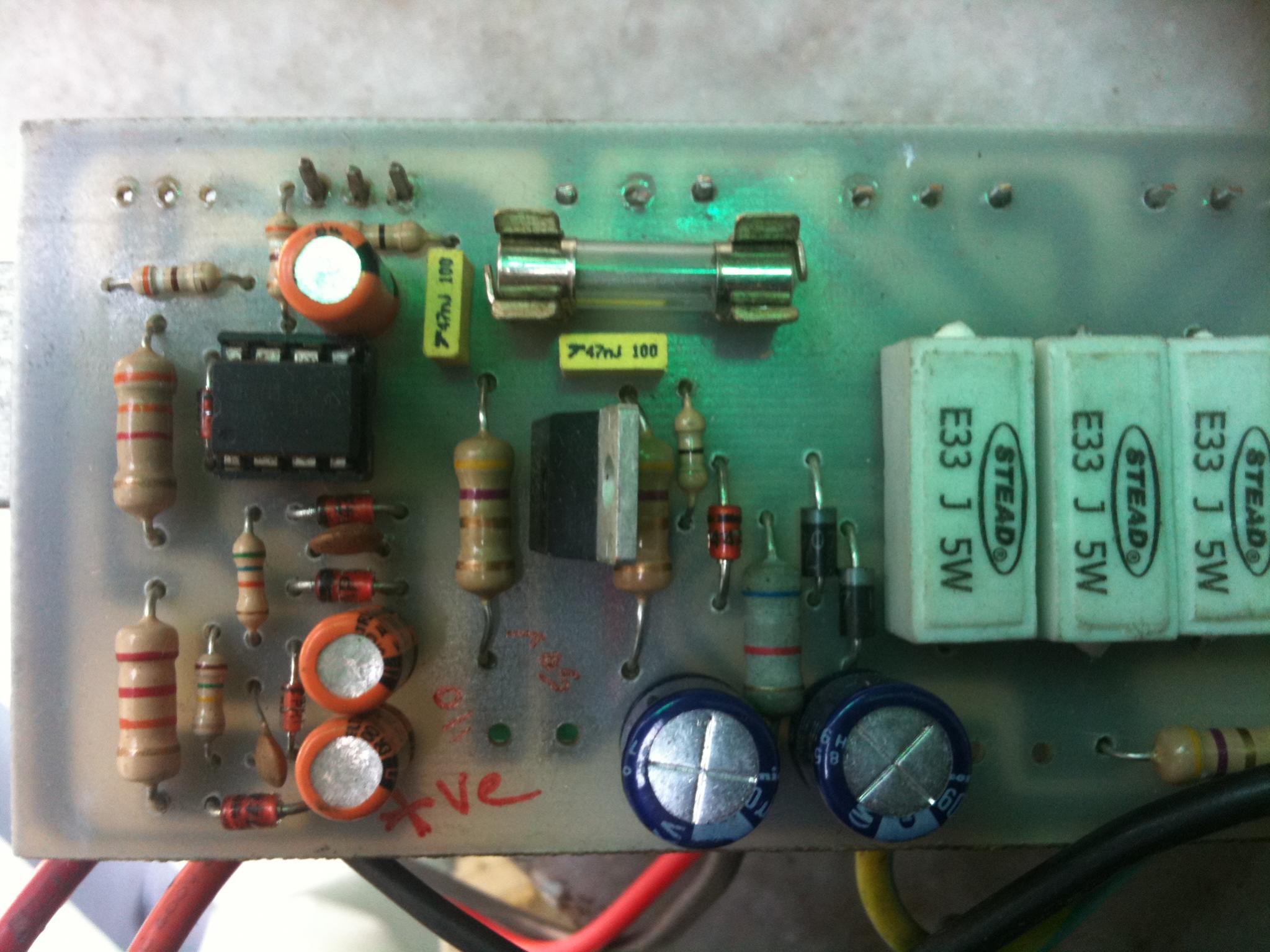

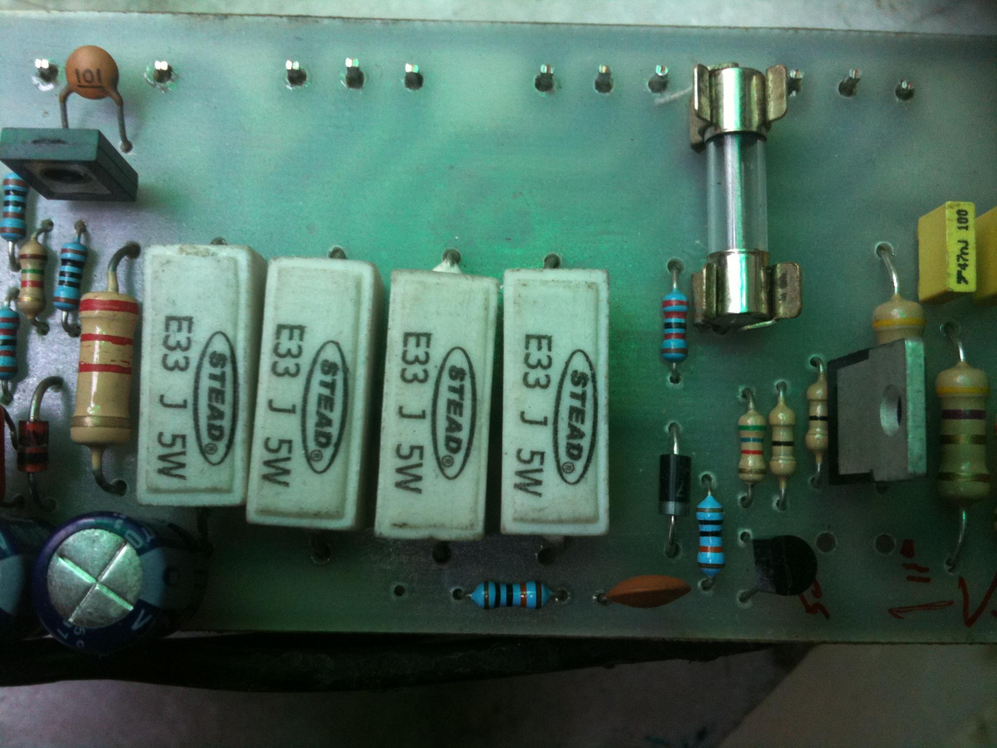

Hi Apex
Hi apex.
H900 watt project is very good. It really works very well and as well as output is very Punchy and clear.
I am confused in one thing, may be this is a problem that u might know.
I need the step driver test up procedure.

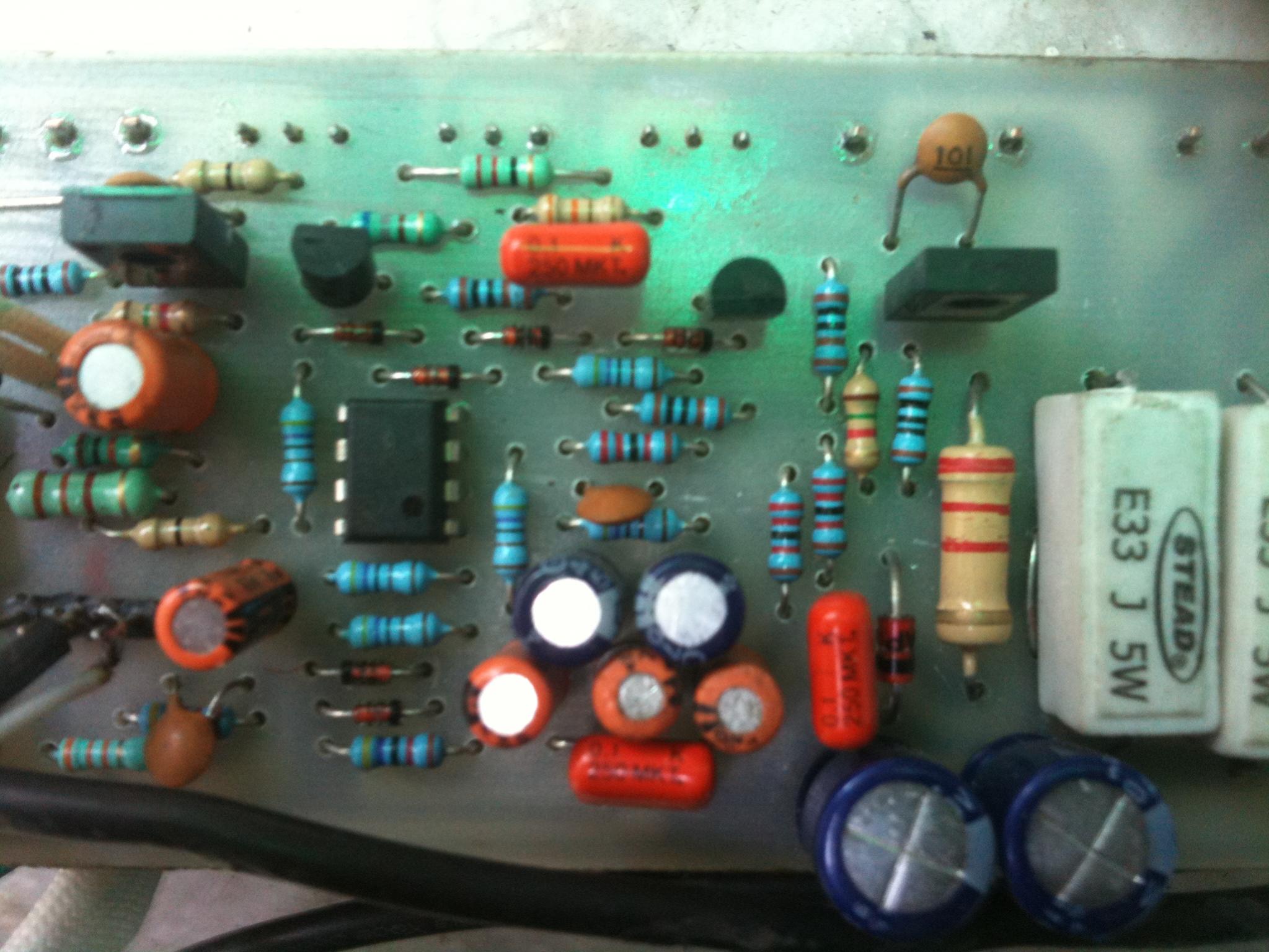

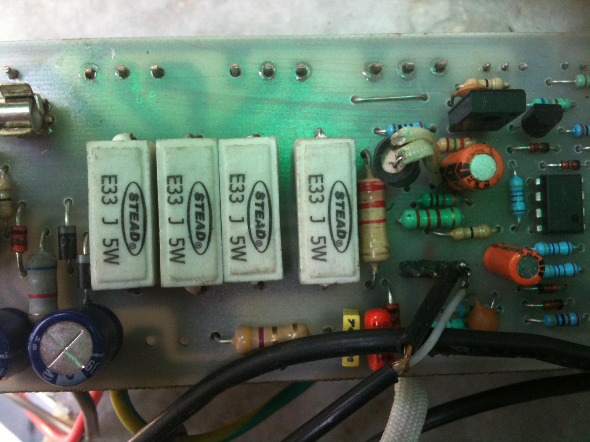

when we turn the amp on then the voltages on fuses are 55 +ve and -ve.
When we increase the volume voltage quickly goes upto 110 +ve and -ve on the fuses.
When we descrease the volume the voltage aren't goes down it remains the same on high voltages as 110 +ve and -ve on both sides. when we switch it off and turn it on again then voltages remain stable such as 55 +ve and -ve. but i think that the voltages should be vary with the volume controll. Plz help me.

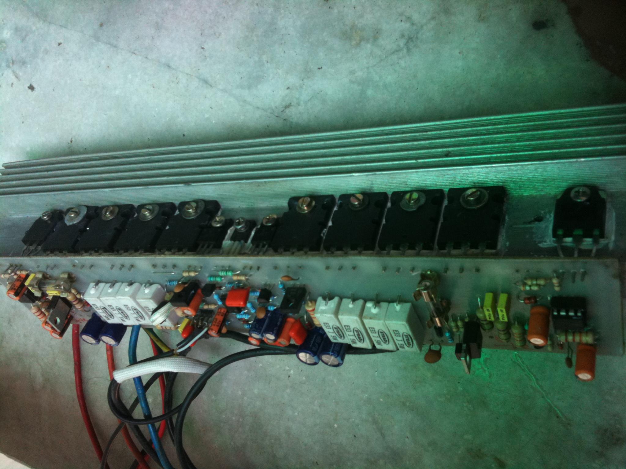

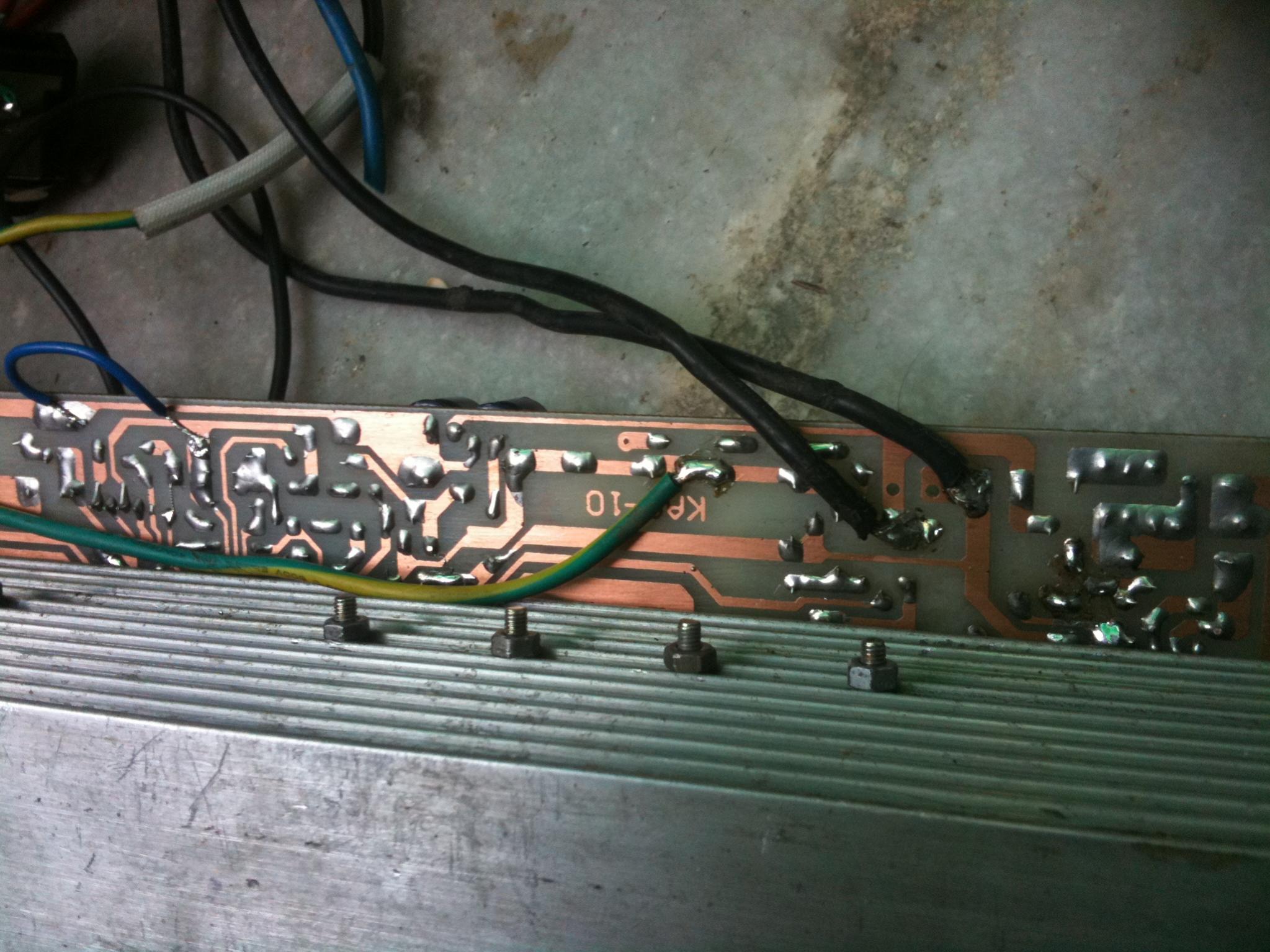

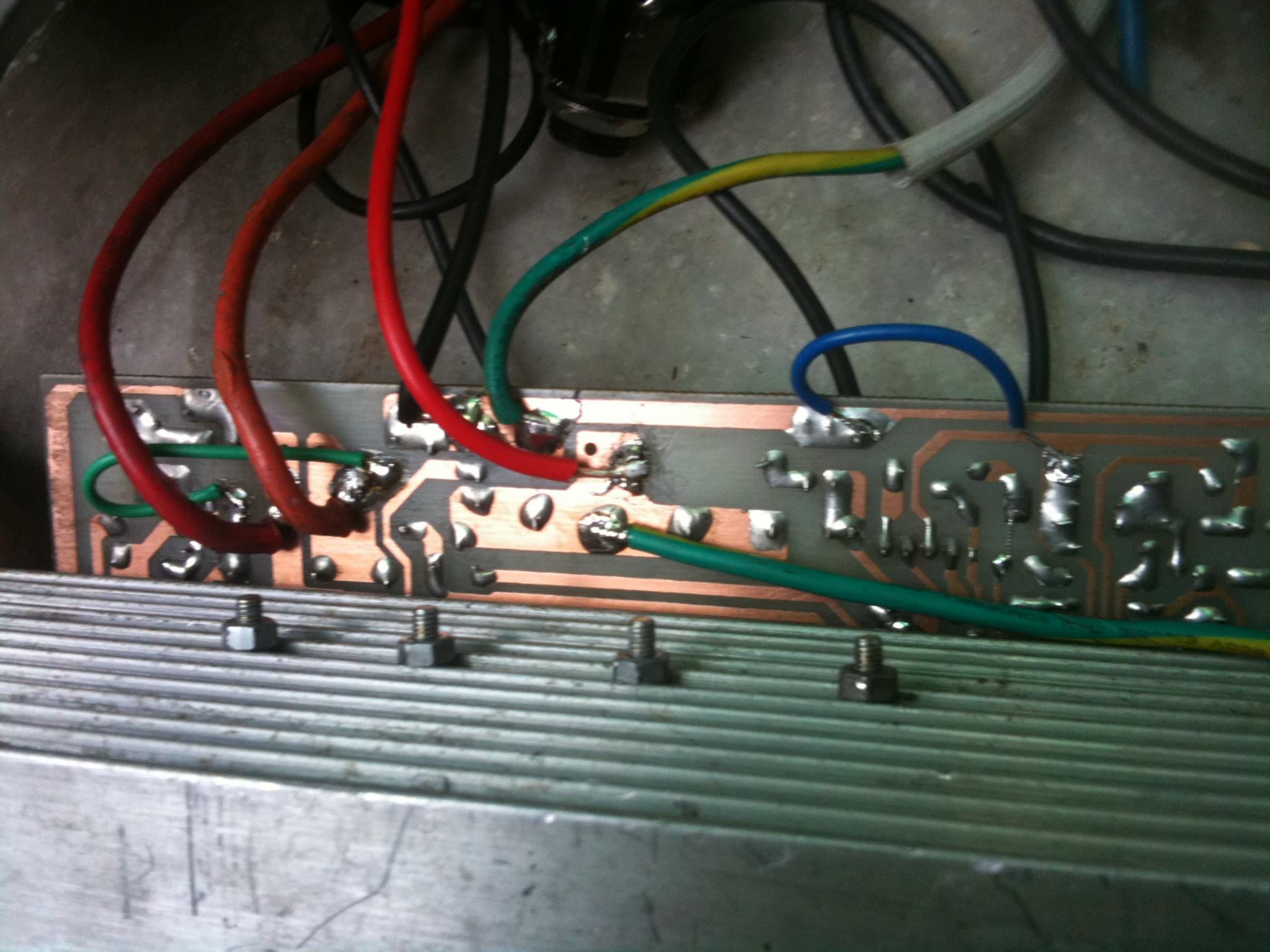

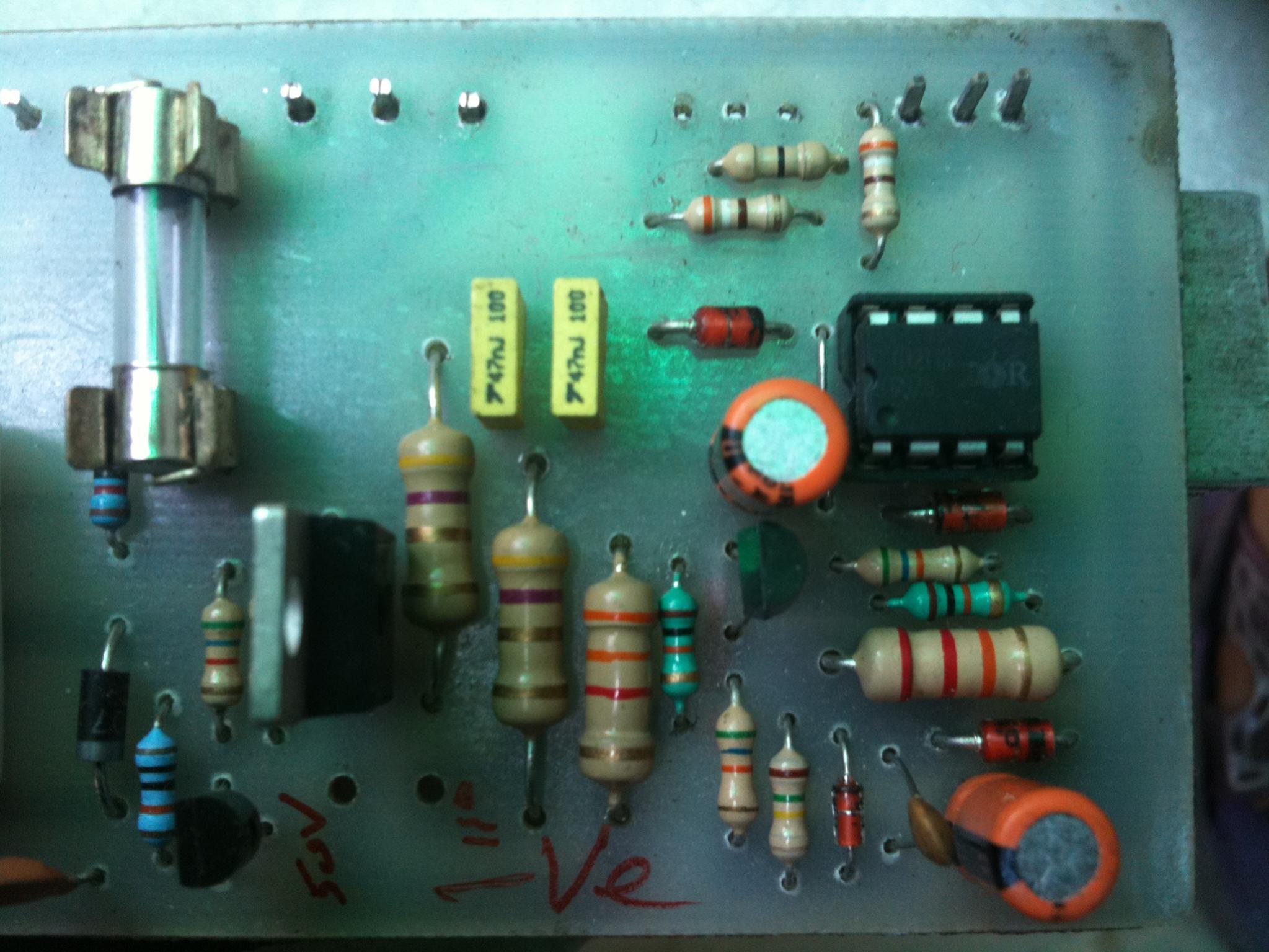

Voltage on the fuses is 55V, and if you measure with DMM, voltage in DC range can't be over 70V with high volume level, becouse step on 110V is fast and short, and you never can measure 110V on fuse. Something is wrong on your amp, can you post some pictures, maybe I can see mistake.
Regards
hi apex
Hi apex I attach the photos
plz have a look.

Hi apex i am using ssh70n10a mosfet it contans 70 ampere 100volt.
Blue wire in input ground. i connect direct to the PCB.
Output is clear no problem.
plz chk this out.
Regards
