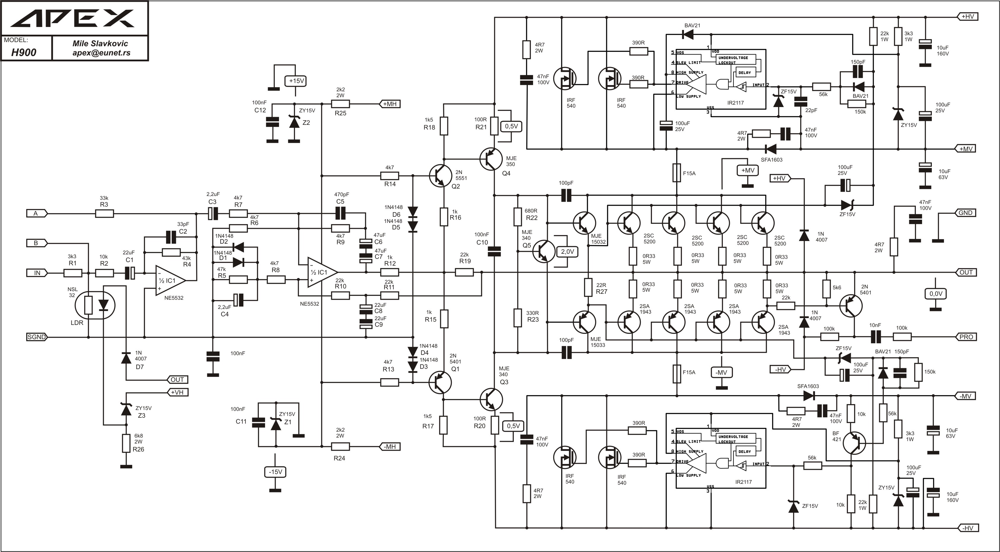

Hello sir mile,
I just wanted ask if use 0-55-110vdc bridge mode, how much AC V comes out....at normal clip...

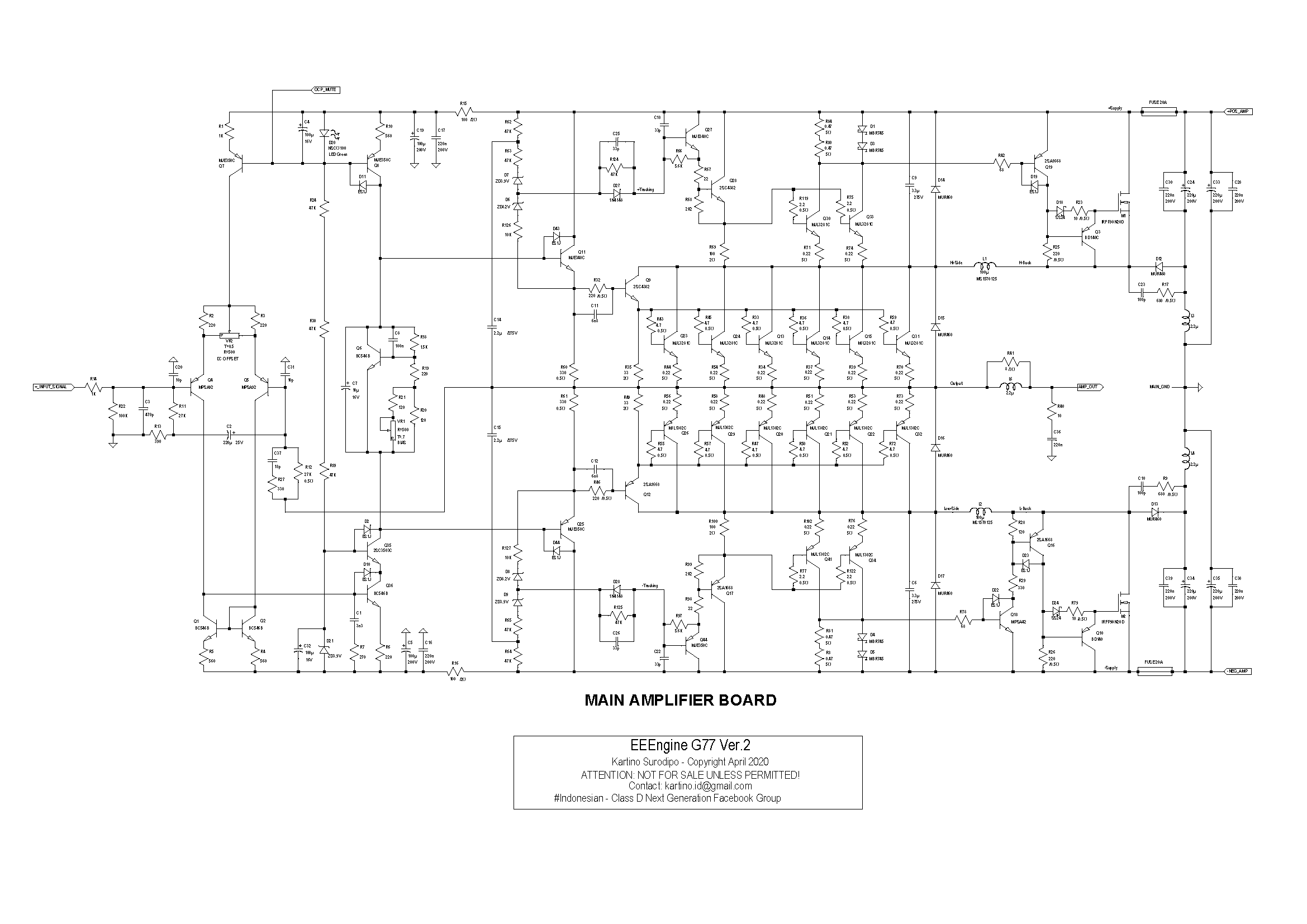

hi all the new td version by kartino .
have fun all
TD (TRACKING DIGITAL) & E-ENGINE AMPLIFIER
have fun all
@stewin,
you asked Yamaha for permission to use their design ?
for learning purposes

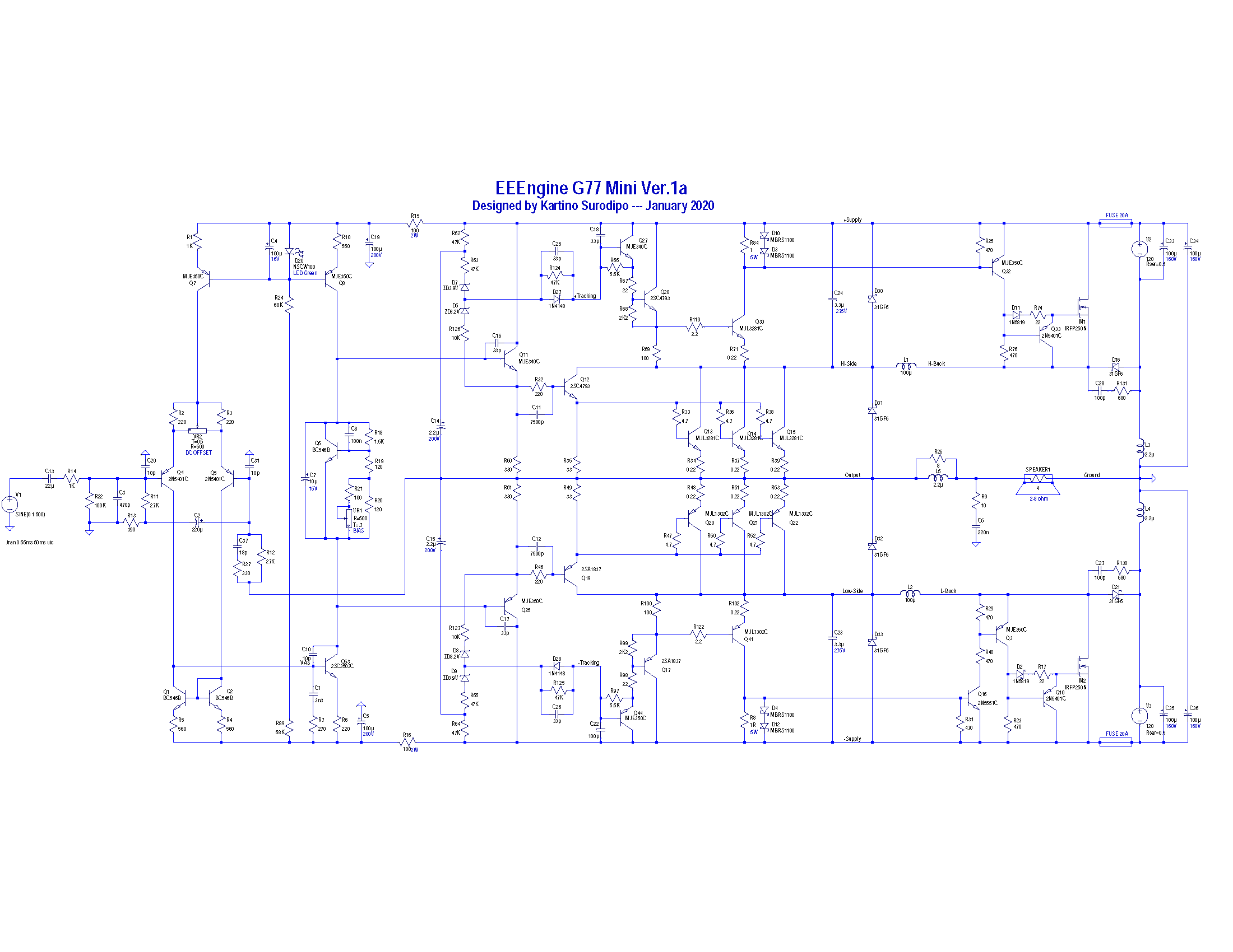

have fun all
updated version by kartino
EEEngine
have fun all
Stewin,
please upload the lt-spice file if possible.
Thank you!
Sir Mile, what is going on? H900 bridge mode, just 20 Vac but spkr pump good but.....
Your step driver not work, there must be 40vac on output.

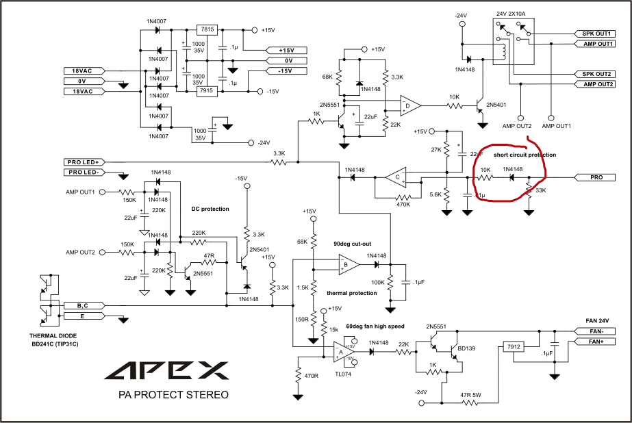

Mistake Pa protection

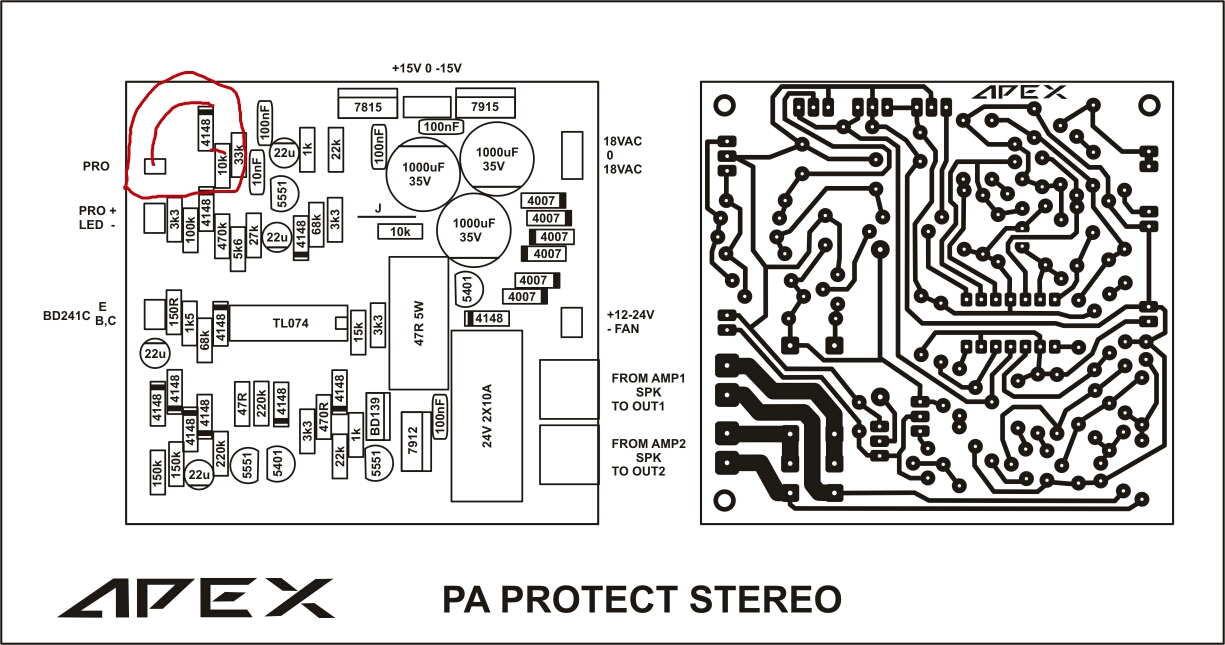

Hello,
Sir Mile, i found a difference between the circuit and the PCB of Pa protection.
Diode 4148 surrounded in red is connected in the circuit with the anode to the "pro" output of the amplifier. On the PCB, this diode has a cathode to the "pro" output.
Which option is correct or do both options work?
Hello,
Hello,
Anode to the 'pro' is correct.
