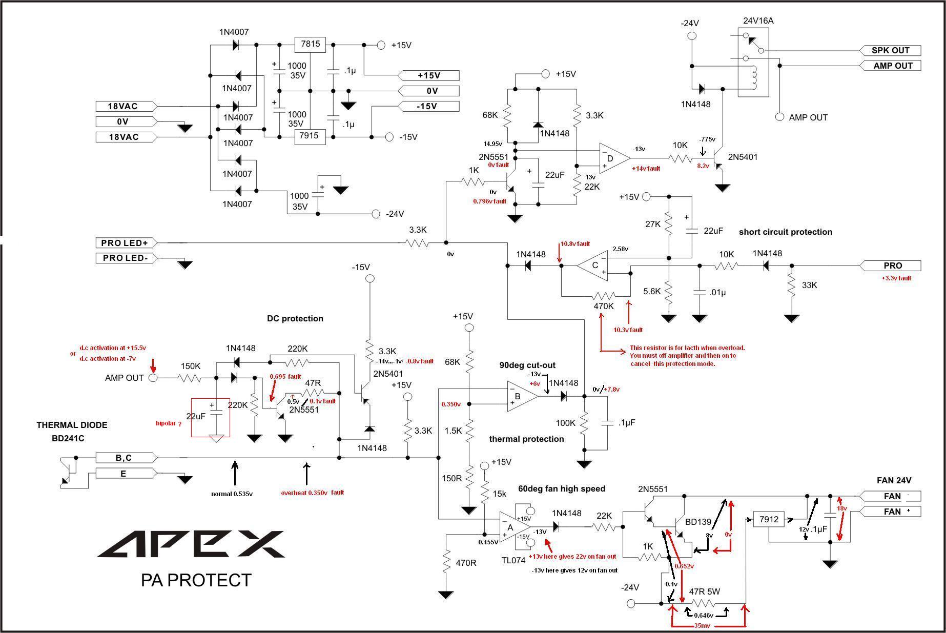

I want to modify this in order to lower the d.c protection at about 1v d.c on loudspeaker out and the pro inp suitable to a hi-fi 100w amplifier or so.
PRO input can be trigered from overload detect circuit with AC signal (B500, H900) or DC positive (AX16, HV23...) and it's power off/on reset.
DC protect can be trigered with +/-1V DC on amp out and it's auto reset.
Regards
I don't think so,i have test this with a variable power supply with an 20 turn potentiometer and it is necessary to attach +15v d.c in order to come in protection mode.
I suggest this modification on circuit.

Thimios, adjust the 22uF downwards.
Try 20Hz input and check that the circuit does not trigger with maximum 20Hz output.
You may want to try it at anywhere from 10Hz to 20Hz for no trigger.
Keep making the capacitor smaller until it does trigger, then go back up one value.
You may find that 220k and 1uF is a filter value that allows the circuit to pass a full power 20Hz. That allows an MKT capacitor. For 10Hz you may find that 470k & 1uF works.

Hi AndrewT, you mean that this will be tested to an amplifier at max volume when input signal is from a function generator?
What signal?
Sinusoidal or square wave?

This was tested this afternoon.
The protection board was connected to an amplifier output .
Amplifier's power supply is +/-50v.
Generator was adjusted at a level that amplifier gives 28vrms on a 7R dummy. Frequency adjusted for 20Hz sinusoidal.
I ended up with a value of 2u2 .This is what i see for a correct value.
Pushing amplifier harder (hard clip) protection activated.
I must mention that with 22uf the protection never was activated even with very hard clipping.

Now try 18Hz, and/or 16Hz, and/or 14Hz.
Does it trigger?
Does it trigger at a lower output voltage?
Are these lower frequency triggers acceptable to you?
BTW, you don't need the 7r0 dummy load. The detector is only detecting DC and very long duration
portions of the output voltage. It is not detecting current. That is done in a different part of the protection system.
