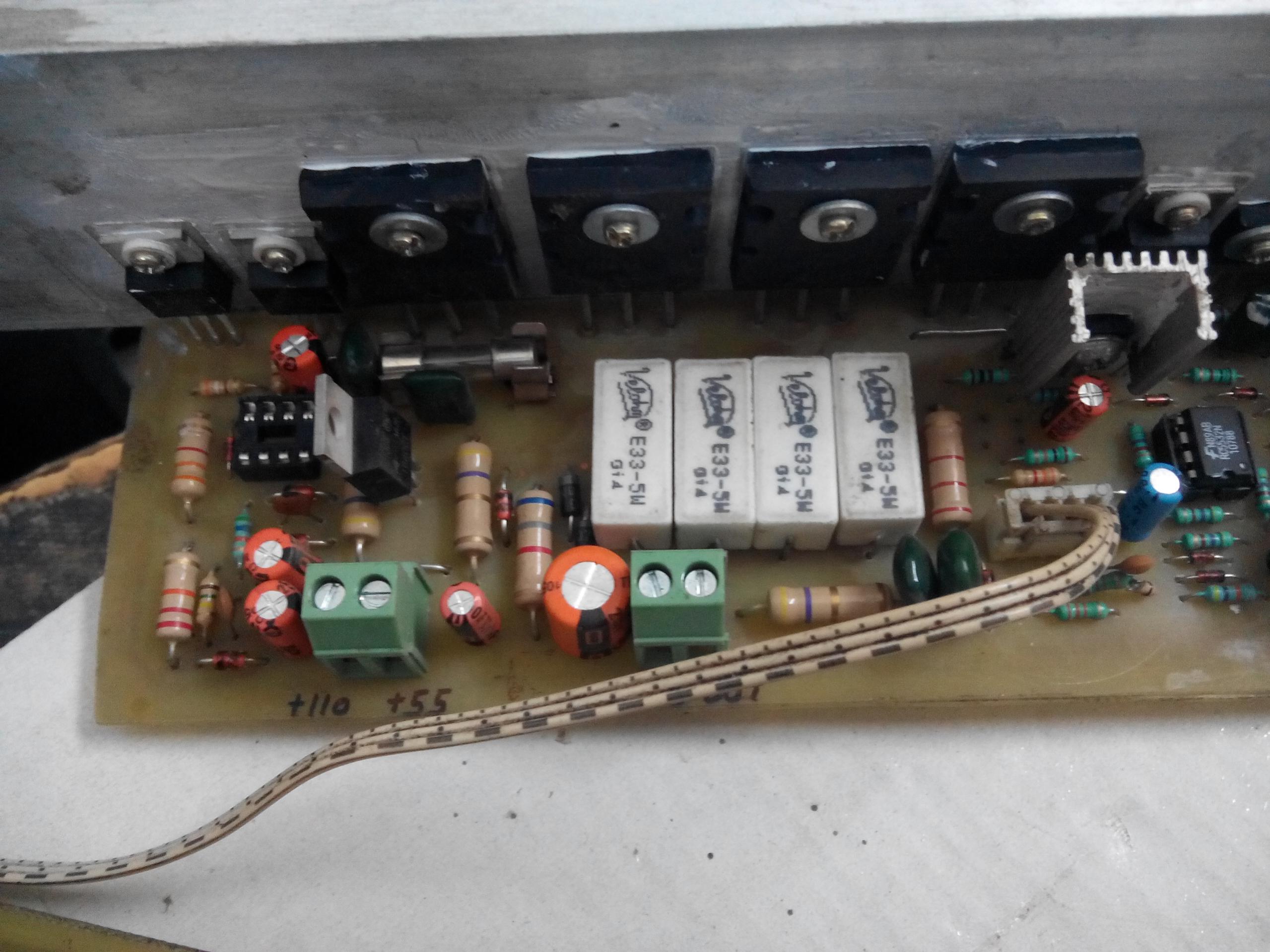

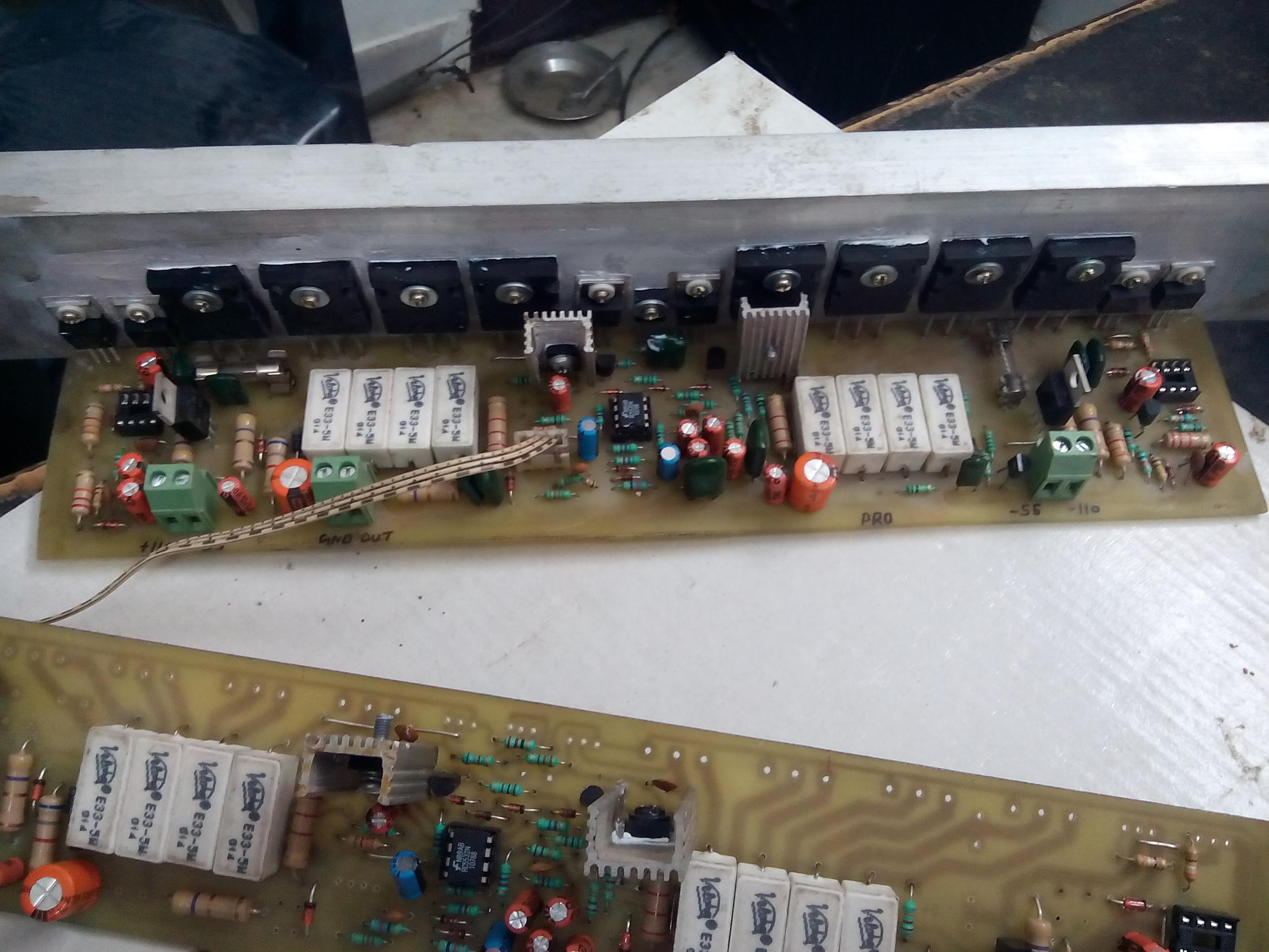

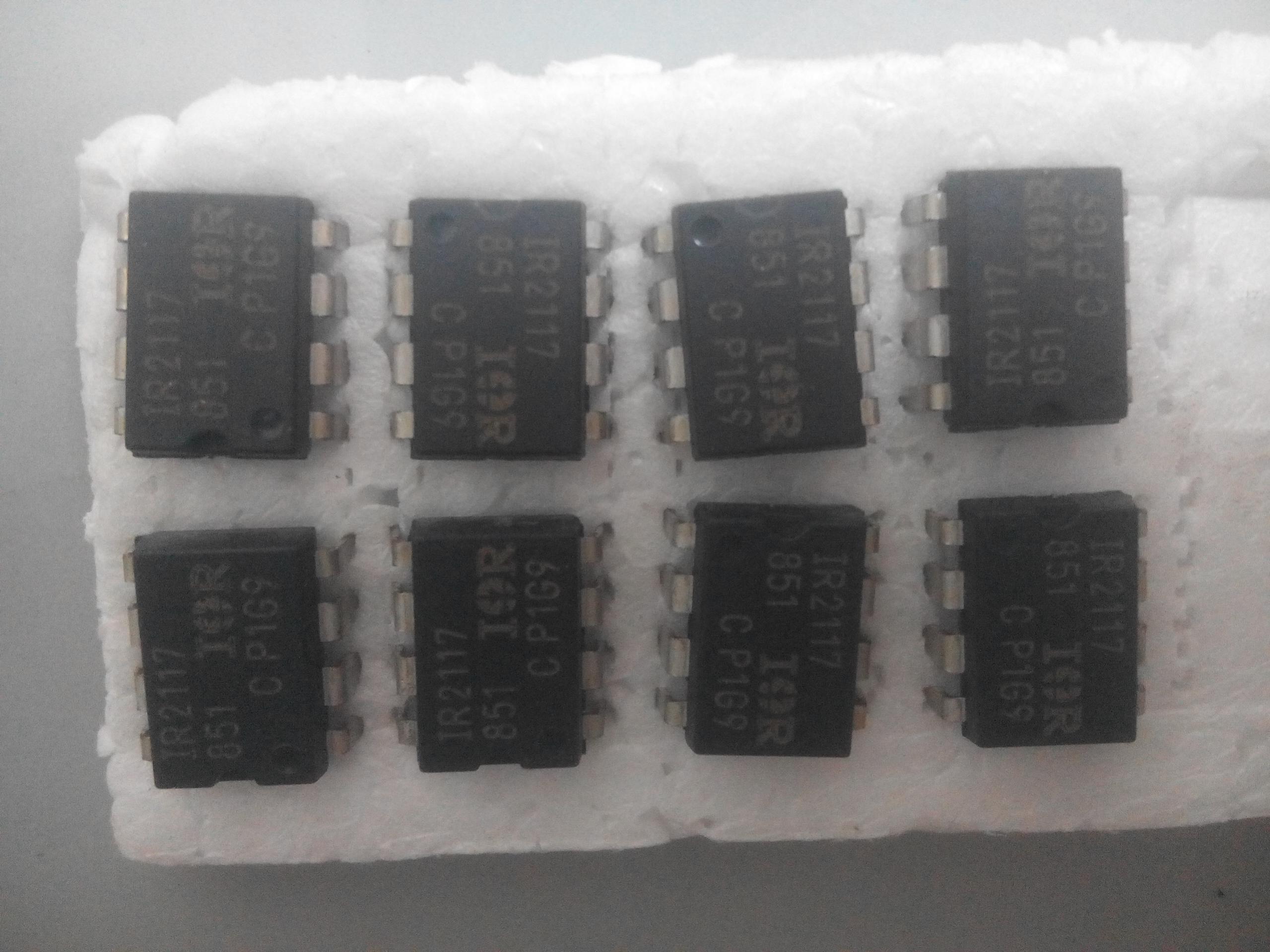

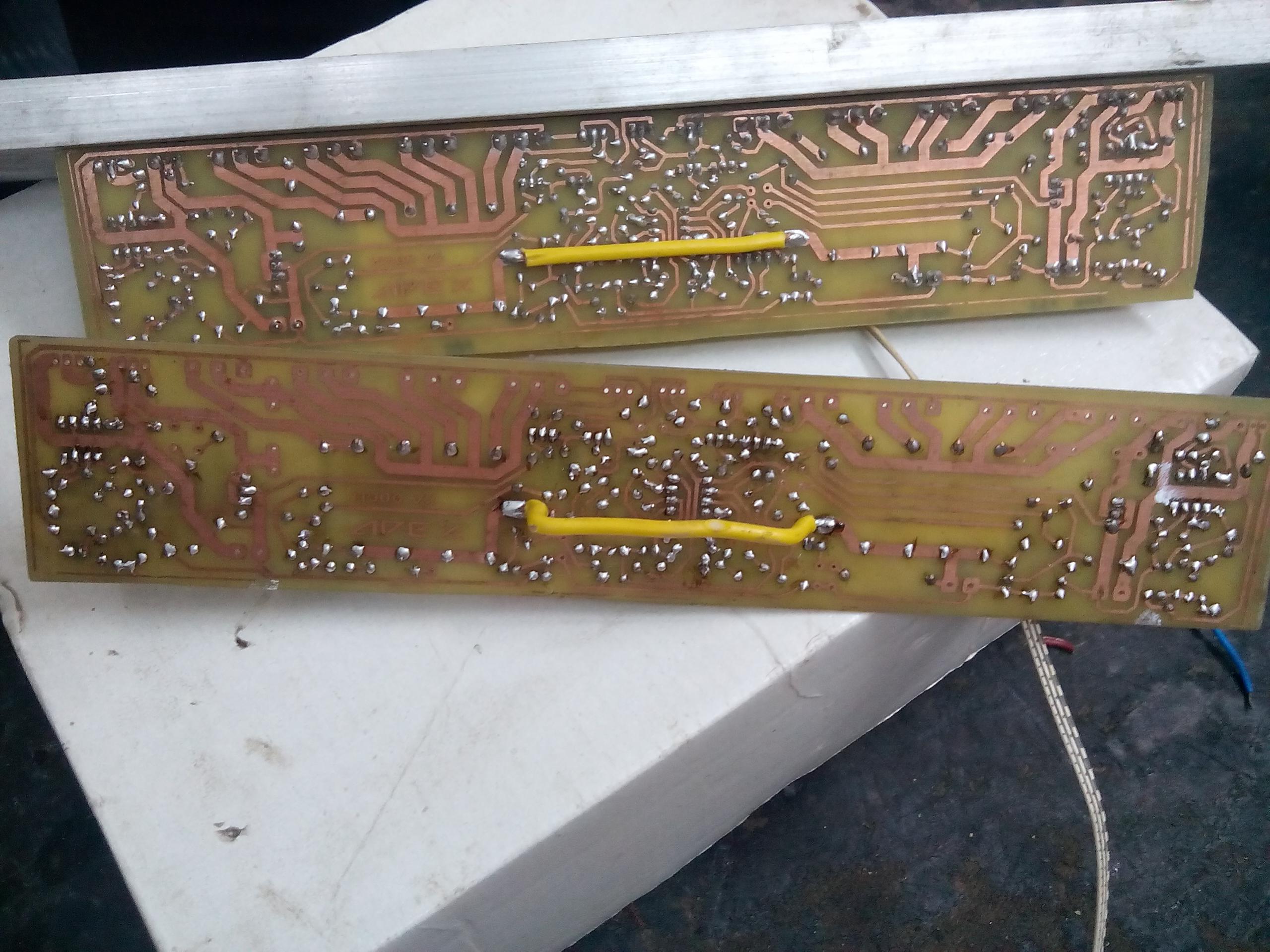

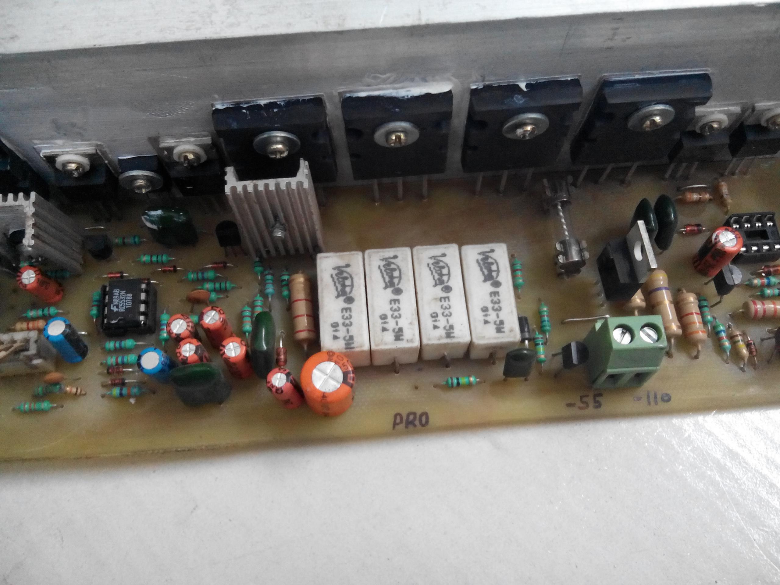

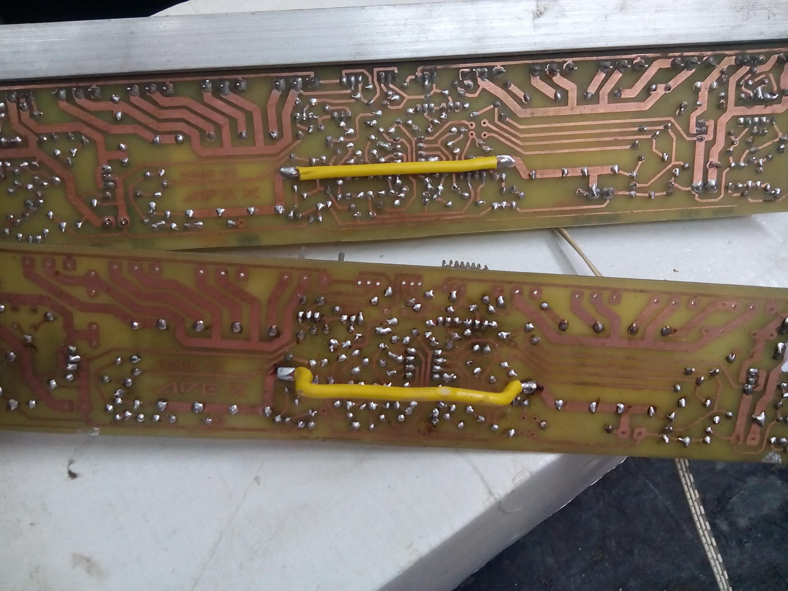

some progress.one channel work in ab class on +-55 because he is waiting for ir 2117.sound quality is best as i know because it has label APEX on it.

Nice work,

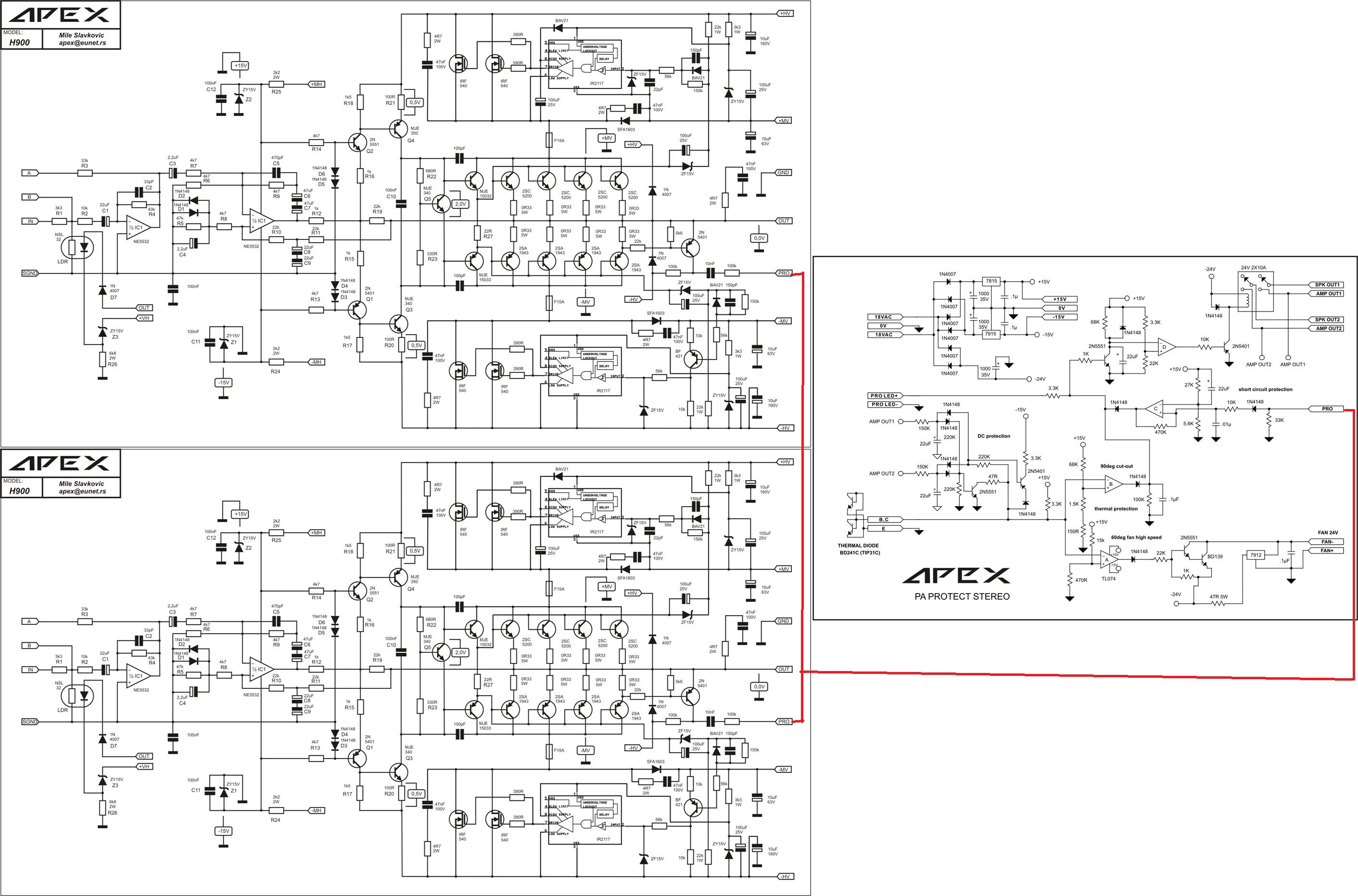

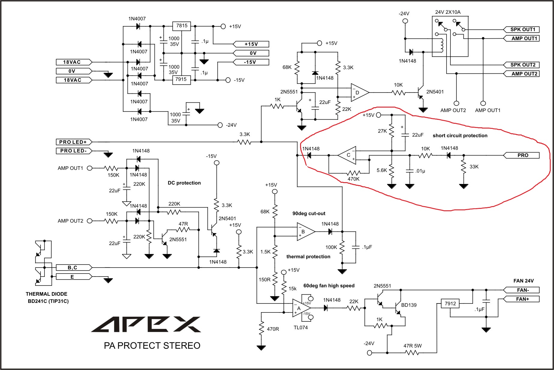

sir mile can you show by way of drawing how the short circuit protection for channel 2 is intergrated to this schematic.Use this circuit for stereo, only add DC protect for channel 2. If you have two heatsinks add BD241C(TIP31C) in parallel.
Regards
regards
hi, today i check my h900 output voltage.excellent result.input 50hz sine wave output more than 70v.my clip led glown at 62v.thanks to sir mile.i want to tell more about sir mile ,everybody also know it already.his response is quick than anyone and more friendly attitude.

hi ,thanks apex sir i knew that you cann't be wrong.there is some misunderstanding.anyhow i made my h 900 v2 without any probelm even amp start at my first attempt.i want to thanks to apex sir,aman khalsa,sandeep,wattaniya.perhaps i did a mistake that i make my toroidal near 2200 va.this is too much for h900 stereo because i check with my meters amp never take even 4ampere at good load.thanks again.

hello sir Mile is there a way to connect the circled area to two seperate channels since the original design is for one channel? and if possible edit the schematic to show stereo connection.
Connect PRO from two channels in parallel
