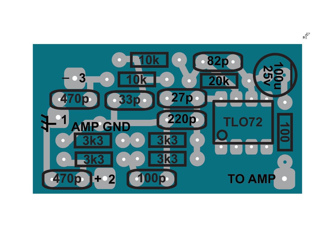

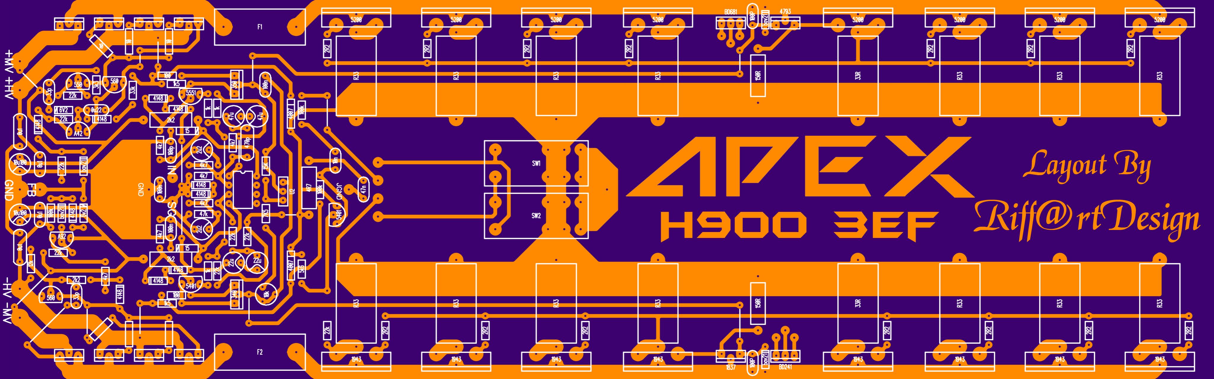

I thank APEX previous to this. I tried to re-draw for speaker protector without changing the value of the components and just change the type of Relay with other models. if you are interested in the image that I created, you can send a message to my email at damanhuridalimunthe@gmail.com for this project.

hi Damanhuri.
nice work,
if u don't mind pls share the top and bottom layouts in pdf.
hi riff
good work,
what is the size (cm) of the layout?

hi nazirdigi if i have no mistake is about 332x104mm...hi riff

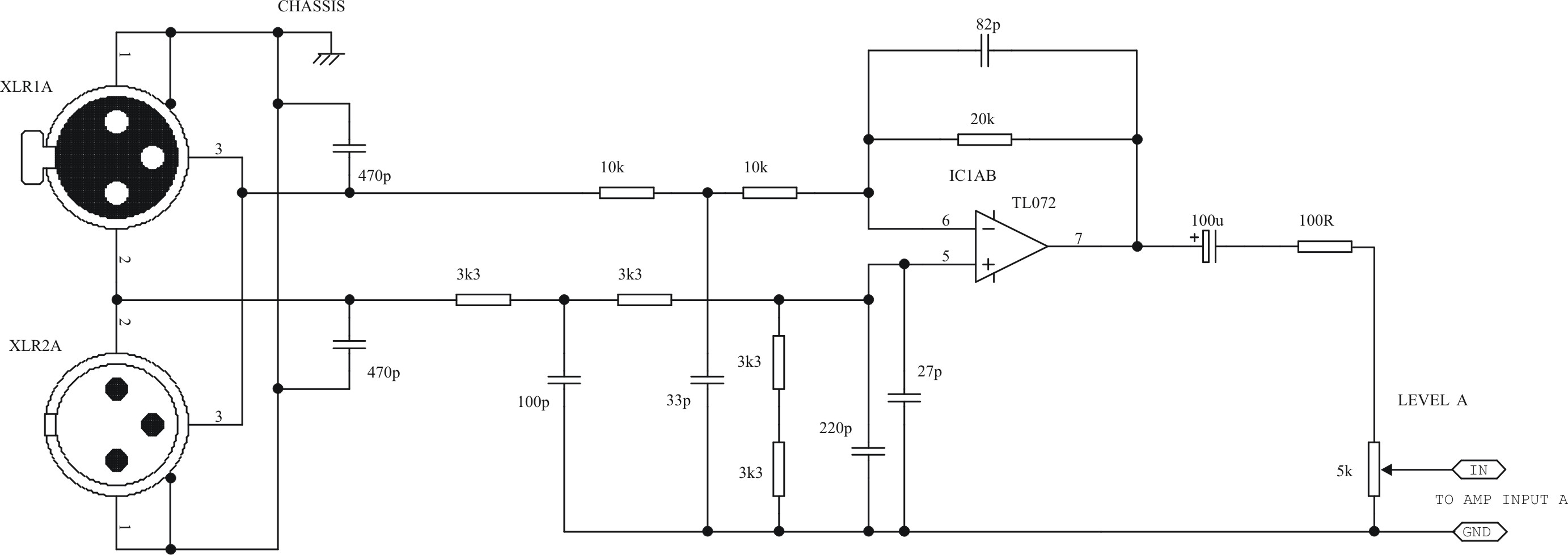

hi nazirdigiHI APEX SIR.
to xlr input what is the voltage to provide to this schematic?
i think +15 to -15 is enough
