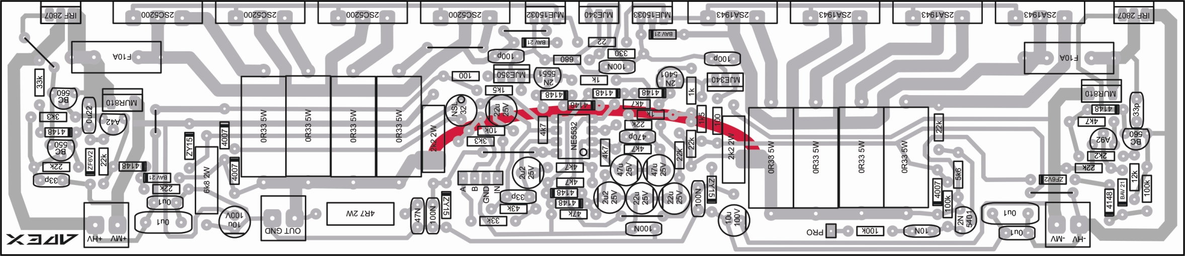

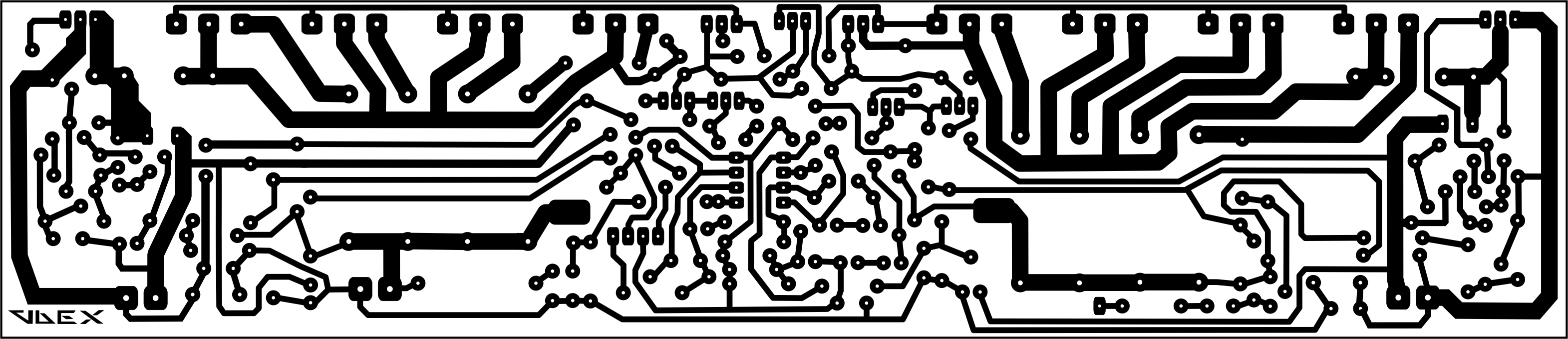

Pcb layout on this same page post #2213
no i didn't try that circuit.
apex sir not share that bottom layout.
how did u get the bottom layout?
can u share the bottom layout.
Sir, it's not the Pcb layout post #2213 , no Opamp in post #2213Here you go
Sir vedmitraa were is a fault in component value of negative side ofswitcing circuit. Or were you have corrected, hope you understand my bad english.
regards.
regards.

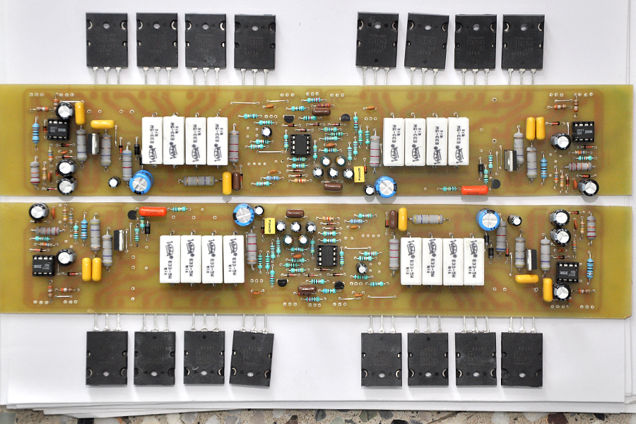

traffo for H900 Brigde
sir mile.
i have duild H900 and u saw that on FB. now i am thinking about H900 Bridge. i just wanted to know about transformer .
maximum VAC. maximum KW. And the filter cap?
sir mile.

sir mile. how are you?
My second H900 almost done, just waitinf for your reply about transformer for H900 bridge?
Nice work, use 2kW transformer 4x30vac for two H900 in bridge.
