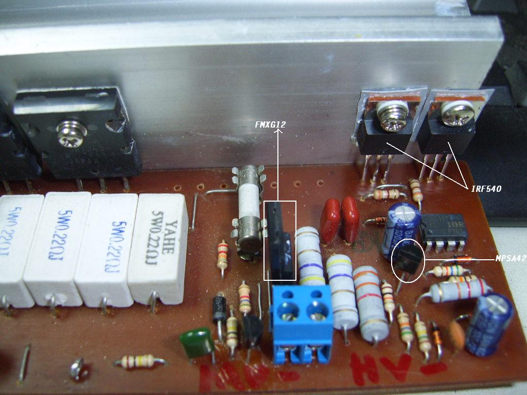

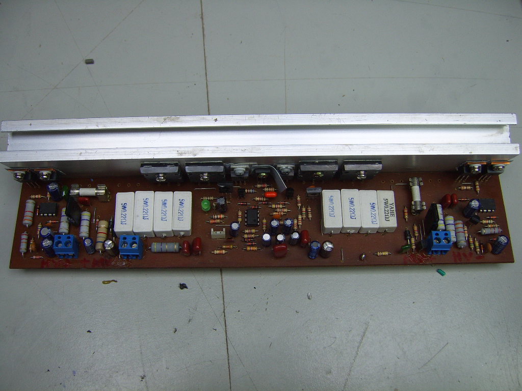

sir irvynejay here the pic of my h900

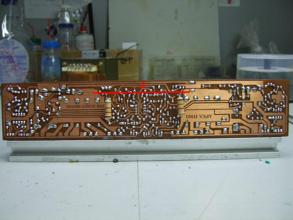

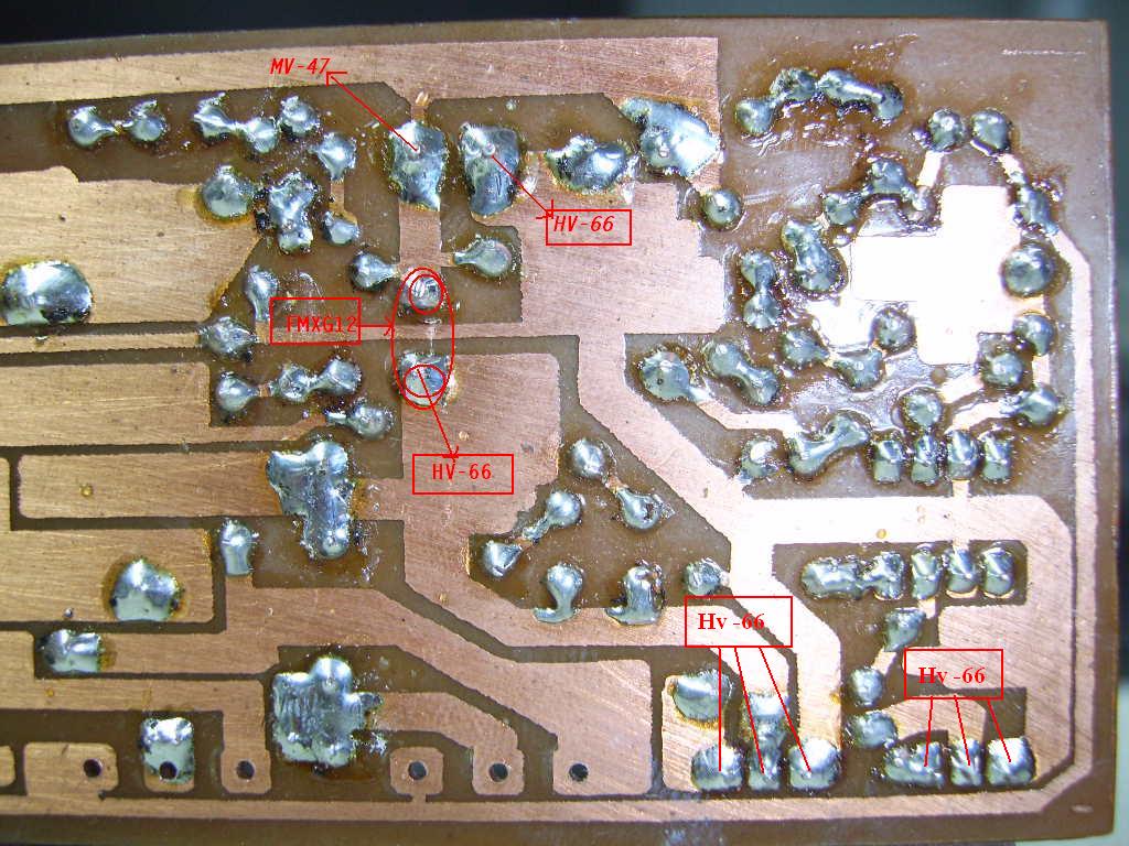

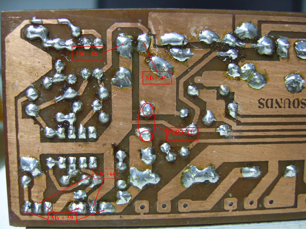

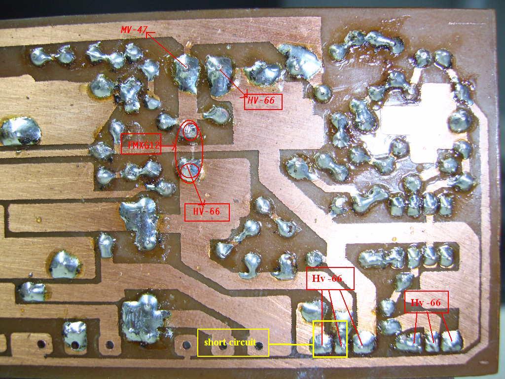

thanks irvynejay, and i want share this problem, to help some diyers to be careful of there project and double check, my circuit its look good or no short, but when i check it by tester totally short circuit, please see my attach pic. thanks w/ the help of sir irvynejay and sir apex,

thank's Irvy,..my h 900,.. transistor mje 340 and mje 350 is hot.,.my rail voltage is..80 40 0 40 80 VAC,.whats wrong for this?
