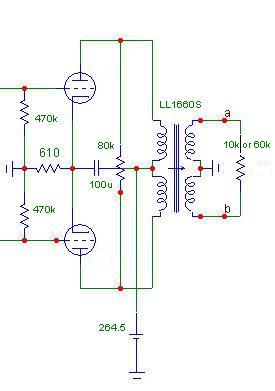

hi
If so, model of 12b4a are definitely wrong or the interstage
trafo has to be modelled as a nonlinear core.
At 1% distortion level, I obtain 135Vrms and 200Vrms (V(a,b)) with 10k and 60k respectively loading the secondary.
max 12b4a grid not positive (with respect to cathode) but near 0 volts.
circuit like the following
Federico
I was lucky to get 45Vrms of fairly clean signal out. If a 60k resistor replaced the 10k, it was no problem to get an ultraclean 100Vrms.
Federico

yes
divide by two my values so
100Vrms and 68 Vrms (60k and 10k)
so the difference is only with 10k load.
but putting the 100u cap between CT and ground decreases
dist. so 100Vrms , 0.2% dist with 60k. This does not
work if load is 10k: dist remains .9%.
What do you mean with
"great distortion when grid is driven positive" ?
How much dist?
Bye
Federico
How much dist?
Bye
Federico

Then, I find differences between loading before the primary or after the secondary of the trafo ( a part from the different reflected resistance).
If I load the trafo before the primary the it is almost not loaded and I find better freq. response and less resonance problems.
So, usually I put a main res between anode (i.e. the 80k res)
and a bigger one ( that practically does not load the trafo) at the secondary (e.g. 470k).
Federico
