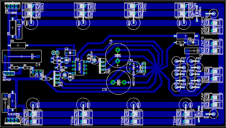

Well, I took the caps off that I added from rail to gnd...
I thought I might not have to make a new board....
However, now I'm getting alot more oscillation than I had before....
seems to be less with the tl072, but still not good... around 25Vp
I haven't picked up the ne4558 yet...
I tried grounding everything to a single point, but that didnt make a difference....
I think it's time to start over... this board has become a bit of a mess... good learning experience however...

Wow. I guess you really WERE listening. Cool.
I can't really decipher the area around the opamp, too well. Sorry. I guess my eyes are getting worse than I thought.
But it looks like C1 and C2 are connected, which might mean that the resistor that was added between the junction of R1/C1 and the inverting input was omitted.
Also, I don't see the connection from R2, C1, and R14 to the star ground, which is also where you could leave pads for an optional ground-separation resistor (wire jumper if not used). Oh wait, I see it now, I think. R14's is separate, way on the right. And R2/C1's goes under the resistor behind the regulator. I guess you might want to break both of those paths and make pads for two ground-separation resistors. Then again, you could always just cut them later, and 'surface mount' some resistors, if it became necessary.
I can't see it well-enough to check a lot of the rest of it.
It looks like C2 doesn't go straight from the output pin to the inverting input pin. So is the added resistor, that I thought was omitted, stuck in there, accidentally? Or is that how you want it wired? In my schematic, the input connects to R1, then C1 goes to gnd, then there's the added resistor, then C2's junction with the opamp's neg input.
Also, there should be another small electrolytic capacitor for each regulator, from each regulator's output pin to its ground pin.

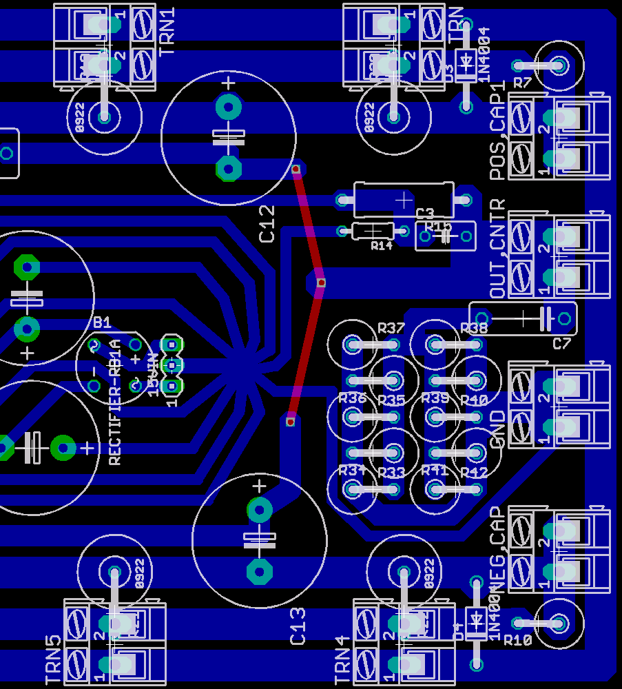

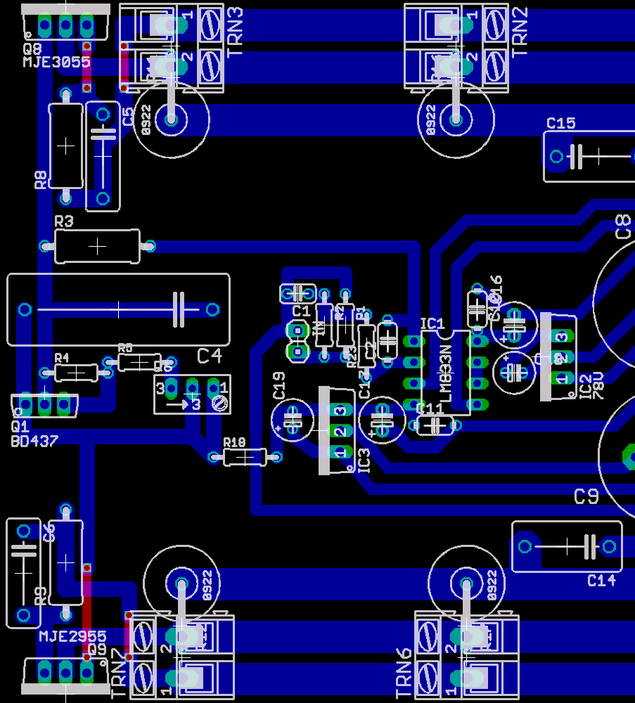

Going to try and post it as a pdf...
I added/changed....
fixed input...
item 7, parallel caps on board, not as close as they should be to the right side...
added vias and wires, 6 of them...
added electro' caps from regs output to regs gnd...
moved regs closer to opamp...
A few notes, in case anyone was wondering...
a)The connectors for the output transistors will not be used, I just used the footprint for convienince...
b)The resistors above and below the previously said connectors, will not connect to the connectors... but will connect to the transistors
Is there anything I might have put too close? wires, components, etc.. that might cause interference?

You should move the feedback resistors closer to the opamp to minimize capacitance at its inputs. Also you might want to reconnect the low voltage power supply so that it's center tap current doesn't flow through the star.
I'm wondering what is needed for bias stability for this amp - does the bias transistor need to be on the same heatsink as the drivers? I guess it isn't very critical if it is biased in AB+B but if running quiescent current through outputs it might be needed.
I'm also worried about the connection of the emitters of the driver transistors to a dirty ground and the loop around the card. I'd say:
1. Move C3, R15 and R14 to the empty space above the opamp. The ground trace that goes to input is perfect for R14.
2. Ground of R8//C5 and R9//C6 to star ground instead of making that scary loop around the card.
3. Optimally charging pulses for LV power supply should be kept out of star ground - but the worst that can happen is a little hum so this isn't very important.
4. Don't use separate ground returns from the regulators and their output decoupling. This leaves some more space for driver returns. The noninverting input of the unused opamp doesn't need it's own return either, connect to the ground just below.
The connection between clean star and dirty ground looks like it might work. Chassis should probably be connected to the GND terminal block together with speaker return to eliminate ground bounce due to capacitive currents from the output throught the transformer.
