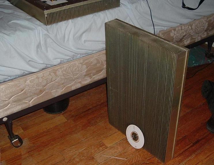

Ah yes, I'm still trying to figure the proper heatsink parameters to make it accurate. I knew my data wasn't completely correct. But I do have two massive heatsinks and plan on attaching a cold plate to the very top of both. This would allow me to make single chassis for both channels, but the PS will have to be separate of course. That sheet is very helpful for someone like myself who isn't into formulas, so I thank you.
cold plate
-john
cold plate
-john
Around here the plans change on a minute by minute basis. That is what I have my Aleph attached to currently. My initial Aleph experiments were with those big boxes I built a while ago. By themselves those sinks are much better off with forced cooling. I was dissipating 700 watts on one of those with a high speed fan on it, and it was cool to the touch. By placing a cold pate on the top of any sink, aren't we effectively raising the efficiency of sink exponentially? With those big sinks, I would probably still need a fan, but I can run it slowly and quietly, couple that with a cold plate on top and I could dissipate as much as I want, I would imagine.
edit: 5 fins/inch
edit: 5 fins/inch
Which one would that be ?
The lowest "theoretical" die temperature would be 50-55C, depending on the ambient temperature.
A heat exchanger can only function with a temperature difference, therefore the cool plate will be hotter than ambient.
By controlling the waterflow the cool plate temperature can be tuned, just regulate the waterpump speed.
