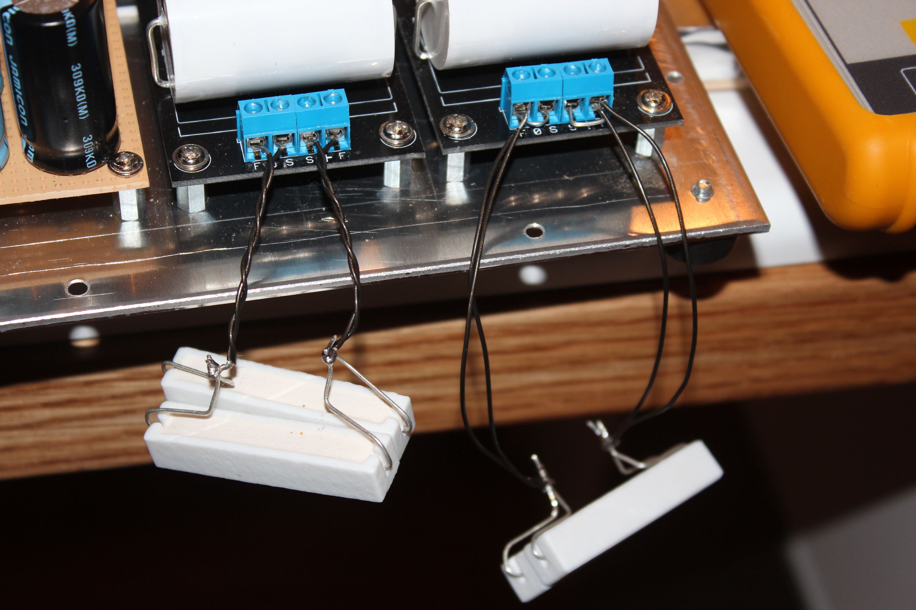

Before I contemplate over what you just say I did some DMM measures below.
Its suspiciously same level for in and out now, it could all be riding on the ground loop. Dress the long output cables in twisted pairs. Force pair, sense pair. Remeasure. Null the sense pair by jumpers at F0,S0 F+,S+. Remeasure.
Left shorted (damn unpealable old Ericsson phone cabling:smash:) and twisted, right jumpered.
75 mV left and 76 right with DMM
The cables are much shorter than I thought from the first photos, but keep them twisted in any application short or long to load. They are not the problem it proved. One check less.

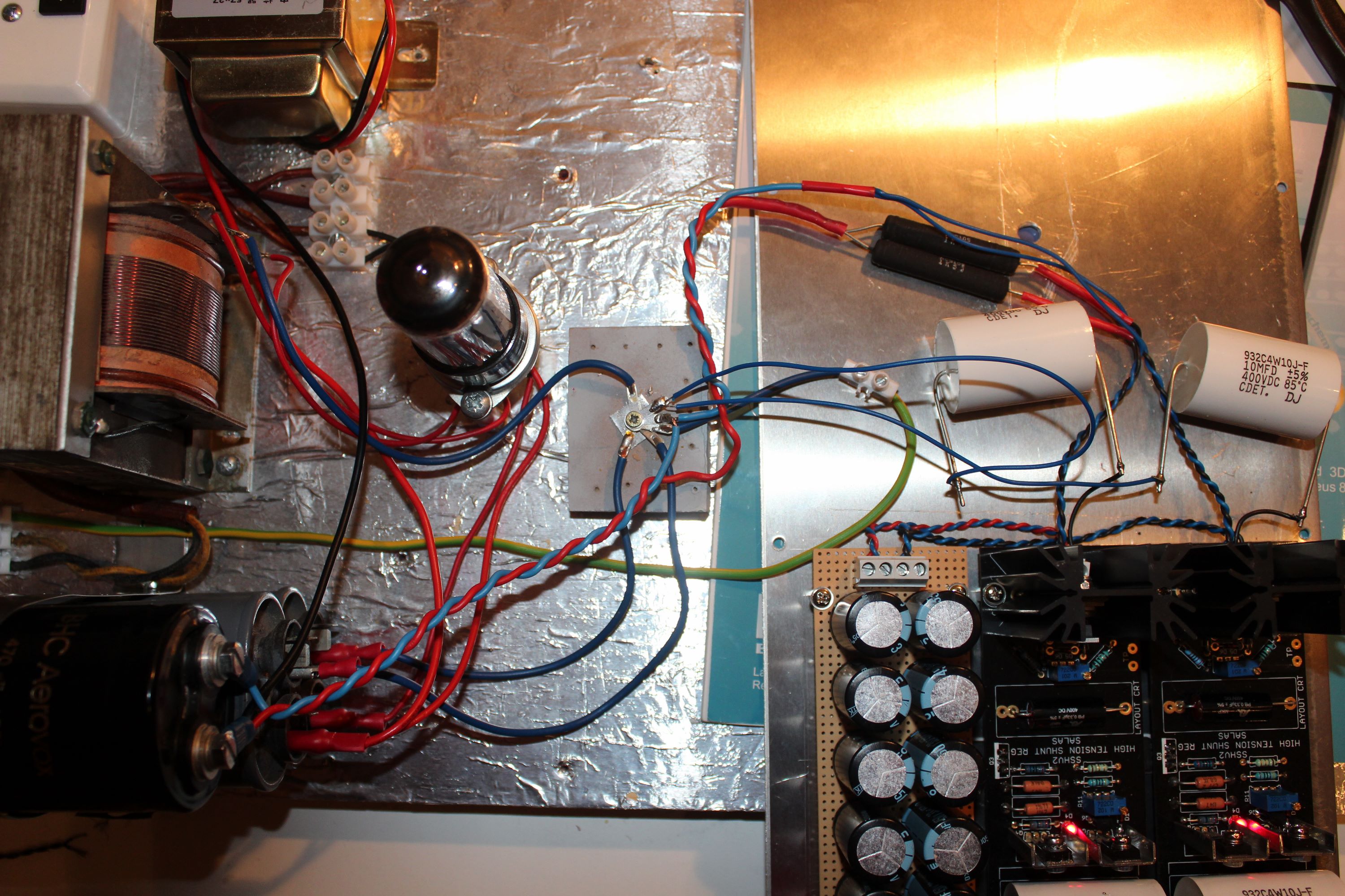

I rewired a bit on the ground scheme. I had put a choke on the gnd rail b4 also, just to see if I had problems there. Now I got rid of it and every single gnd line is on the same star now. Same measures.

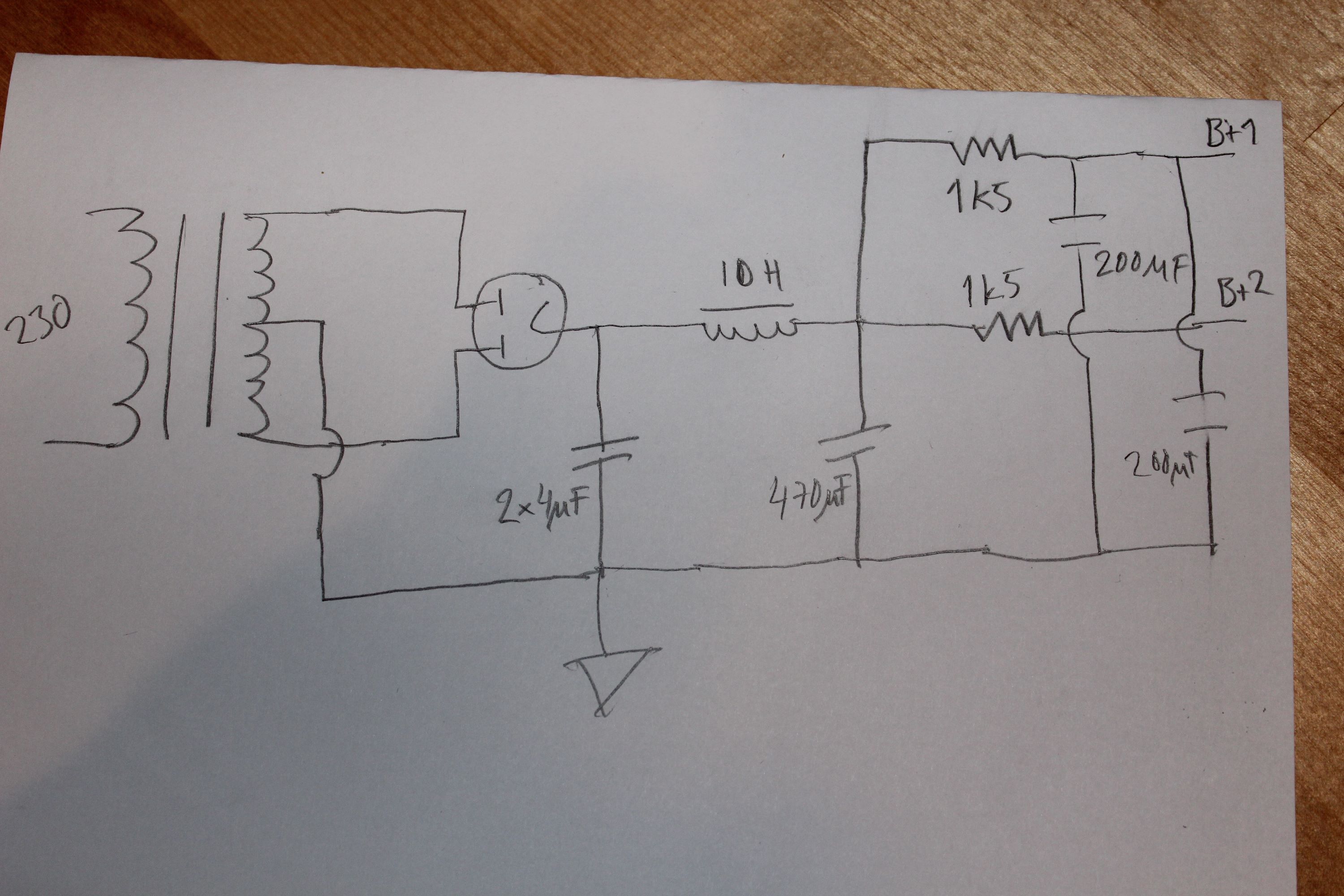

How does it heat up the diode valve and how is wired for that? Why B+2 has no output cap? Why I saw a star like GND node in one of your pics and I see just a serial return wiring in your diagram?
Its dual diode, 5AR4, new tranny has 5 V winding, yestedays had 4, thats why I used AZ1. I miss-drawed the schema, ofc both outputs has one 200 uF each.
