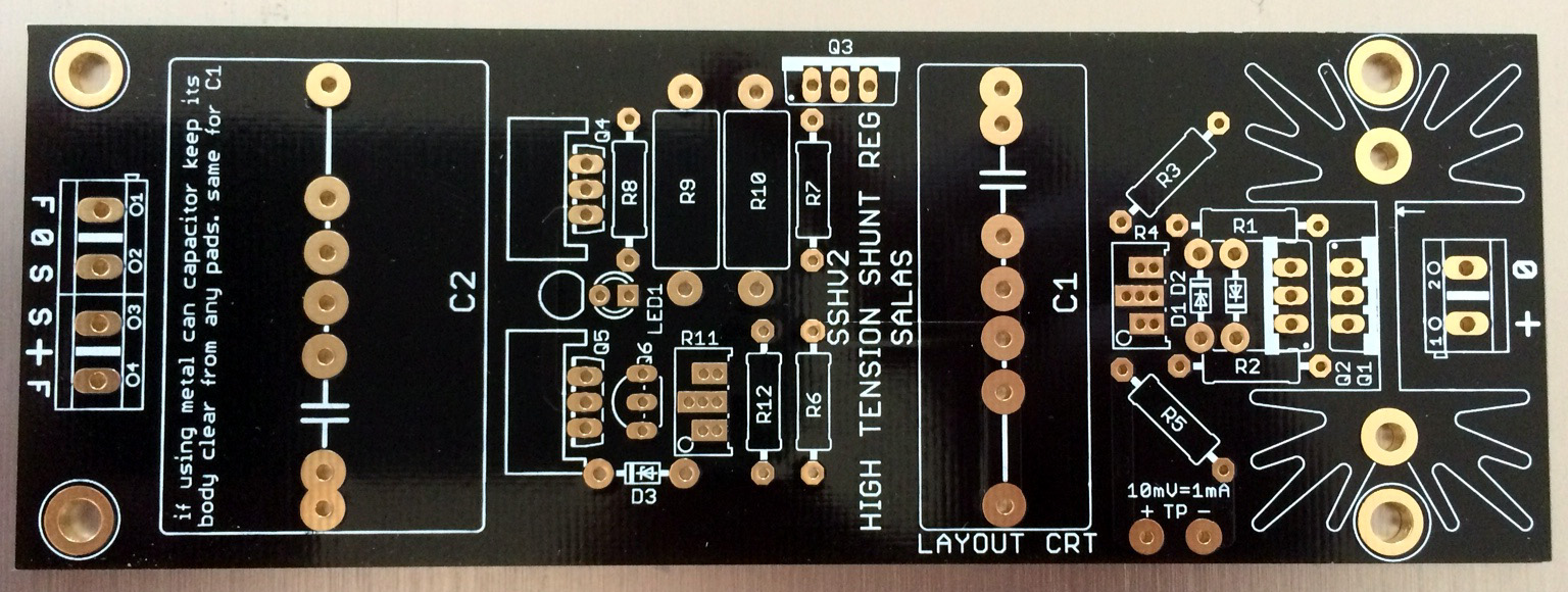

6V6 line preamp
Salas said:
skrstic said:
Hi Mr. Salas.
I do not know anything about electronics, so I apologize if my questions are stupid.
My parts list is
power
-1 x trafo
340V-0-340V (250mA)
5V (3A)
10V (1A)
10V (1A)
-1 x 5C3S(5Ц3С) tube
-2 x coils 10H
-capacitors
1 x motor-run 4uF
2 x 220uF
I borrowed 2 Russian 6V6 tubes from a friend. Heating is grec-22000uf-lm317.

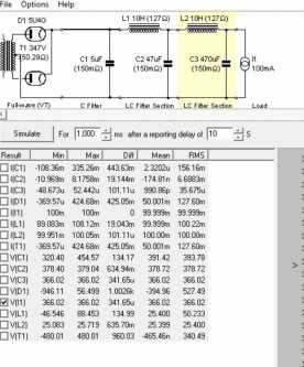

High voltage looks like:
(caps are 220uF)
Questions:
1) I need 1 or 2 SSHV?
2) In PSU Designer load should be resistive or constant current?
3) What value should I put? (constant current 22mA+22mA tubes + 20mA SSHV2 = 64mA)
4) What value R to put on SSHV2 dummy load (340V/0.044mA=7727.27R)?
5) On SSHV2 on TP pads should be 440mV (if 1 is used)?
Thanks in advance. Slobodan.
Hello Slobodan
Please post that questions text to the 6V6 thread so more people can answer or benefit from answers. Since its about things that many others would have questioned too.
From first 45 pages (correct me if I'm not accurate)
answer - 1 SSHV2 for regular stereo preamp, 2 x SSHV2 as dual mono or something like.
answer - constant current
-65mA four 2 x 6V6 + 1 SSHV2
-42-45mA four mono 1 6V6 + 1 SSHV2
(1 lamp 6V6 is around 22mA depending on manufacturer and 1 SSHV2 is 20mA)
answer - 7k7 for stereo and 17k mono
answer - 440mV for stereo and 220mV
Please double check my answers.
1. One SSHV2 set at circa 60mA CCS can handle two channels. But reconfigure it in two wire mode because the consumption nodes will spread. Two wire mode is short at its output connector legs the F+ and S+ together as well as the F0 and S0 together thus have classic +V 0 two wire output, not Kelvin four wire.

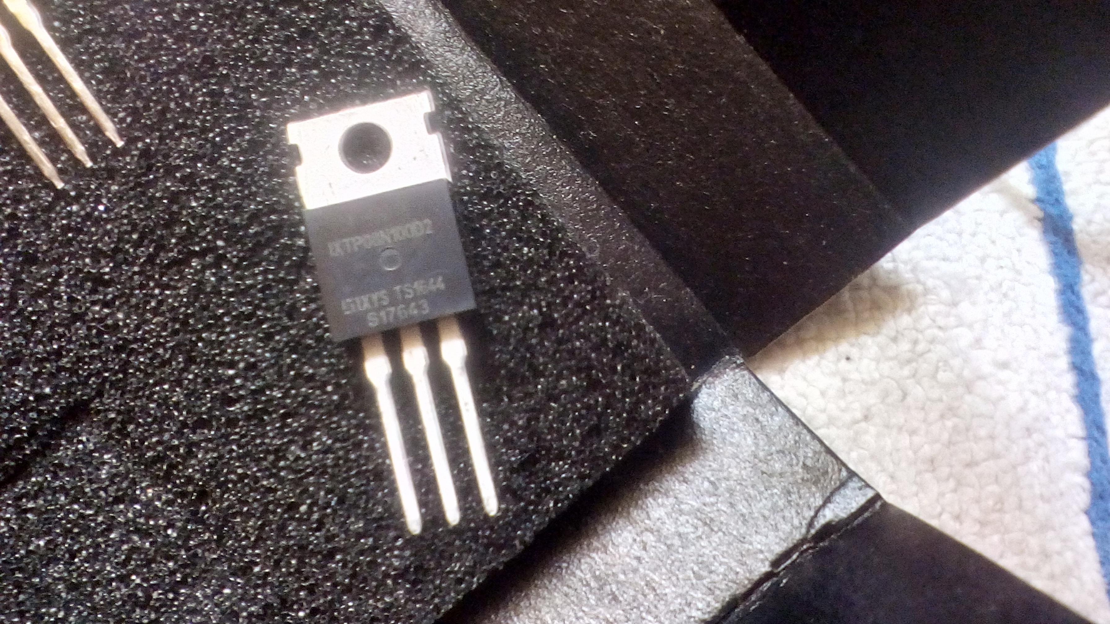

Also use IXYS higher voltage DMOS instead of DN2540 Q1 for more safety since the Vinput is close to the DN's limit in this application. Nikos will kindly remind us the exact IXYS type he put.
2. CC load in the simulator since it remains steady as you change other things
3. Put 60mA because the real tubes usually pull little less than the 22mA per unit prediction
4. Correct. But no need to hit exact mA in this work OK and sinks heat OK preparatory test with dummies. Go with practical dummy resistor values that you can actually find in shops. Go for less mA than more mA when you got to use about values.
5. Should show the total CC current you set. 10mV = 1mA. 600mV for 60mA for example. The newer boards have extra printed directions for quite some time now.

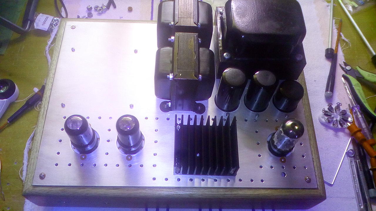

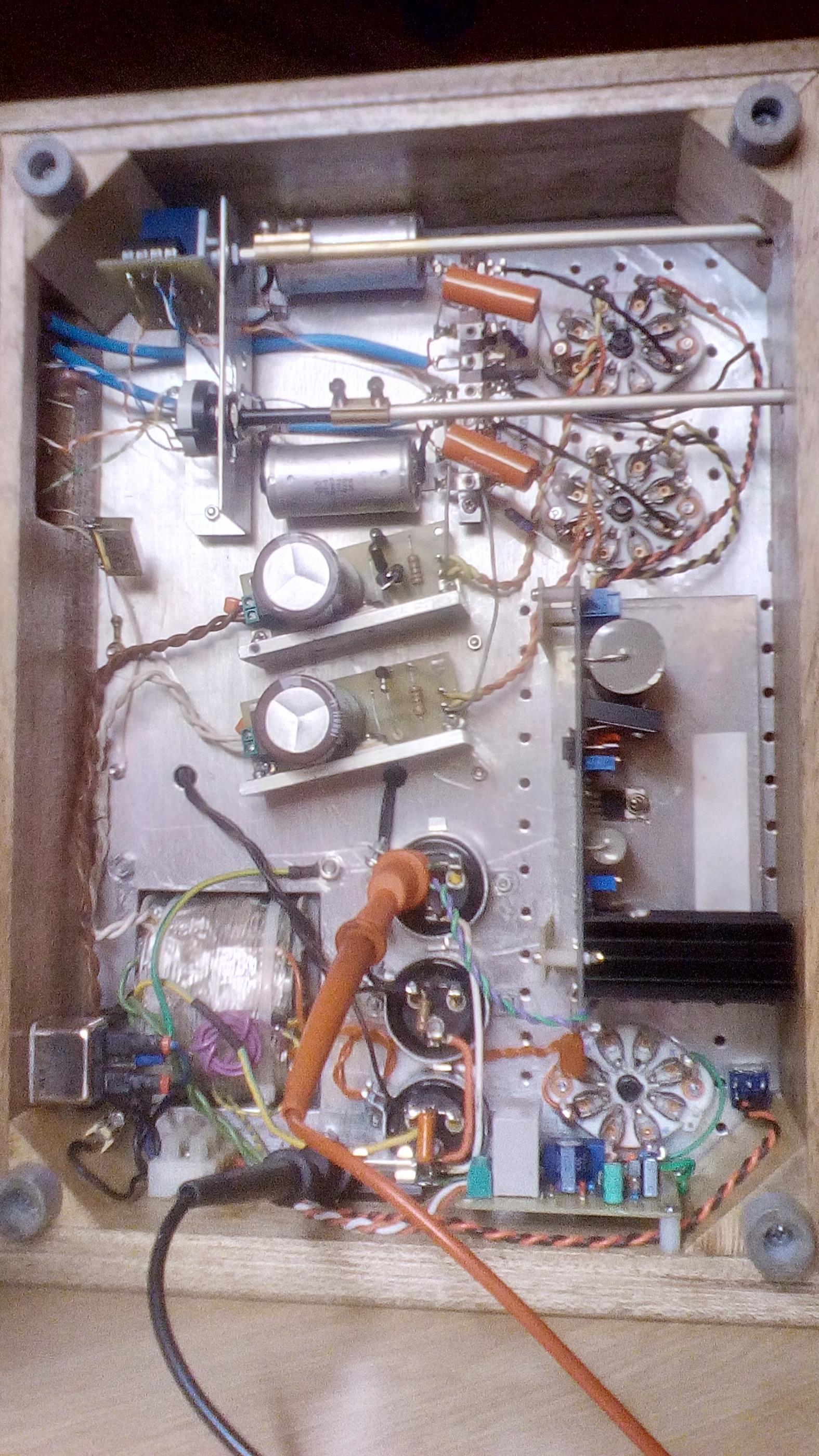

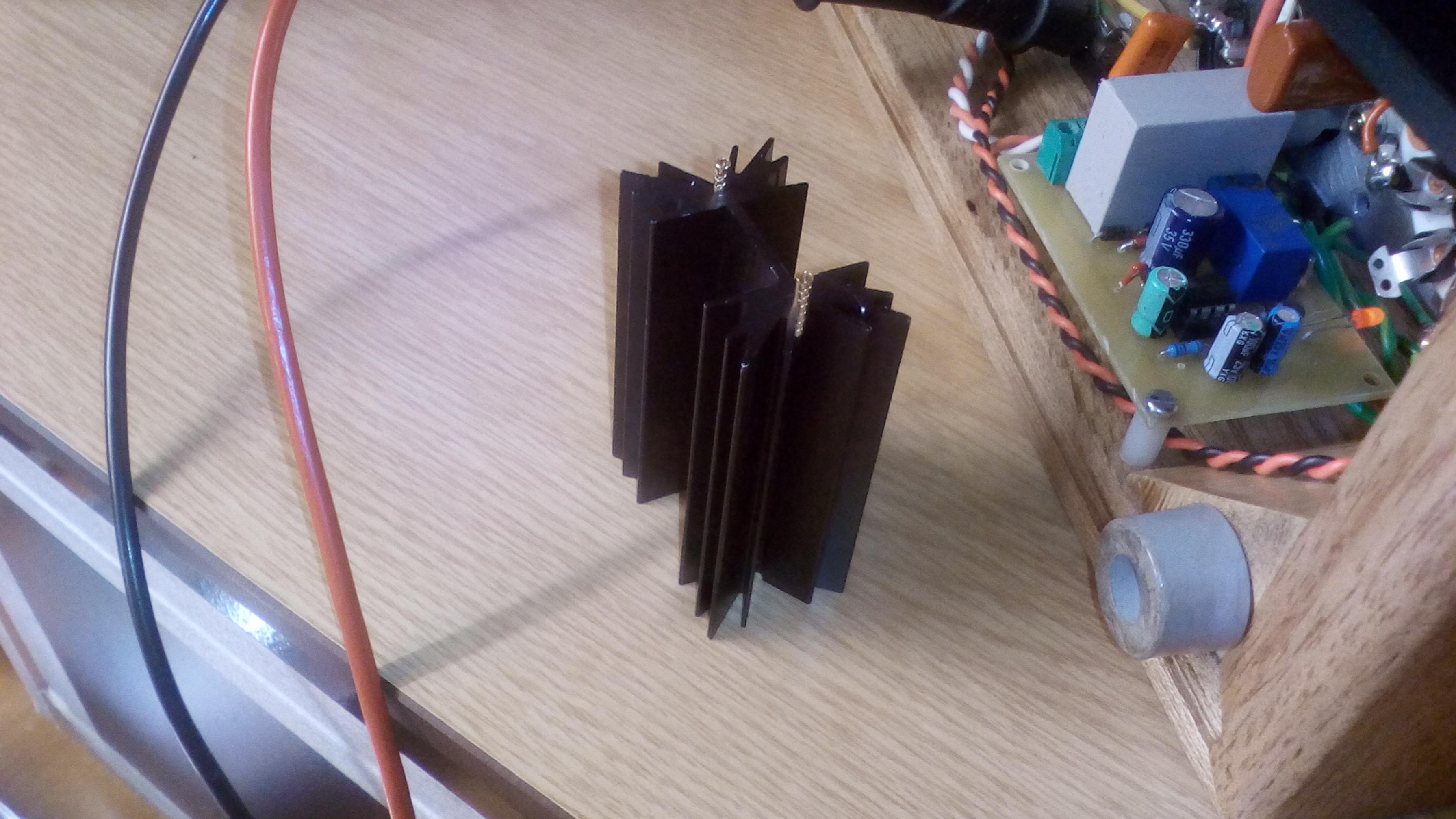

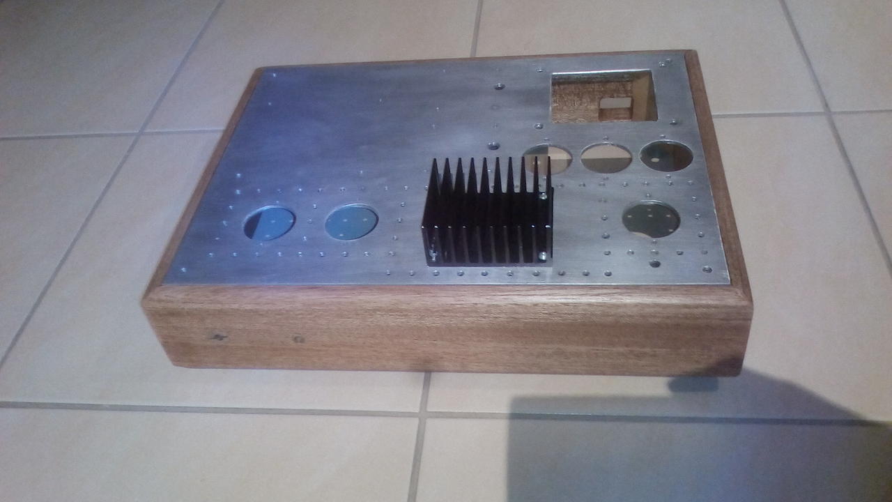

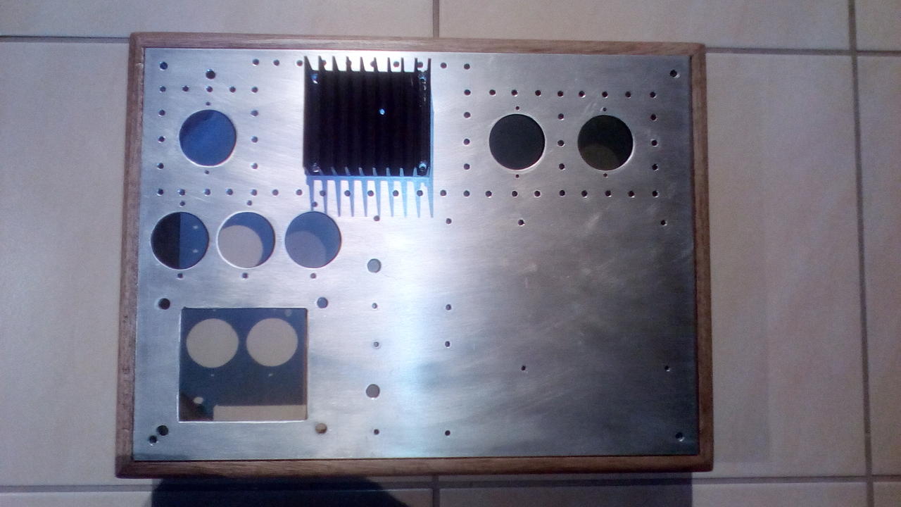

My setup.
640VCT
2X10V /2A for regs 6.3V
5VCT/3A
One reg at 70ma (input 345V-385V) output 330V with IXTP08N100D2
Big heatsing SK129 64mm
