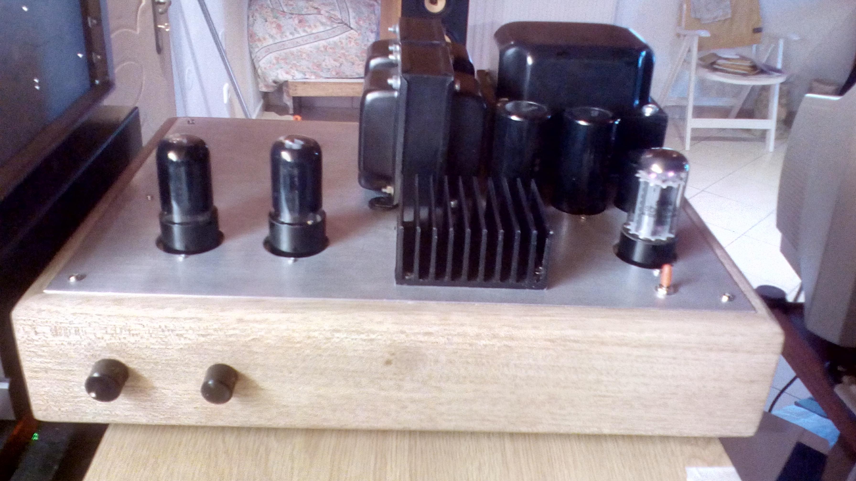

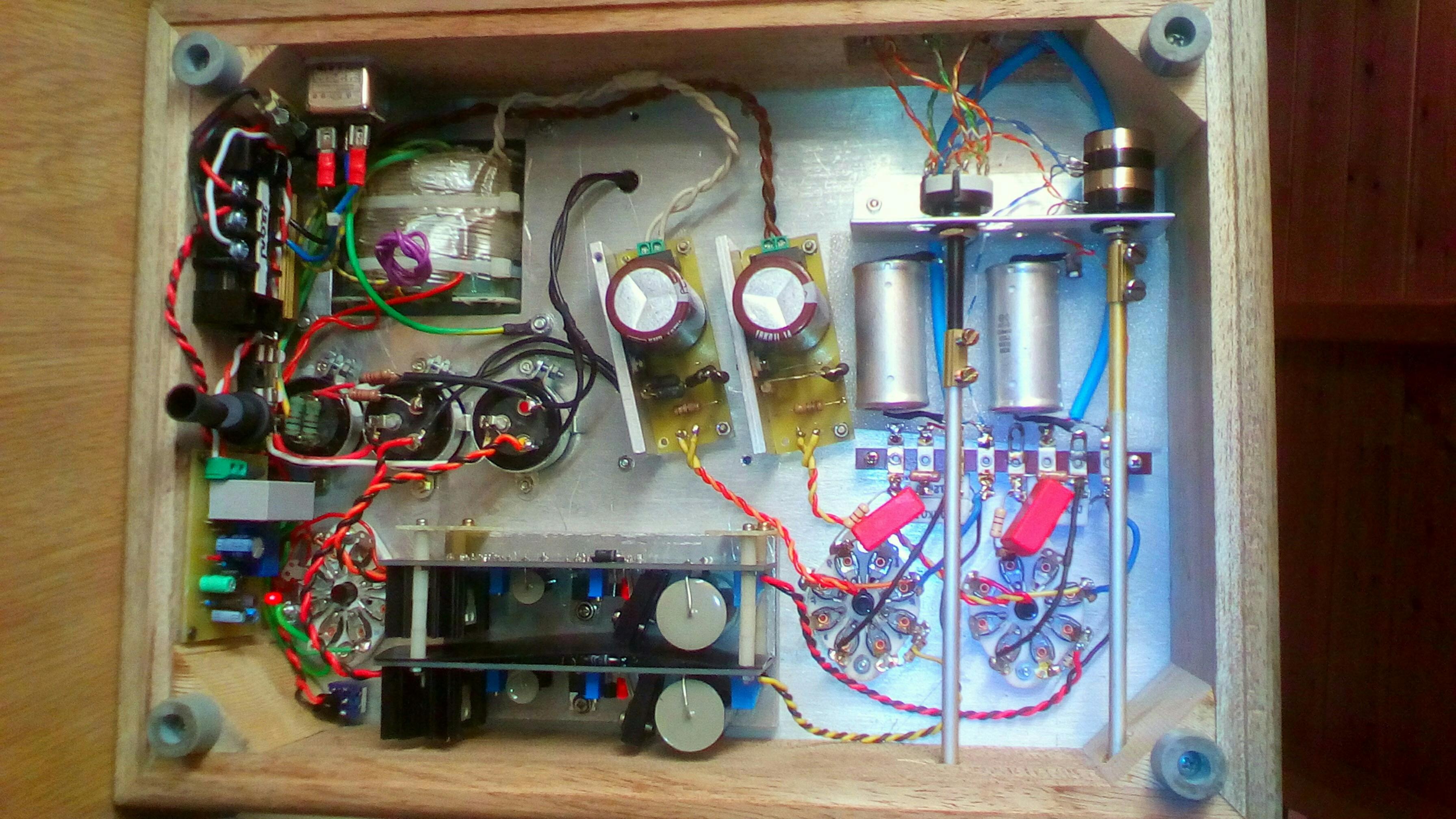

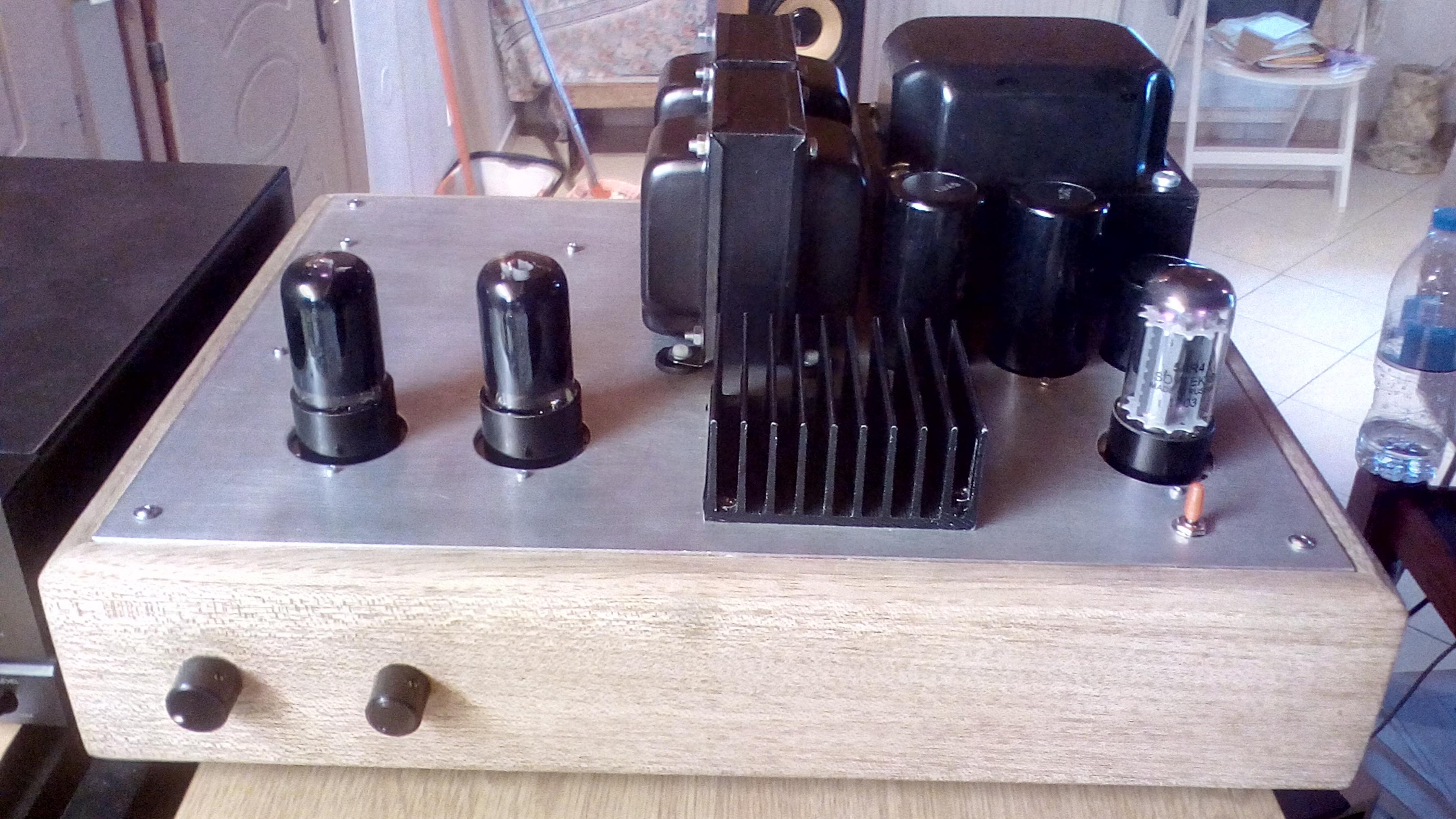

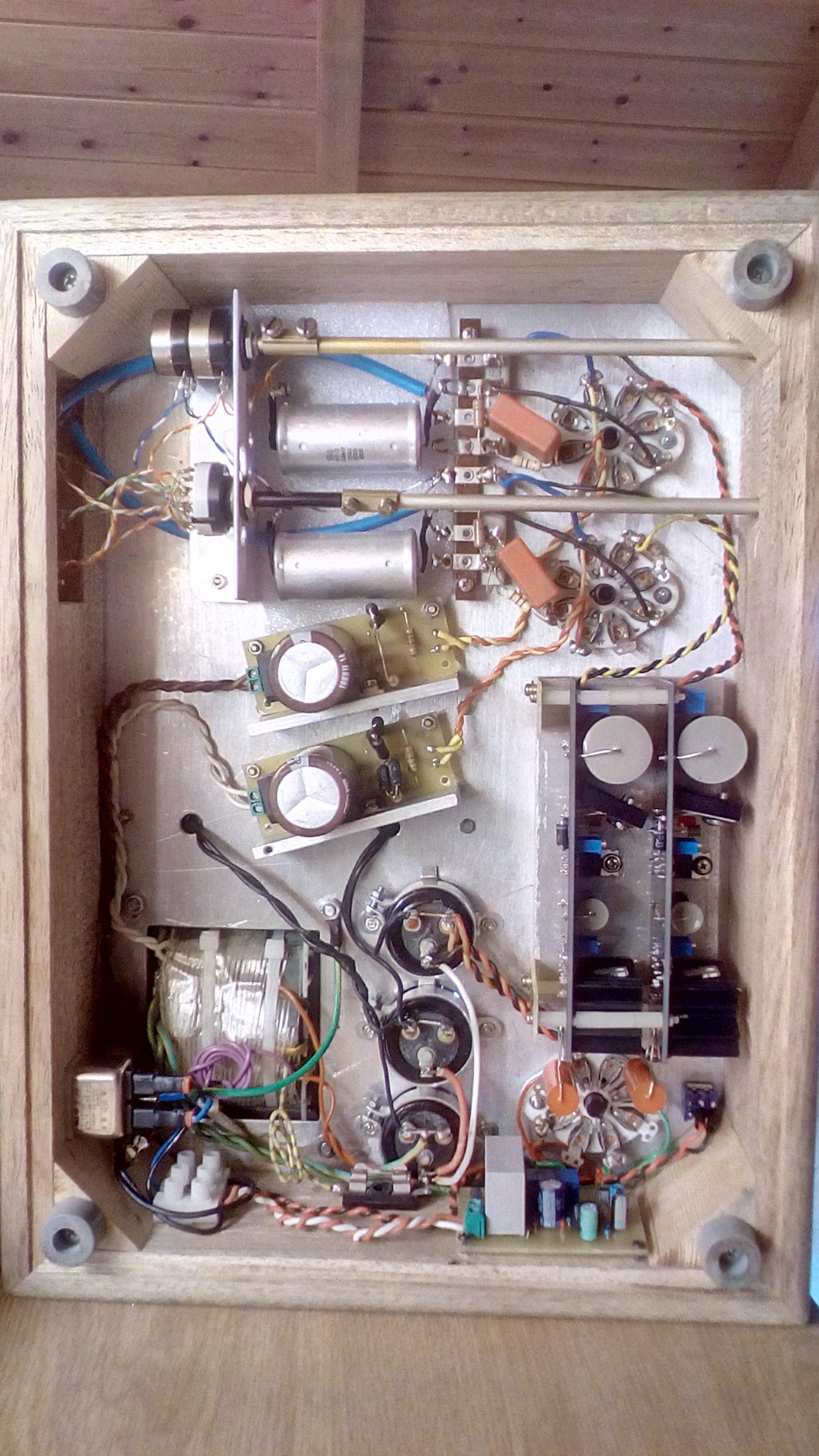

I'm finished my buffer, everything goes well...no noise or hum at all with my 93db speakers and my ears 1cm distance from them.

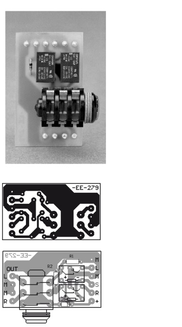

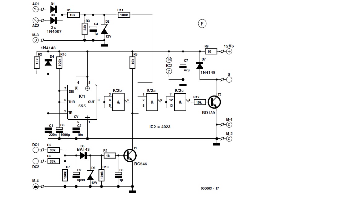

Hi Nick
Its not output delay/relay ,its delay/relay for the 5V filament of the rectifier about 70-100 sec so the filaments of 6V6 to rich about 6.26-6.29V after the regs start make with safety high voltage.

Hi

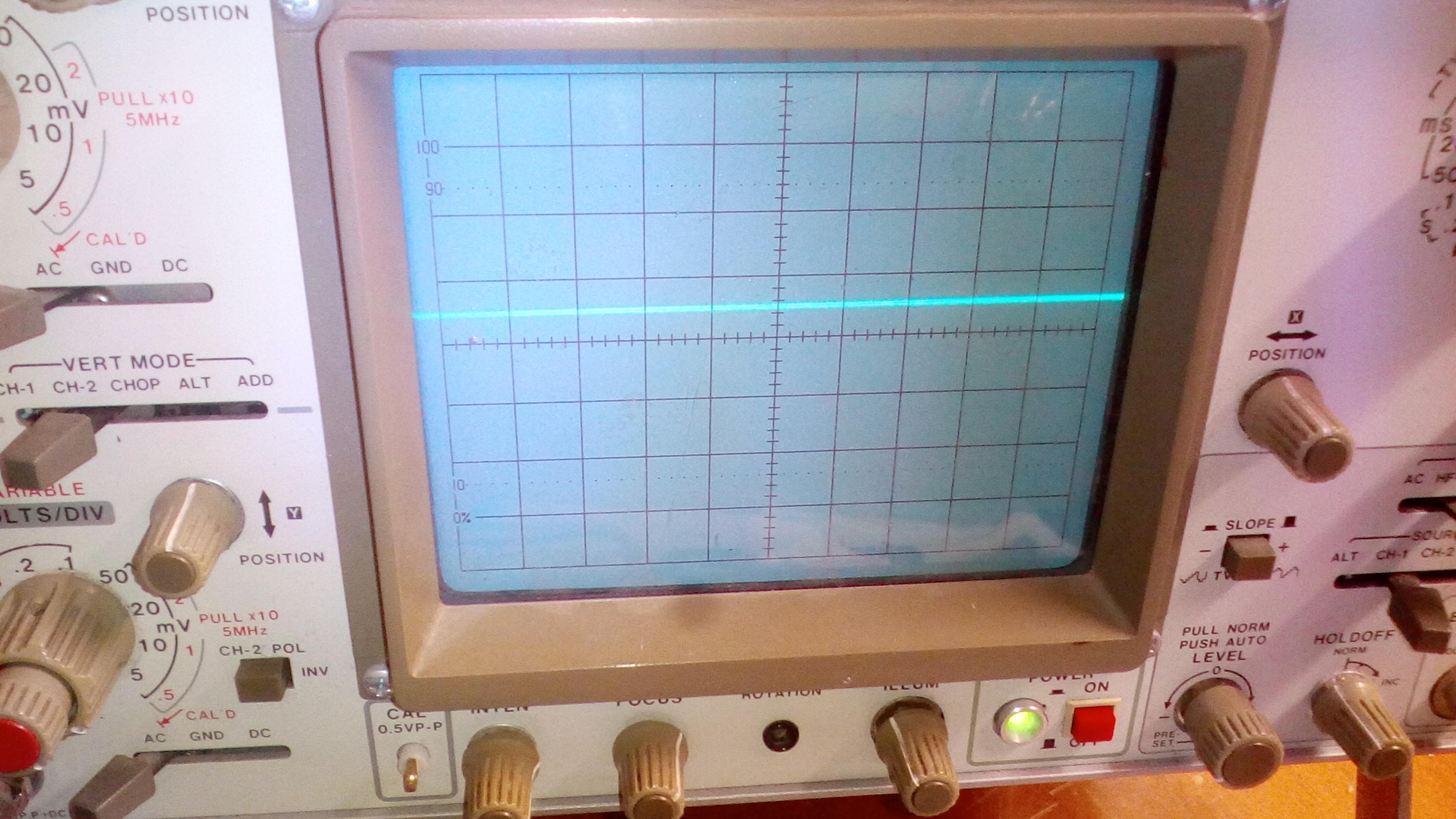

That measure in it's final timing should equally prevent the slow output voltage bumps after power on and off? Because if I put the digital scope in seconds long single trigger mode it can catch those and they look synchronized with the signal tubes heat up & cool down filament cycle.

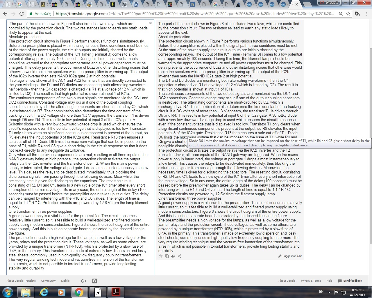

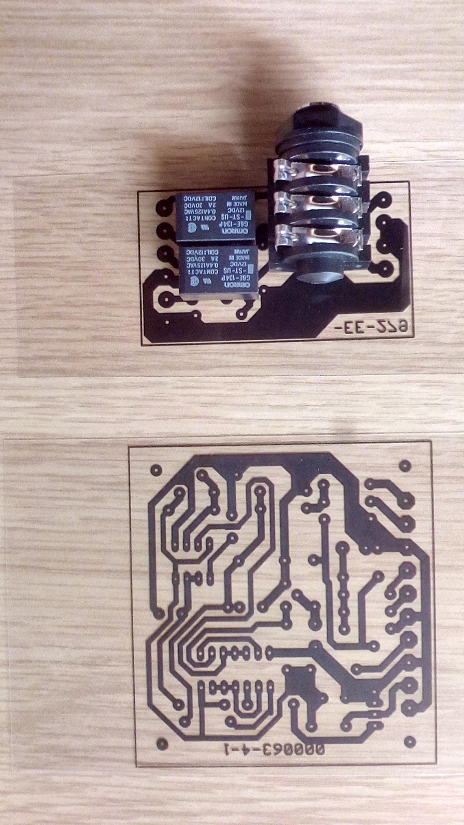

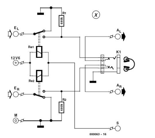

Im preparing for a protection circuit from elektor..

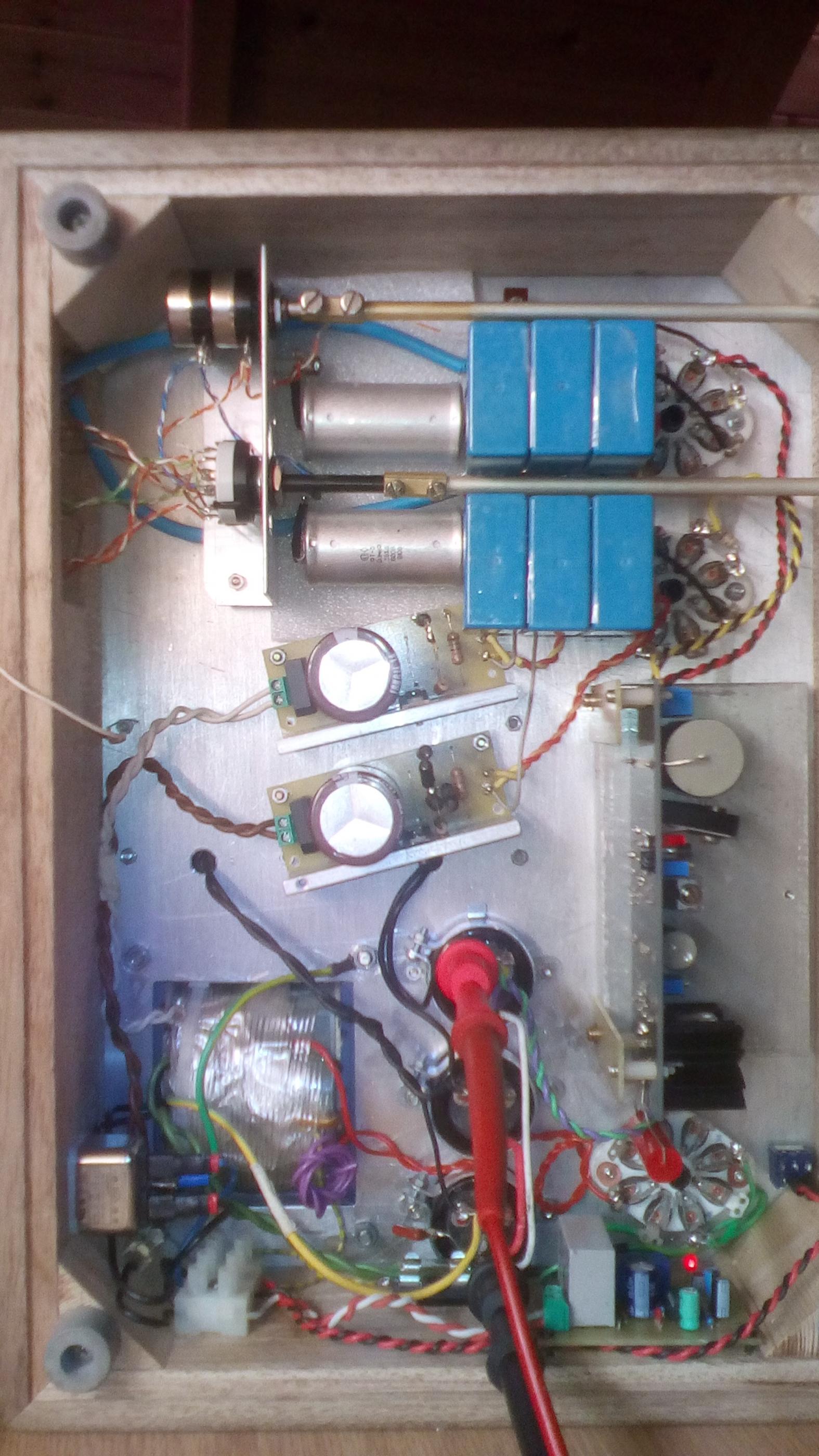

Tomorrow I will give and the schematic, the last setup with only choke and caps has the best results..about ripple and 350-380V before the regs

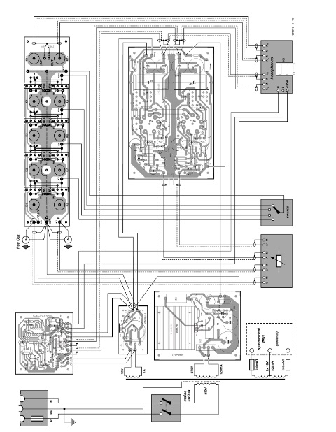

The schematic...
I do not know how much impact (Dc1,Dc2) I will have on the output of the buffer tube ..
Opinions?

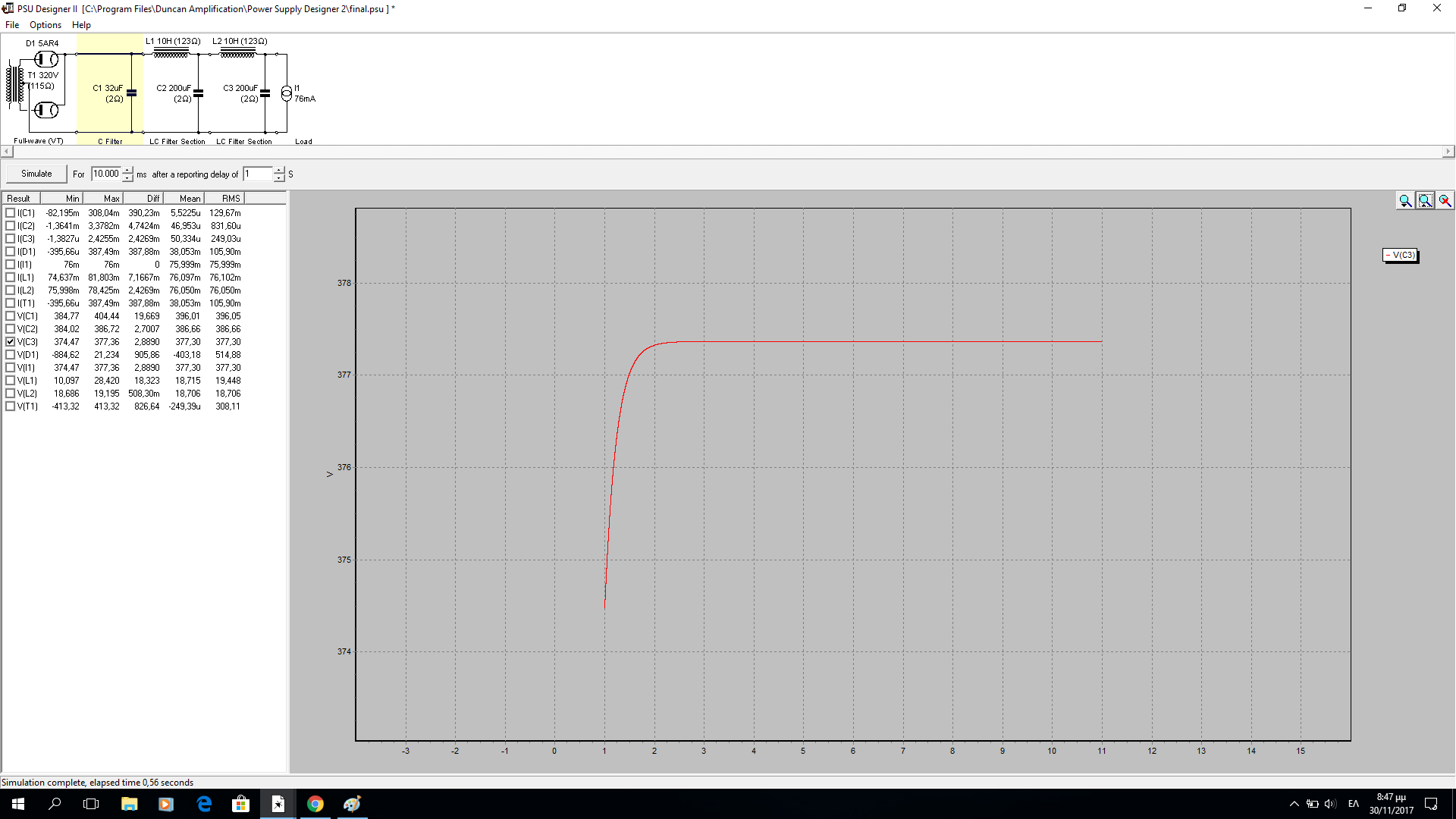

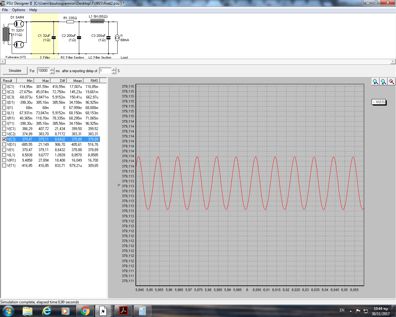

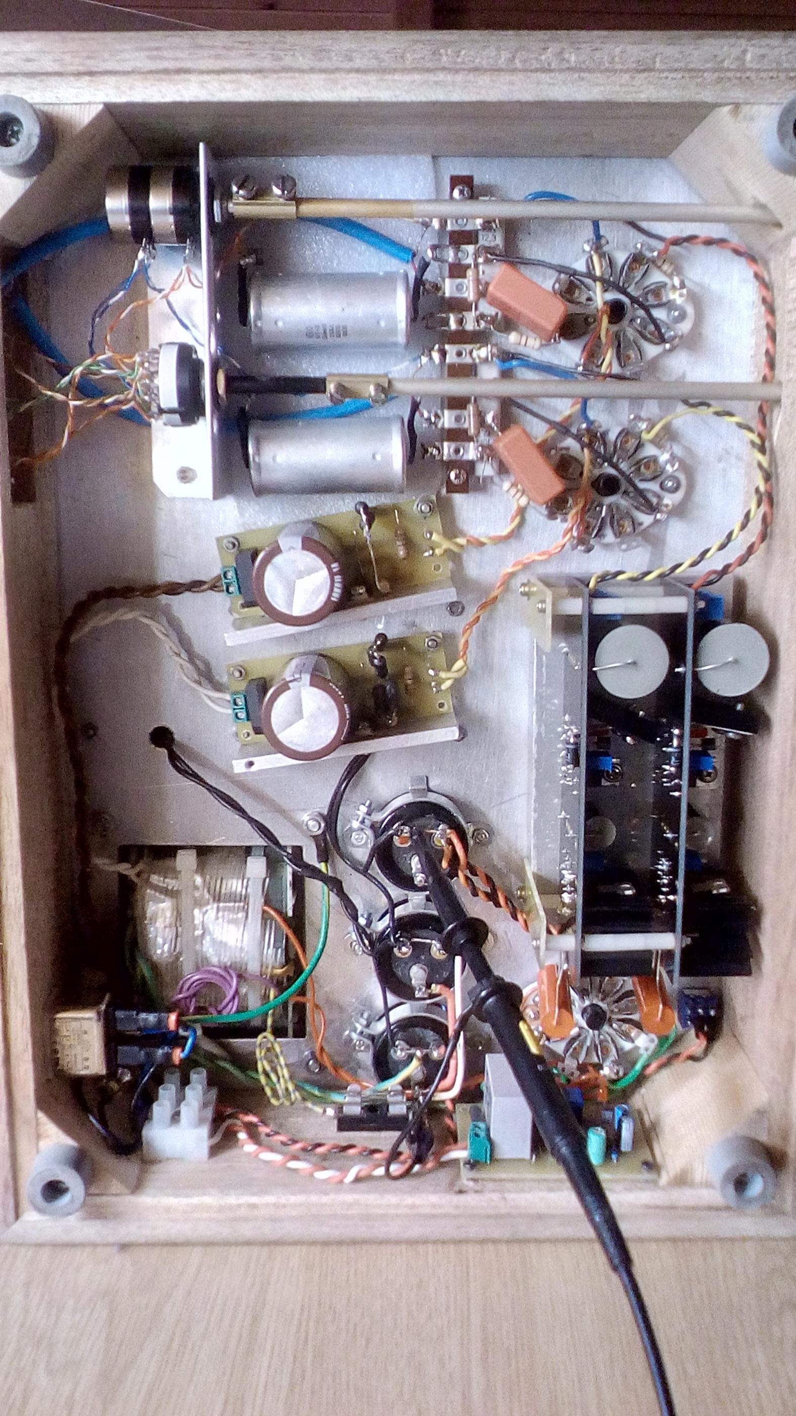

Salas SSHV2 the best results...330V after reg probe X1 or X10 foto1 and magnified foto 2, and before the regs same results.

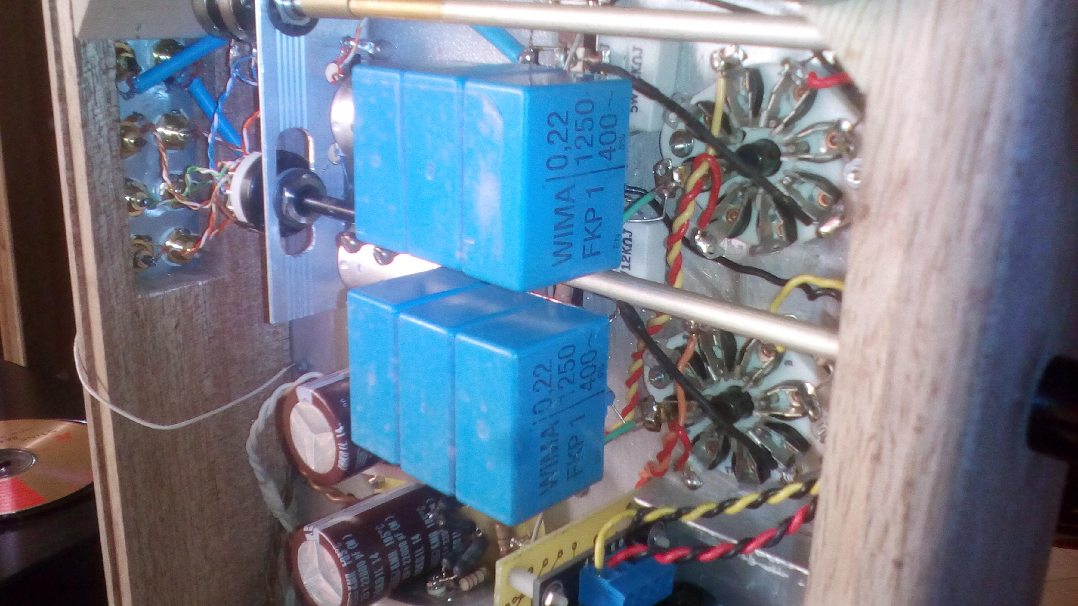

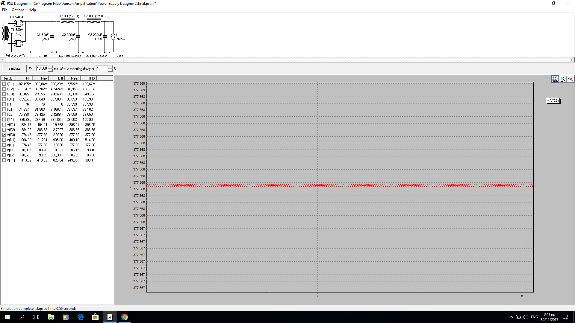

Im trying new combinations with different caps.... I think I will stay with 680nf - 330k output ...about 3 hz- 3db ... with my golmund clone 100k input...
330V- 6KΩ,Rk 390Ω=9.51V=25mA ..

Wima FKP are very good film & foil capacitors. In any case when deciding a coupling cap, beyond calculating a uF value for enough low pass given an amp's input impedance, we must also remember that the V rating of the cap should allow not only for the DC it blocks but for DCV+AC it sees. 1.414*Vrms +DCV <Vr. That is why we see a 100V marked capacitor rated for 63V pure AC in some analytical datasheets for instance. Because 63VAC*1.414 = 89V and then +10% allowance for safety and longevity. That's for line and low enough frequencies mainly. Especially in pulse HF use the % allowance is much more as the V rating goes up. There the high energy changing steep and fast can be much more damaging to dielectrics.
diyAudio Chief Moderator
Joined 2002
Bypassing can make a combination speedier but it also mixes in more than one part's different self resonance and introduces different ESL due to more legs. For audio frequencies coupling its not technically critical, more a matter of subjective trial, unless someone has adequate electronics lab equipment and knows how to measure and evaluate such things.
