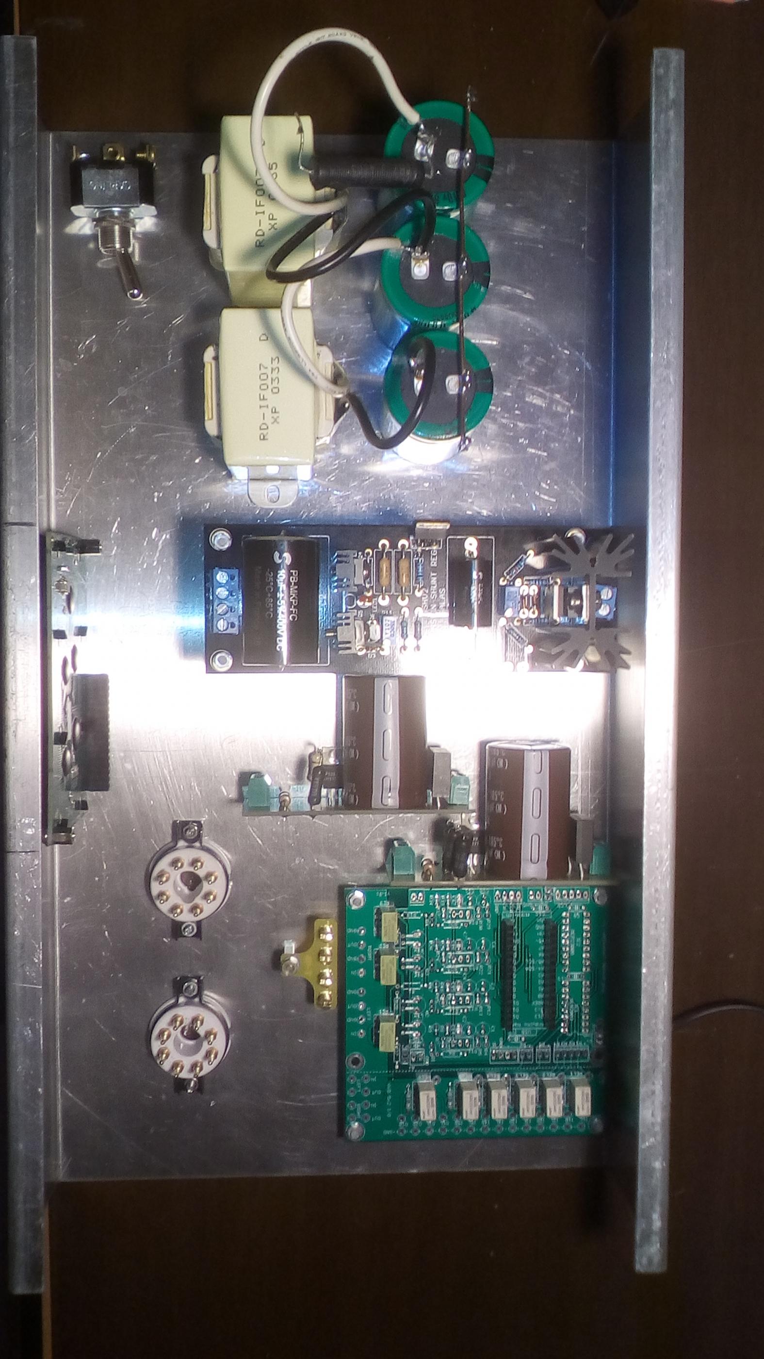

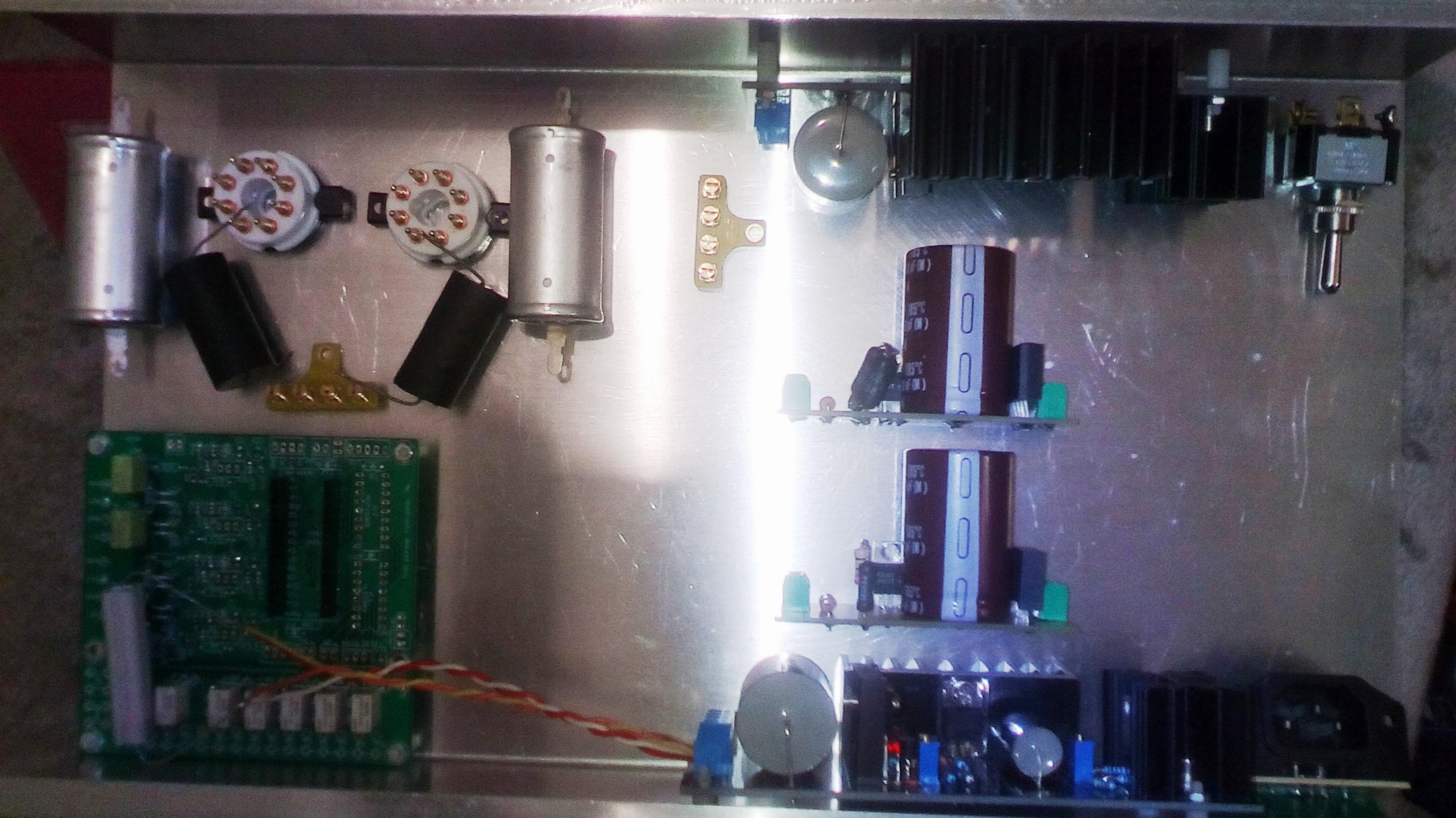

The materials have been collected .
Now good mood for assembly .
The chassis is shaped Π with dimensions 38 Χ 20.5 Χ 7 cm, with future possibility of adding wood to the sides of the box.

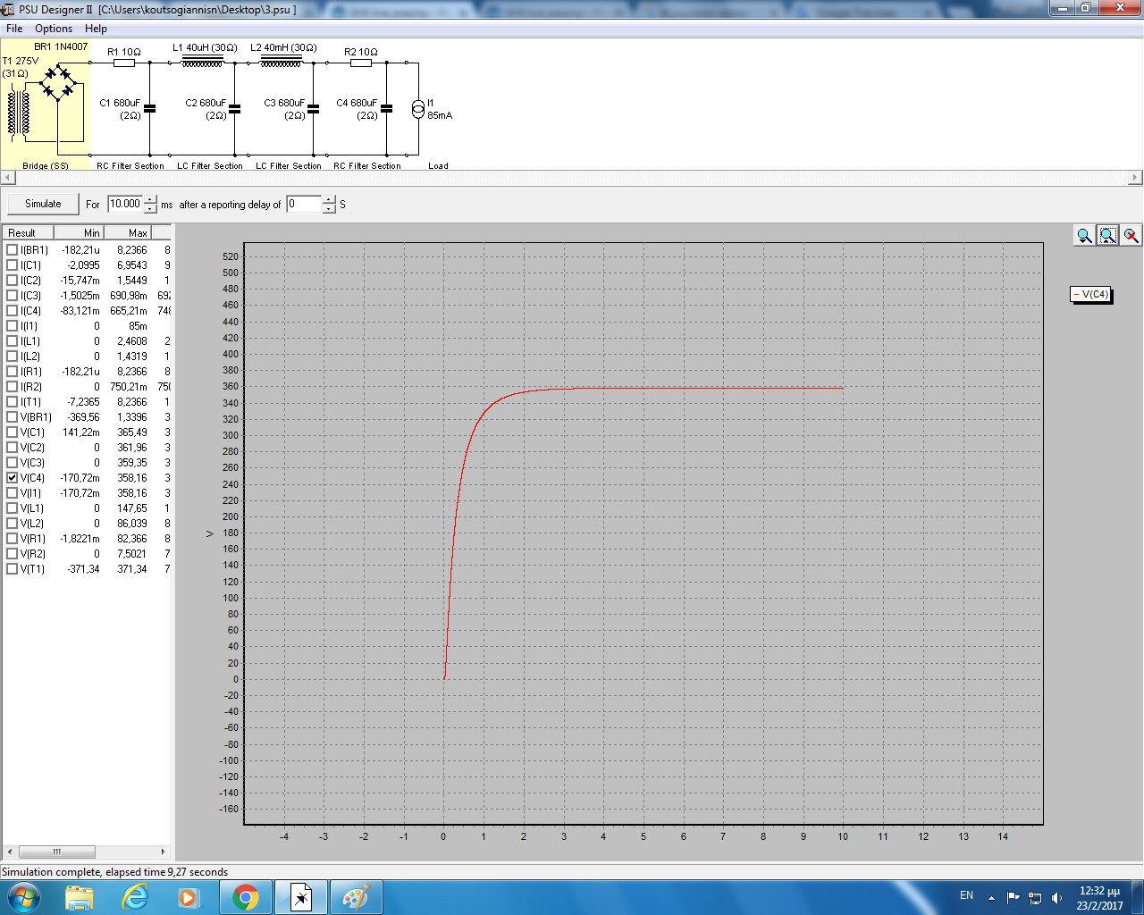

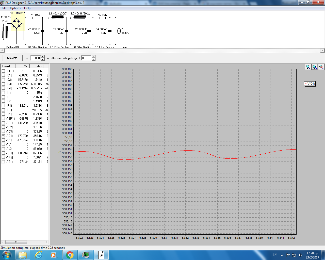

My thought is the combination Cathode follower version with Arduino based LDR volume and source selection controller .
