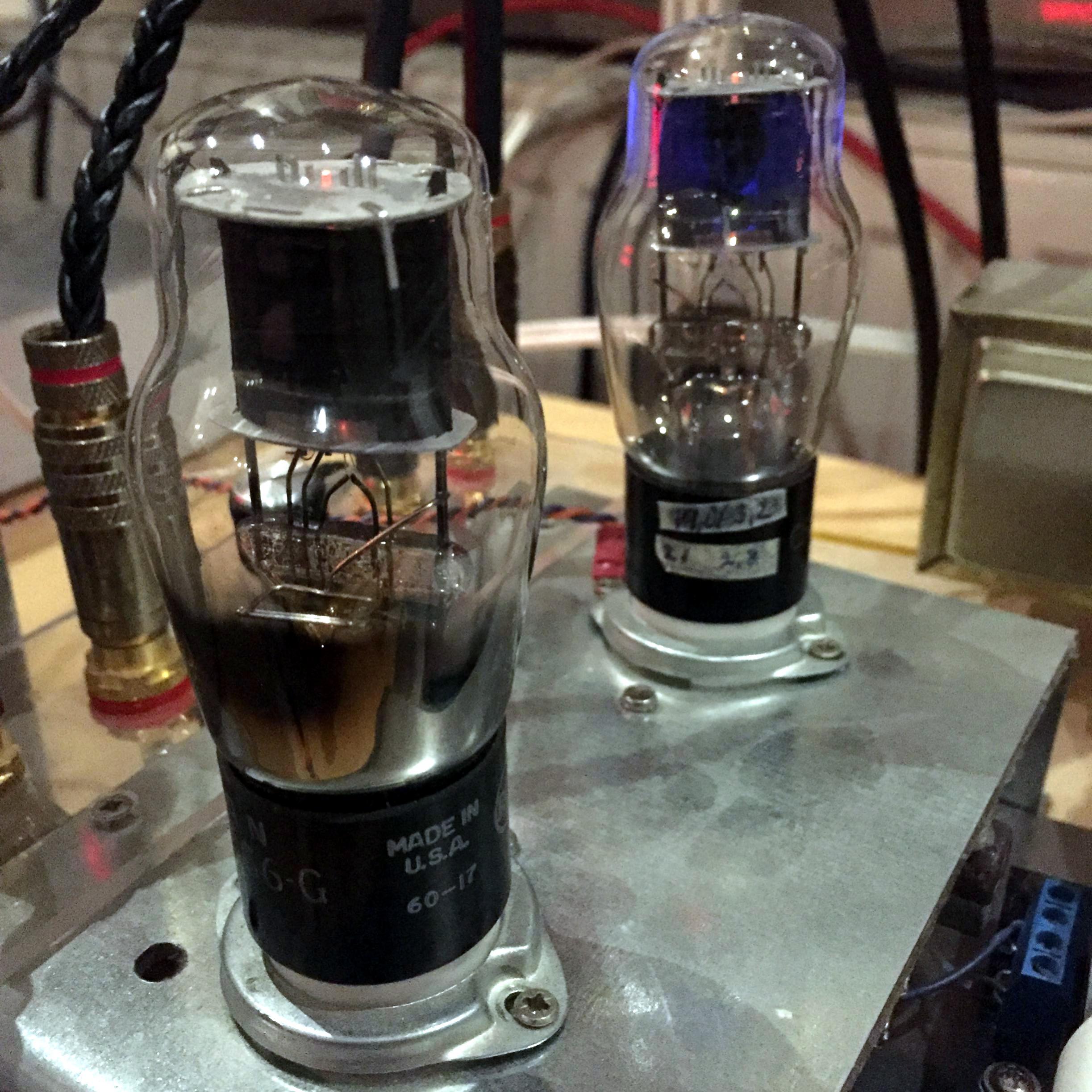

6g6g. Had to heat them heaters from a fluffy external supply since only 150 mA heaters. Microphonic this pair: medium high. Sound: up to you guys but I'm staying right here. Heavenly. Its small ST bottles. Lovely tubes.

Awesome info Stajo, the 6V6 pre owners will dig it. Those ΡΑΔΗΟ Russian NOS are nice indeed. Maybe the 7V Vh higher temperature made them ding a dong a little more. I have some, sound is good in all but hiss may differ, they can be bit of a gamble if buying only two. I find them powerful enough yet "melodious". Good remedy for bad tweeterzzz.

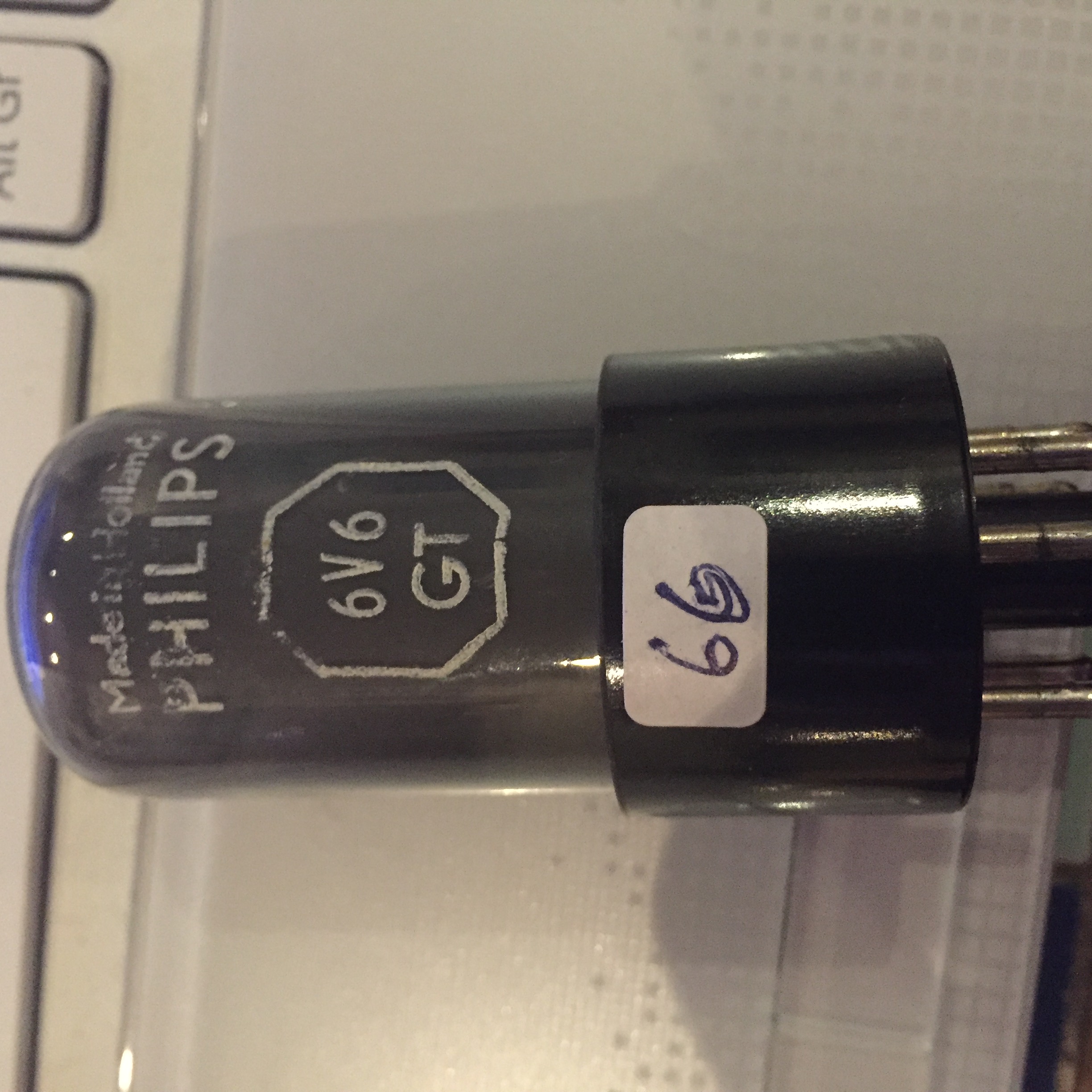

I've never seen a Philips 6V6. Could they come from Australia? Philips bought a production line down under in the 1940s.
Theres a first time for everyone isnt it? Well I'm not the biter of calendars but if you want tube history you can talk to the boat owner currently in hospital. Hold up almost any tube he'll tell you where its made, by whom, when and who branded it ADHD square

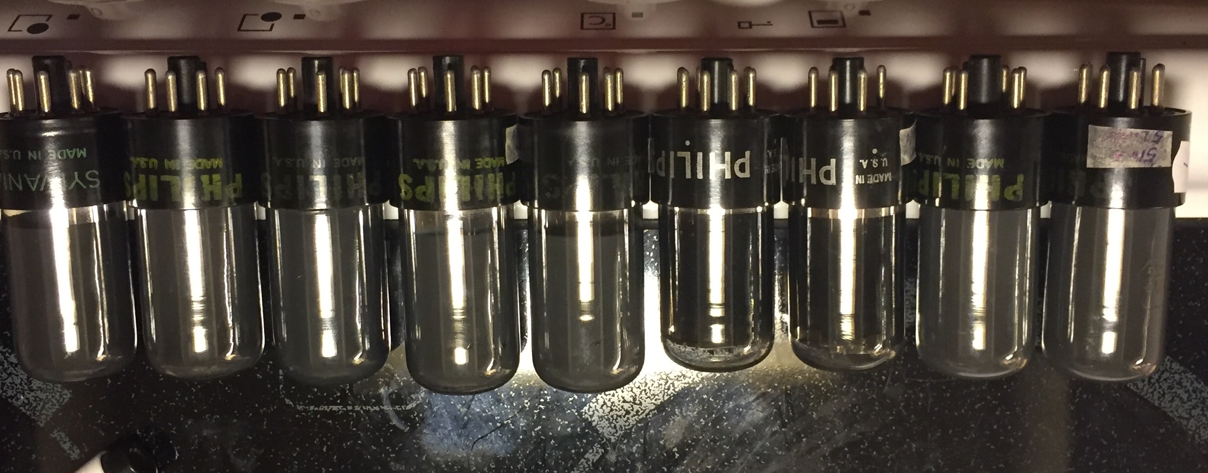

Got... ehum... to many. I could ofc try some samples out for the keen one. Did so for George.

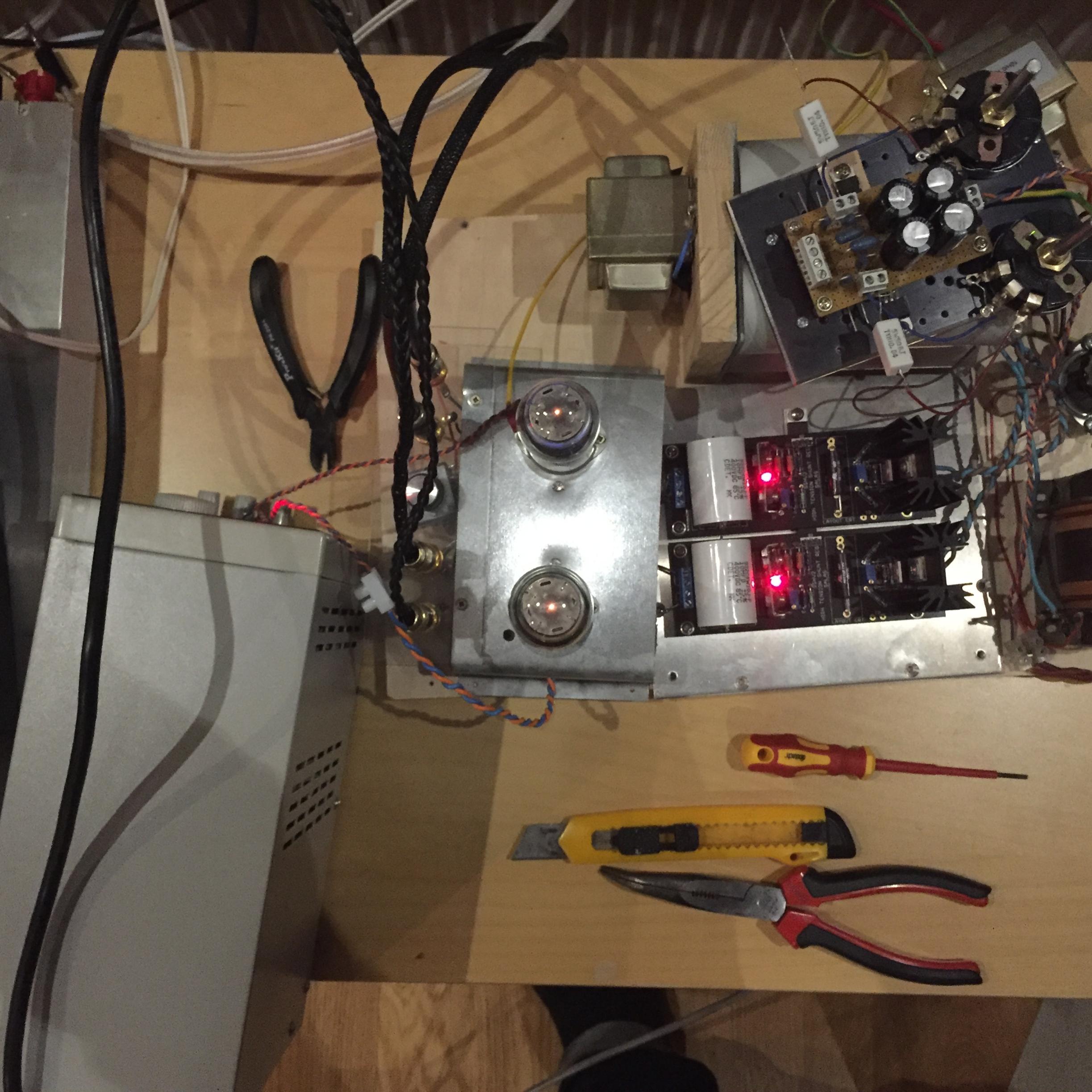

Nice tubes. Is this pre in gain or in follower mode?
Same config actually. It was a gamble slipping them in. Started with 12,5 v on the filaments :)
Its 5 k load, can be higher and 320 from the sshvs. Silmic decouples and 680 on the cathode. Output couplers could shape up. Will post a pic of the mess from phone. Rebuilt it in 180 when I came home on the kitchen table.

Its the common cathode circuit then.
