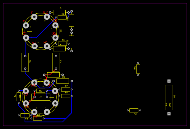

Using EasyEda to start a crude PCB design, keep in mind I am not very good at this, so any suggestions are welcome. Mainly using EasyEDA since I can work from work and home, and it's pretty easy to use. SUGGESTIONS ARE WELCOME!!!!! This is very early stages, so don't laugh
Blue is bottom traces, red is top, pretty simple. Still need to add the output cathode bypasses, and the front end plate resistor. Once one channel is good I'll copy everything over to the other side. Ignore the random parts on the right side of the pic for now. The plan is to run twisted pair wiring straight to additional pads near the heater pins to allow trouble free AC heating, and I may add jumper positions to allow the use of series connection from 12 volts if there is room after everything else.
Need to figure out how to copy the silk layer on top to the bottom, and once I get everything more or less how I like it (and acceptable for everyone) I'll worry about going thicker on traces, enlarging copper areas, and maybe adding additional pads/holes for accommodating different components. Once that's all done I'll figure out if we can fit the mosfet PSU in the center of the board, but that's not a primary concern, I'll mess with that once the main circuit is good. So far it looks like it can fit though...
