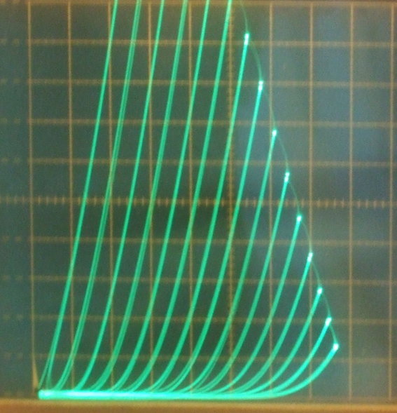

6N14P looks very good too, I was given a couple to check out recently. Good looking curves-
Tube Tester Files - 6N14P - 6H14P
Mu ~25 or so.
Mu ~25 or so.
