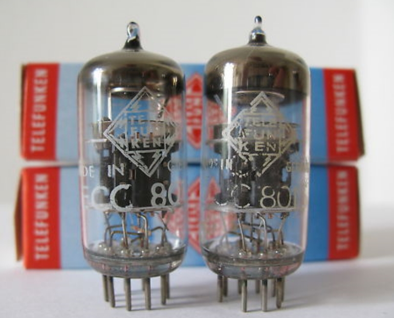

Wavebourn said:
http://picasaweb.google.com/lh/photo/VQXOlv7x5TtvT7tYZSfiTA
This is again the same picture showing a TELEFUNKEN ECC801S (with a faded "1") , definitely NOT a ECC80
Since ECC80 can't replace 6SN7 where more rugged 6SN7 was used so designers kept using the original instead of the "replacement", a special version E80CC was introduced.
Very doubtful and unverifiable.Where did you got this info ? Not a single mention of the ECC80 can be found on the web (try to google it) or in any written reference. (Tube databooks) Any links ?

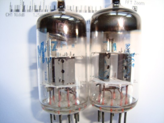

ECC82; I've got alot of short anode Mazda types (practically unused NOS) and their performance inconsistancy in R/C setups is appalling and the centre values given in the Philips data sheet should run. Substituting with other ECC82 types, these Mazda by suprise give near identical gain specs. Only the thd is through the roof. It had occurred to me that these tubes may have accidentally the wrong markings and logo, but I doubt it. The gm, anode performance/ grid volts etc is sim to other ECC82's.
No wonder they were designed for TV frame stages. These I think are the worst performers and the only possible application (these days) is in a power supply.
I don't have any 6CG7; and when I get some long anode types I will suss them out. This is probably the reason that the 6SN7 has accomplished fame. By & large I get far better performance from long anode types than shorts.
The only medicine to get those rotton Mazda ECC82 to work is to CCsource and CCsink them.
Pic of short plate ECC882s heavily eroded Mazda legend. Avoid'em like the plague !

The description of an (late) 1950ś audio tube is the one of the ECC808/6KX8
The picture showing Tfk ECC80 is an Tfk ECC801S missing a digit & letter,
notice the double mica wafer and the round getter is similar in the attached Tfk 801S picture .., other possible tubes where missing print could designate them as ECC80 is the ECC808, ECC807, ECC804, ECC803S, ECC803, ECC802S..., but! they are all different regarding the two mentioned details of the build.
Hope this did solve the matter :p
Mazda brand valves with blue print are generally remarked East European manufacture; often RFT or Hungarian Tungsram.
How well ECC82's perform depends on the circuit. I did some measurements (near bottom of the page) on a simple cathode-coupled amplifier and found that ECC82 gave lowest 2nd-order and about the same 3rd-order as 6CG7 etc. In this particular circuit section-matching is the important parameter, as distortion in one triode can be partly cancelled by the other. The best performer was a US-made RCA 12AU7A. I saw no correlation between performance and anode size.
