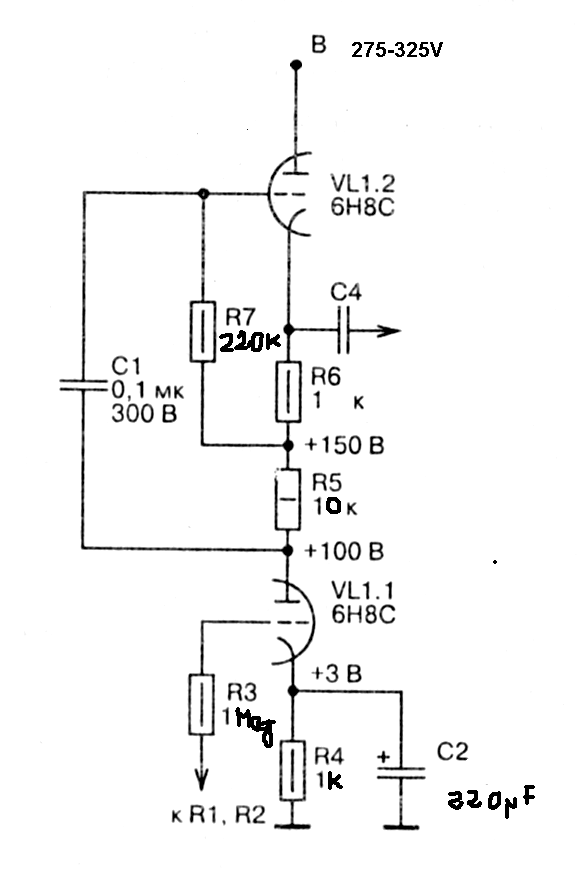

Not complicated. A handful of inexpensive parts and very little real estate would get the job done. Besides, the OP said he was looking for high gain.
I think 26dB is more than enough gain for a preamp. If you are going to start adding in semiconductor CCS then you might just as well make the whole thing out of semiconductors. Hardly a tube design in my view.
Have you tried it both ways? I have, and the difference was more than negligible.
I very much doubt that. A 6SN7 at 5mA with a 10K resistor between has a plate load equivalent to at least 10*ra at which point the only distortion the circuit produces is due to the intrinsic distortion of the tube itself. Raising it to 100*ra or 100*ra with a CCS will make no noticeable difference. A 6SN7 mu follower will produce typically 0.04% or less distortion at 2V rms output and 99% of that will be intrinsic to the tube. Your CCS might reduce that to 0.039% if you are lucky. If you are telling me you can hear a 0.001% difference in distortion then the only person you are fooling is yourself. If there genuinely is a difference between the two it can only be because you built the mu follower badly.

How much mA draws the two valves?
With the values I gave it will be close to 5mA.
Output impedance is around 1500 ohms.

Wich schematic?
The last schematic in your first post.
What about this schematic with R4, R6 400-500 ohms?
B+ 360V?
I have 240VAC tx, Salas shunt regulator spends 20V in-out so I have maximum 315-320Vdc regulated wich value for R8 have I to use to have 250VAC?
Schematic can be improved?
I will use Salas high voltage shunt regulator.
Just replace the 47k resistors in the schematic above with CCSs. While you're at it, try the loctal 7N7 in place of the 6SN7.

Thanks Ian, do you know input impedance?

Input impedance is equal to the value of the resistor from grid to ground. This can be anything from 1Meg downwards.

Post 11 is necesary R3 10K or refers to volume pot value?
Probably. It does not have to be that low. It can be any value you like up to about 1Meg.

How can measure 5mA, voltage across cathode resistor?

Across R6 right?

Across R6 right?

Yes but it is probably easier to measure it across R4. It is 1K so for 5mA you would expect to see about 5V.
Schematic looks good to me.
100K log pot at input is OK.

How do you say +3B at between the cathode & resistor R4 + capacitor C2?
I think it will be nearer to 5 volts.
