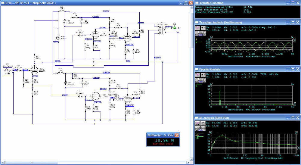

Hi rvrazvan,
You can use any power transformer you like,
as long as it's capable of delivering 100mA
i strongly advise you to use PSUD2 by Duncan Amps
a brilliant tool to experiment with different set-ups.
I find the measured outcome to be spot-on when it's actually build.
Planet10,
have you ever made a PP version of the RH84 ?
I made one, and it puts out 7,5W per channel.
The 7,5W is what is to be expected as the single ended does ~3,5W.
However, I do not understand the simulation Mr. Kitic once posted on this site... How can this sim say 18.96W ?!
Empee
Hi rvrazvan,
Planet10,
Empee
