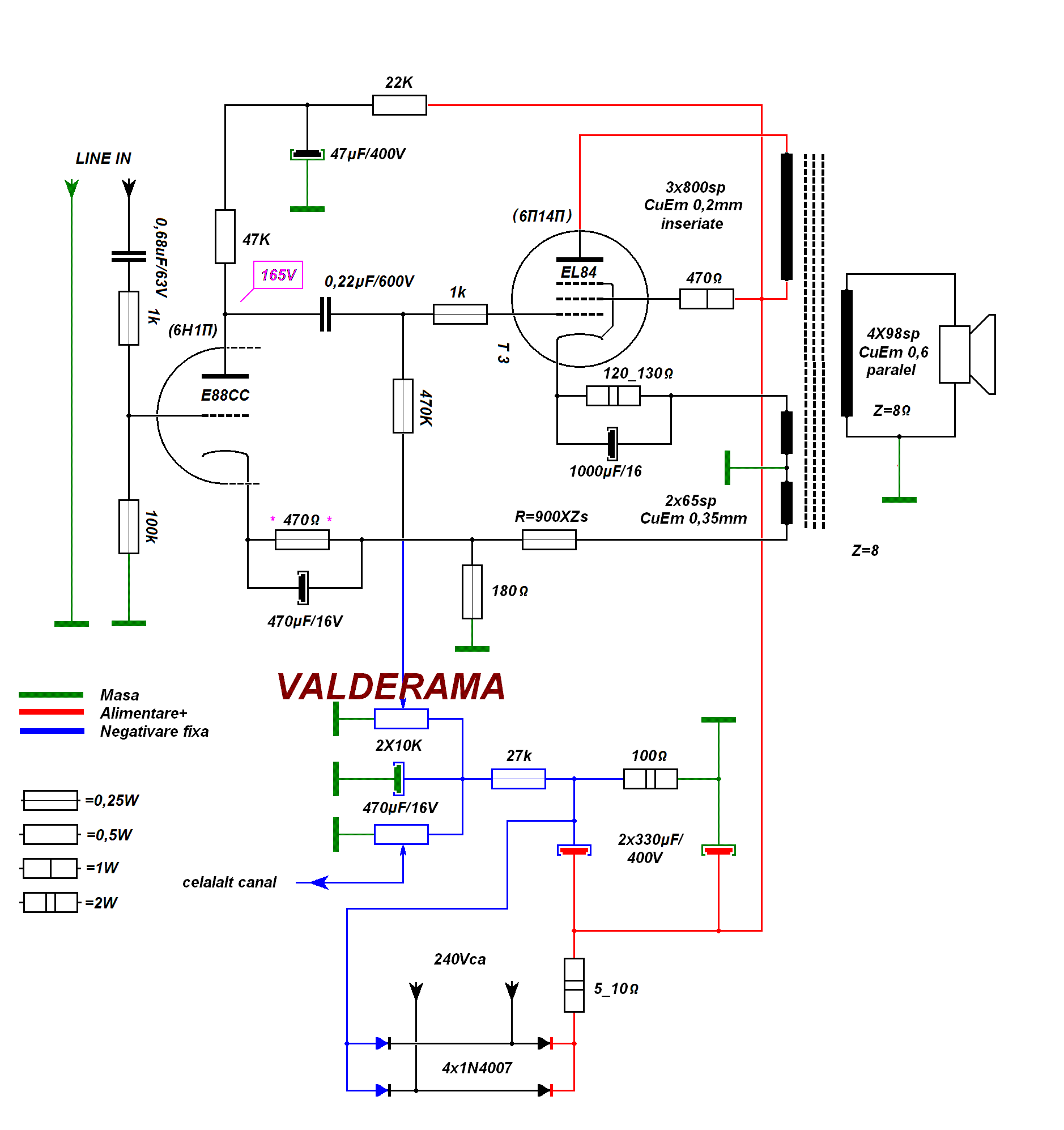

Ok so i got my hands on a few russians:
-4x 6p14p
-1x 6n6p
-1x 6n2p-ev
I'm new to this field. I do not have much experience with electronics so i will need some help.
First step is obvious....chosing a schematic:
Right now i have my eye on this schematic( triode/pentode operating mode)
I welcome any sugestion about this schematic or other schematics.

I linked someone to that schematic a couple of weeks ago, and it wasn't greeted with much enthusiasm by the regulars on this forum. The schematic is most likely a guitar amp offering high gain...and high distortion.
Alternatives that are much better sounding (apparently; I haven't built either) can be found here:
Simple EL84 poweramp/integrated (push pull, which is no problem since you have 4 6p14p's)
http://www.decware.com/se84cschematic.pdf (single ended triode mode; less power, more expensive output transformer, but I'd prefer to build this one myself)

Well i can get a ton more 6p14p's...but i'm gonna stick to a SE for the moment. PP will be my next project .
I will read more about the zen project.
Look at this one also. It's made by a guy from my country...and it seems that he knows a few thing about tube amps ....but looks hard to build...
If you use the 'Valderama' circuit shown above, you will need to add feedback from the secondary side of the OPT. Hence, the circuit will require some modification. I'd personally stick to the tried and tested decware amp. You could modify it to use the 6n6p.

The decware SE will put out about 2W max, which is enough for efficient bookshelf speakers. For comparison: I'm currently using a badly designed 2x6AQ5 PP triode amp in my living room that will put out no more than about 750mW, which is enough to reach quite neighbor-unfriendly sound levels You could get a bit more than 2W out of a single tube if you run it in pentode mode, but you'd need to add feedback. If you want more power, you can go push-pull and go up to about 10W with two output tubes.
In that case, the Valderama circuit would be an interesting thing to try. I'm also interested to hear what other members of the forum think of that circuit.well the ot will be custom made anyway. maybe i can have them done by the same guy ho made the schematic .

Are we talking about the "stereo" amplifier that has the cathodes of the Left+Right output tubes shared? In self-bias applications, there is signal on the cathodes, too. Why mix the channels if you want stereo operation?
Also, how "unique" is an output transformer whose secondary is not grounded?

Are you talking about the Zen amp?
Well all i know for now is that this amp is well regarded by most of the people who heard it. However i wold like more power from it....so i was thinking maybe i could build 2 in the end and bridge them. But i need some feedback on this ideea. I don't have the knowledge to predict evetual problem that may rise doing this.

you might want to take a look at the higher powered SEP design from the same guy ( Steve D)
caveat - some of his technical prose is "interesting" to say the least, but I've heard several of his amps, and they sound quite delightful
note that a couple of important features of his SE designs is that the in-house wound OPT are floating to allow for bridging - I've heard a pair of "Cs" run that way and aside from a bit more grain/noise detectable on very high sensitivity speakers, it works quite well
