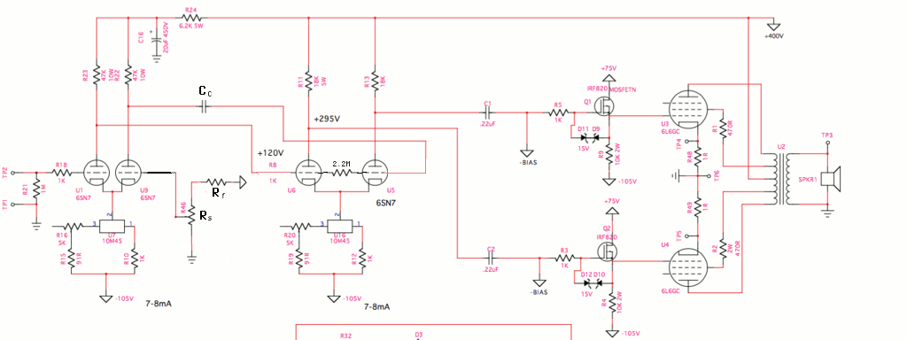

After re-reading this thread a few times, I've decided to abandon my interstage transformer idea. Simply cannot get driving impedances low enough (Along with all the other compromises). In looking for Mosfets, I've come across a few Cree Silicon Carbide units. The CRM0280090D is a 900V/11.5A/.280ohm device with a CRSS of less than 7pf above 20V VDS and better than 2pF above 100V. Does this open me to possible problems with Oscillation?
I've had my eye on the new Cree Mosfets but haven't tried them yet. I have been using Fairchild Fets with good results. FQP(F)2N90. Add the F it you want an isolated case. Go with the FQP part if you need the die to run cooler. I use 1k gate stopper resistors and haven't seen any oscillation problems.
That number is no good. I assume you are referring to the C3M0280090D.
I have not tried any of these SiC mosfets for audio applications yet. The rather high gate resistance would limit high frequency RF applications, and work in your favor toward calming oscillation in audio amps, but remember ferrite beads are your friends.

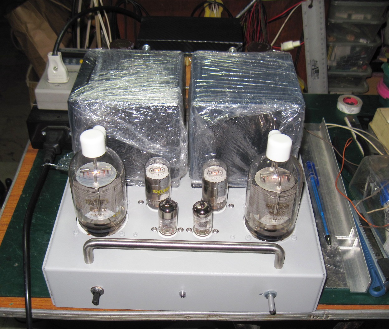

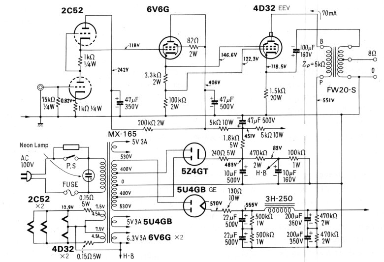

Hi George.... saw image of your test board with the 4D32 transmitter tube and have rekindle my desire to build a SE 4D32 amp using Noguchi FM-24WS-3K5 OPT. Driver tube will be twin trioded 6EM7, and operating 4D32 with 400v plate @100mA. It's a Japanese circuitry.
Question is, what'll be the best driver tube for better sounding?
BTW, this 4D32 is intimidating, cheap, and looks like the fat bomb that was dropped over Japan :eek:!

i am building one right now....driven by 6gf5 triode wired and 6dt8....
E
Hello Sir.... Bought 3 pcs. @ $75. + $16. shipping from US.
Looks mucho and could probably last another 20 years like me :D.

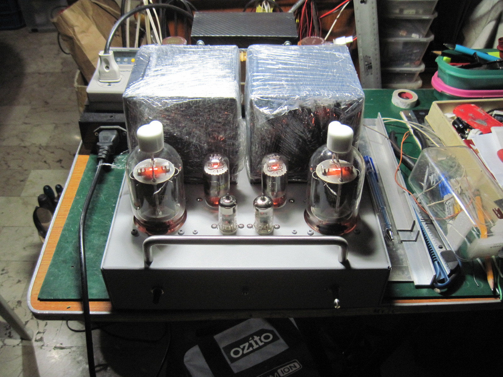

Breadboarded this single-ended 6EM7 > Telefunken EL 51, sounds promising!
Next , I'll try out the 4D32.
I'm not a EE, but just an old copycat, seeking reliable schematic to ponder on! U've any to share?
Thanks!
That question has been asked ever since people started making amps. Unfortunately it is impossible to answer......It's like what is the best car, a BMW or a Honda? Most people would choose the BMW, but I'll keep my old Honda Element since I haul more junk than people.
I used the 6EM7 as a driver tube when I made a cathode follower amp since I needed a lot of output voltage swing. It worked fairly well, and sounded good in that case. I did find quite a big variation in the gain of the first stage. I had to go through several tubes before finding two that had the same gain.
