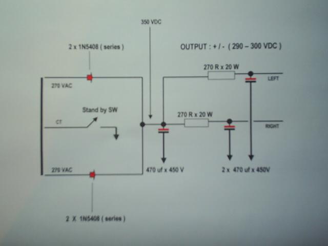

Hi quitvinny ,
Here is the power supply schematics . Very , very simple !!
The diodes are 1N5408 ( two - series connected ) , the resistors
are 270 R x 20 W wire-wound .
Use always the stand-by switch , to prevent cathode stripper .
Regards ,
Carlos

Little quick question, does the quality of the capacitor in the power supply affect the sound of the amplifier, because I can easly get cap (470uf x 450V) with mouser, but its like xicon or something like that...
Next, resistor with no power rating indicated, it`s 1W i guess ?
Right now I`m in the redraw-everything-with-your-sugestion stage, I will have some news soon annnd question soon !
Thank !
My comment is that many people claim to "hear" a difference with different power supply capacitors, but blind tests often contradict this.
The most important point is that the first capacitor must be able to withstand the ripple current. This can be a difficulty because it is usually unknown; it depends on the resistance (impedance) of the power transformer winding. Further, I really had to hunt here to find ripple specs at all for electrolytic caps - I could only find data for Hitano. This helps you little, except to say do not use the first physically small cap that you can get. Electrolytic caps with sufficient ripple capability are larger than normal ones - sorry I cannot be more specific.
Then the influence in audio (if any) usually comes at high frequency from the series inductance of such caps (they are constructed in a spiral wind). Again this can be difficult to measure, except that 2 smaller caps in parallel is often better than one large one - but this is more valid with transistor circuit requirements (thousands of uF). I have measured a JJ 100uF 450V to be 0,3 mH. This translates to 60 ohm at 30 KHz, which can maybe be a factor. So we put a polyester in parallel, because of its lower loss at high frequency. But I measured several such caps between 330nF and 1uF (all 630V) and not one had an internal inductance lower than 30 mH! It also varies, depending on the make.
Still, one mostly uses 0,22 - 0,47uF polyesters in parallel with the electrolytics, if only to feel better! (I am referring here to the power supply output caps; the ones at the amplifier side.)
I am sure others will comment. (And I do not see an unmarked resistor in Carlos' circuit.)

Hi quitvinny ,
As I said in my post # 24 , you can improve the power supply’s quality ,
putting MKT or MKP caps , paralleled with electrolytic caps .
I suggested 0.1 uf x 630 V , and Potqieter suggested the same thing
but with values of 0.22 or 0.47 uf , as you can see our suggestions are
almost the same . You decide it !!
The power schematics that I sent , is very simple , it has 4 diodes , 3 electrolytic caps , 2 wire-wound resistors rated for 20 Watts and optional
choice : 2 or 3 MKT or MKP caps paralleled with electrolytics .
I do not know what another resistor are you talking about ???
Regarding your question about cap’s quality , see the Potqieter reply , I
agree entirely with him , when he went direct to the point , and said :
The first filter cap must be able to withstand the high ripple current !!
Please feel free to ask again ,
Regards ,
Carlos

Hi all, I think I got the right desing for the psu (http://image30.webshots.com/31/7/76/48/2784776480068130724tDHNFj_fs.jpg)
(if doesnt work see my last post for explanation where to go, except check the amp-psu. jpg image)
Please, do a little check out over it, should be good, but we never know...

Hi quitvinny ,
I saw the previous schematics and everything looks like OK !!
BUT you need to revise the following :
1 – No necessity to use LM 150 ( rated for 3A ) , the “old and good” 7812 , with a good heat sink , will do the job .
2 – The power tranny winding , to feed the HEATER circuit ,
needs no more than 0.5 or 0.6 A ( If in the future you are planning to do a preamplifier , using the same power supply , then consider a rate of 1.5 A )
3 – The screen grid resistor must be rated for 2 Watts or more .
Wire-wound if possible , if not , use metal film 2 Watts
4 – All 1 K and 330 K resistors in the output stage , can be 0.25
or 0.33 or 0.50 Watts , preferably metal film , the 1K - 12AT7’s grids resistors can be 0.25 Watts metal film
5 – I strongly suggest that you increase the rating of output stage
cathode resistor , from 5 Watts to 10 Watts , you can use resistors
association ( series or parallel ) . And use ALWAYS wire-wound
resistor for this job .
6 – The CCS power supply , as I said , must be tottaly separated
from the rest and uniquely to feed the CCS , a rating of 100 mA
is more than enough , you can add a new secondary winding on the power tranny , or use a little tranny under the chassis .
7 – Add the level control at the input , and you can eliminate the
100 K resistor at the input , use a 100 K or 50 K log dual pot ,
a high quality one ( Noble , Alps , etc. )
8 – About the CCS , ask for help to Ray_Moth , send an e-mail
to him .
And I think that everything will be OK !!!
If you want that we see the modified project again , feel free !!
Regards ,
Carlos
P.S. MYLAR is the same of MKT cap , but MKP ( polypropilene ) , sounds better ( IN MY OPINION ) .
