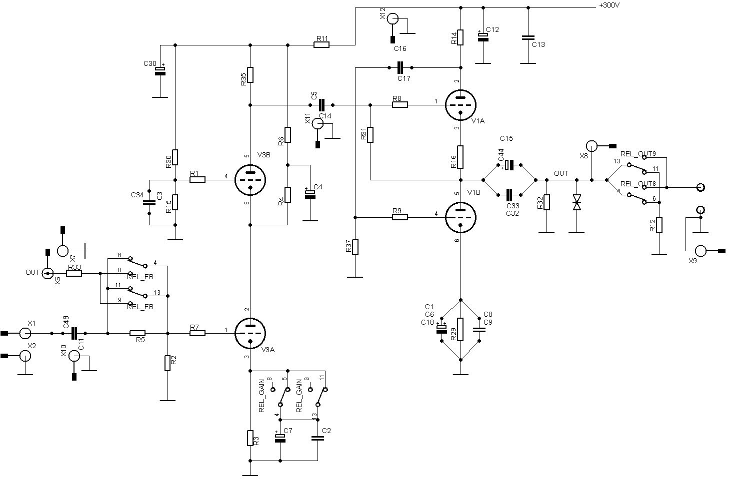

R6 serves to discharge C1?
Exactly I use 0.47uF dor interstage capacitor.
So does R36 as drawn.
It's input cap will be in series with the output cap.
Yeah, so you still have 0.47uF feeding a 10K load.
I guess 150K.
Provided the subwoofer has a 0.47u input cap, which would indicate a 33Hz -3 point. In reality that's way small for a input cap on a sub.Yeah, so you still have 0.47uF feeding a 10K load.
I just built a 12SN7 buffer that uses 100u coupling caps (it feeds a 1k load).

A 6SL7 is a horrendous choice for that design. That's way, way too much gain. They also tend to be microphonic. I suspect with a better choice of driver tubes, you wouldn't need separate B+ supplies for first and second stages.
The DC heater supplies should not be necessary.
The cathode loads on the 6080s will burn up most of the available signal current rather than the load. This is also a poor design choice.
