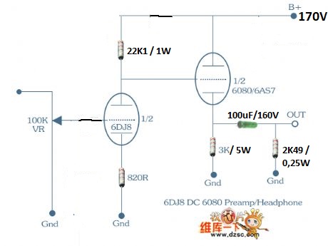

Finally got a couple of winged Svetlana 6H13C, I found on the net several schematics using as first
stage ECC88/6DJ8/6922, 6SN7, 5687, wich one have the best sound quality?
The 6DJ8 circuit has a way too small output capacitor.
Thanks guys, really appreciate the help.

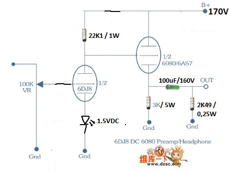

you can improve this nonsense by implementing ccs instead Rc endstage
For 6H13C?
How?
What impedance headphones do you intend to drive? All of those circuits would do a terrible job of driving modern low impedance headphones.

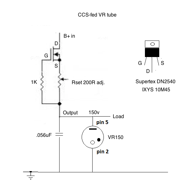

If you insist on OTL tube circuit then look up "super triode." This is a configuration where a triode controls a MOSFET. Bias it with a CCS.
If you don't know how to do this, then build a simple op amp based headphone amp. It'll work a whole lot better.
And don't rely on circuits on the web. That first circuit is oh so poorly thought out and wouldn't work properly even as a preamp. (f3 = 159 Hz STUPID) Somebody didn't put their thinking cap on, because it could be massively improved just by changing a few component values. What a waste.

OTL amps using the 6H13 are an insane waste of iron, space and energy, dual is even worse.

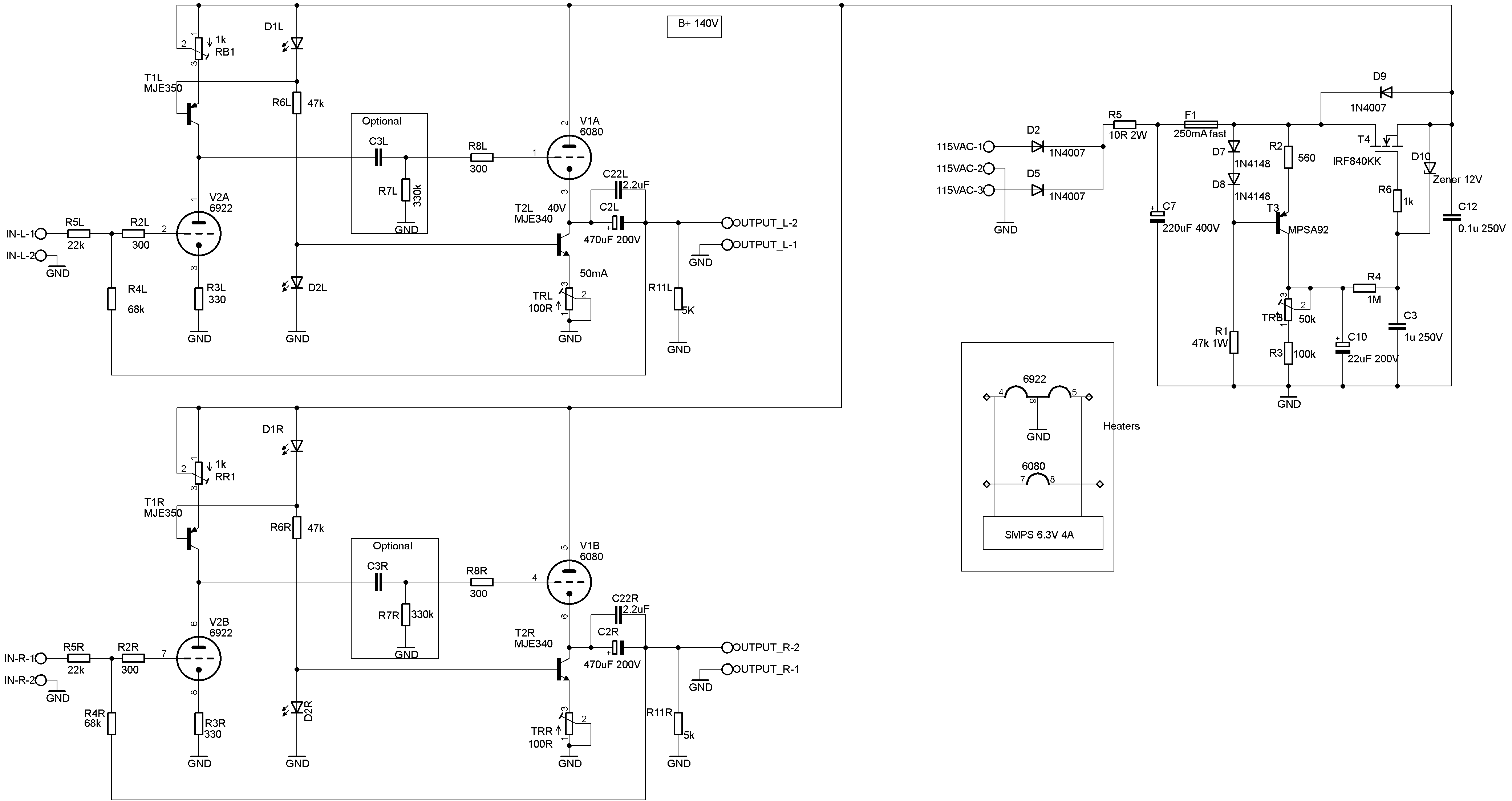

http://www.diyaudio.com/forums/tube...dphone-project-ec88-6080-a-8.html#post3834514
Have a look. Only suitable for highish impedance headphones.
This one?
Yes. Constant current sources optimize distortion and increase power output, while the signal is handled by the tubes. It's an inverting circuit with global feedback.
From what I can see, the designer covered all his bases. Might need some tweaking; I haven't built it.
