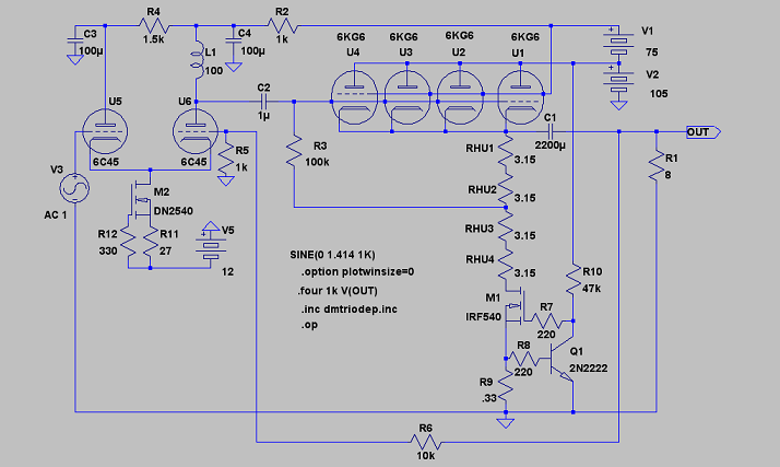

revintage said:My guess is you will get 0,5W, 5%THD, 8ohms.
Hey Lars if you get a moment could psot the formula you are using to determine this as I can not come up with a similar number and i am sure i am missing something somewhere. Thanks
revintage said:Used LTSpice to find swing, then Urms^2*Rload. Gives quite predictible figures.
Not familiar with LTspice so please forgive me if I ask to much.
Are you saying you took say the expected input voltage (+/- 2v) x it by the swing of the 6SN7 and then used the above formula?
Because I used P=VI and came to 1.5w.
Thx
Did a quick calculation of gain in your 6080s and cameup with 0,2x. This because the load(8//64ohms) is so much lower than Zout at ca 25ohm.
To make good calculation you must also involve UaIa-curves.
But they should give the same result as Spice, as the mathematical models are based on the same UaIa-curves.

Why go for these odd tubes? Go for 6KG6/EL519!
I have a box with at least fifty PL509/519.
Five per channel would be just about enough to keep a smile on my face until the electricity bill hits the mailbox...
