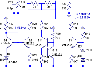

Here is my Goldmund clone (actually it doesn't have to be called a Goldmund clone just because the topology is the same) using led based ccs of 1.949mA, giving JFET source voltage of 2.6182V.
I created other 2 or 3 ccs that will give the same current and voltage, and compared them in LTSpice. To be fair, all ccs uses the same 2N2222 transistor. It is not that fair actually, because the amp has been tuned with led-based ccs in place (and the ccs itself not yet fine tuned to put the transistor in good operating condition). But anyway...
I was surprised that the led-based ccs outperform (tho microscopically) the ccs next to it. And was terribly surprised with the performance of the Goldmund Mimesis style ccs.
The Mimesis ccs gives very high distortion to the first stage. It can be seen from Goldmund amps simulation (especially Metis3) where first stage distortion is very very high. Theorists will say that it doesn't matter as long as the final distortion is fixed by feedback. I just used my voodoo skill and decided to get 0.1% distortion from the first stage

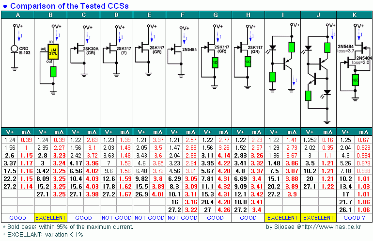

Here is a collection of different CCS.

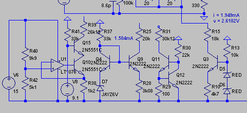

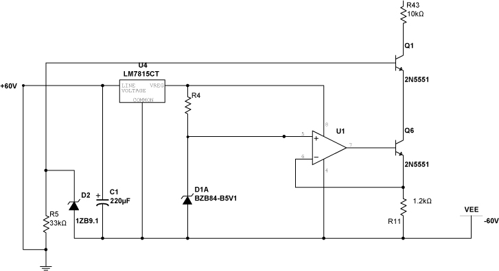

OPAMP vs LED

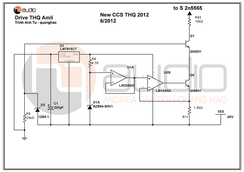

I just quickly simulated Quanghao ccs using LT opamp as shown in attachment. I tweak one resistor to output comparable current (1.949mA) and there is no improvement in distortion. In general frequency range, the opamp-based ccs has slightly lower noise. At 2kH and above the opamp wins very slightly. At bass frequency, the led-based wins. I think I prefer the led-based, unless I can tweak the opamp ccs to perform well at bass frequency.

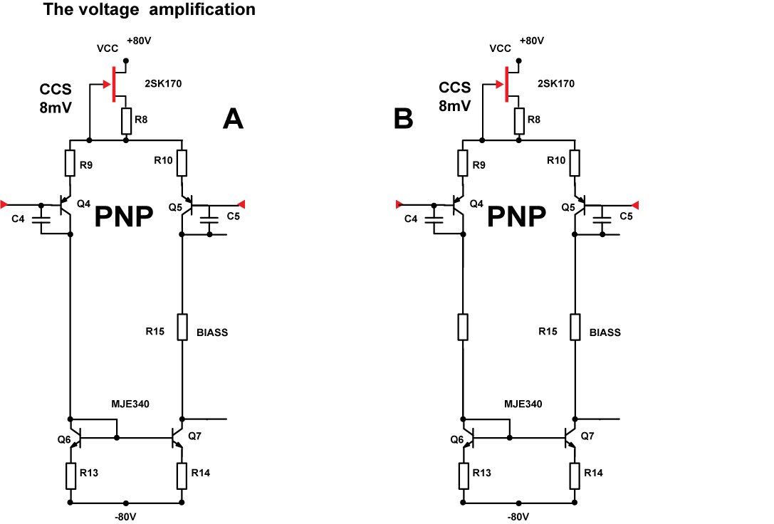

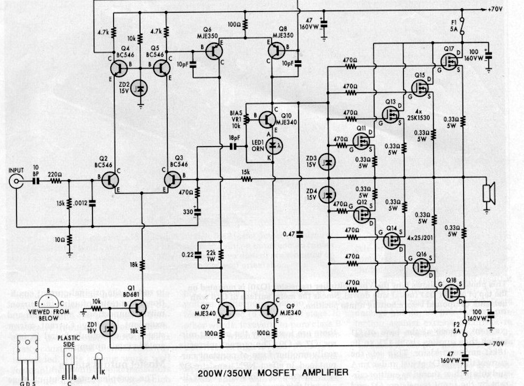

this amplifier, may be i can copy?? it is one idea!
What idea do you want to copy from that amp? It is pretty standard.

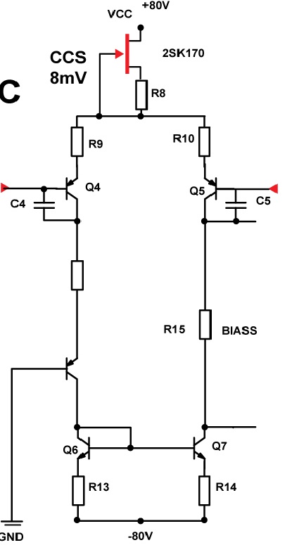

The voltage amplification, I can get A or B, C
How do you say about it!
I think balanced operation ensures linearity. So #B or #C, whichever that works.
I'm struggling to find out what will make an amp with good bass performance. From practice, amps with #C have good bass, so may be there is something in it. I'm not there yet.

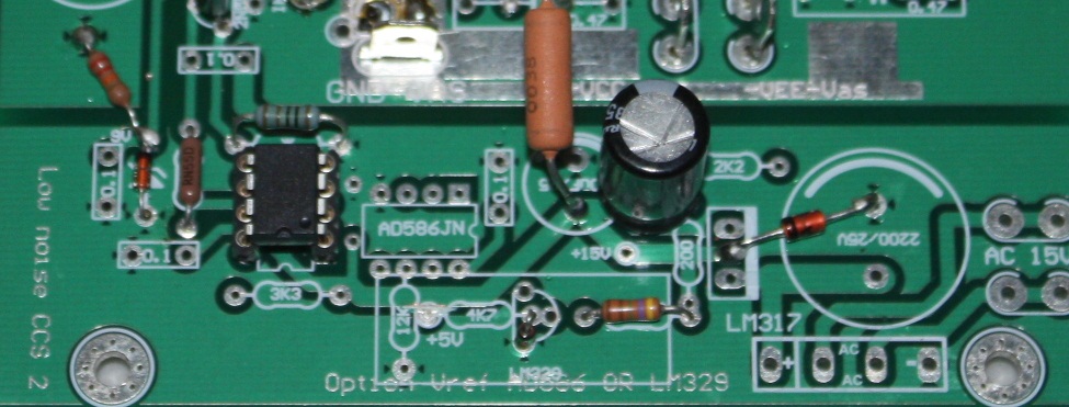

nice overview.Here is a collection of different CCS.
The associated PSR curvatures I had also seen anywhere here on diyaudio before. Unfortunately I haven't save the file.
teifbassuebertr, I think this is the one.
i like J or CCS,
thanks

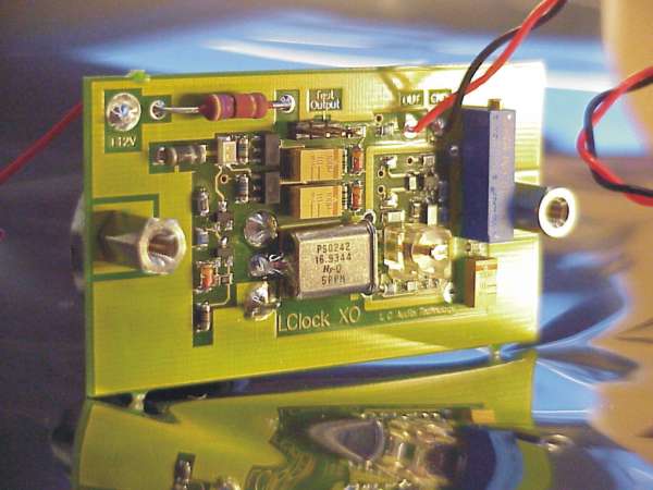

No, but nevertheless also helpful - thank you. There is an other variation found by LC technologie's "LC-Clock" in the atachment.teifbassuebertr, I think this is the one.
