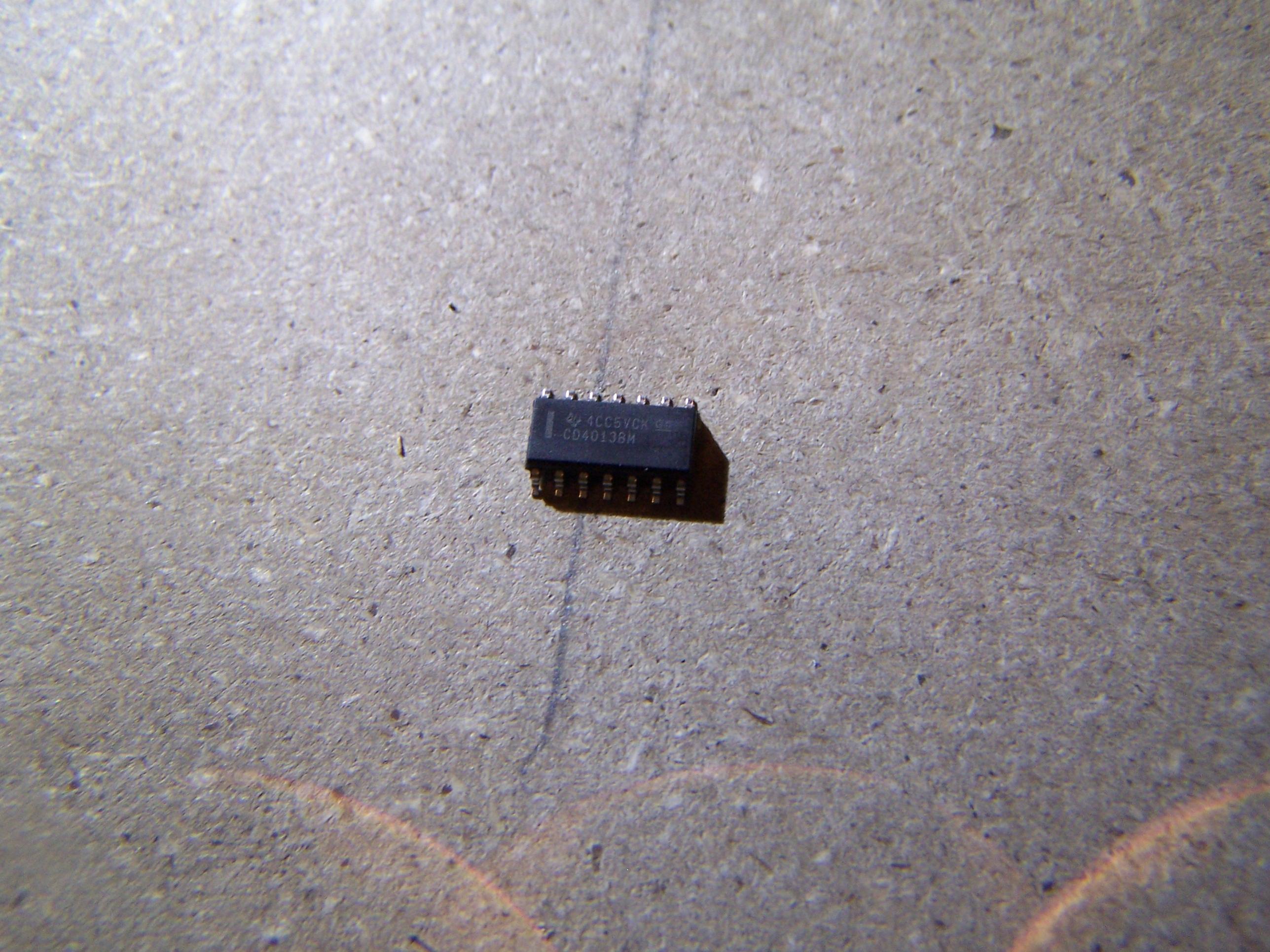

So I finally got at this project last night, got my resistors soldered on the SG board.
Go the caps soldered on the rotary encoder board, so far, so good.
I would like to ask if someone could verify that this is the correct IC for the encoder board though.

So apparently I have the Chinese version of the Texas Instruments IC.
It only has a printed bar across the body at one end for a reference for mounting.
Is this the O end?
Sorry to ask what I am sure is a stupid question, tried to find some info on the web first and everything I found, they referenced a dimple or dot.
Is this the O end?

Looks like I have reached a brick wall with this project.
I can not even see what I am soldering with this surface mount stuff let alone if it is soldered correctly.
I even have a magnifying glass and reader glasses
Christ it sucks getting old.
