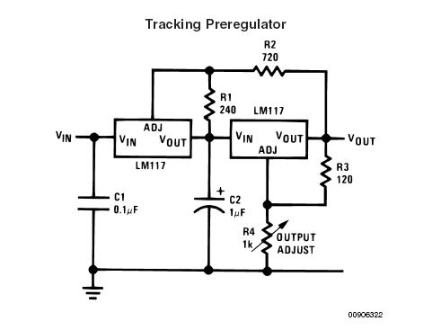

Bricolo said:apassgear, can you post the shematic of the regulator you want to use (the circuit after the clclc+lm117)
what about this regulator, taken from national's lm117 datasheet?

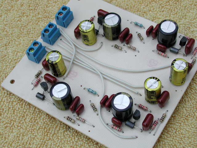

Instead of posting the schematic, that I have not prepared, let me show a pic of what's going on beyond the pre regs.
Most of the parts on top of the board are the 4 regulators (+-5V) one each polarity for each OPA660 (SOIC) which will be mounted on the copper side of the boards.
You can see on the first plane corner the regulator plus all the caps and resistors requiered.
A short explanation of each regulator is a 1000u filter (gold colored) bypassed with a film .47u next is a 100 Ohms series resistor that feeds the regulator, two resistors forming a voltage divider for setting the reg voltage. Next is a ferrite bead on a jumper that feeds the decoupling caps first one lytic 220u 50V Panasonic FC (dark blue one) next 10nf and 470pf both polypropylene. And once again, if you have missed that part the regs are LT431 well known on this forum.
Have not mounted the OPA's since I´m checking the regulators with a resistive load for some 15 mA.
Found out that 3 of the 4 regs were out of spec. some noise at arround 50KHz, but these parts were from NTE (NTE999) which are relacement parts supposly good ones. But most surely are scrap from the manufactures and rebranded out of spec parts (after this experiance.
But the good news is that I got some genuine TI parts (LT431) this afternoon. A real surprise to get these parts on this town. I was lucky.

what is the active regulation part in your circuit? I don't think a 431 can give enough power
