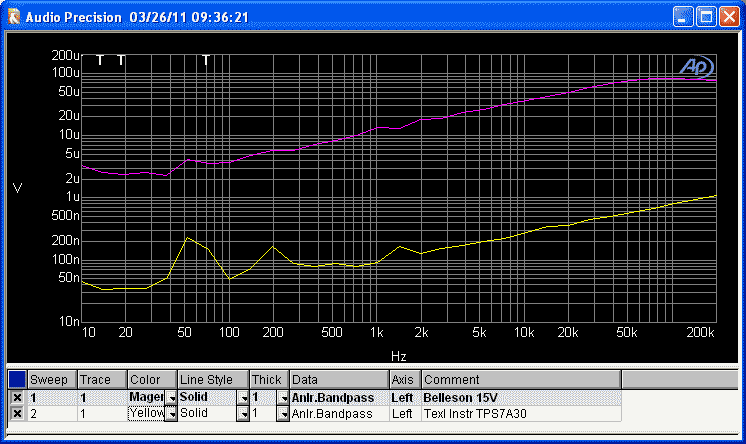

How about this quite inexpensive item from Texas Instruments -- TPS7A3001unmodified, in its completely natural state:
Is the photo depicting inherent noise of the regulator?
Belleson has two characteristics that these inexpensive regulator cannot provide: high current and high noise rejection. I was using their 1A version back then and now their 2A version. The 2A version can support 3.35A easily and can be modified to support 4.6A. The noise rejection is -110db from 20Hz to 40KHz. The same cannot be said for monolithic IC regulators.
I plan to measure the Line Rejection and Output Impedance of the Belleson. In the interim, the chart on noise speaks for itself.
FWIW, the test setup for noise is the same as the 1995 TAA articles, save that the AP SYS2722 has a much lower noise floor vis a vis the System One which was used in 1995. It is helpful, however, to still use the 100X balanced amplifier and get the measurements out of the weeds.
