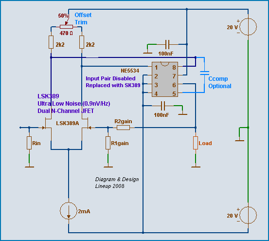

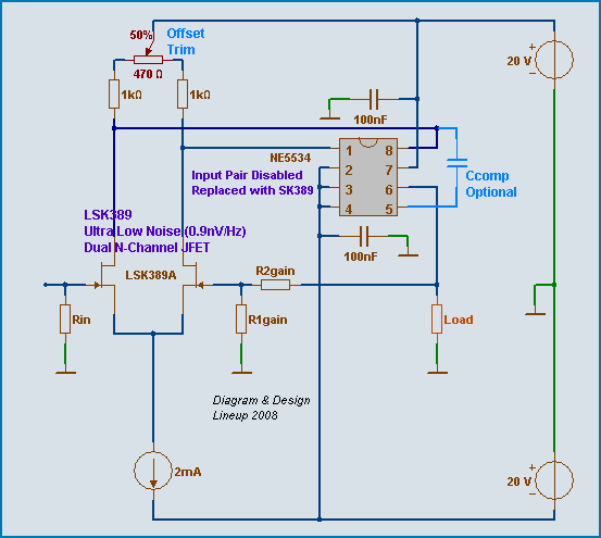

Like I have shown before and in Attachment example.
Shows my own custum JFET opamp input LTP.
(The weaknesses of NE5534 are not many. But in order to minimize bias current & noise the LTP pair in NE5534 is biased as low as ~75 uA per transistor.
I think I made a measurement long ago, indicated this level.
Of course this have also some negative effects = Lower slewrate, lower Bandwidth.

Hi lineup -
Voltage between 5534 pin 7 and 8, and pin 7 and 1, is about 2.5V when the part is used normally. 2.5 to 3.5V is OK with a custom LTP such as yours. The 5534 chip contains a 13k load resistor between pin 7 and 8, and pin 7 and 1. With your component values, expect about 1.13V, since the drain current is 1mA and the effective drain resistance is 1k+235 ohms in parallel with the internal load resistor. I suggest an external load resistor value of 2.5k per side and a 1k trimpot, this should give an effective drain resistance of about 2.5k and 2.5V across the load. The LSK389A transconductance of 10mS at 1mA is low enough for unity gain stability without an external Ccomp.
nuvistor said:
Hi lineup -
When I measured my NE5534, there was less than 1 Volt across 11 kohm (nominal 12k).
This indicates something like 300-400 mV across second stage emitter resistors.
Which makes sense to me.
I do not know if different manufacturers bias the input stage differently.
I would not think so.
My target in the schematic was 1.2k//12k ~ 1kohm
and 1 mA will create 1.0 Volt across each collector resistor.
Of course, looking at NE5534 topology, there is not much
that would stop us from increasing current in SECOND Stage, too.
A bit of experimenting would give a good answer :)

Increasing the drain resistor voltage drop too much will affect positive limit of input common mode range. I have tried as much as 5V with +/-15V supply without problems, using Signetics parts from 1980s, but then maximum positive input will be less than 10V. It's possible that different or newer parts have different voltage drop, experimentation as you suggest is probably best.
I had to measure again.
My NE5534 are Texas NE5534P.
You were right nuvistor. :cool:
I measured drop across input collector resistors.
I did this only at one examplar (the one I could find) and at
A) +- 5 Volt (10Volt). B) +-15 Volt (30Volt).
Result:
At +- 5 V, the drop was: 1.99 V
At +- 15 v, the drop was: 2.21 Volt
As these resistors are like 11-12 kOhm,
this gives NE5534 LTP pair runs at: ~ 165 - 185 uA each.
I have changed in my schematic. See attachment
LSK389 (2SK170 can of course be used)
input JFET pair runs at 1 mA each.
2k2 + 235 Ohm = 2k435
Parallell 2k435 // 12K, gives collector resistor: 2kOhm.
1mA x 2kOhm = 2.00 Volt
Which corresponds to my measuring.
regards :) Lineup

The LSK389 fets give lower noise than the internal bipolars in this case.
Usually, you hav e to look at your source source impedance to make the call. With JFET's fed from high source resistances, there is very little [noise current x Input impedance contribution], so you are left with jus t th e equivalanet input noise voltage, which at 0.9nV/rtHz is very low anyway. If you are using low source impedances (say <100 Ohm) the noise current on bipolars is not really a factor.
In the case of this proposal from Lineup, looks like the LSK389's will offer a lower noise floor across the board compared to the internal input devices. You can DC couple your input source as well with the FET's - nice touch.
* At medium source resistance( say 15-30 kOhm ), the noise will be at same level.
* At lower ( say <=10 kOhm ) bipolar can have noise advantage. At least compared to more normal noise JFET.
* Higher input impedances (like 47 kOhm and further to MOhms) will benefit from JFET input.
As we have almost no bias current,
even at higher gains, we will not have any DC-offset problems
caused by resistor choices. (not compared with bipolars)
I like JFET for this thing :)
Not much headache cancel DC-offset, caused by bias current + High Gain.
Now, if you have less good matched JFET pair (V-gs),
you will have to un-balance currents in input.
My Question :)
BJT needs good current balance in input .
( D. Self show a difference of only 2% increasing Distortion by a level ).
Anybody knows how sensitive JFETs are to such un-balanced currents?
.. my guess is, that they are less sensitive ... but we should strive for equal current ..
