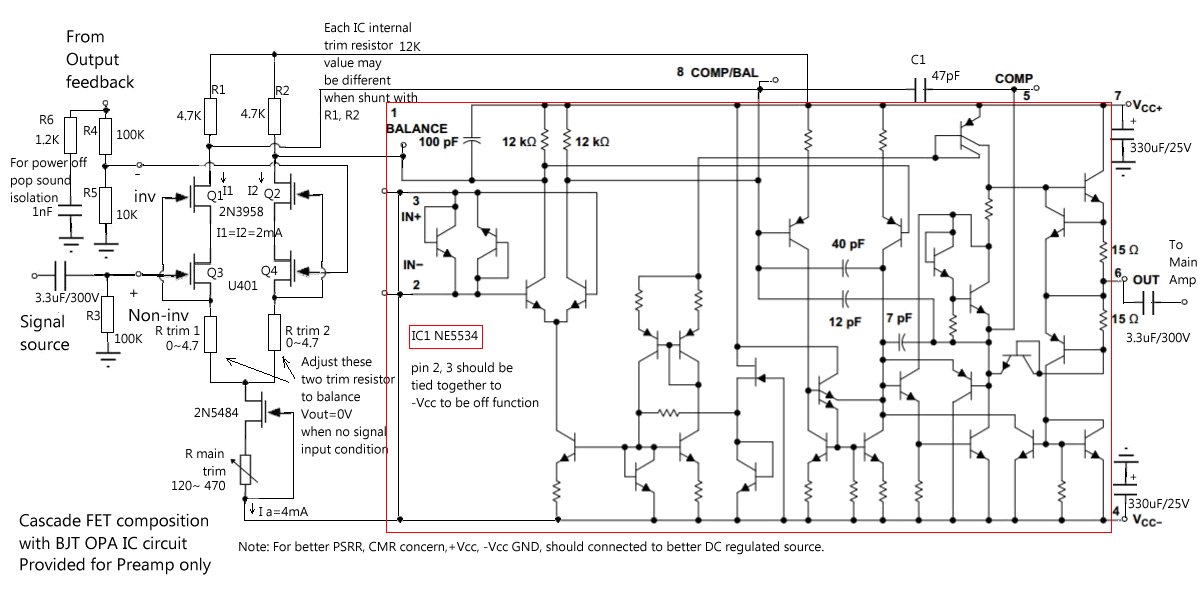

Share an earlier solution, composed cascade dual match FET with NE5534
This has been an old forum in discussion NE5534, JFET OP which ones feature and performance is better long time ago.

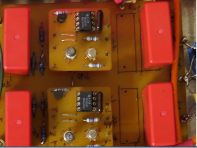

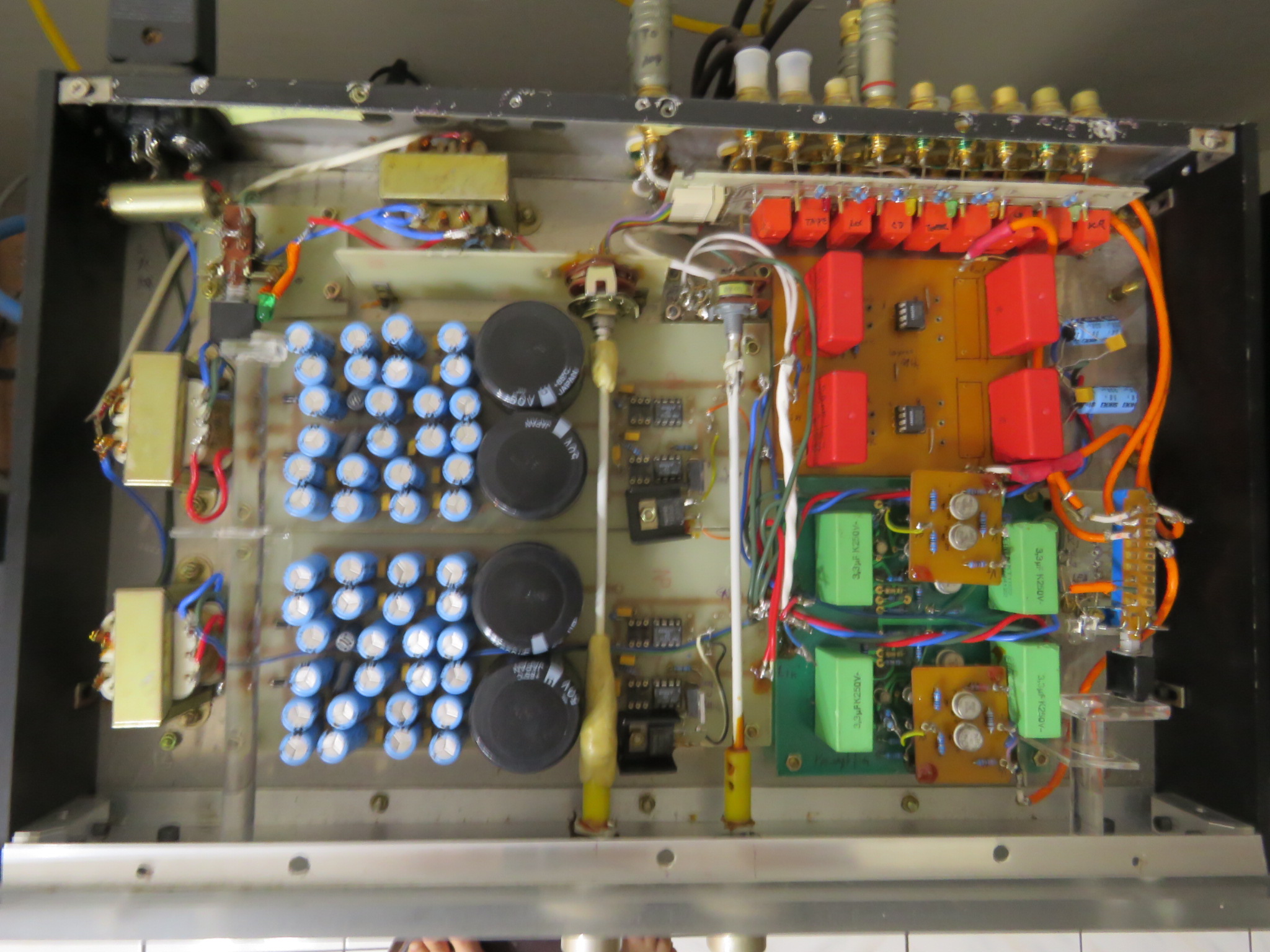

Here, I would like to share the subject experiment I done 20 years ago. Using Cascade dual match JFET conjunction with NE5534 is indeed workable and function stable. The sound performance combined these two kinds OPA main feature without much parameter sacrificed. ( sorry, just by ear test that time)

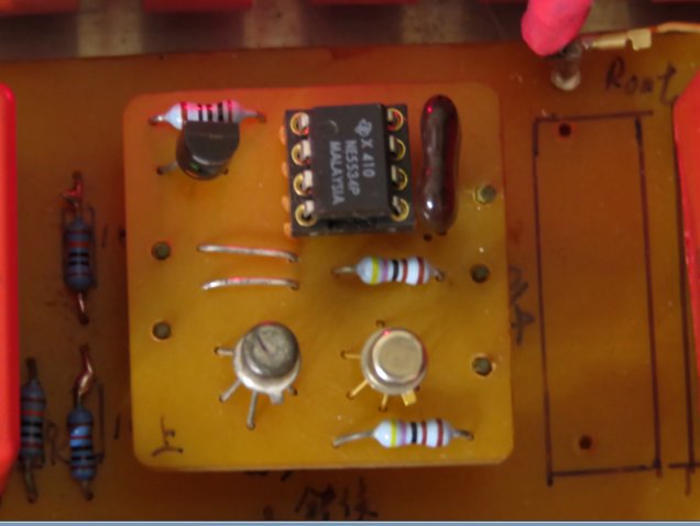

I made a substrate PCB with an empty 8 pin socket and 5 pins hole socket, to easily plug in/ out device test. An Av=10 gain was set feedback to input inverter terminal . Non-inverter terminal just tied a resistor to ground.
The composition of Cascade FET & NE5534 board, so called hybrid board, it is made by only 3x3 cm square, with 5 pins terminal. ( see fig 1, 2 following)

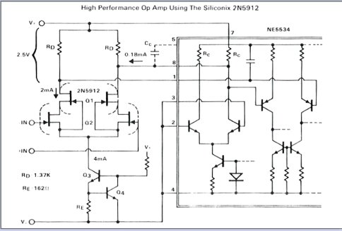

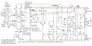

Hybrid circuit mainly follow the instruction of Siliconix appendix ( see fig.3 below), however, revised BJT constant current driven portion, substituting it by using a FET source follower~ by connecting a resistor between source and gate, minor adjusting the value of this resistor would decide constant current of first stage FET driving. Two drain resistors were connected with NE5534 Pin 1 and Pin 8 separately, Pin 2, 3 are connected to Vs- as an off function set.
The same hybrid boards have been deployed by several types, in order to compose with different device, i.e, LM318, LF351... like OPA627 internal circuit, with three stage signal driving and conversion. All of these effort was to try, figure out any better, compromised sound performance could be researched and also for experiment enjoy.
However, to reach such high standard sound quality, containing a mutual advantage of BJT and FET OP feature, certain extra, medium cost should be paid for. Dual match FET is expensive too.

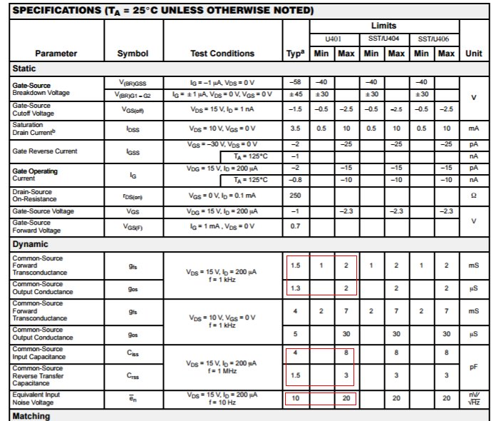

Especially, u401, 2N5911, LSK389/ 489.., these devices were made by BI-FET junction, with equivalent ultra low noise, low input capacitance, low input drift voltage parameter baring higher cost too. Fortunately, the cascade source follower dual match FET seemed no need to use Ultra low noise grade device. Using 2N3958, low cost unit should be good enough.
Under no signal situation, the output voltage is below 0.1V ( 100mV). By accurate adjusting the source bias into balance situation might help to reduce this output offset voltage. This also bear another extra work for parts pre-sorting, insert a tiny value of trim resistor setting.
Obviously, prototype sample making are always difficult to compete those industry mass process ( ie, laser trim process of OPA627) product. When engineer become hesitating doing this, time is money, people become to believe that using those high standard industry grade product is acceptable without doubt. Of course, when time goes by, next generation people will not remember what is NE5534 this device anymore.
The subject present an experiment, if you don't like or don't trust something, you have to face, to change it; nevertheless the result is good or bad, you have to proof and do that to convince yourself. The experience told me, this just for fun, nothing related to make money, when I was retired someday, I should remember all this process.

Look at the NE5534 internal design. You will see that the PIN5 is the direct output of the internal VAS. That opens some possibilities like I mentioned before. You can use the PIN5 directly as output, and omit the class B output stage of the NE5534. The VAS will be mostly in class A. This output sounds far superior, but one must be sure that the current demand of the following stage isn't so big, and one must avoid shortcut's.
Second once like also mentioned before one can increase the class A range by adding a current source to pin 5 or simply a resistor from pin5 to V+
