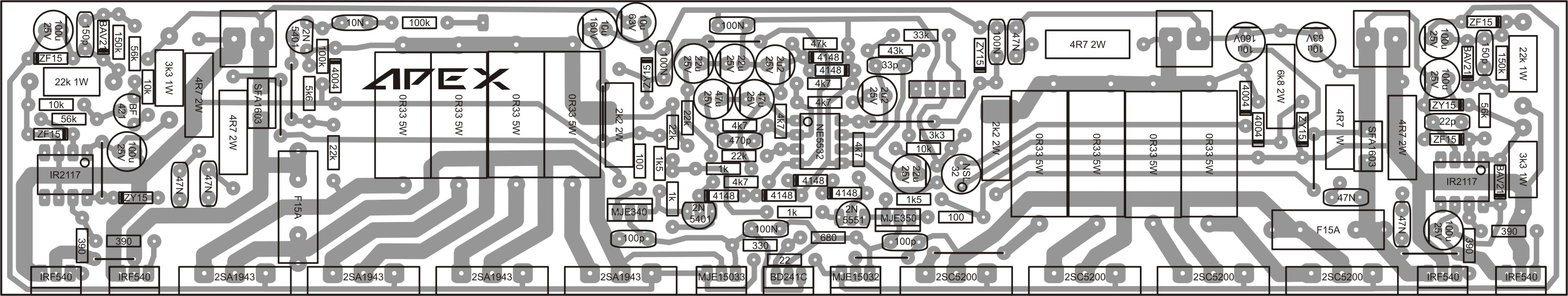

please post b500 component landscape with traces shadow like this h900 please

Is the component labeled 12V 16A in the soft start a dpst relay? Also, where does the +/- 30vdc come from? It looks like no power from the mains until the 30vdc comes in. Sorry if this is a stupid question; I've never had to build this type circuit until now. Is this circuit absolutely necessary? Thanks for any help. I'll be etching boards this weekend.
30VDC for soft-start relay you have from protect board useing +/-15V without GND. Without soft-start main fuse will blow when transformer powered up. QSC use 1R 10W NTC on some amps instead soft-start circuit.

Hi Apex..I just finish built P500 from P900 without step-up driver..and with jumper as yours intructions..
Testing with toroid ct 47vac, elco Philips 17.000uf/100vdc x 2, and dioda bridge 40A...
Result..on tone control positioning 9 o'clock..sound (low, mid, high) is clear, detail, beautiful...but on positioning 10 o'clock..low unstable...What is wrong??
