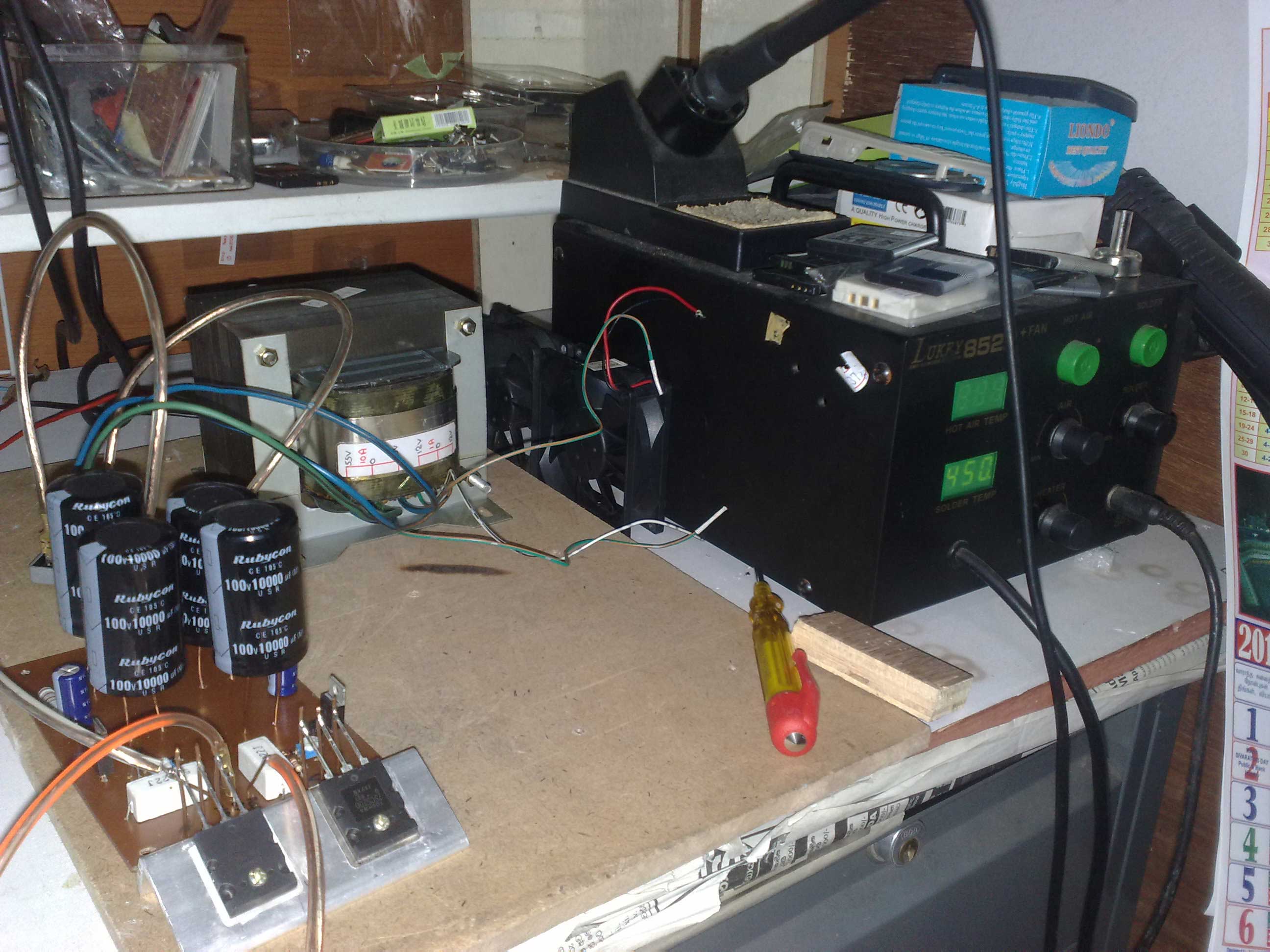

hi apex sir.
today i checked the amp with regulated power supply. i set to 75v dc. but no worth, same heat then i off the power.
so i set to 55v dc then in the power supply resistor 2.2k 1w getting very hot. so what is the solution?
If you don't want heating resistors use separate +/-15V DC PSU without 2k2/2W resistors and 15V zeners for suply NE5532 and unregulated +/-83V DC PSU for suply amp.
Regards
Regards

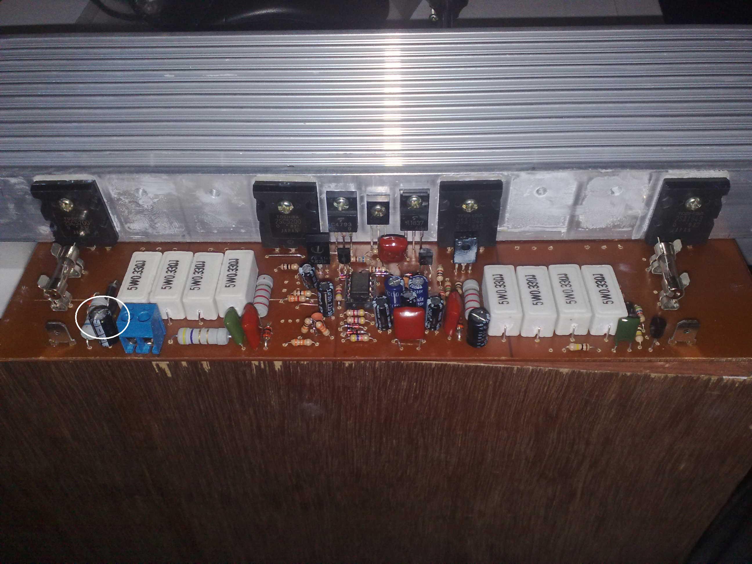

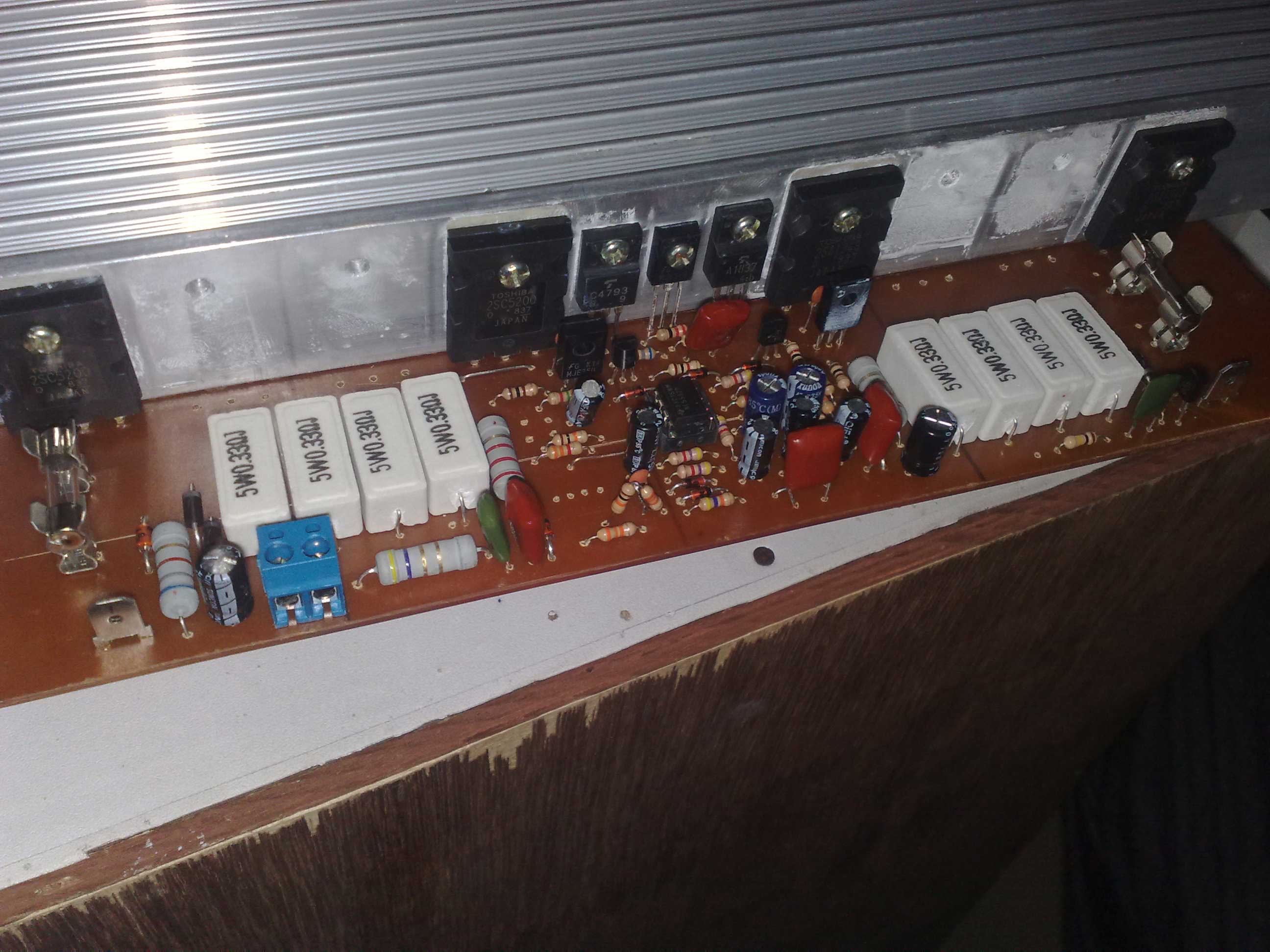

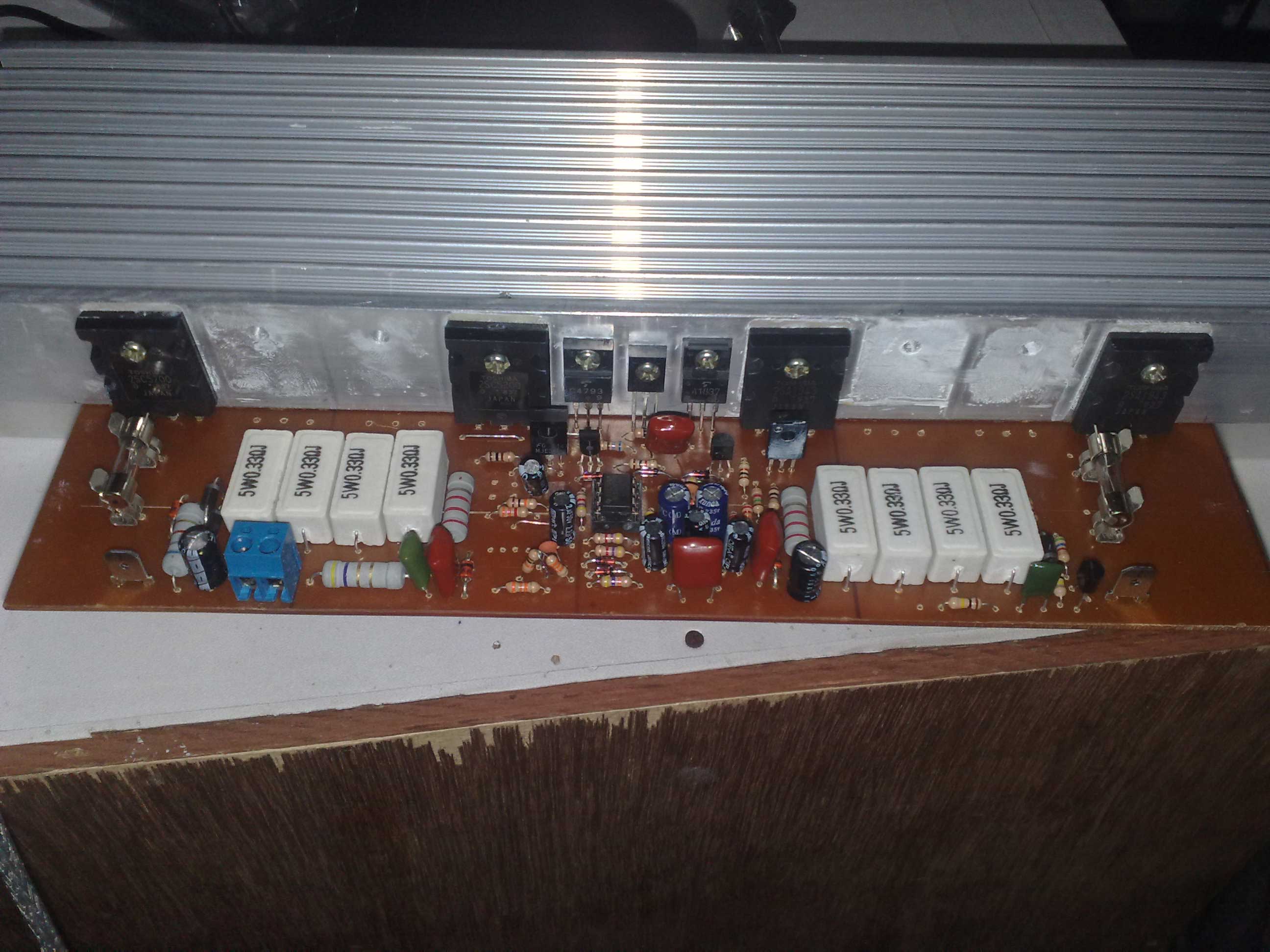

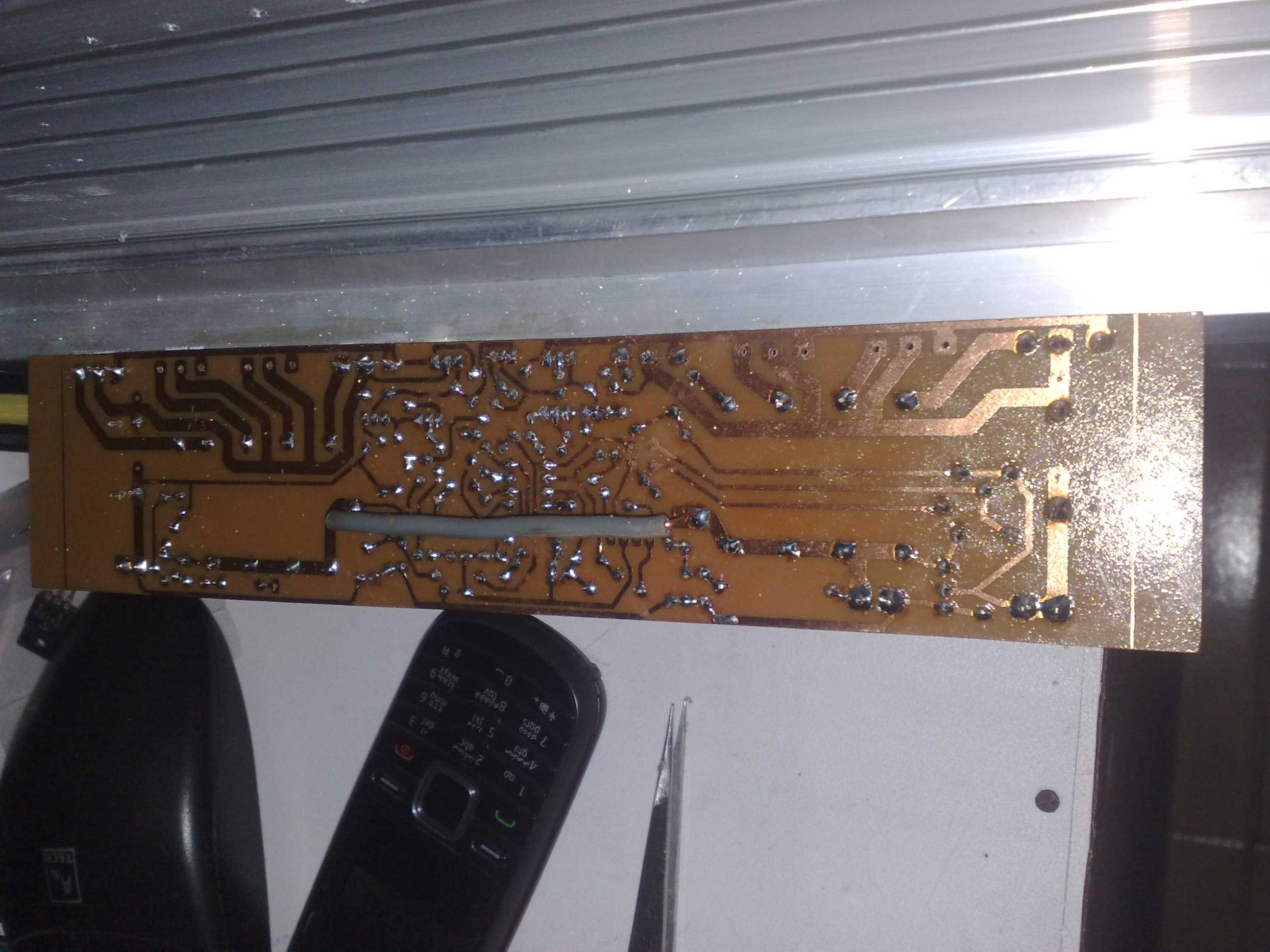

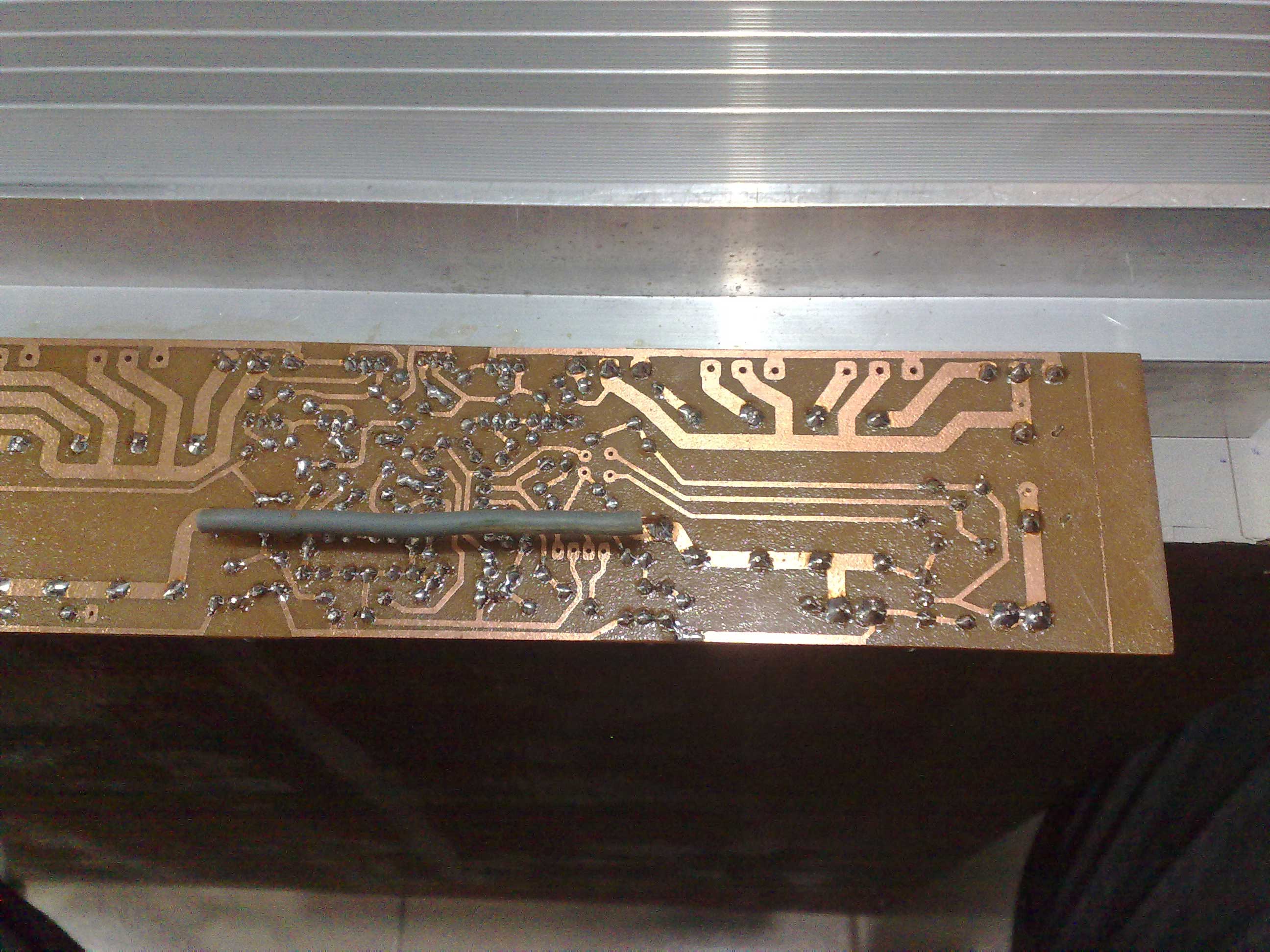

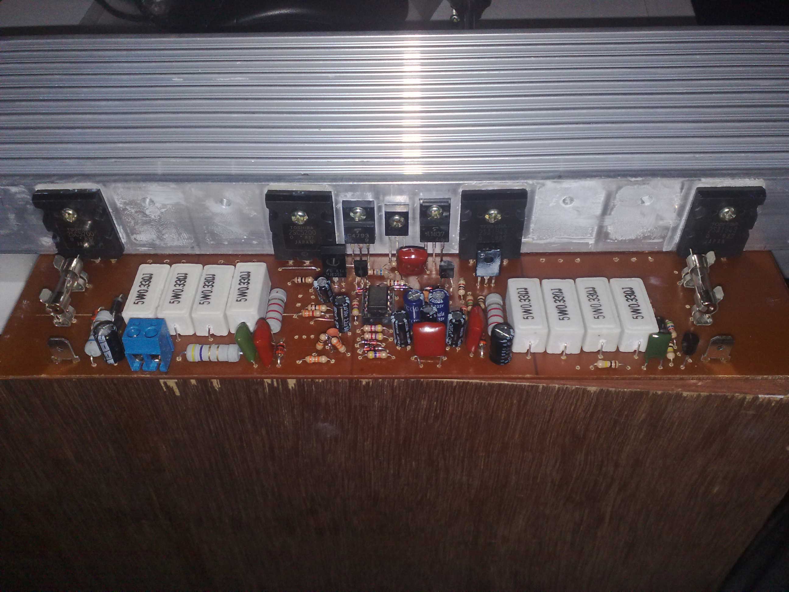

hi apex sir,
today i prepared the second channel of the amp.
i put two pair with 55v dc supply with 10a fuses.
after power on one of the part is burn, the smoke is gone like a rocket.
but i cant see the burn part. but the parts are very clean.
there is no darken marks in the board.
here are the photos.

10uF/100V is burn, and you have fake 2SC5200.
Regards
Regards
thank u sir.
what purpose it will blow.?
Regards
Yep, there are no doubts. You don't even need to smash them open. Just look at them. nazirdigi, I'm afraid you are a victim of counterfeit transistors and that amp will never work unless you buy original devices.
thank u sir.
Bad part...

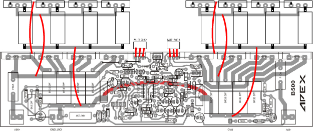

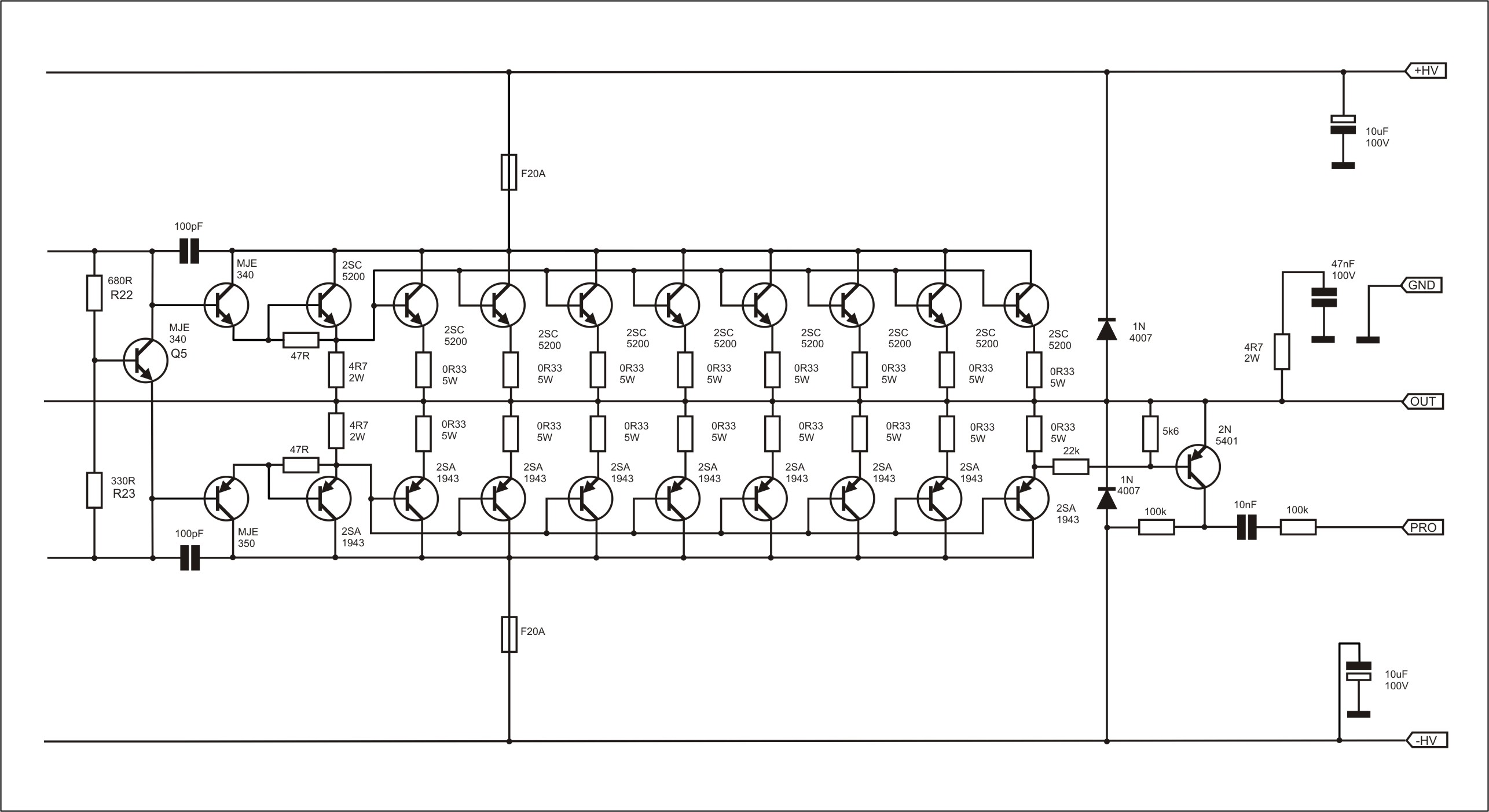

hi apex sir .
for 2 ohm load how many pairs to add, because for long run and heat.
Add 4 pairs, and add pair of drivers.
Mr. Apex, How much watts can produce with trafo 15A, ac 56-ct-56 (this trafo i use for 2 chanel/stereo).....Regards
This is 1680W trafo, can be use for 2ohm load stereo.
thanks for the reply sir.
IS this correct sir?
Use this circuit...
Use this circuit...
so the drivers are 2sc5200 and a1943.
