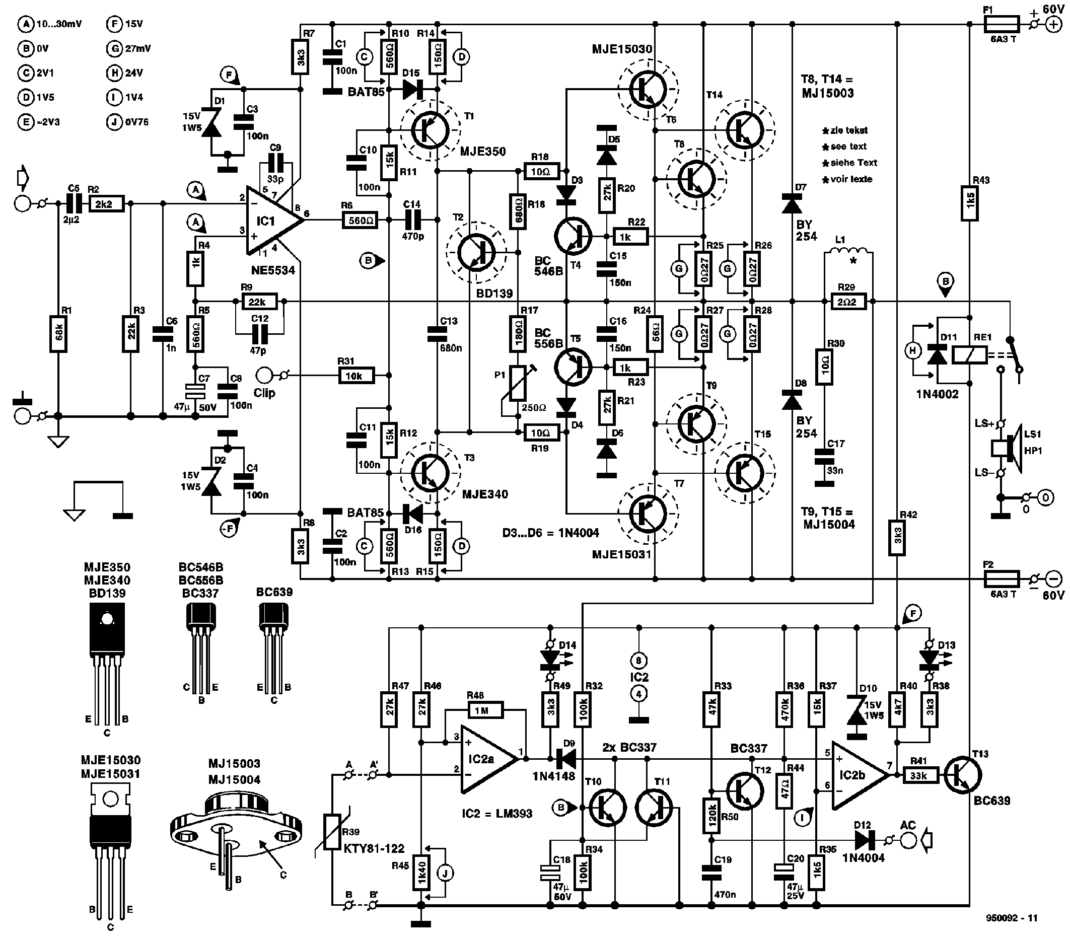

hello sir apex now my fan is running on full speed at 60 digress .. i want full speed at 50 or less pls tell me what to do?
thank u ....
Change resistor 470R with 510R in '60deg fan high speed' circuit.

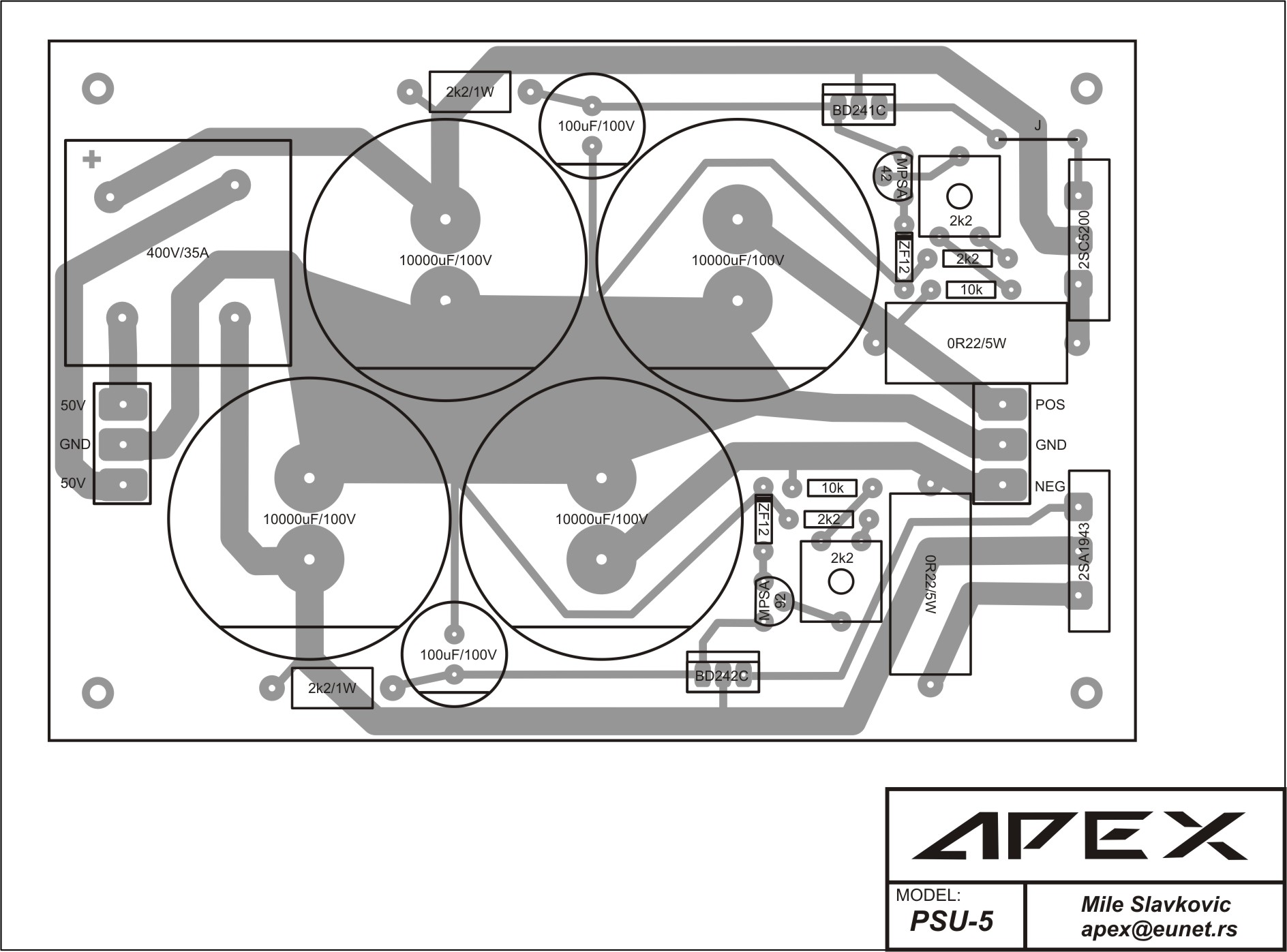

Hi, everyone.
I want to design and make amplifier that can push 3 speakers par channel. I used PA300 schematic to draw PCB, and add some more output transistors.
Apex, AndrewT and others who want too help, can you plaese look PCB and suggest me if there is something that I need to ADD,REMOVE or CHANGE VALUE before making PCB, so amplifier can work normal. Thanks.
Regards
Regards
