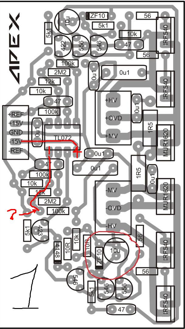

i hope mile will confirm this before ill put the step drive in to my b500 thanx for the info

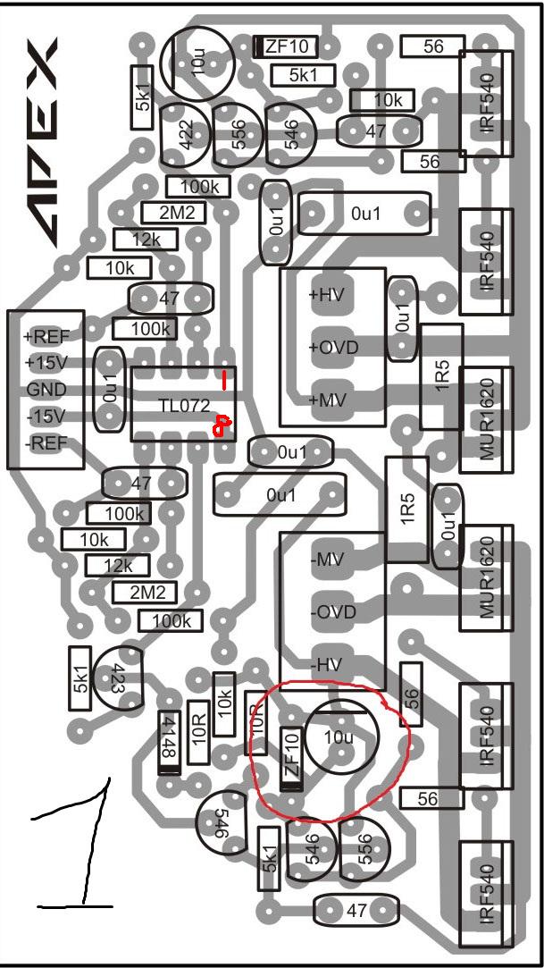

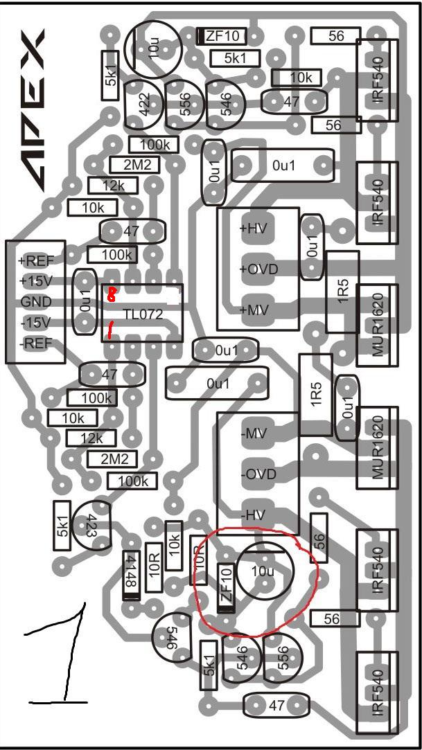

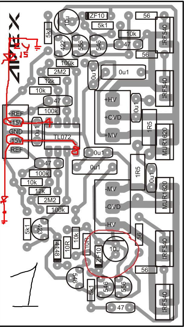

tekko,ur mixing up the pins, its mounted with pin 1 facing the connector.

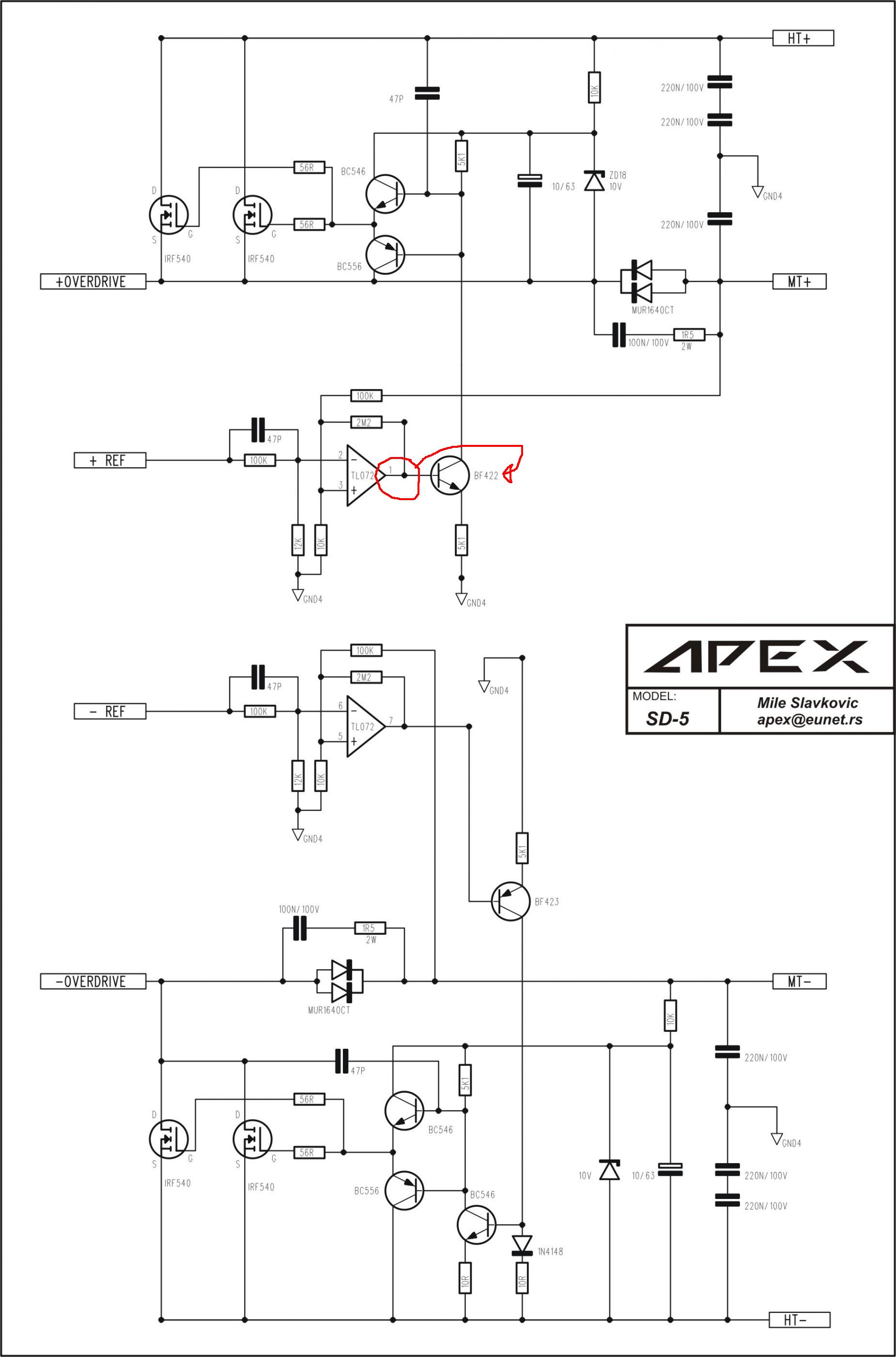

evaluate the schematic if you follow the posted supply how can output pin1 go to bf422?

please show i.c. pin clearerhi engel dela pena

please clarify tlo72 pin supply.

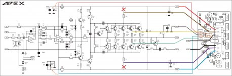

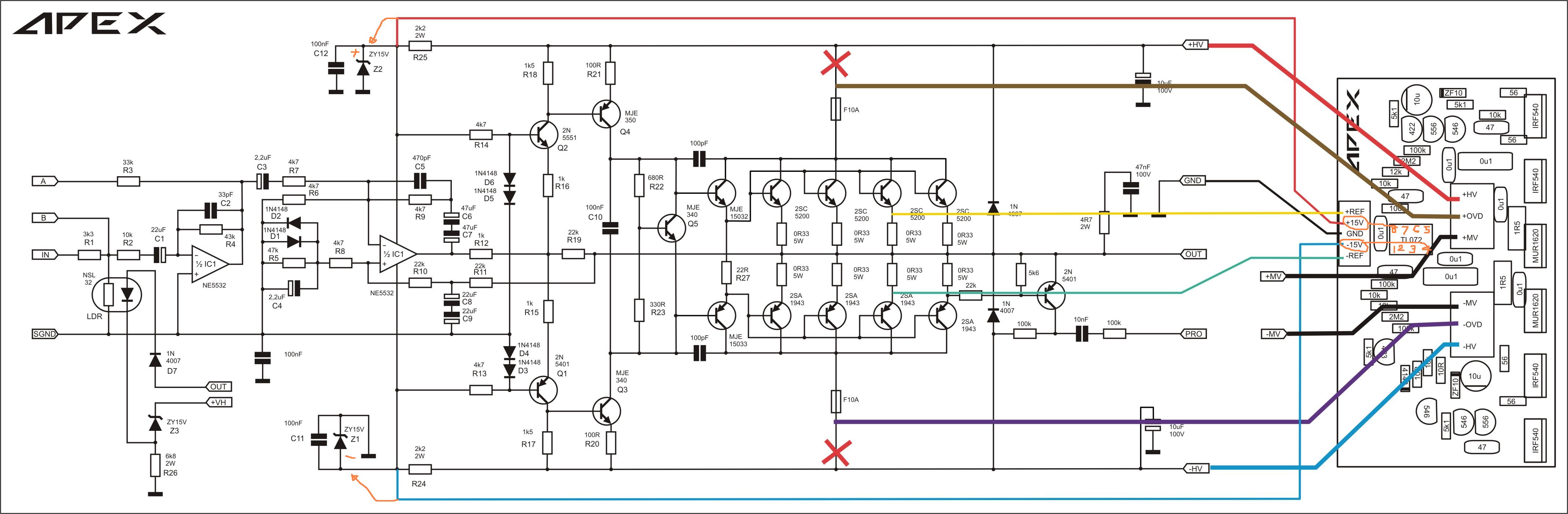

hi engel dela pena
greetings yes its tested working on real 1000 watt speakers
1 tlo 72 step driver ic gets supply from 15 volt zeners on b500 pcb
2 i use IRF2807 MOSFETS GET WARM MY HEAT SINK IS THICK SO make heat
sink thicker
3 check amp with tlo72 step regulator with 100 WATT BULB IN SERIES

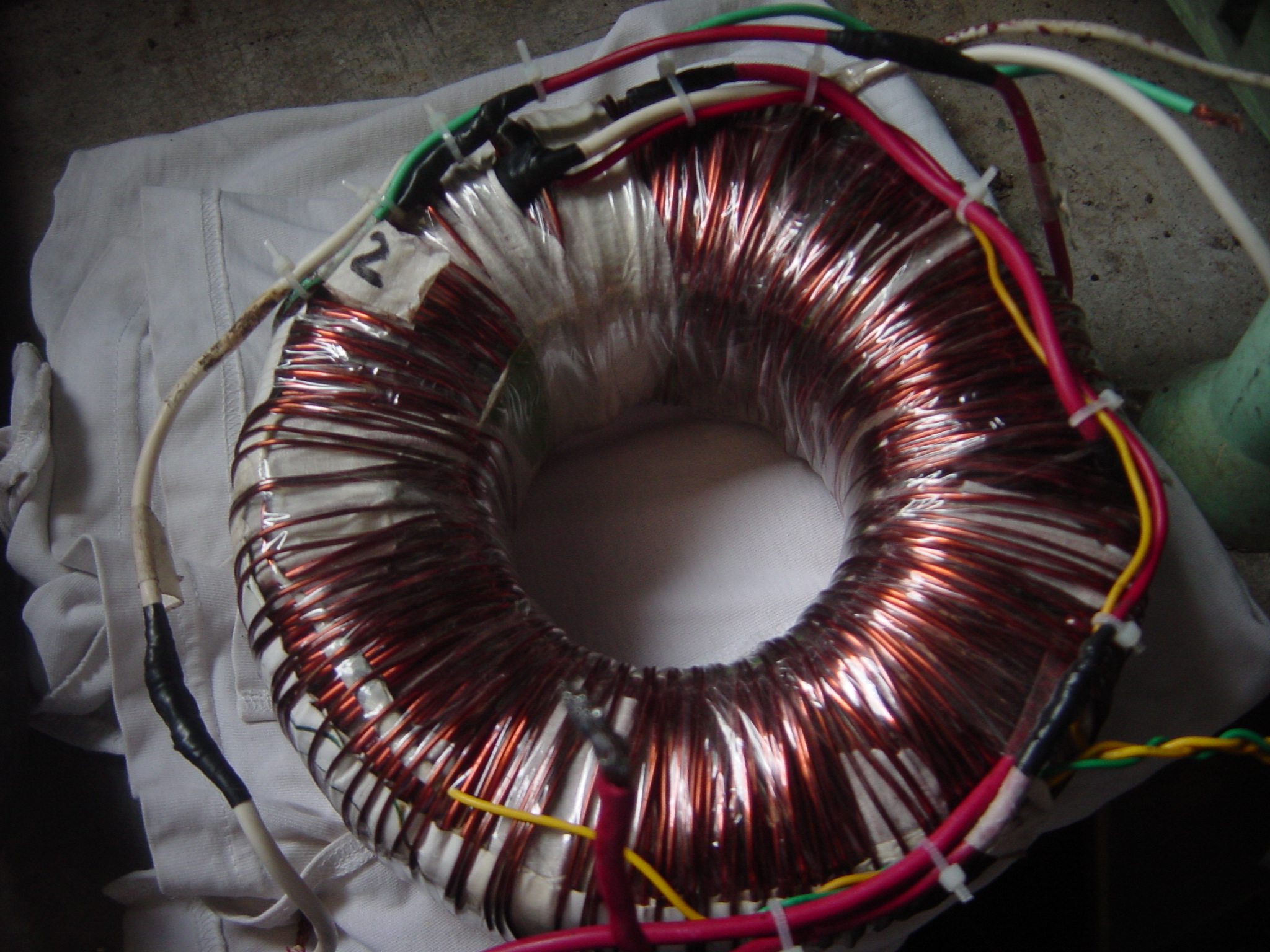

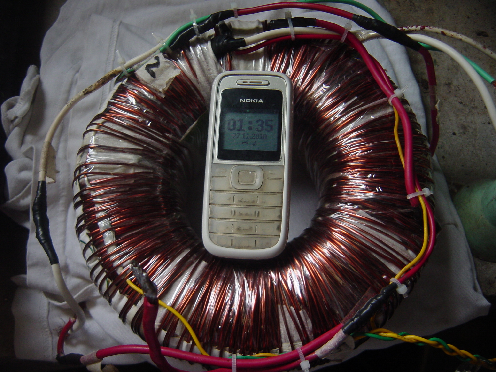

what transformer u use?its hard to find -+90v.what speaker u use?thanks guys

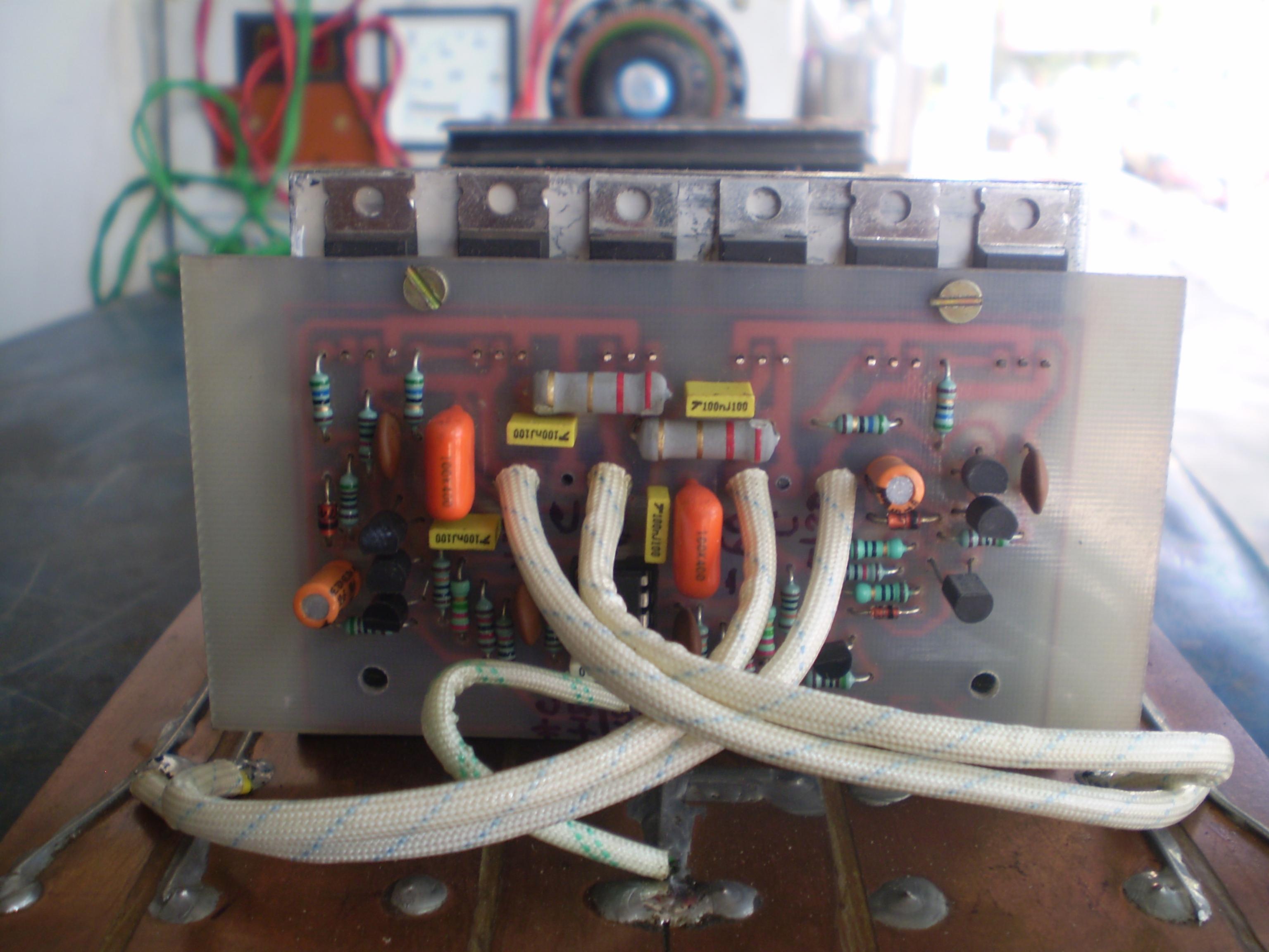

the amp is working well
two days of testing no overheating
very good sounding amp
mamak,
b500 supply is 40-0-40ac
torroid,
i bought it from a surplus shop w/o coil,
and recoil it,
only using locally made speaker,but sound is clear amp is clean,many builder already testify

one last thing mate.
w/c of this two is your pin 1?

thank you mate,hi engel dela pena
greetings well -15 VOLTS NEGATIVE GOES TO PIN NO
1 PIN NO 8 GETS 15 VOLTS POSITIVE once u use step driver u really feel the power
