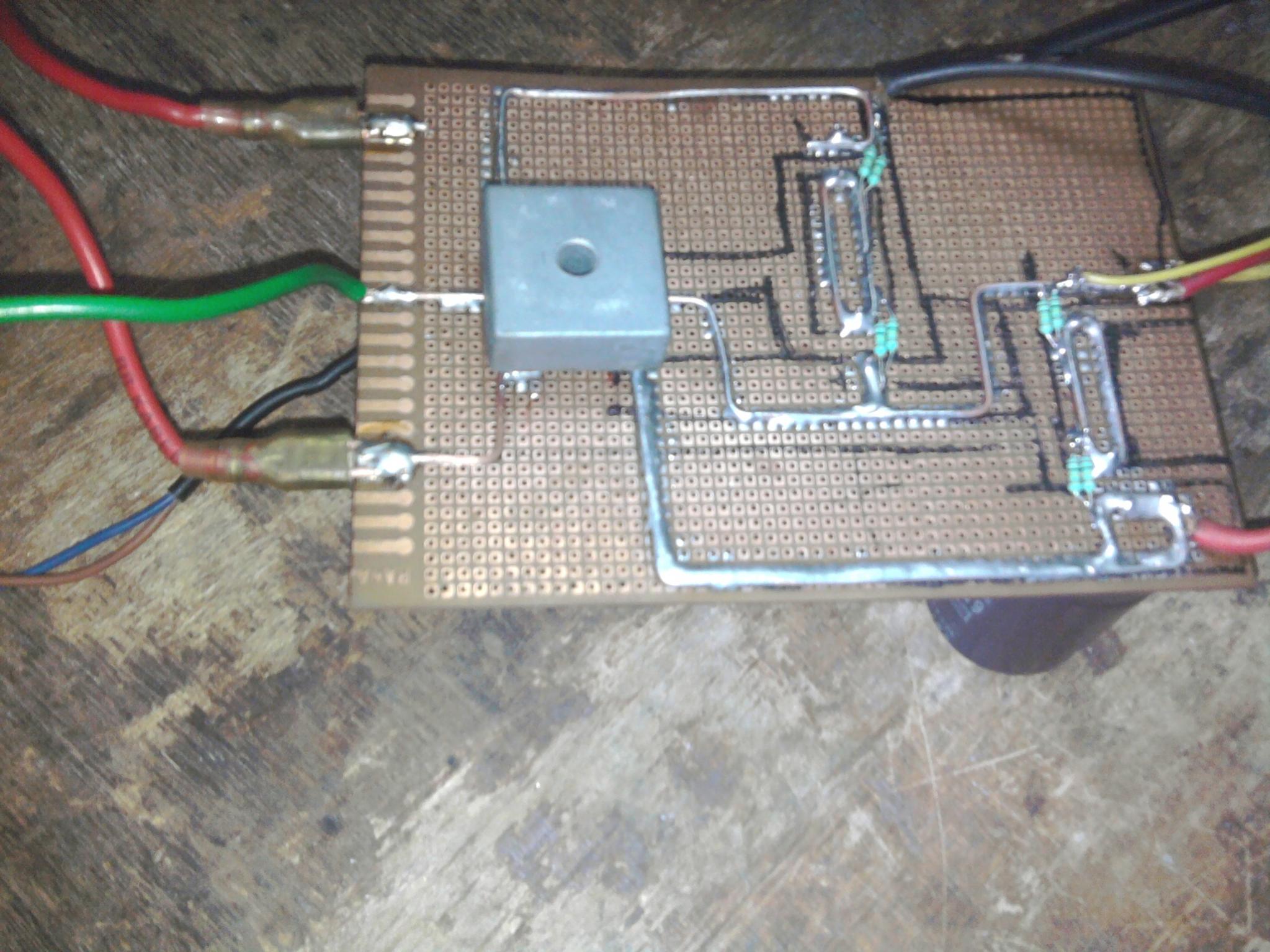

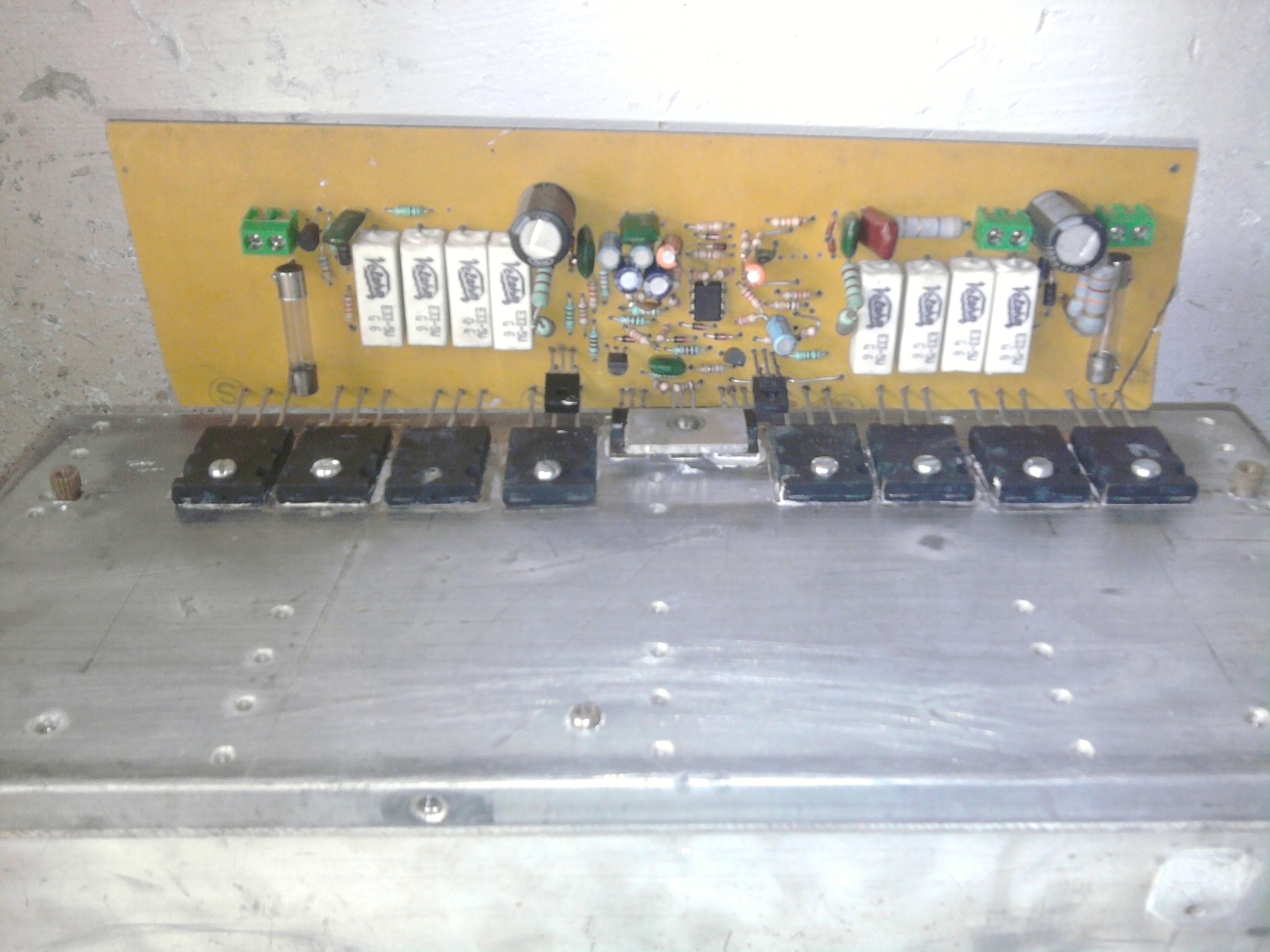

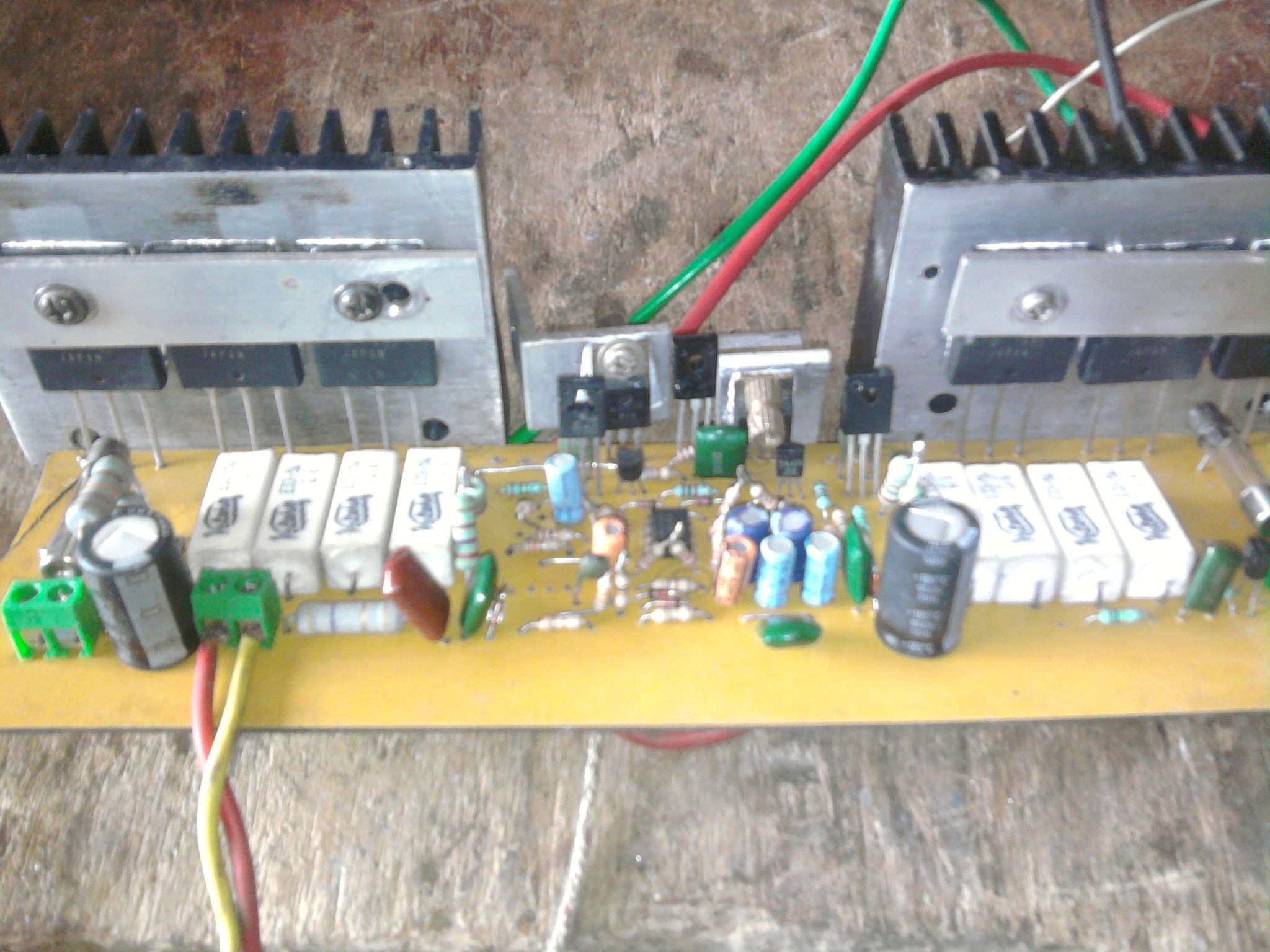

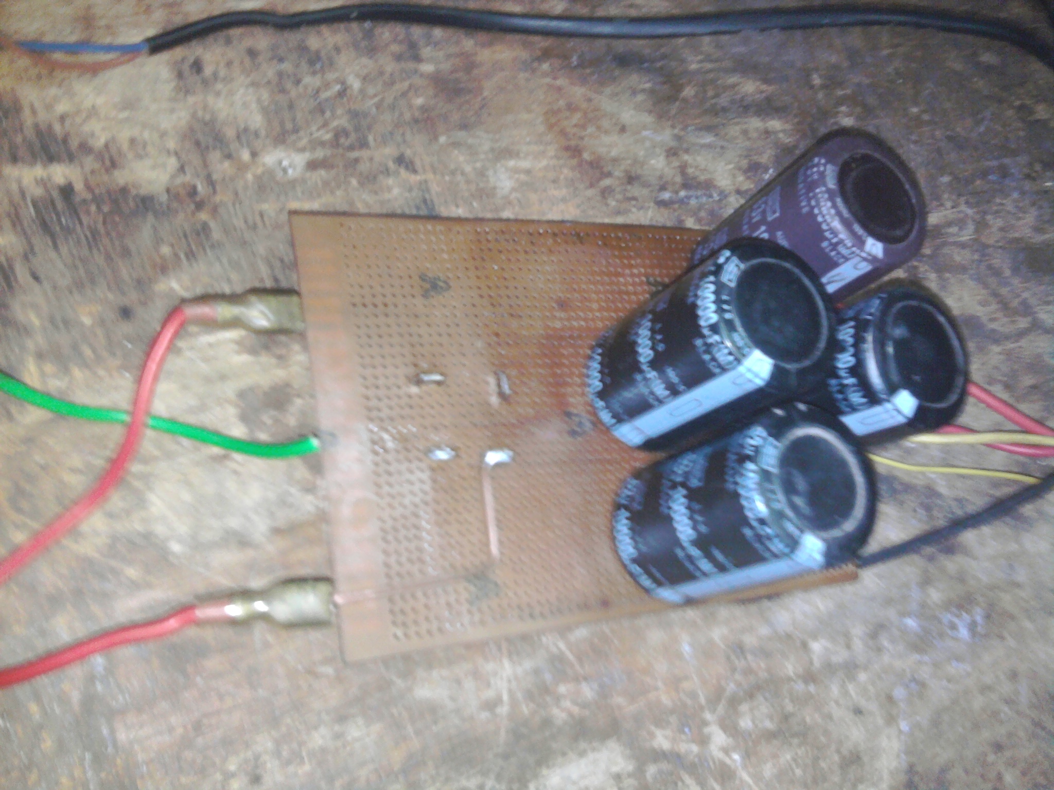

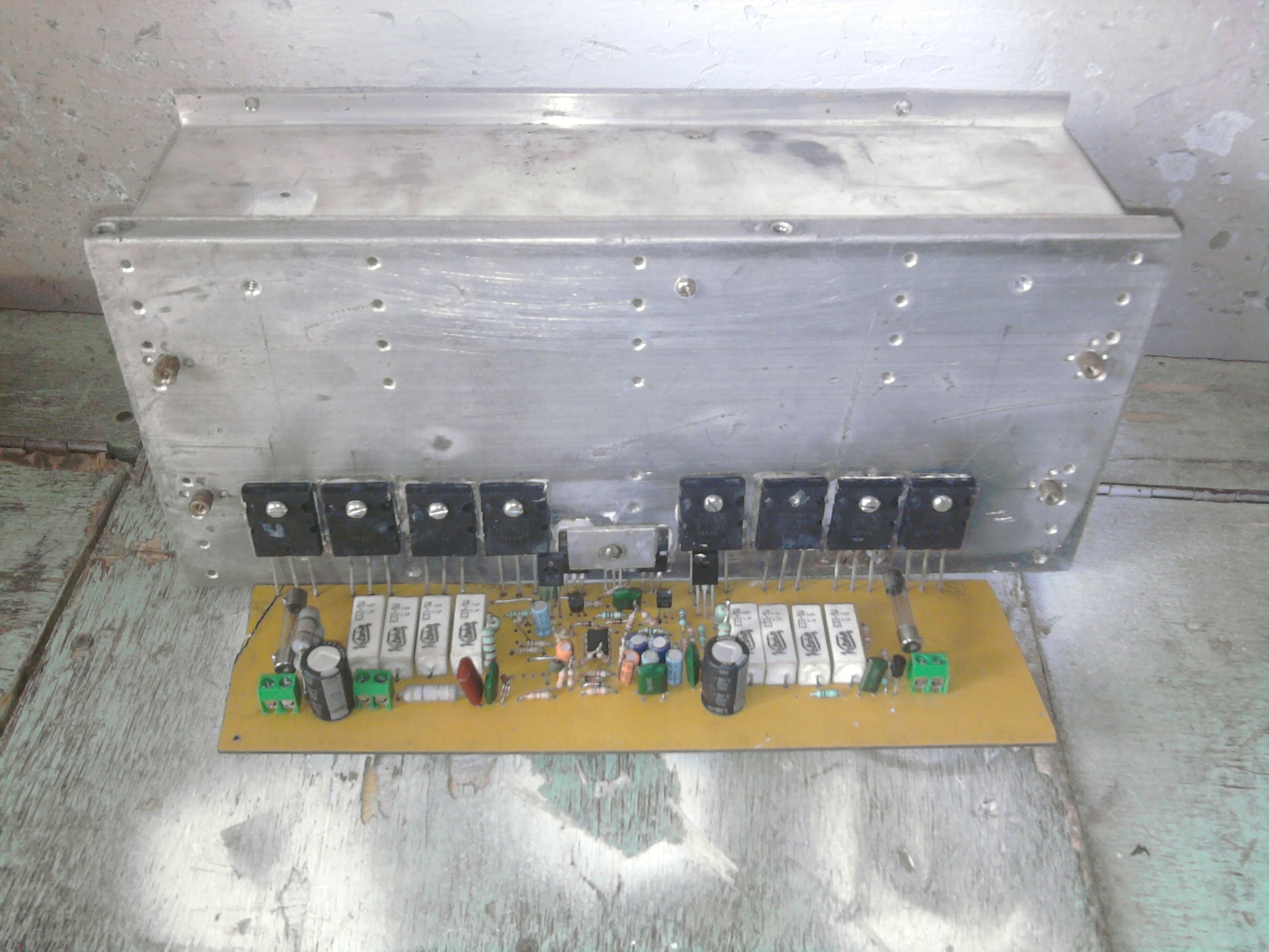

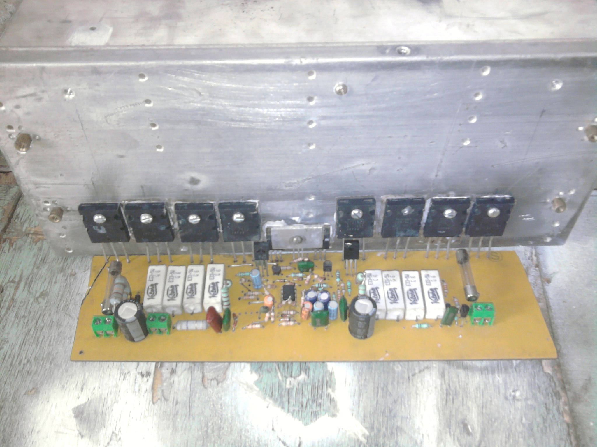

pics of my b500
hello sir pls help me out......

...can i use a transformer with dual 32VAC @ 15Amps?..what major adjustment/s will I do?..can it still give 500w @ 4R?..pls help me..:)
no.
32+32Vac could give about +-47Vdc at the supply rails.
This will allow approximately 37Vpk to a 4r0 load.
That is about 171W into 4r0, if you build this amplifier and PSU specifically to generate a high maximum power output.
If you bridge a pair of these amps you could maybe get 342W into 8r0, but there is no way to get 500W into 4r0 without bridging and building everything massively to achieve that power target.
For reference, 500W into 4r0 requires 63.2Vpk at the speaker terminals.
Vpk = sqrt(Power * Rload * 2).
Vac = sqrt(Power * Rload).

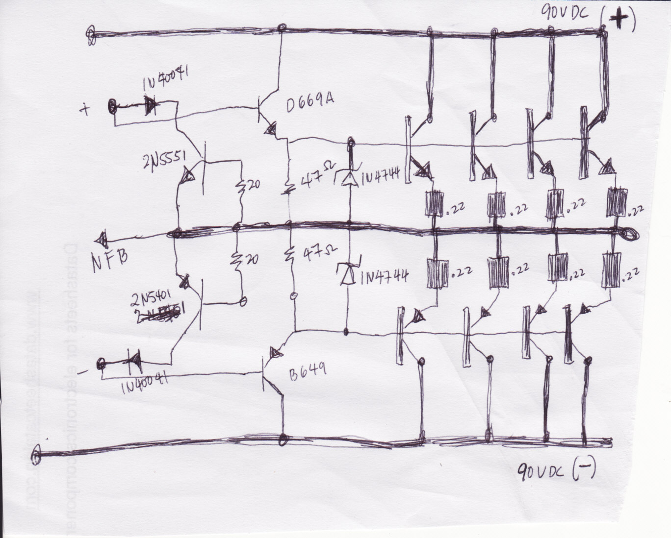

Few questions for you APEX
I am looking at the protection circuit
For the +-15V is 2 amps really necessary? It looks as this is only supply voltage for the opamp and the transistors.
I would also like to use 12Vmax not 24V for the fan. Is this an easy modification?
I am looking at the schematic but its hard to understand with the negative voltages. From what I gather the opamp gets a signal from the thermal diode then turns on the transistors to increase fan speed. I do not see a +12v for the fan. The -24V goes into the -12V regulator LM7912. From there it looks like the output -12V goes to the Fan+
No need 2A, 500mA will be enough. U can use two 12V fans in seriers. Fan (+) is connect to GND, and (-) is on -12V (amp cold) -24V (amp hot). Reason to use 47R/5W is that in this case no need to use heatsink for LM7912.

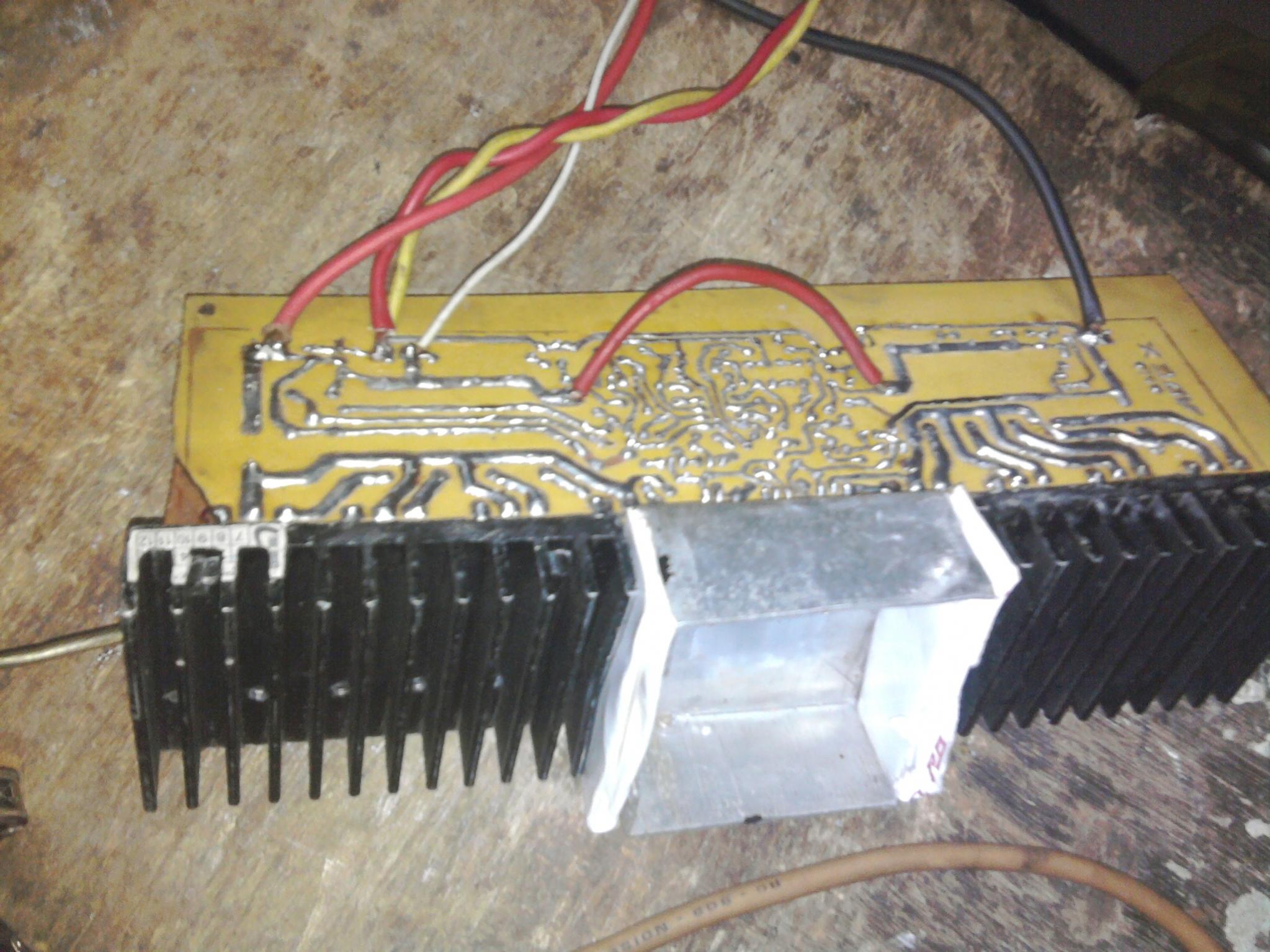

hello sir
i use same wiring as u told .
the temp is very high on heat sink where i fix the transistor.can u pls tell how much temp is good for that??
Disipation on heatsink at full power will be 150W for single channel B500 (AB class eficiency is 70%). Heatsink on your picture (B500 3 pairs output) is to small, without fan not enough for 100W amplifier. Do you measure BIAS.
