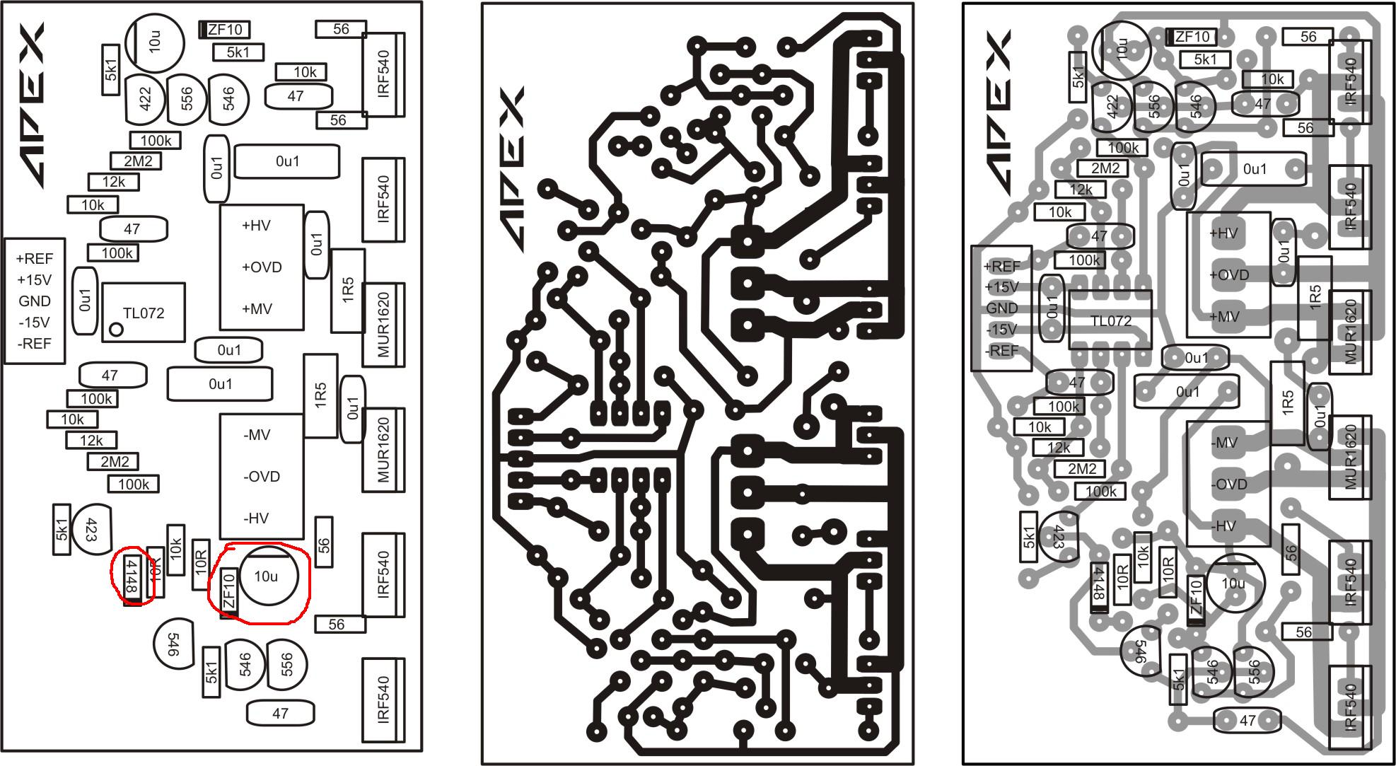

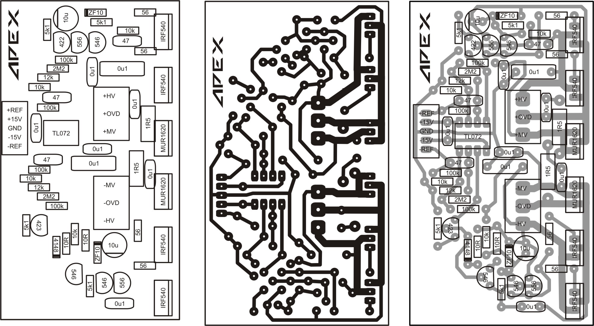

Heii..Apex..I found problem on B500. Like this:
I used PSU +/-44VDC, If I not applied fuse, I measure voltase (+) and (-) to ground is simetris (44 vdc), also (+) and (-) to output power is simetris (44 vdc). But when I used fuse 10A, voltase (+) and (-) to ground not simetris, (+) to ground = 43vdc and (-) to ground only 35 vdc. Also (+) to out PA only 35vdc and (-) to out PA= 43 vdc.
If I used fuse 0,2A, voltase (+) to ground = 43vdc and (-) to ground = 42,3vdc. Also (+) to out PA=42,3vdc and (-) to out PA = 43vdc..
Please help me..
Regards
Use 10R resistors insted fuses and measure voltage drop on them, did you measure DC offset and voltages on other suggested points.
