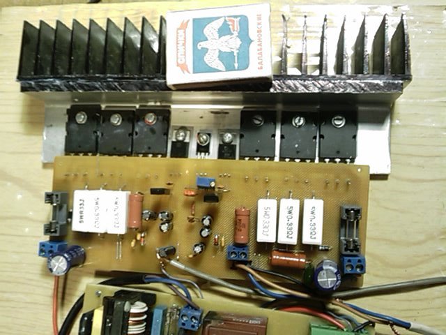

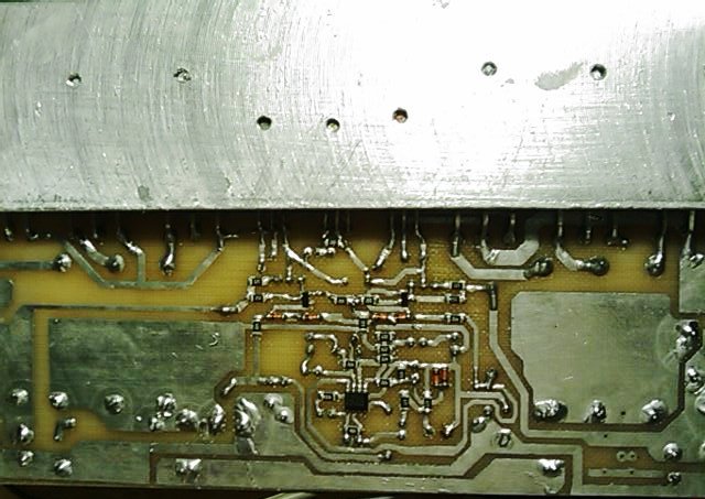

500W PA amplifier with Limiter
Hello guys

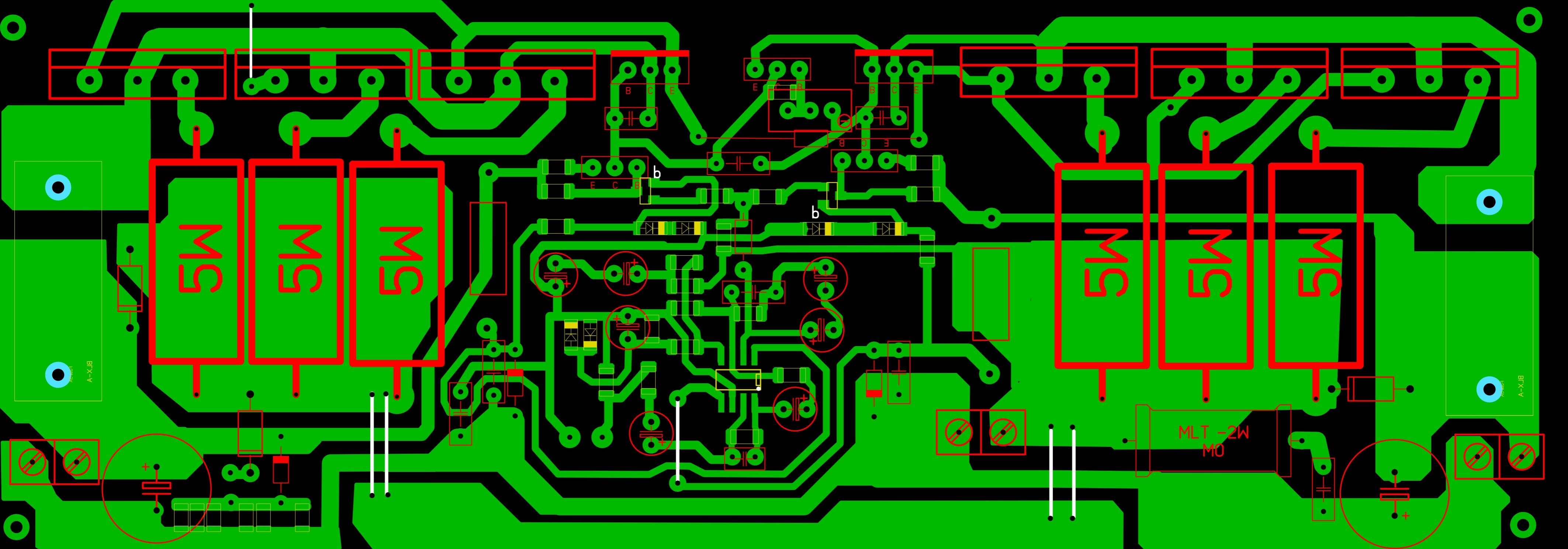

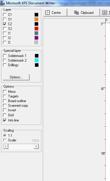

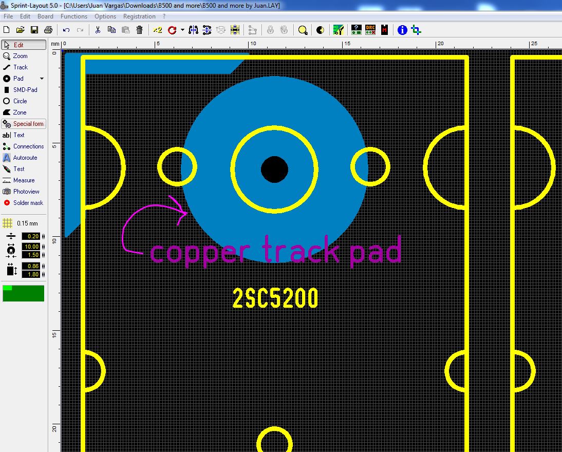

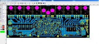

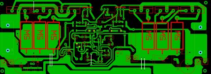

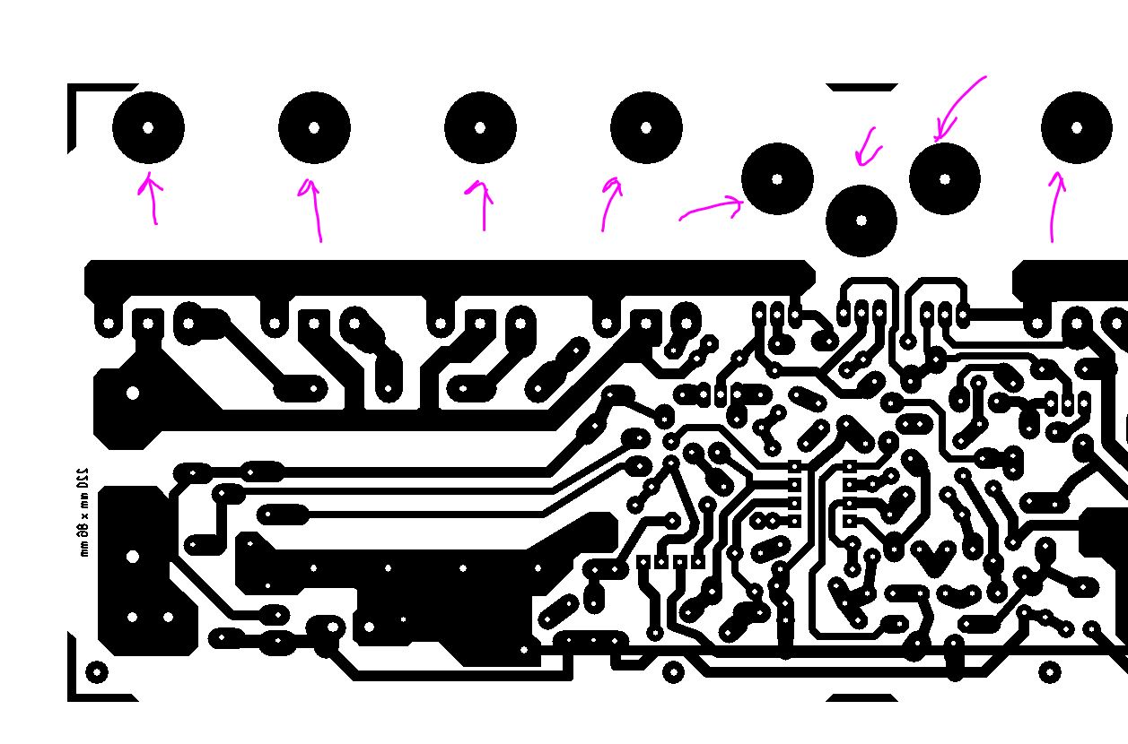

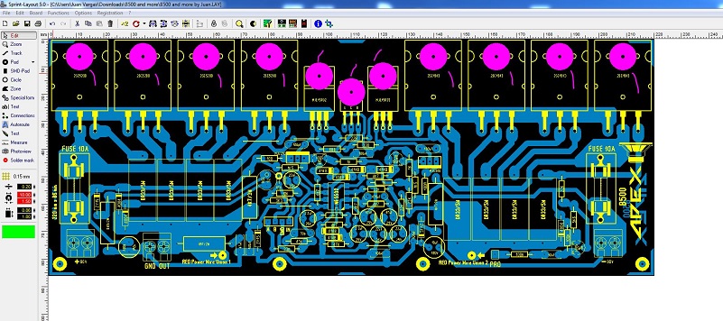

make sure if you are using the file for "etching" make all the holes smaller so you will have enough material for soldering usually 0.60 mm hole diameter for all is ok so then you can chose 0.90 mm for diodes and 1 mm for the MJE15032 etc, the main power transistors are about 1.48 mm round it up to 1.50 mm diameter hole, the rest caps are usually 0.80 mm some are tickers than others :) also enlarge the hole pads copper area for the main transistors that help to align them sorry I forgot select only C2 do not enable C1

Ok I'm back, I will leave here different sizes because in the past I use think that layout from a PDF file will be just fine and the dimensions are correct :rolleyes:, I found out that after the files is transfer to a "virtual image PDF the size might be a bit smaller" but if you are using a "real printer" size will be accurate using 1:1 and it will give you and accurate size of the layout if you are using the straight out of the software PC to printer it will be good very good :D.
God knows how many printings I did to test it out on PDF files :p, even if I chose A4 or other format it will always change the size of the layout, for that reason what I do is I print different sizes and then I compare them using MJL3281A leads to see if they align correctly, is not 100% accurate but it works, if you are to print those sizes use "draft only" to almost grey to safe ink or cartridge life,
when you find out what size work best for you then you can print the final one you are going to use for the etching, here are the files :) , I think 130 size is way too big but I will leave it here any way :D
