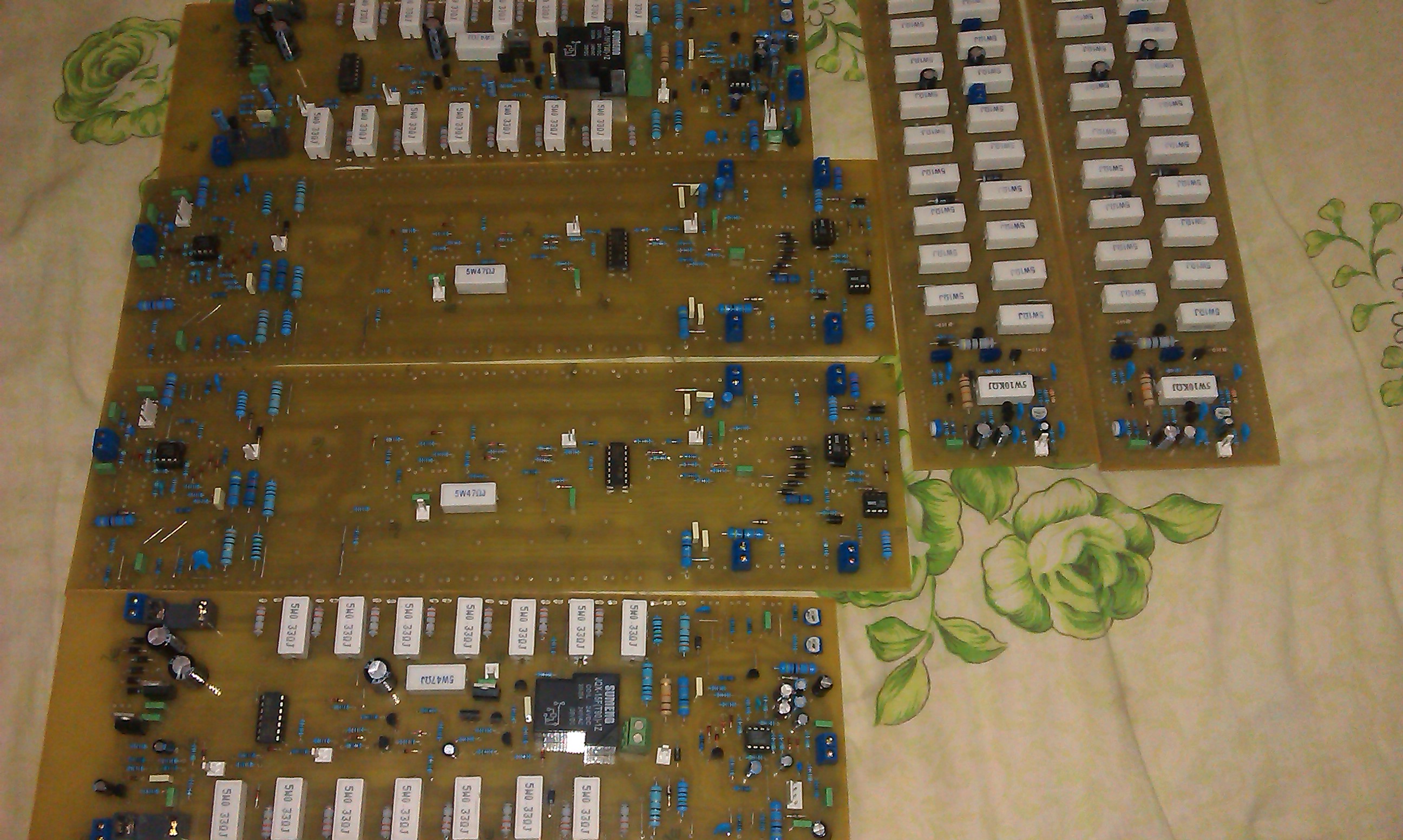

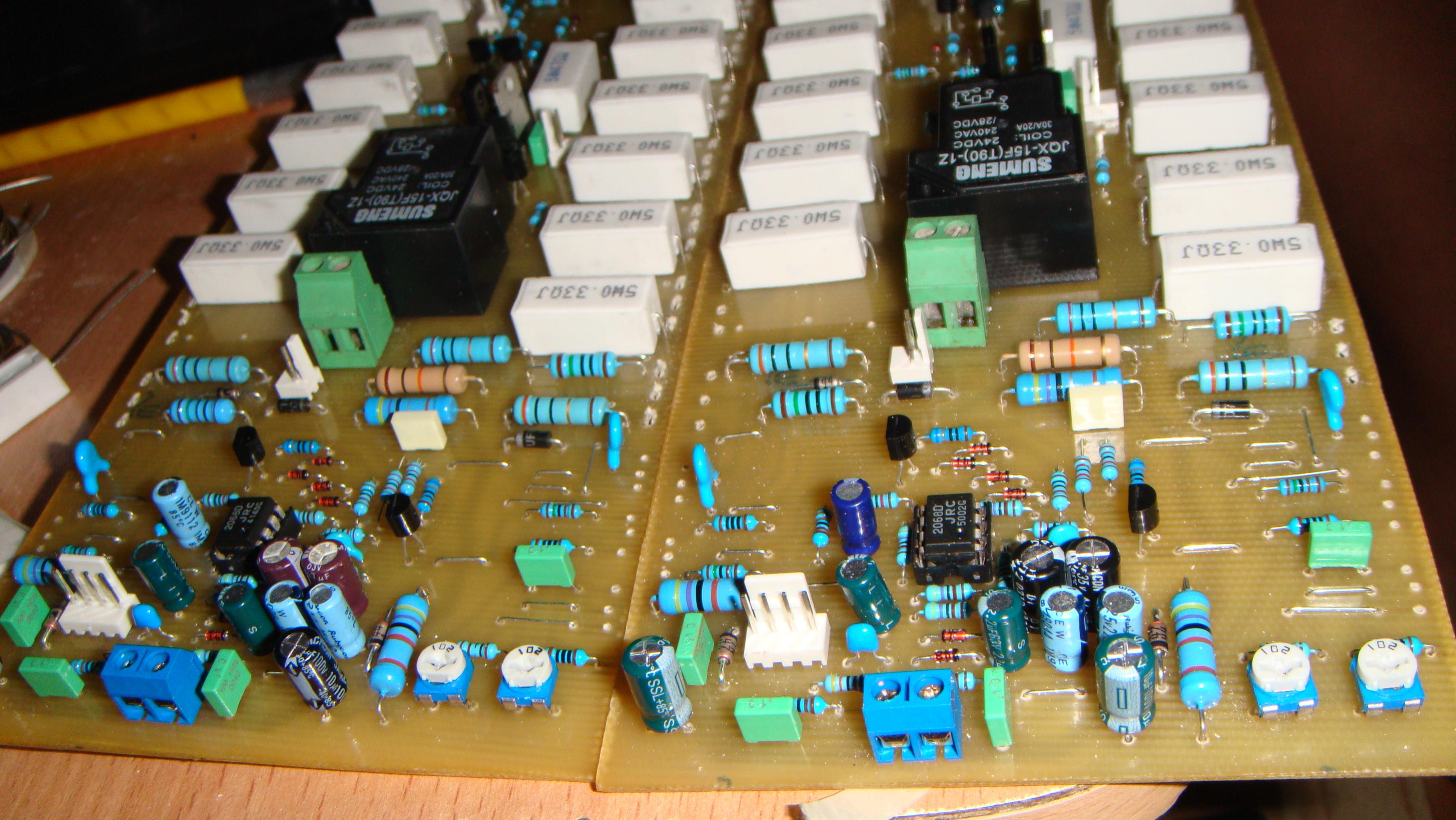

my on going b500

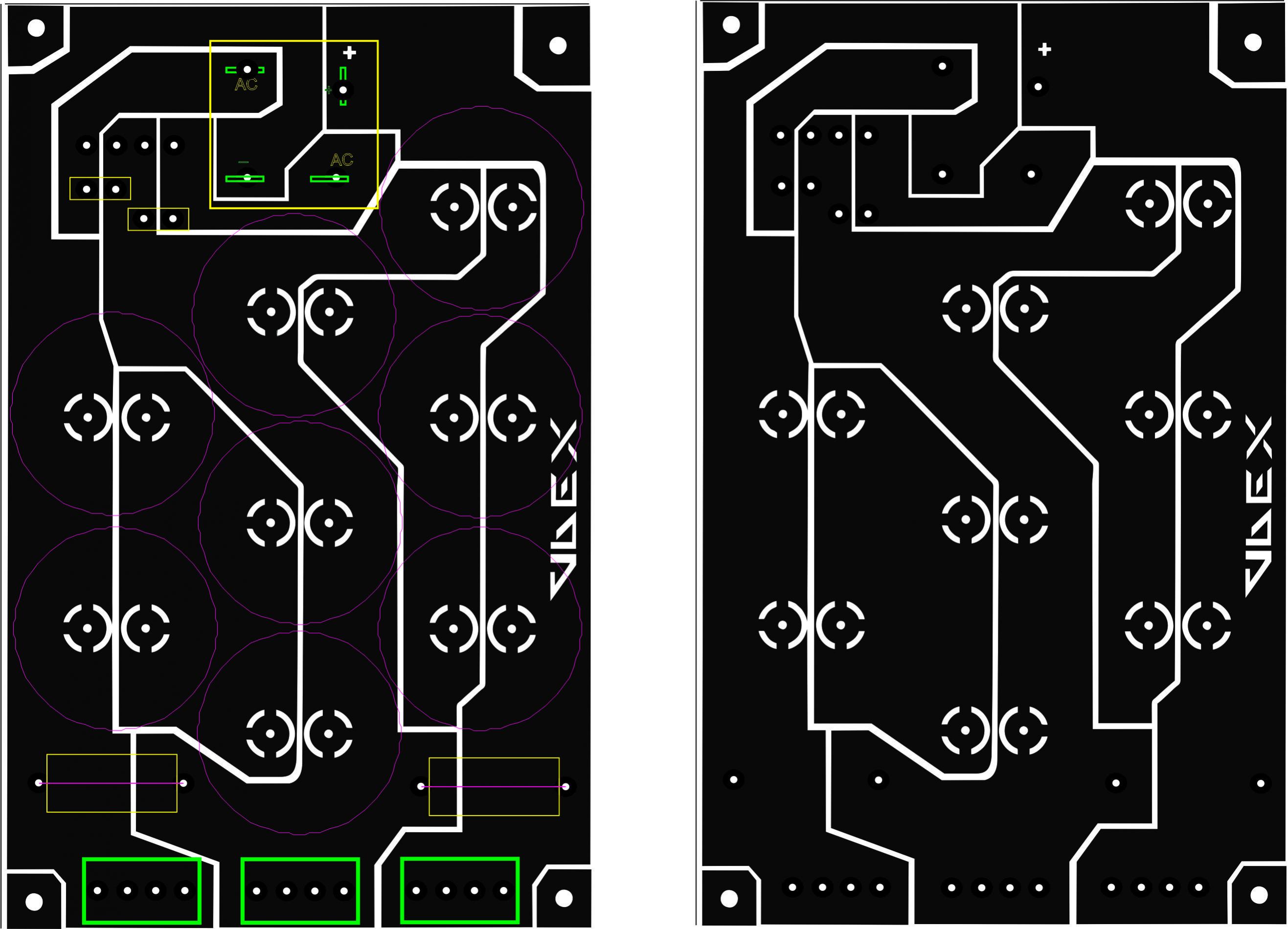

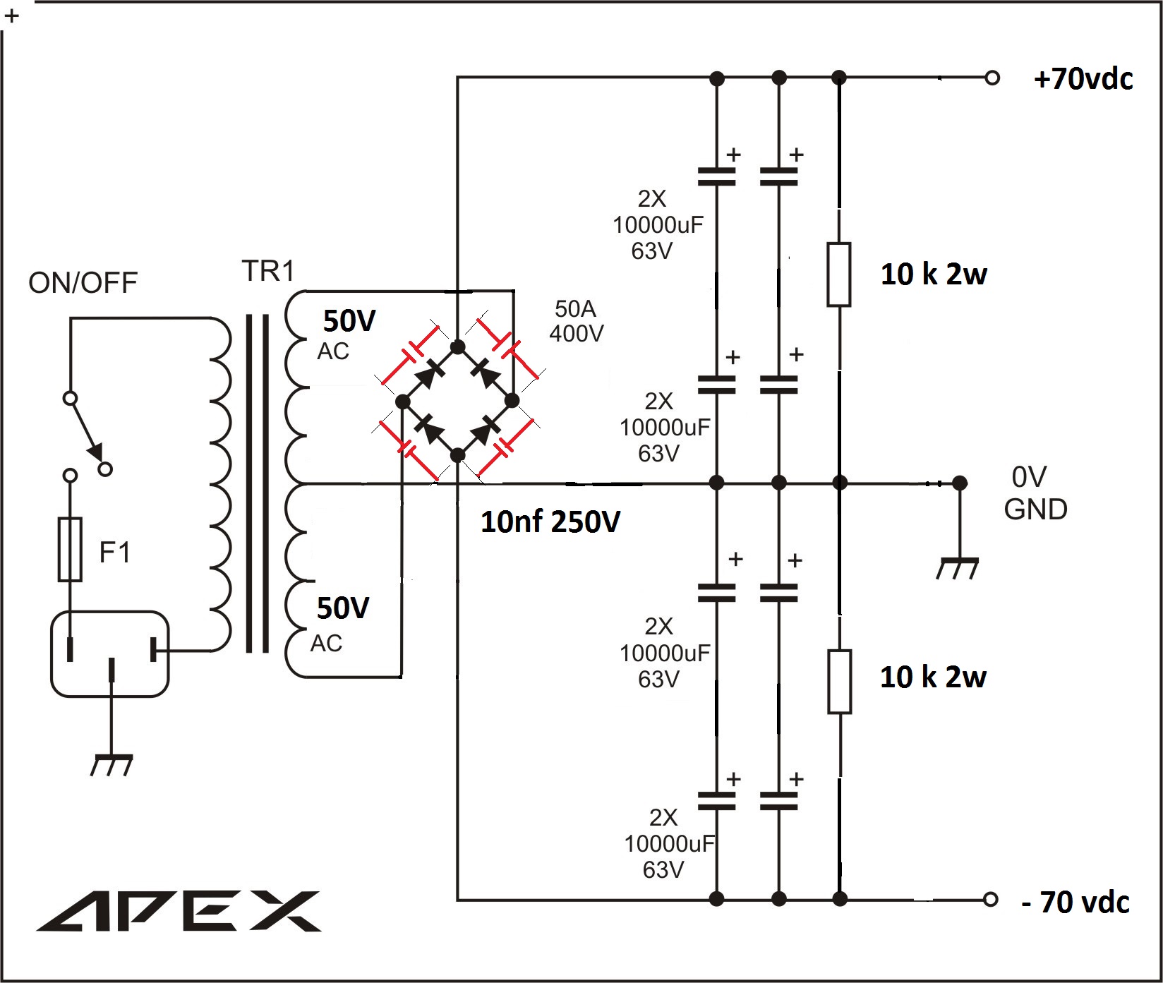

Power supply board for B500TEF, PCB size 101x160mm
Hello ... Just like to post this edited power supply board for my B500TEF.
My Power supply:
Trafo - Toroid 50-0-50VAC at 20 amps
Capacitors - 10,000uf/63V 8pcs
filter caps at diode - needs suggestion for value
Bleeder resistor at output - need suggestion for value
Hope anyone can help me use proper values for missing parts.
Thanks & Regards

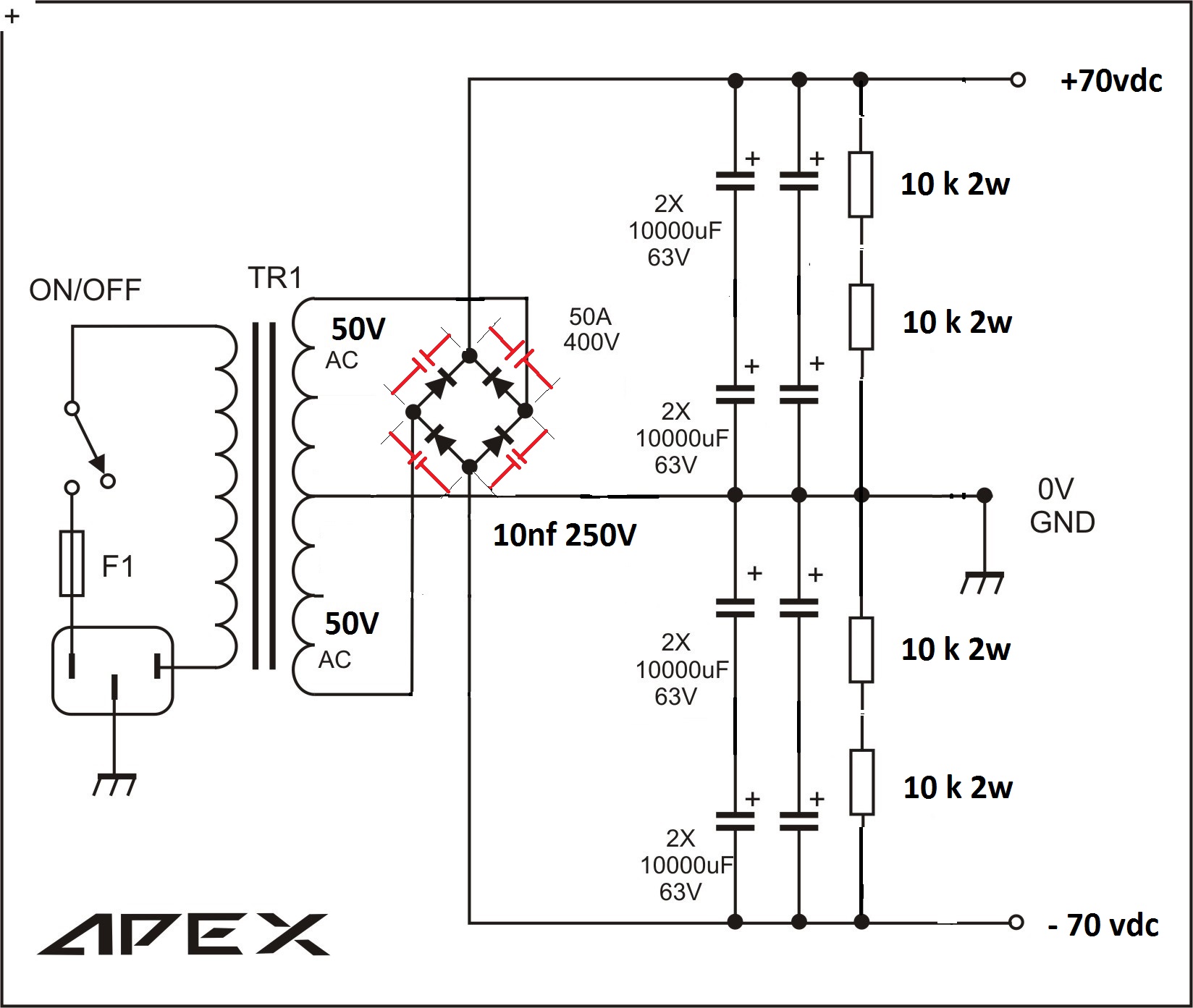

Please check filter caps at ac side of diode.. I think this is wrong, any suggestion is welcome.. many thanks
You need 4x10nF/250V in parallel with diodes in bridge and 4x10k/2W in parallel with caps from midle point to rails.
QUOTE=apexaudio;3728163]You need 4x10nF/250V in parallel with diodes in bridge and 4x10k/2W in parallel with caps from midle point to rails.[/QUOTE]
Hi Mr Mile.. many thanks for your quick reply.. Please see attached schematic I also edited based on your original for H900. Please see the resistor placement.. I put only 1 resistor each rail.. Is this ok ? or shall I series the two 10k 2w in each rail.
Many thanks & Regards
Many thanks & Regards[/QUOTE]
Connections mising.
Connections mising.[/QUOTE]
Thanks you very much again Sir Mile for clarification..
Best Regards

Thanks, here's the files.
How the size of the PCB, sir?
