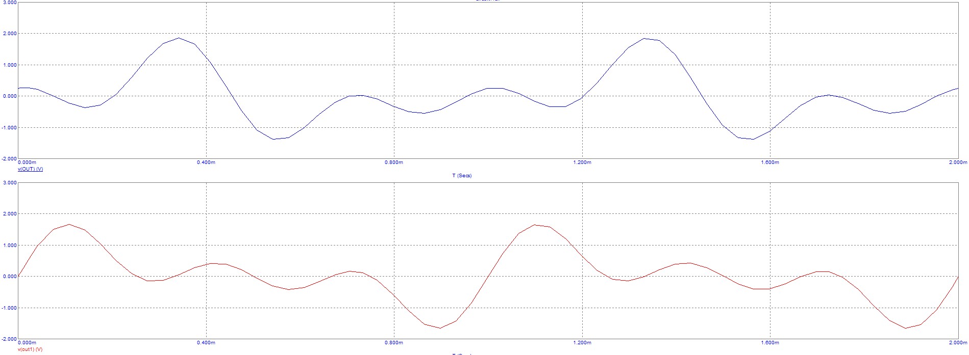

What you are saying Elvee is these two signals sounds the same? Very interesting.

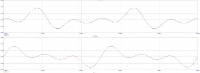

These two signals are identical at the input of each of two amps with different phase shifts
I say these two signals would sound very different and is precisely how we discriminate one instrument from another and why your father does not sound like your mother.
I suspect they do, but I do not have access to the source of these signals, ie, how you created them.
Can you show us?
Can you create a .wav file?
Remember, we are talking of phase shifts expressed in millidegrees, group delays in the low nanoseconds range.
No, the distinction has mostly to do with "timbre": Timbre - Wikipedia, the free encyclopedia, and very little with the relative phase of the different components.

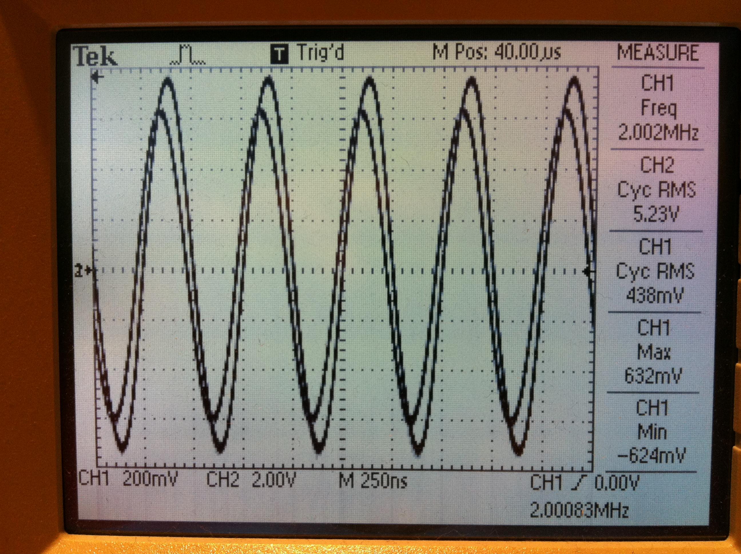

1KHz and 10KHz squarewave.
1 KHz looks good, but I cant really explain why it gets rounded so much at 10KHz.
Anyway, 70V/uS slewrate is still ok and good enough
Well, I now know the answer.
It is the 1 uH//1R in the output that causes it. Removed the coil//resistor and I get a very nice looking Squarewave, even at 20kHz.
Slewrate is around 300-350V/uS.
But without a coil it starts to show oscillations with 40-50nF parallel with a 8 Ohm load.
So it is a trade off, stable amp with 70V/uS slewrate or unstable amp with light capacitive loading and 300v/uS slewrate.
There is no question about what I would choose.
why do think you have to choose? - no one measures slew rate after the inductor
the amp performance limitation, distortions from slew limiting happen on the amp side of the load decoupling network
there is no need to launch 70 v/us onto your speaker cable
Interesting, I should have though of that before, it makes sense that distortion from slew limiting happens before the inductor. After all, the inductor is just there to shield the amp from anything that might interfere with the NFB.
So basically, it would be reasonable to say that for all intents and purposes it is a 300-350V/uS slewrate amp, even though the output itself after the inductor is limited to around 70V/uS.
