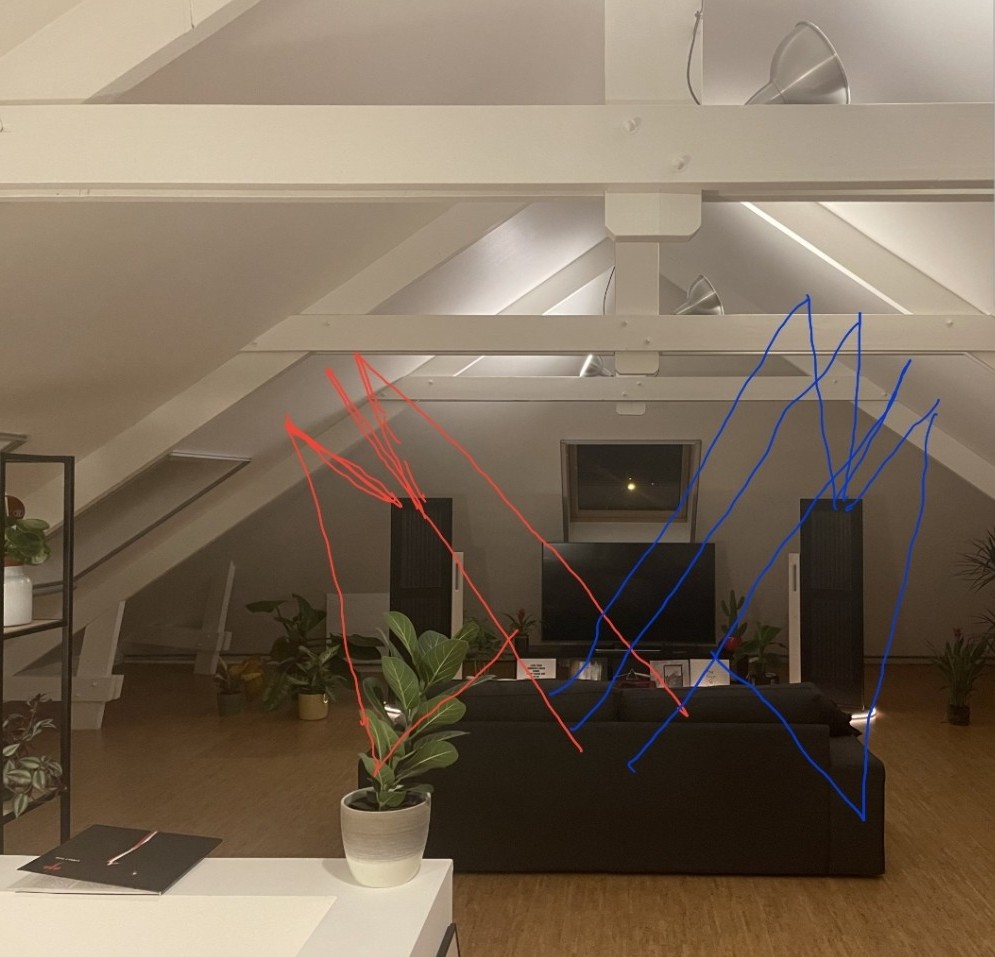

Also recently I've had a revisit on acoustic room treatment placement.
I paid attention to where reflected sound could be absorbed.
Used the mirror technic to see where I could see the horns from listening area.
Along these lines for my loft room (note, this is not my room, something I found on the internet..)

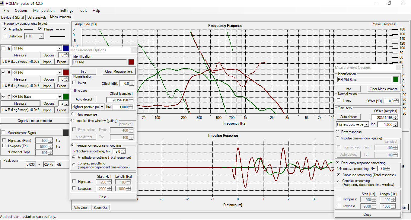

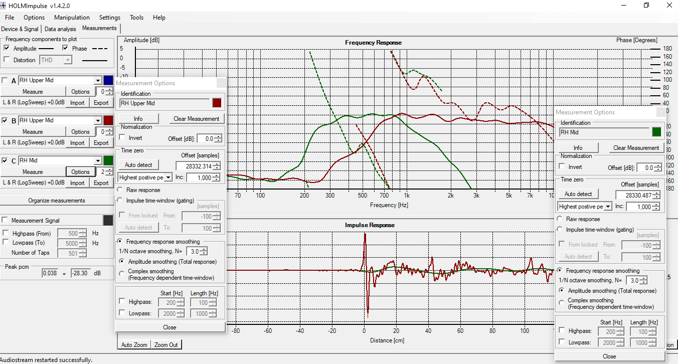

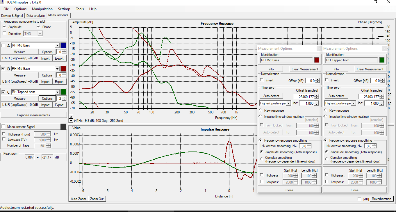

I got some time to have another go at phase alignment.
Note extra bass at 27Hz room mode.
I have 3 settings, from this, to flat. This one is 'shock and awe' setting when demoing bass. Sofa vibrates nicely to church and cathedral bass, and certain Electronica.
Flat is totally boring!
X/O 100Hz
The midbass to mid, X/O 300Hz.
Mid to upper mid. X/O 800Hz
I've matched the slopes as best I can so far. It certainly has helped align the phase plots better, I think?
Still not 100% I'm doing this right though, but it sure does sound nice!

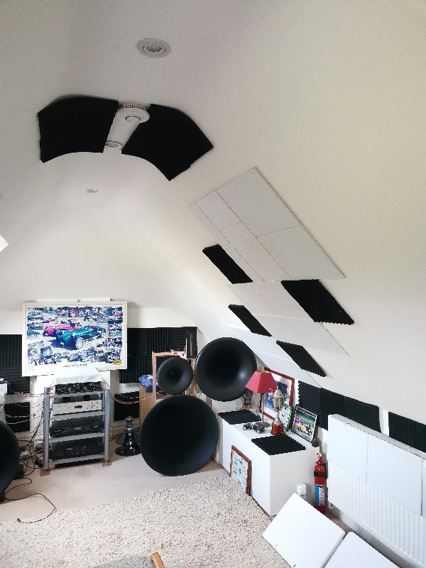

Here's the latest - room treatment.
I don't have room in the corners for big bass traps and don't really have an issue with the bass - once I've correct at 30Hz and 70Hz is applied in DSP.
No correction anywhere else.
It's not a clappy room by any means.
I did find that 1000Hz up treatment gave a much shaper image, esp vocals.
I tried thicker 500Hz and up panels but didn't like the effect.
To find the positioning I used the line of sight mirror trick.
It's not so obvious what is reflecting where, in a loft room and to the listening spot.
I have around 20% coverage excluding carpet etc.
Side ceiling, also end wall.
More behind the listening spot and to the sides (not in shot).
i revisited the SPLs and played around with the X/Os and phase checked to.
Really happy with the sound.

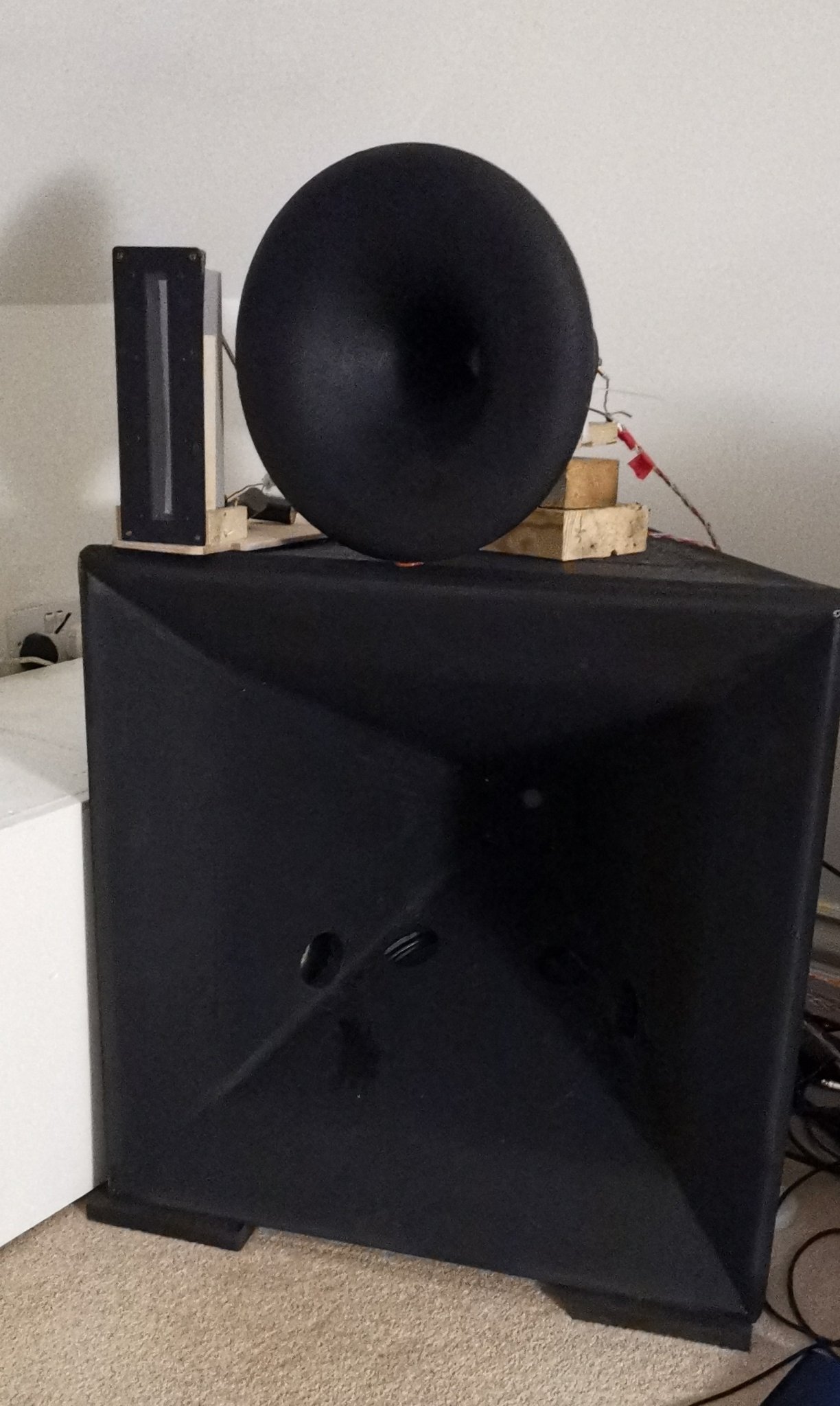

Having had great fun, and in fact continuing to have great fun with the SH50 alike synergy horns, I decided to try them as a 5 way!
3 long-standing components are still in the mix.
  • Raal 9" Lazy ribbons.
  • Vitavox S2s on 550Hz soft wood Le Cléac'h horns, I turned some 3 or 4 years ago.
  • 2.4m tall/long Tapped horns (also a Danley Sound Labs design) I made some 12 years ago now!
What's new!
The Danley SH50 conical horn is now doing LF, using the trusty Eminence Kappa 12A.
Though playing a big deeper than trad mid bass straight horns - thanks to the horn loading being knitted with reflex port loading.
The SH50s are also being used Synergy wise, for the MF - from the 4 little 5" Celestion sealed back cone drivers.
Whilst 'lash up' can be used to describe the current physical assembly / look.
The acoustic / electrical setup is anything but.
I've spent lots of care and attention measuring, time spent on the frequency response, crossover slope choices fitting for each driver range, how they interface with the adjacent drivers, and phase alignment.
The resulting sound is I believe, the best I've ever had from my system!
Improvements over previous 5 way systems are most noticeable in the LF bass of SH50, more kick, texture, depth, plus more cohesion between the LF and MF from the Synergy design, and the more compact and vertical inline layout of the MF and HF drivers.
It's taken a good while to realise the potential.
I enjoy the journey and reaping the musical rewards.
Dynamically recorded live music really sounds live!
I guess thanks to all the drivers being the sort of thing you could hear live music over at a well prepped venue, but it's also super refined and accurate on studio recordings.
Another really cool thing is that within seconds I can configure it to be a pure Danley'esk 4 way - the tapped horns + 3 way synergy SH50.
I have 2 systems in one.
They sound quite different.

Holy conical! My problem with Danley horns is that when simulated it is both a crappy midbass horn and a crappy midrange horn. Having everything centralized might help with certain things, and can give you the headphone effect, but having good quality horn profiles (in good material) is more important.
Yes, I was highly sceptical, but wanting a semi PA setup for a wedding venue, I built anyway.
For the wedding it will be the BMS comp drivers, perhaps 2 extra 5" MFs (4 in total), and another 12" LF driver (2 in total) per horn.
So the hifi set up sound..
With trad DSP crossovers on the SH50 the LF isn't too shabby out of the box.
Does need a PEQ cut at 120Hz.
Reaches down 60Hz and easily plays up to the MF at 325Hz cross.
The MF was a bit of a revelation measurement wise. Between 300Hz and about 1000Hz it was pretty smooth really. A little cut at a hump around 350Hz needed.
I am still dabbling with the "XO free" flatter phase integration that is reported to be so good. That uses mostly only PEQs to control things!
I can hear some potential there but integrating the tapped horns is not as easy.
A lot of PEQs are required - still work in progress!
Putting the Vitavox S2s on the Synergy horns has made the sound totally acceptable to me!

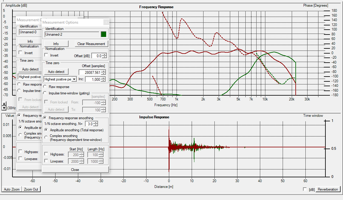

HF and MF is good, LF needs more work - trial and error as I'm not REW au fait.
To get phase control in having to advance the LF in time. Should not be like that?🥴
It still sounds better than anything else so far!
Never say never on the another horn set up though.
I have already tried the 5 way with SH-50 doing only LF and MF.
I will probably try the SH-50 as LF only next.
Bringing the Sea / Le Cléac'h (or other) horns? And the JBL2482s back as MF.
It's the only config I've not tried yet.
Once I've sorted the SH-50s out fully perhaps..
Asymmetric AH425 and even something similar for the mid frequency compression drivers could be something to try.
Size is the problem.
Better directivity control than round would be good.
I've learned that from the SH-50.
