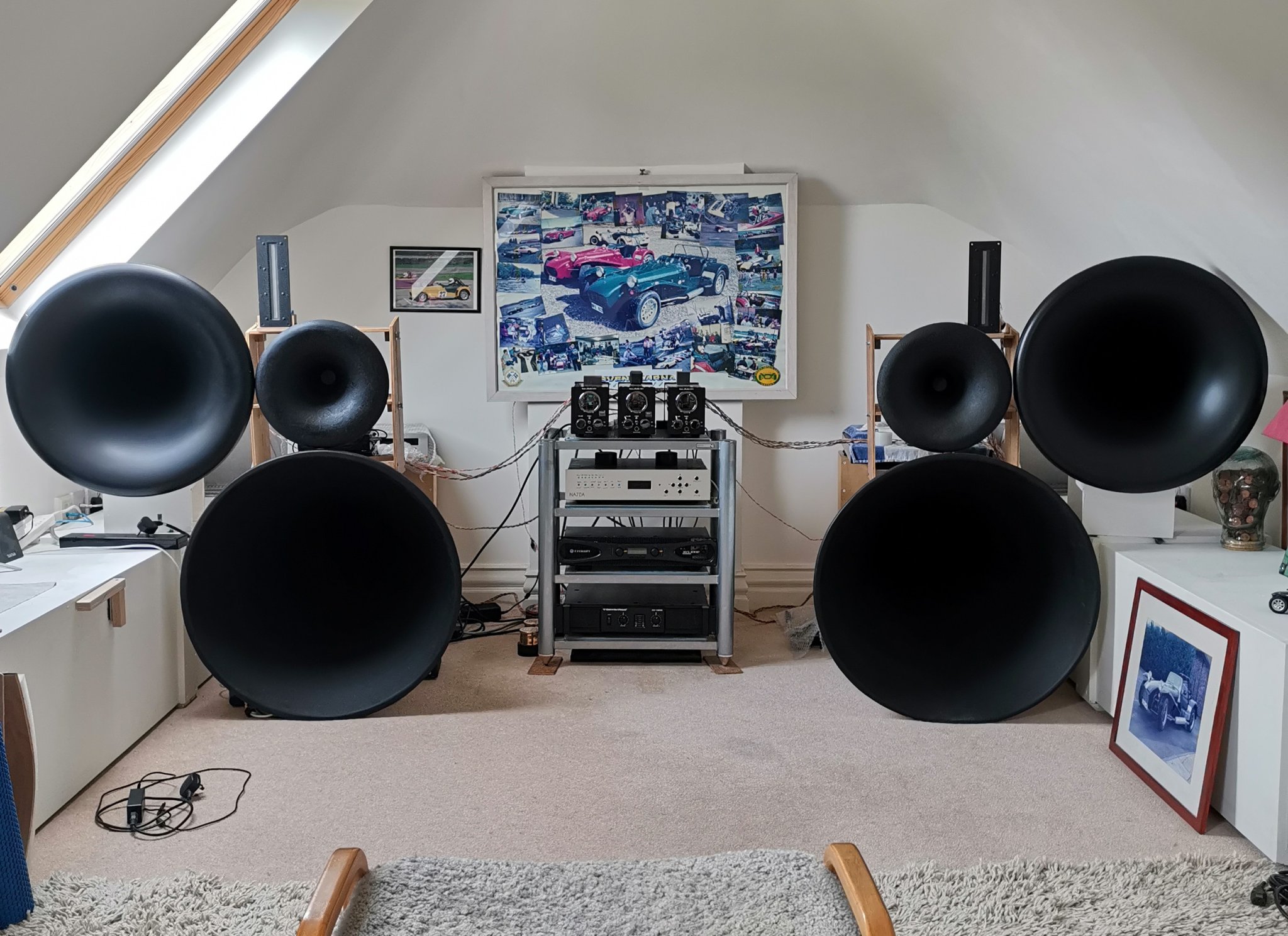

Having run with the new room config for several days (tapped horns across the end wall firing directly at me), listened, measured and tweaked it in all ways I know how..
It failed to live up to the previous setup.
Before I tried it it was a
"I gots to know" moment (Dirty Harry).
Had to be done.
So what was wrong?
The magical upper mid bass / mid / upper mid cohesion and stunning realism was lost.
No disrespect to hifi, but it sounded like a playback hifi, not an enthralling performance anymore.
Horns done right should wow, should sound right across the board, should do everything impressively.
The magic was lost!
The bass worked well enough. Not as much corner loading for the tapped horns of course.
I don't know why it didn't work?
Perhaps the change in proximity of the side walls to the upper mid horns, doesn't work like the mid horns do - frequency thing?
I didn't mind the slightly higher presentation of the mids. That was actually quite beguiling.
I missed the width a bit though.
But it was the combined realism of the horn grouping that was lost somehow!
So, 500kgs shifted around again, filled and painted the tapped horns a bit, vacuumed the floor, cleaned the skirting boards too, before putting it all back as it was.
Put the Thunderbird 2 reflectors on the tapped horns again🙂 Painted them beforehand too.
Loaded the old DSP preset for this room setup.
Bam - magic returned.
Layout itch scratched. Never again!

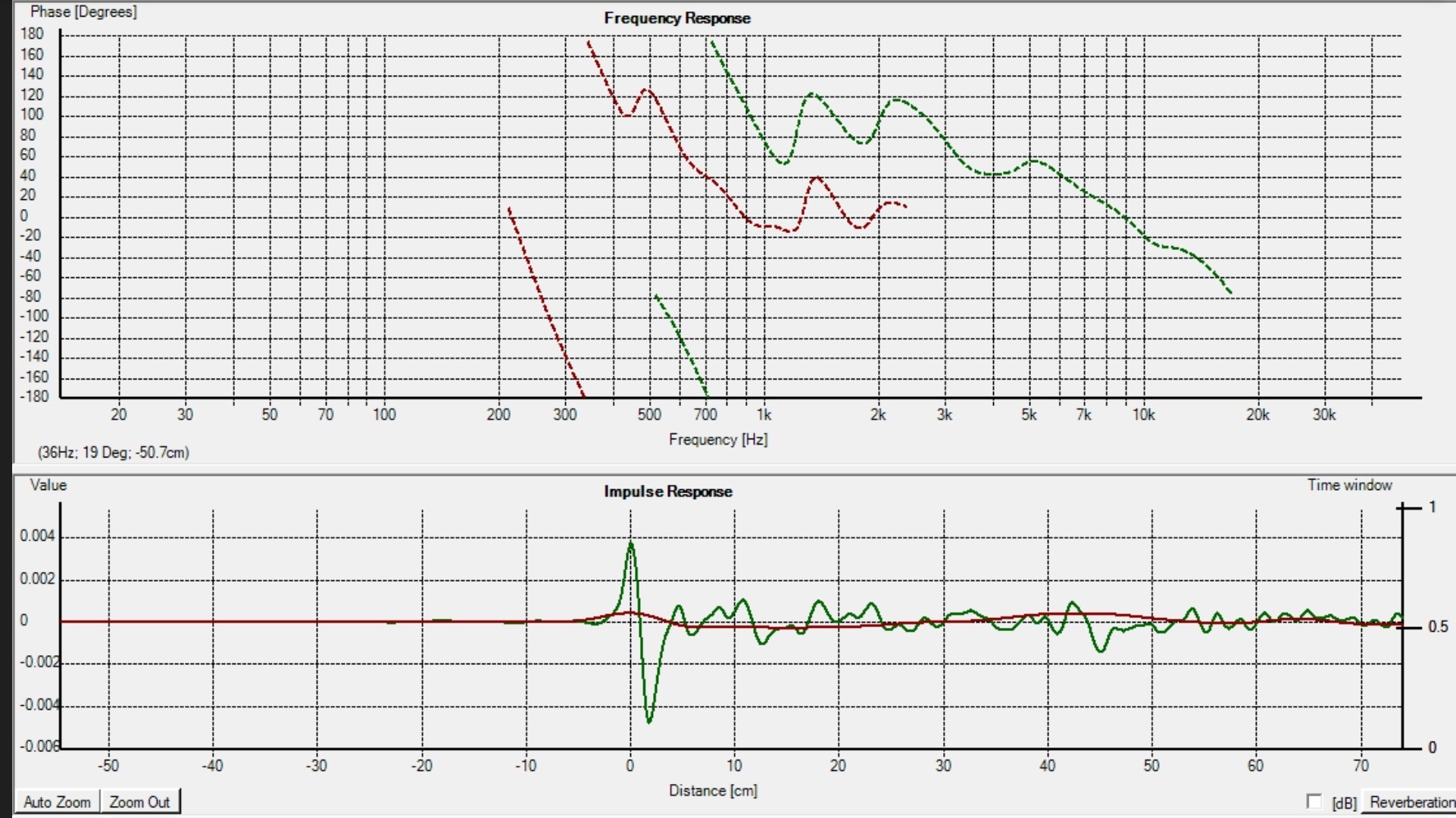

I've been measuring and focusing on the @jtalden procedure.
Aligning in Holmimpulse of my upper mid horn
I get these first positive response and phase plots;
Green Upper mid horn, Red mid horn
Help interpreting much appreciated.
Esp. this that jtalden wrote, many moons ago
"Adjust the Offset (delay) of the MR Horn as needed to achieve close phase tracking of the direct sound throughout the XO range. [I expect a very clean phase trace in this case but sometimes, particularly when XO <500Hz, there can be room modes or reflections that make phase chart more difficult to properly interpret.]"
- Vitavox S2s on 550Hz Le Cléac'h horn crossing at around 1000Hz 1st order and rolling of no X/O, and
- mid horn JBL 2482 on T200 horn 2nd order L-R at 300Hz and 750Hz.
I haven't read this thread nor used Holm for many years, so my comments don't consider your project background or specifically how to make the adjustment using Holm.
In General:
I always use the TW as the overall system reference time and adjust the next lower driver (upper mid) to align it. The next lower drive (mid) is then aligned to the upper mid and so forth to the lowest driver.
Regarding your chart:
Considering the upper mid as the reference, we can use Holm options to change the timing of the mid to overlap the phase traces of the 2 drivers as closely as possible. [Note: It is critical that Holm captured the relative timing between these 2 measurements (stream was kept active).] If so, then we can adjust the lower mid in Holm options to create the best overlap and identify the amount of delay change needed.
Per your chart as a ballpark estimate. It appears there is about an 80° offset required to overlap the phase traces in the XO range. Manually estimating the needed adjustment, it is roughly:
0.22 ms delay reduction of the mid. This corresponds to about a 75 mm increase in mid driver distance from the mic located at the MLP.
A remeasure after the change is needed to confirm the result.
In General:
Update:
After years of the earlier pics on this thread gone missing - due to various image hosting shutdowns,
I've been able to rebuild all the pictures (well 99% of), on this build and evolve a 5 way horn system thread.
Many thanks to moderator Jason and others for making it possible.
I'm now working through the more recent images that are fine and visible, but are not uploaded / attached. So they will be future proof too.
If you fancy looking back at the wood work madness of the early days / and passive to digital evolution etc etc, go back to post one and forwards🙂
