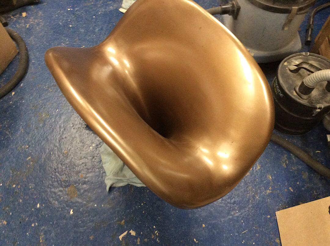

Steve, you could always borrow mine..

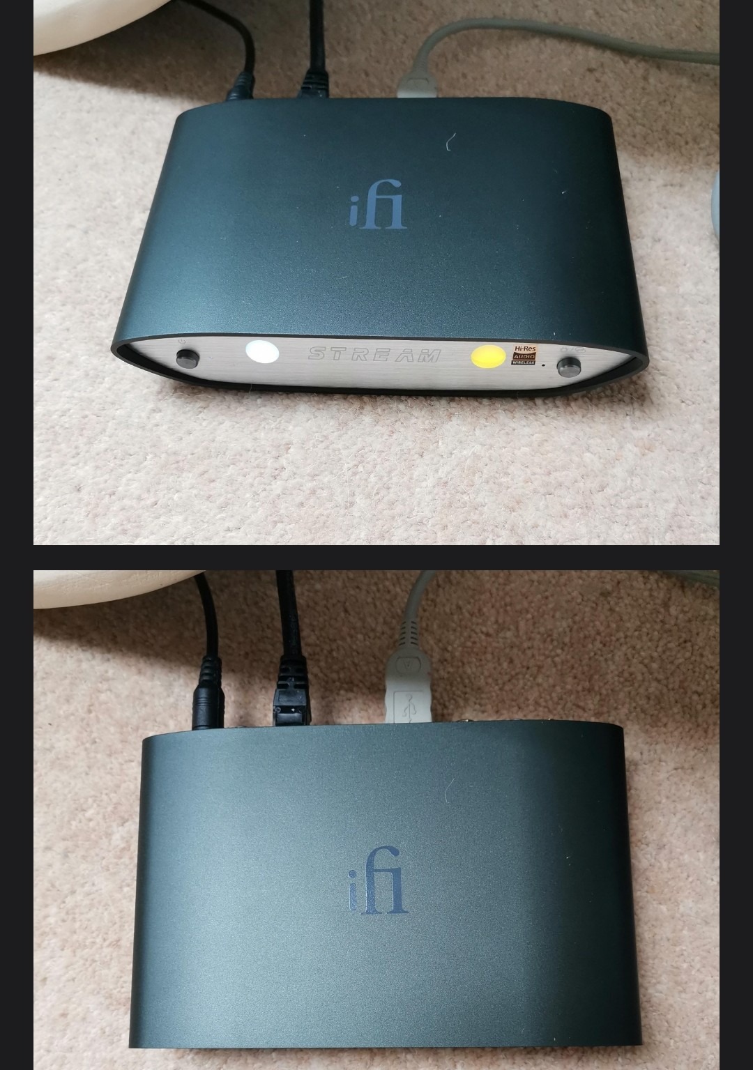

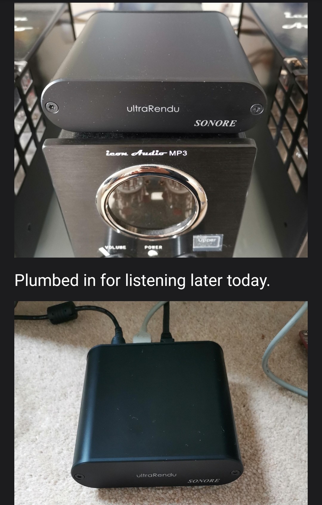

I've been using Qobuz for 3 years.
Most of that with a RPi + Allo Kali reclocker, Volumio and feeding native I2S into my dacs (Najda)
Reccently trialled a couple of off the shelf Streamers.
Ifi Streamer
and Sonore Ultrarendu.

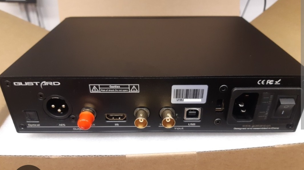

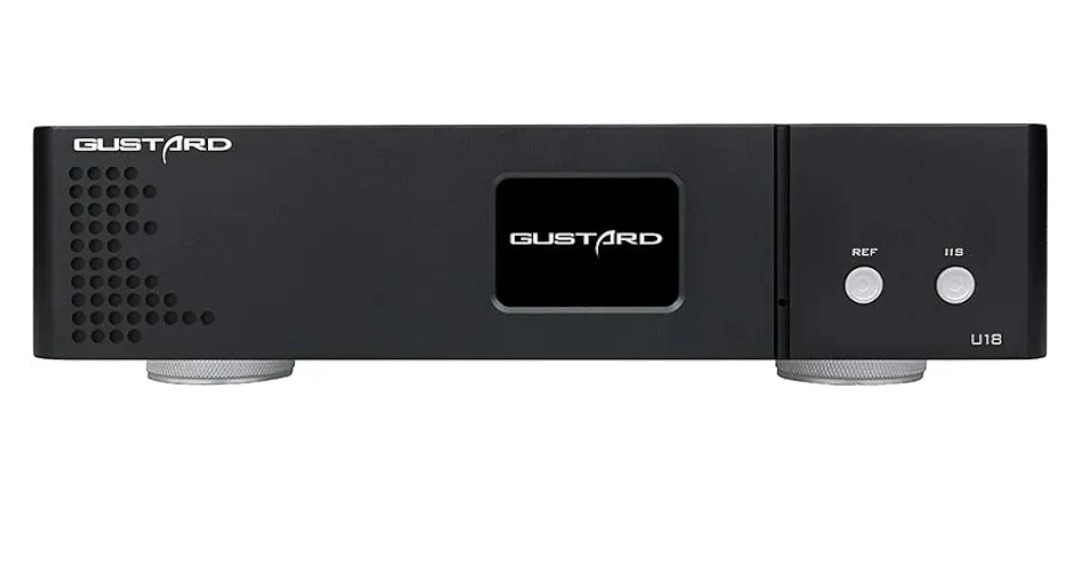

The latter with a Gustard Reclocker.
The Ifi had their purifier in already!
Certainly an upgrade from the RPi.
More resolution and dynamics.
I settled on the Ultrarendu etc over the IFi. Just sounded more me!
Only trouble is that I've been having problems with what appears to be the Ultrarendu hanging up.
It's documented elsewhere,
Won't start playing a track, hangs at 0.0 seconds progress flashing, nothing playing. When viewed in the Playing now screen in Bubble UPnP or mConnect for that matter.
The Dac light is permanently on.
Exiting and force stopping Bubble no help.
Reboot Untrarendu alone, no good.
Have to reboot Ultrarendu and switch the Gustad reclocker off and on again.
Then all returns to normal.
I've tried all the settlings.
Proxy in both places.
Still happens about once a listening session!
I'm on V2.9 of Ultrarendu SW. They sent it.
Sonore have been responsive.
I've sent Dac diagnostics, screenshots etc.
I'm still gathering data.
I thought going down from max 24/192 in Qobuz settings was helping, but nope!
24/96 same problem from time to time.
Usually it's when I load playlists, ▶️ all and then skip about a bit!
Anyway, my Qobuz sub was up and I thought I'd try Tidal (hi-fi only).
No MQA for me.
Since using Tidal it's not happened.
The tonal balance of Tidal is slightly more restrained in the treble, I found.
I actually cranked up the Upper mid (Vitavox S2s) tweeters (Raal lazy ribbons) a dB or two.
Since doing that I've no issues with the SQ.
Sounds nightly fine actually.
Let's see how long it lasts!

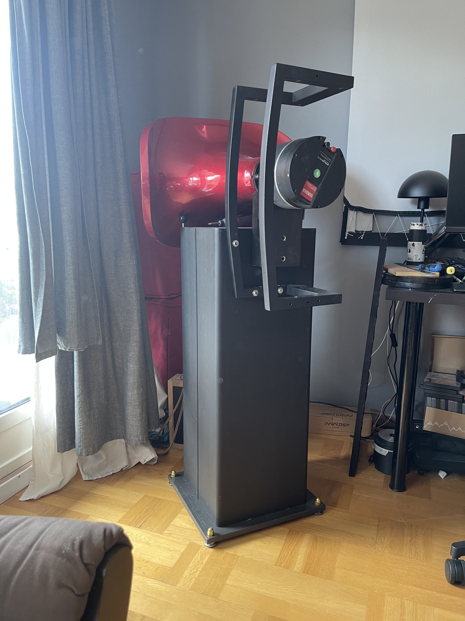

This is where I am. But I opt for 1st order passive above 500Hz. I tried a 17uF cap on my JA6681B in a Iwata 300 from about 600-11000Hz and I liked it better than my attempt at 2nd order. Sounded much cleaner.
I think below 500Hz I won’t bother with physical time alignment. I never heard a difference when playing with the delay on my minidsp. But above that, in theory, I can get problems with the midrange cancelling out or adding to the tweeter horns, especially super tweeters eith high crossover point. But I suspect this is more of a problem for direct radiators, because when I asked Mr BA to measure his horn system with or without the supertweeter at from 8 kHz we did not see anything negative. I hope I get the same result.
To experiement with time alignment on my tweeter horns I have prepared a simple slide on a metal shelf. This is how it looks like now.
Midbass horn is under development. I will make do with four Seas W26FX002.
