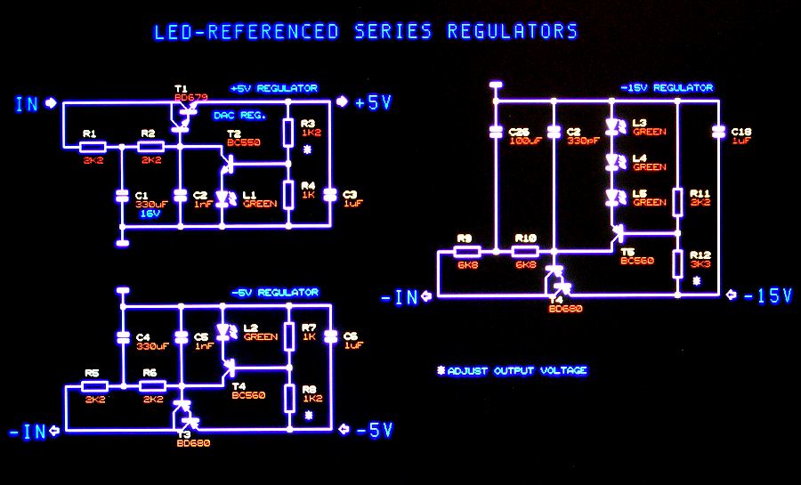

DEM RECLOCK
Hi John,
in Post 35 and the attached Schematic you are powering the inverter IC with 10v derived from the -5 and -15v lines.
I am using a differential line driver (DS8921) to create the balanced DEM clock signals, which is powered by +5v. Is it worth me powering the DS8921 chip with the -5 and -15 power in the same way to create the negative offset in the DEM reclock signals?
Brad
Hi John,
Brad
No it runs on approx. 5V DC (-5V minus voltage drop across 5.1V Zener diode D1). So the 74HC00 GND connects to -15V and the plus connects to approx. -10V.
The DS8921 can also be used, but it might require a separate voltage regulator:
UA7805, input to -5V, GND to -15V (creates positive 10V input voltage with respect to GND pin), output then provides +5V with respect to -15V supply.
But it's better to use the discrete LED referenced power supplies (much better sonic performance compared to 78/79xx regulators). I attached schematics of these LED referenced voltage regulators (+5V, -5V, and -15V).
For the DEM clock mod you would need two of these +5V regulators.
