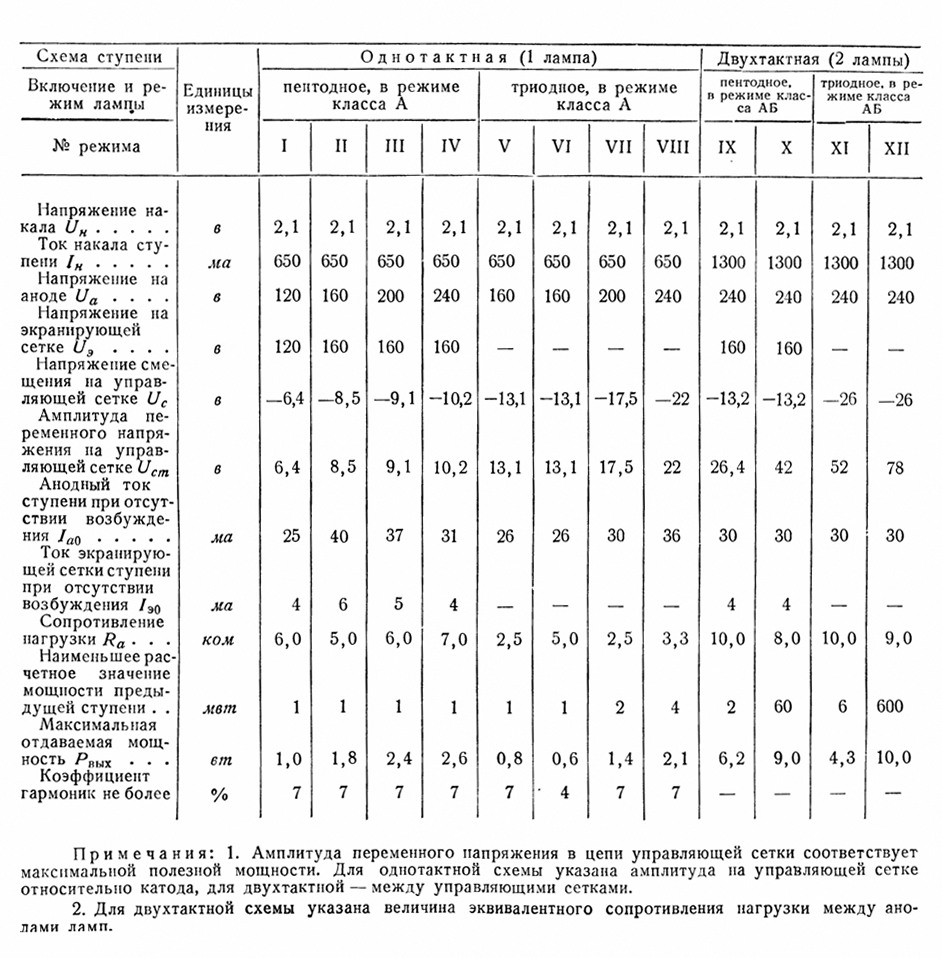

4P1L
A little about 4P1L http://www.klausmobile.narod.ru/testerfiles/4p1l.htm

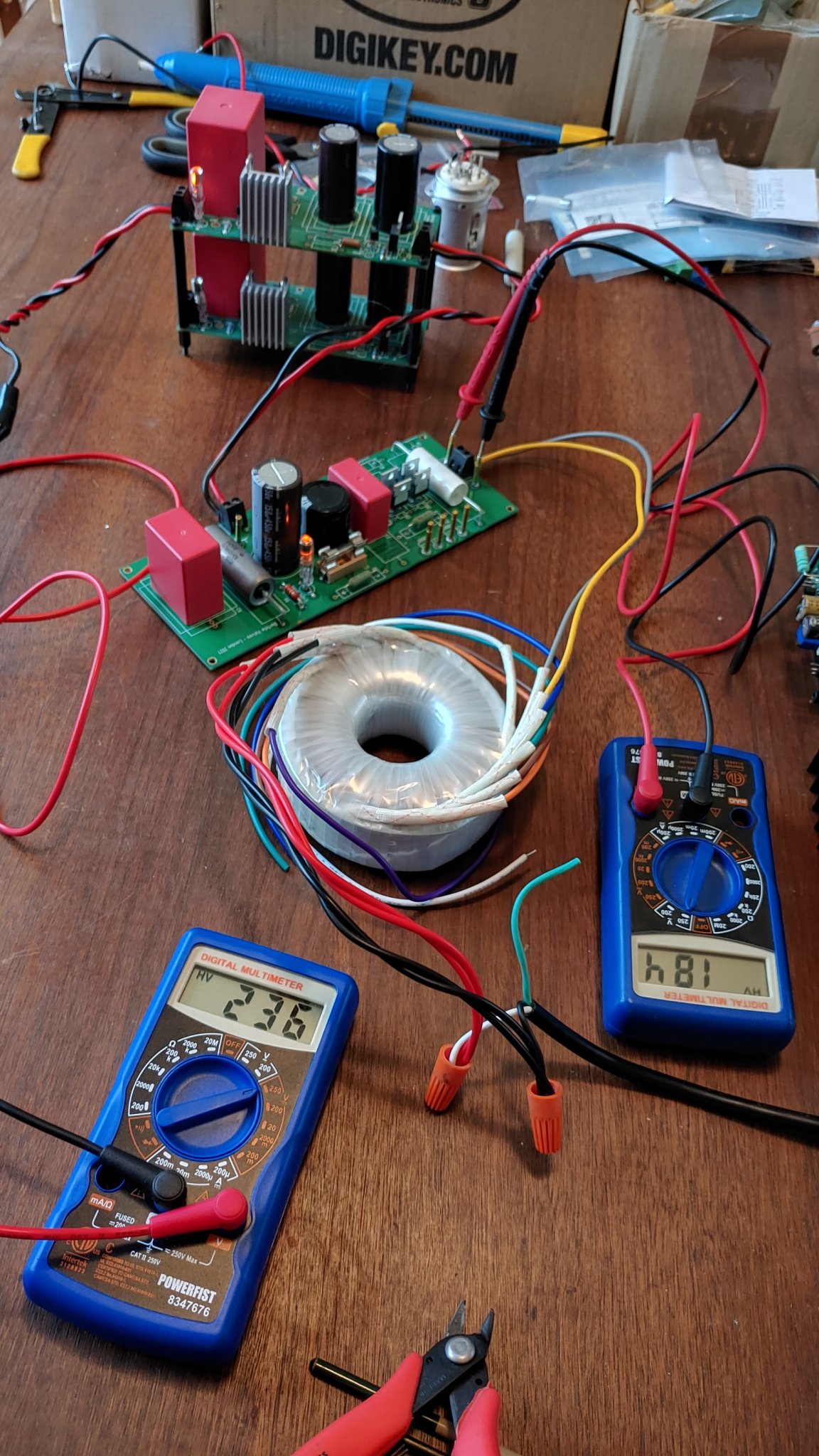

I've started back in on this project after some time away. Recently I finished the final assembly of Ale's HT power supply board. I got about 255V out which feeds into his cap multiplier board set to 235V out as seen in pic.

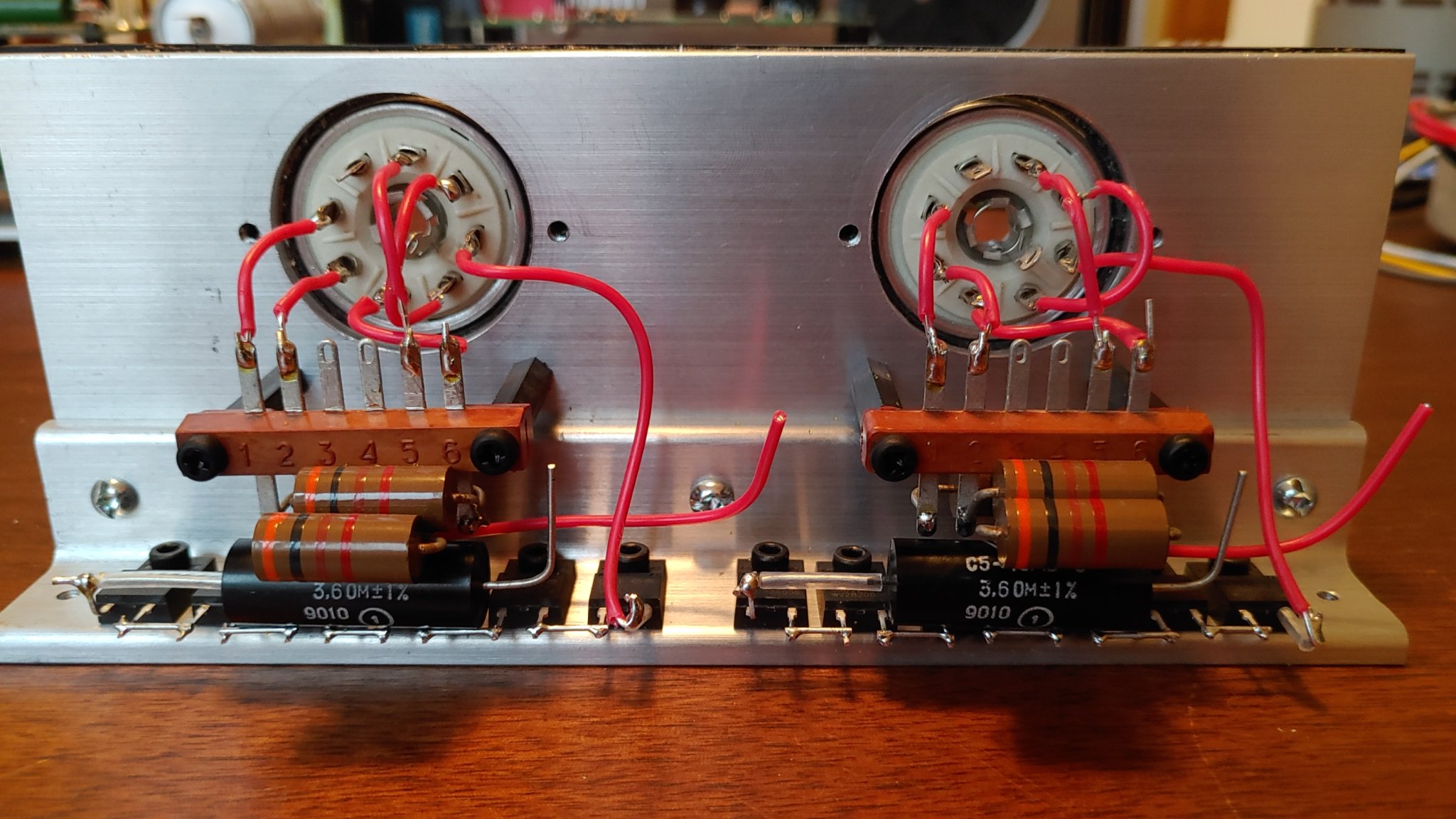

I've attached a pic of my tube termination board. Here on the bottom you can see a string of 6 SIC diodes along with a 3.6ohm resistor to get the last little bit of voltage drop.

You can see on the right hand side I takeoff from pin 8 to the anode of the first diode. I pick up the resistor at the other end and then have the ground point ready back at the other end of it.
I expect my bias voltage with diodes and resistor to be a bit above 8V running 590-600mA through the filament. If I understand right my bias value will be fixed and I will the adjust the gyrator voltage to ultimately set current.

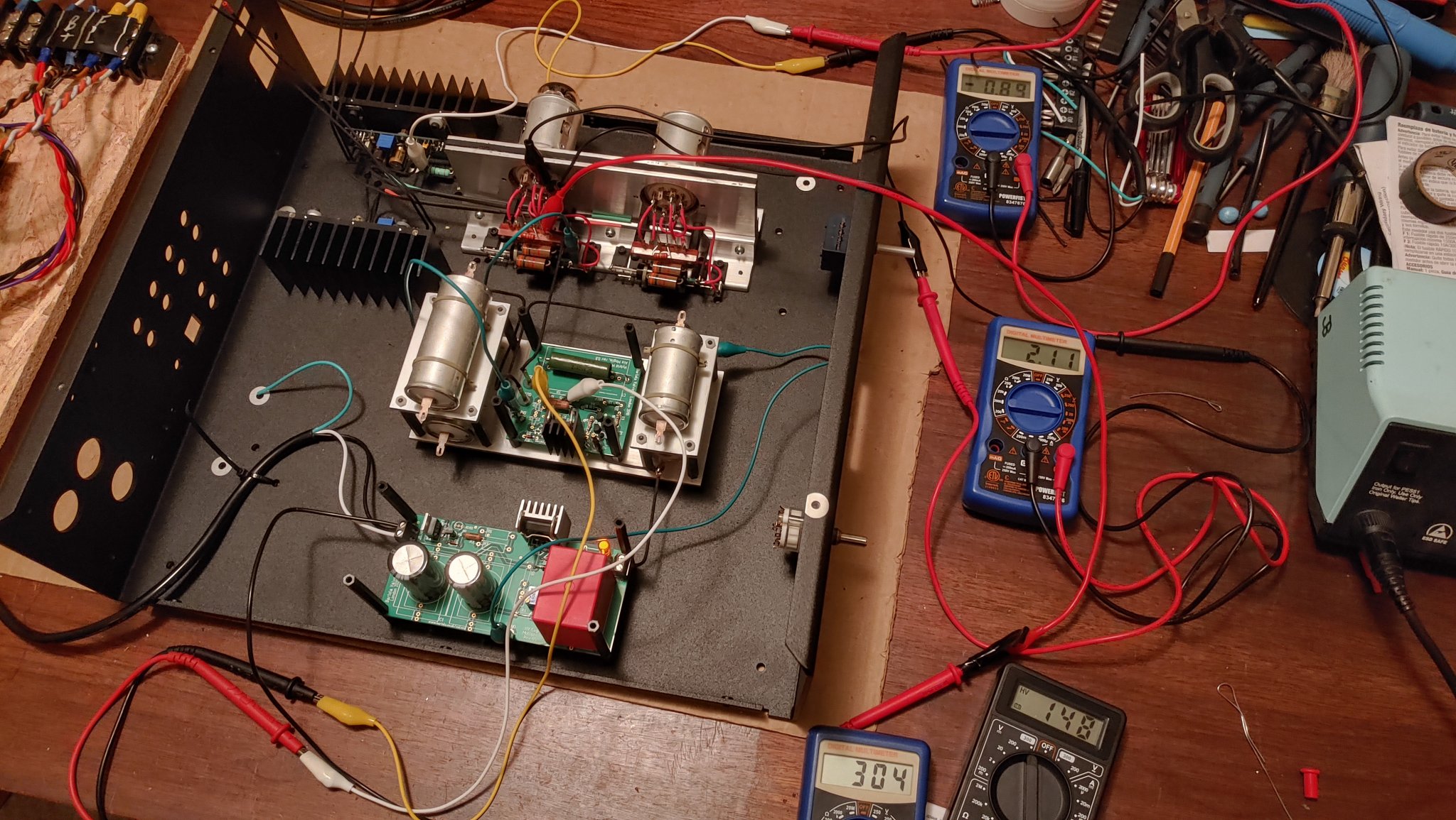

First power on of one channel with tube installed tonight and everything is looking good.
Raw DC output of 15.6V allowing for me to get 580-600mA and 2.1V for the filament.
Connected the B+ by way of Ale's cap multi board and on to Gyrator. Voltage at anode is 148V and reading 300mV at test point for 30mA.
This is using a hybrid of 6 diodes off the filament and then a series 3.6ohm to ground.

That all sounds like a typical "solid state" stage, and 30mA is good for a 4P1L. In my own case I mostly listen to opera, classical and jazz so I have quite stringent demands for the tonality of voices and acoustic instruments. This caused me to abandon the gyrator solution in favour of a simple resistor load - purer and no glare at all. I used the combination of diodes and resistor for a short while because it was convenient, but once again abandoned it because of the same discomfort with an audible edge to the tone. This disappeared with a simple resistor in the cathode, using filament bias. I'm a massive experimenter, and have tried just about every version of a line stage, and I've ended up with no solid state apart from the filament regs for the DHTs.
However, with the 4P1L the demands of using 30mA current push up the B+ which might not be desirable. So I have tended to use valves which are comfortable at lower currents like 12-15mA. The 4P1L isn't - it sounds thin below about 25mA. So I moved to other DHTs. 2P29L is OK and quite transparent but there's better. 112A has a fuller tone but it's quite a boring valve. 26 can sound good - it's a nice valve especially on vocals. But if you're already at 1A for the filaments why not then go for a 47 at 1.5A. This has become the choice for my "daily" amp. The 10Y is better still if you can find any, but it's expensive. Still the best, though. So for an affordable DHT stage my choice goes to the 47. The 46 is also good. Again, I use it in filament bias with a resistor load. Pure sound, transparent, no glare at all.
If my primary listening was rock music I might find a gyrator and diodes in the cathode acceptable, but I never listen to rock music. For acoustic instruments I stick to resistors or otherwise a good plate choke. Always filament bias with Rod Coleman regs. .

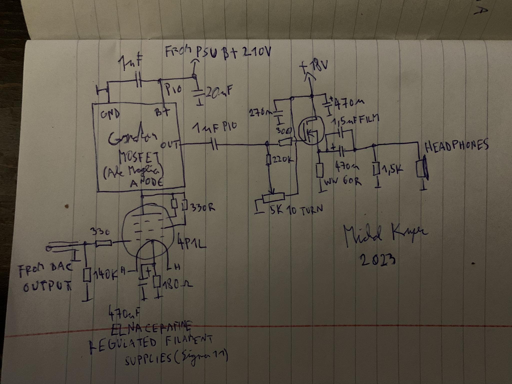

Okay, so I would want to revive this thread a little bit: I scrambled every part that I needed to modify my e88cc heaphone amp, and Ive ended up with this: signal straight from ad1865 dac to 4p1l grid, loaded on Ale Moglia gyrators, with rc network in cathode (my bad I dont have colemans regulators and filament bias, just sigma11 low noise power supplies for the filament, and running the 4p1ls on 4.2 volts). Precision resistor and elna cerafine in cathode.
After this it is cap coupled (1uf k40y-9 russian pio) to mosfet IRF540 source follower and to my 35 ohm headphones. Follow the schematic.
Since the first notes playing I have been surprised with this preamp. Such a clarity and lots of emotions in the music. Crystal clear sound. Best sound Ive heard from my experiments with headphone amplifiers. Plus I have almost zero noise (I took several precautions to eliminate both power supply hum noise and high frequency noise). But the microphonics is a little problematic, yes. So far so good. The 4P1Ls really sing. I think about what modifications I can do or if I can try some other DHTs? Maybe 2P29L? Or I have a pair of old european E422 tubes (equivalents of telefunken re134).

That looks nice. If you want better than 4P1L I would use a type 26. However Ri is 7.5K so your source follower would have to do some work on that. With a gyrator you could look at the 01A as well. That's very nice.
The 2P29L is about the same level of sound as 4P1L. The 4P1L needs at least 25mA through it, 30mA better. 2P29L isn't so fussy.
